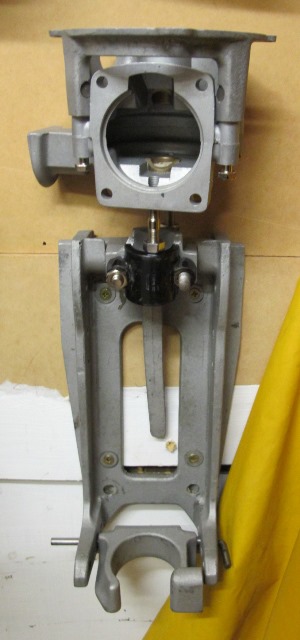

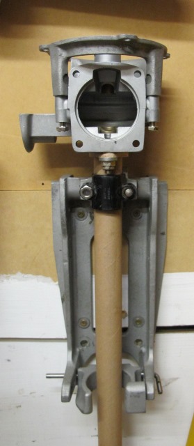

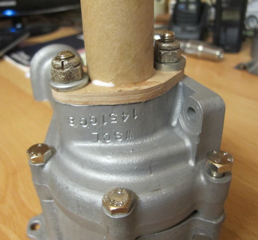

Having run out of many parts I have just fabricated a dummy drive shaft tube from cardboard and plywood.
This allows me to display the next series 102 engine, I need the block and piston next?

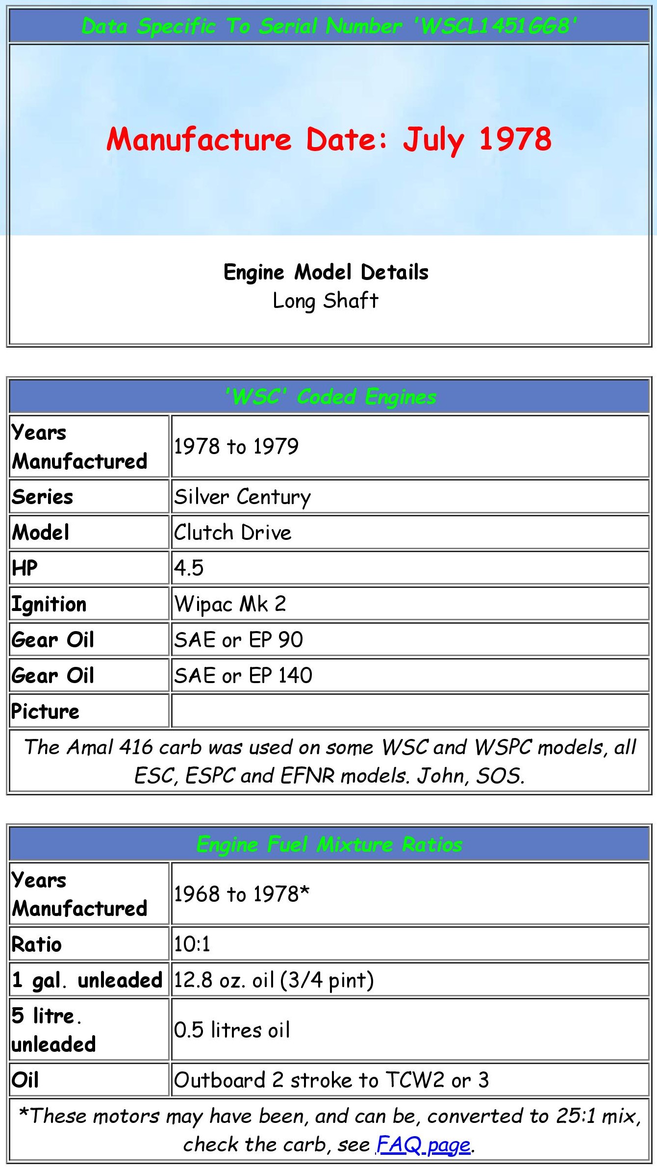

The motor number did not show up when I checked in the SOS search pages.
The number reads WSCL 1451 GG8
fleetingcontact
Posts: 275
Re: Roys third 102 series build
Post by fleetingcontact »
african imp
Posts: 395
Location: Hout Bay
Post by african imp »
fleetingcontact wrote:WSCL 1451 GG8.jpg
Thanks on that!
I have now copied the info and will file it for the motor and future use.
What is an Amal 416 carburetor?
Ok, its shown in the Seagull parts book circa 1980 on page 20 :P
To date I have never seen an Amal 416 carb.

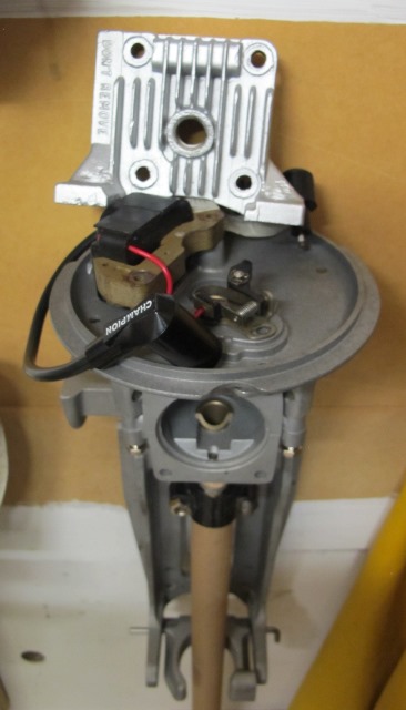

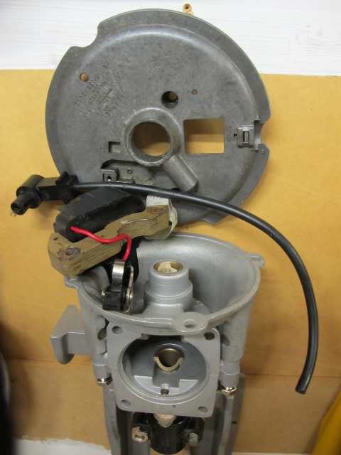

Scraping the bottom of my parts bin I discovered a part damaged flywheel base plate, I have a Wipac 2 coil and a probably servicable plug lead.
There is a restored flywheel as well, so progress has been made?

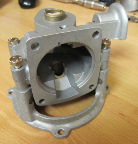

A change of engine, no longer the 102 series but now I find the spare crank cases that I have are stamped with Silver Century engine numbers.
Question, did the 102 series and the Sliver Century use the same crank case?
I have one Century cylinder head that is servicable.

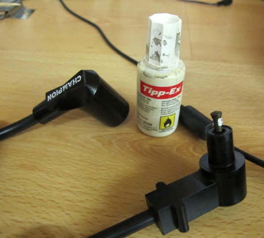

I have a HT lead, one end was cut off so I screwed in a Champion HT plug cap, the end that fits into the Wipac 2 coil had a spring only, I removed the brass bullet from another HT lead and once fitted, bonded the spring to the bullet with Tipp-Ex :P
Posts: 3295
Re: Roys next build will be a Silver Century ?
Remember to get as much electrical conductivity between the spring and nipple. This is an area that causes problems of lost or intermittent spark. Yes, nipple can dislodge and disappear.

Hugz wrote:Remember to get as much electrical conductivity between the spring and nipple. This is an area that causes problems of lost or intermittent spark. Yes, nipple can dislodge and disappear.
Thanks on the advice.

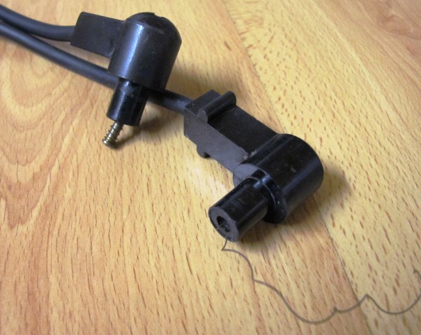

My next selection is small, one looks quite good, the other needs a spring soldering on?
Yes, I know that new ones are the best idea but by the time I pay then have posted by registered mail, clearing and the vat here I will have paid three times the UK price?
So I recycle whenever possible :P
I note that Fred in Robertson,Western Cape, RSA is charging R300 for a new HT cable. That is a similar price from the UK and before I ship it in.
Posts: 3295
If my memory serves me correct l used a piece of a jug heater element as a replacement spring in the past. Only spiral l could find of the right size. I would probably just coil my own now.
