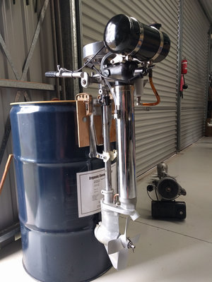

I bought this 63 model 102 about 10 years ago. I finally got around to "doing it up" and finished the project yesterday. The motor is in good condition with little rust in the head, and starts easily.

1963 Seagull outboard

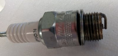

Took the 102 for a run on the river today with my granddaughter. The outboard ran fine but, after about 5 minutes running, it stopped dead and would not restart. I had to row back to the ramp glad that the test run was against the tide. My initial thought was that the coil had failed when it got hot but I found that the issued was a fouled plug. I guess that there was some loose carbon floating around in the cylinder. With a cleaned up plug, the outboard ran fine in the test tank for ten minutes. Lesson learned is take a plug spanner with me on the next test run.

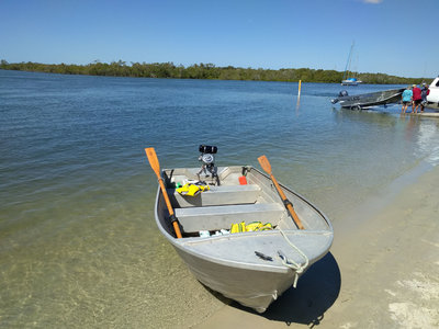

All ready to depart
All ready to depart
A fouled plug put an end to the test run.
All ready to depart
All ready to depart

That cable tie on the tiller arm will probably kink the throttle cable if the tiller arm is raised vertical!
Re: Retirement Project
Good job on the rebuild, look great.
Valid point about cable tie, throttle cable often better left hanging loose from previous experience.
Who hasn't got a Forty Plus or a featherweight with a kinked cable, caused by the cable going through the hole in the tiller mount.
