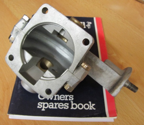

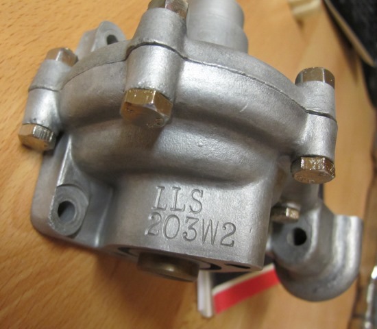

A Silver Century crank case is in the pictures, I have two of them.
