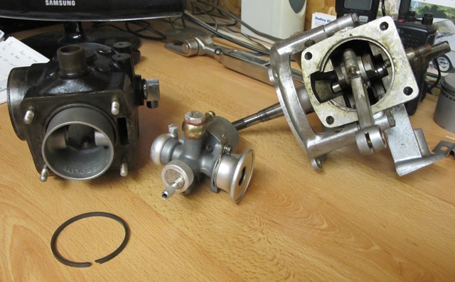

I have just managed to unseize a series 102 engine with the Wipac 2 ignition.
On inspection the engine is near new, I will have most parts in stock to reassemble it into an outboard but there is no carburetor.
Can I use a Villiers carb as in the picture, I would need to make an adaptor to have it fit the inlet pipe.
Any comments please?

Seems like a lot of work for very little gain Roy.
I would measure the throat of the villiers and see if it's the same ID as the inlet stub on the 102 cylinder. 2 sizes of villiers carbs that were fitted onto seagulls to be aware of. The smaller size villiers (7/16 i think) was normally found on very early 40 series seagulls and possibly the odd lawn mower engine. The bigger size villiers (1/2 inch i think) was what normally got fitted to the later 64cc seagull 40 series and probably a lot of other applications other than seagulls. There may be other sizes of villiers carbs around with different jetting for other applications, and therein could lie a lot of trouble when it comes to jetting requirements for a 102, so for the sake of keeping things simple i would opt for the normal amal 46n carb for your 102.
There are plenty of used amal 46n 2 jet carbs available via the internet.
This is what i found in less than 5 mins.

If all else fails you could also use the later amal 416 if you wanted as these were a direct fit for century's and 102's for when the original carb failed. The main SOS site mentions this also. You can also find them on late model 40 series engines although with a nylon adapter ring inside the flange for a smaller stub as on the 40 series engines.
Just like this one https://www.ebay.co.uk/itm/SEAGULL-FORT ... sPageName=
Just remove one of the nylon adapter rings inside the flange to suit the bigger stub fitting and you're good to go.
Might be a different jet size for a 40 series so something else to be wary of. These 416 carbs will also run quite happily with a 10:1 fuel mix too. They're a little more adjustable compared to the older 46n carb but there's not much in it that i've found. I like them and have the odd one or two fitted to some of my 102 "bitsa's". They work good and they're a straight swap with no extra fiddling around to get them to work.

The century used the villiers, the silver century used the same amal as the 102. Seeing the Century, Silver Century and 102 are similar internally I'm assuming your villiers carb will work fine. Depending on how you modify it your inlet stud component will be longer but that shouldn't present a problem. Keep the barrel original so later you can fit amal.

Earlier century's with villiers carbs also used slightly different cylinder heads with smaller volume combustion chambers (the one's that the racers usually want for their "high spec" sooper dooper tweeked motors) and sometimes referred to as "high compression" when you see them on fleabay which are different again to silver century variants.
For simplicity's sake i'd still use the tried and tested amal carb. You can't go too far wrong from the engines original design concept that way.
Adding some sort of sleeve to the cylinder stub will add extra length to the inlet runner not to mention any variation in internal bore diameter of the inlet tract unless you could somehow keep a smooth transition between the two. From experience when i used to race small 2 stroke mini bikes air doesn't like moving past or over or around too much of a step for want of a better word, at least not more than a 45 degree angle anyway without some sort of disturbance to air flow. Not sure how the villiers carb would cope with that even if you could get the jetting somewhere near correct. Air flow in an ideal world likes a smooth entry and flow with little to no disruption in its way. I can see an added length of sleeve to allow a villiers carb to fit onto won't be doing much for the 102. Bit asthmatic i can imagine.
But let's not argue, this is Roy's seagull. Let him decide

An Amal two jet carb would be my first choice but given that even John of SOS struggles to supply them and then at what becomes an expensive choice once shipped to Cape Town, RSA, I have to think of other options?
I may start the engine on the smaller Villiers carb and then wait for an Amal 2 yet to appear ?
The Villiers carb I have is a half inch one.
Thanks on the advice you have given.
