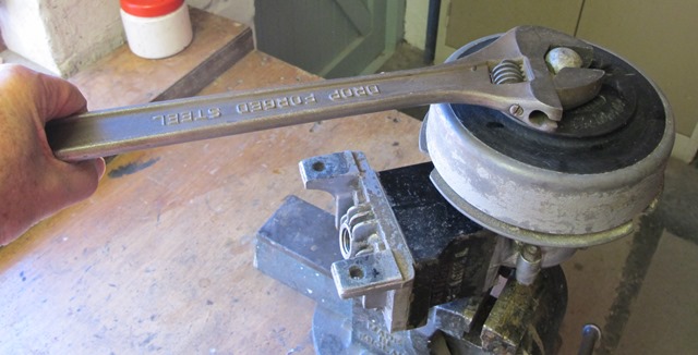

Guys, I have a 1974 Forty Plus here and even with a 350mm long shifter on the flywheel nut the thing will not move.
I have the crank shaft square in the vice, my fear is that if I use the shifter with too much force I will damage the crank?
Right now I am thinking about using some heat from a gas flame, to protect the plastic, I will place a wet towel on the plastic and a metal cover plate over that, this seems to be a best option.
Does anyone have another idea please?

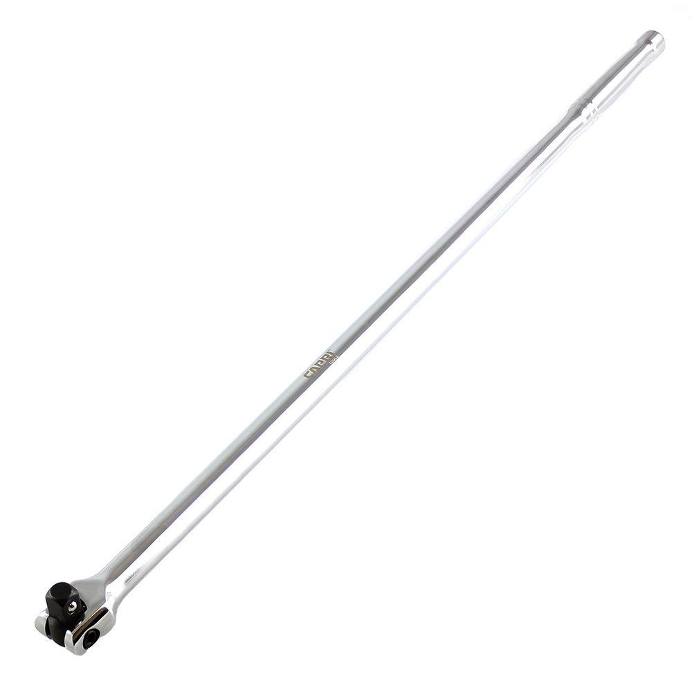

I was a bit worried it might distort the crank but when I finally got the flywheel off it was obvious it was already toast - very rusty.

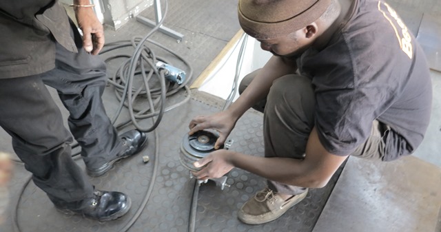

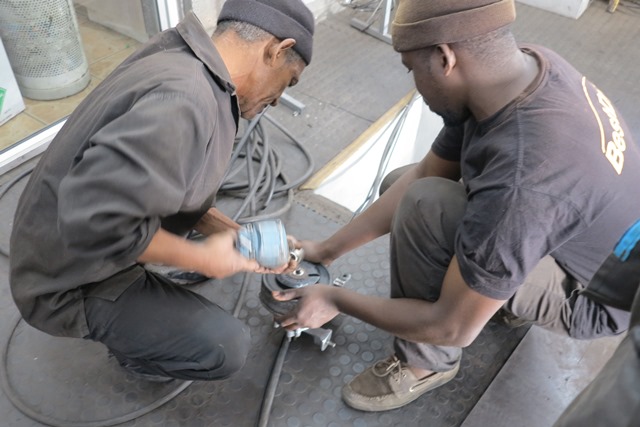

I used your impact hammer idea and had a tyre fitment shop use their air gun and with the socket that I gave them for the job.
Thanks on the very good advice!

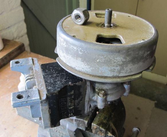

Thanks, yes I moved to a socket and a long bar, hitting the end of the bar with my one pound hammer with a copper face brought no results so I left it for a pro tyre shops impact hammer this morning, success was near instant but it still took a good go with the impact gun.
