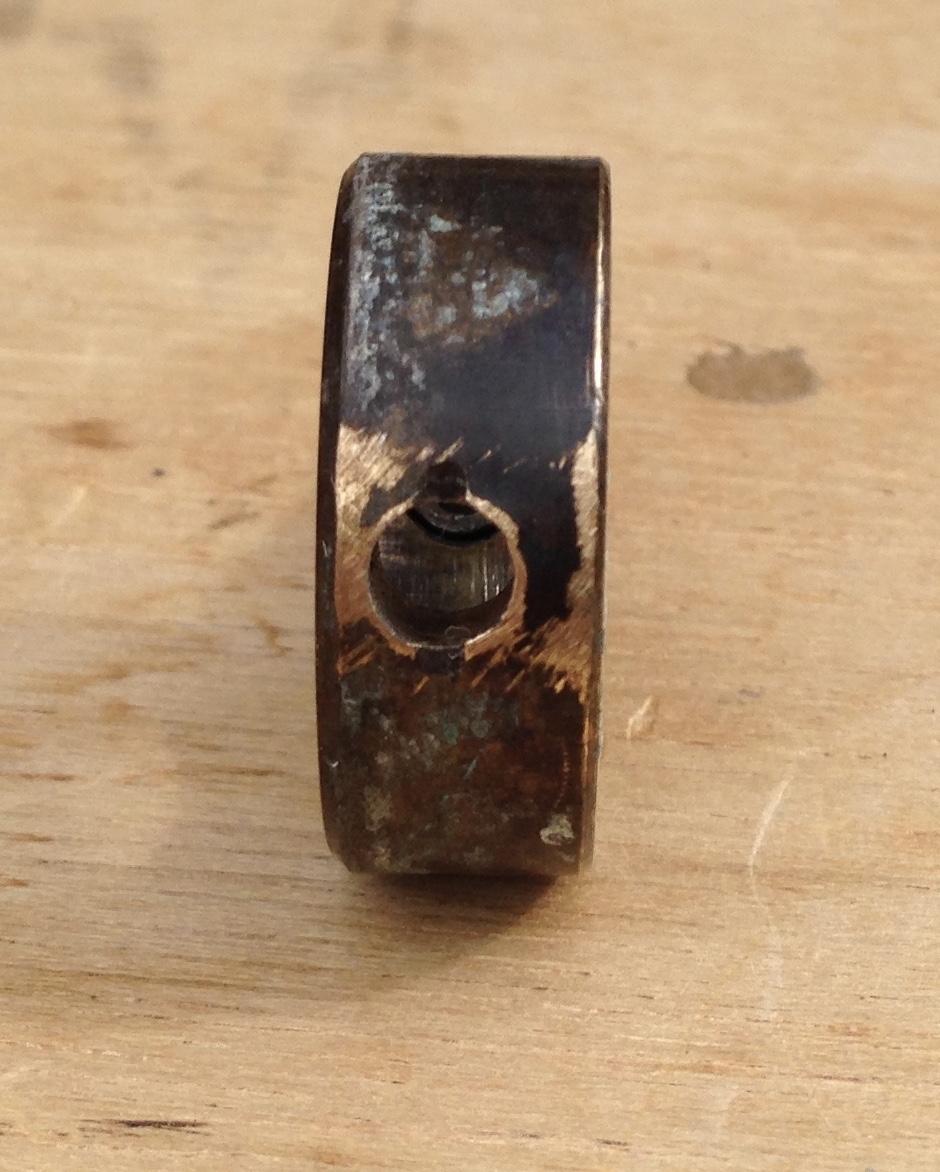

2 the brass collar inside propellor(1410A) has a hole for the pin (1412) that is eccentric - see photo. Is this intentional so that one can fit it one way to increase the pressure on the rubber oil seal, and the other to decrease it?
[attachment=0]IMG_1031.jpg[/attachment]download/file.php?mode=view&id=13621
