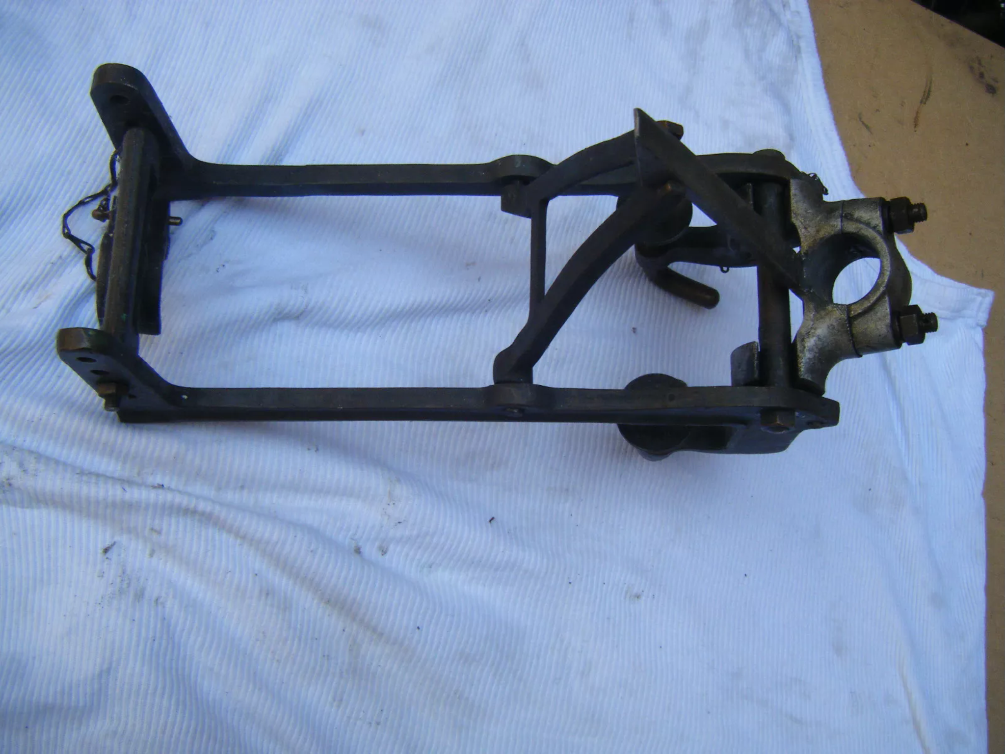

Hello all,
Looking for some close-up pics of a complete skeletal bracket - particularly showing what the original bolts & transom screws were - so I can get my incomplete one finished as accurately as possible. Have done a search but hard to tell from the pics I've found so far.
The bolts on mine are steel & look a little thrown together from whatever was laying around in the shed. Are they supposed to be brass? Nuts either side?
The thumbscrews are stainless, missing the cups - are these likely to have been original? And if so - same pads as the Marston likely?
I'm also missing the bronze V-strut if anyone would like to sell or trade?
Thanks for any help. Have a good one.

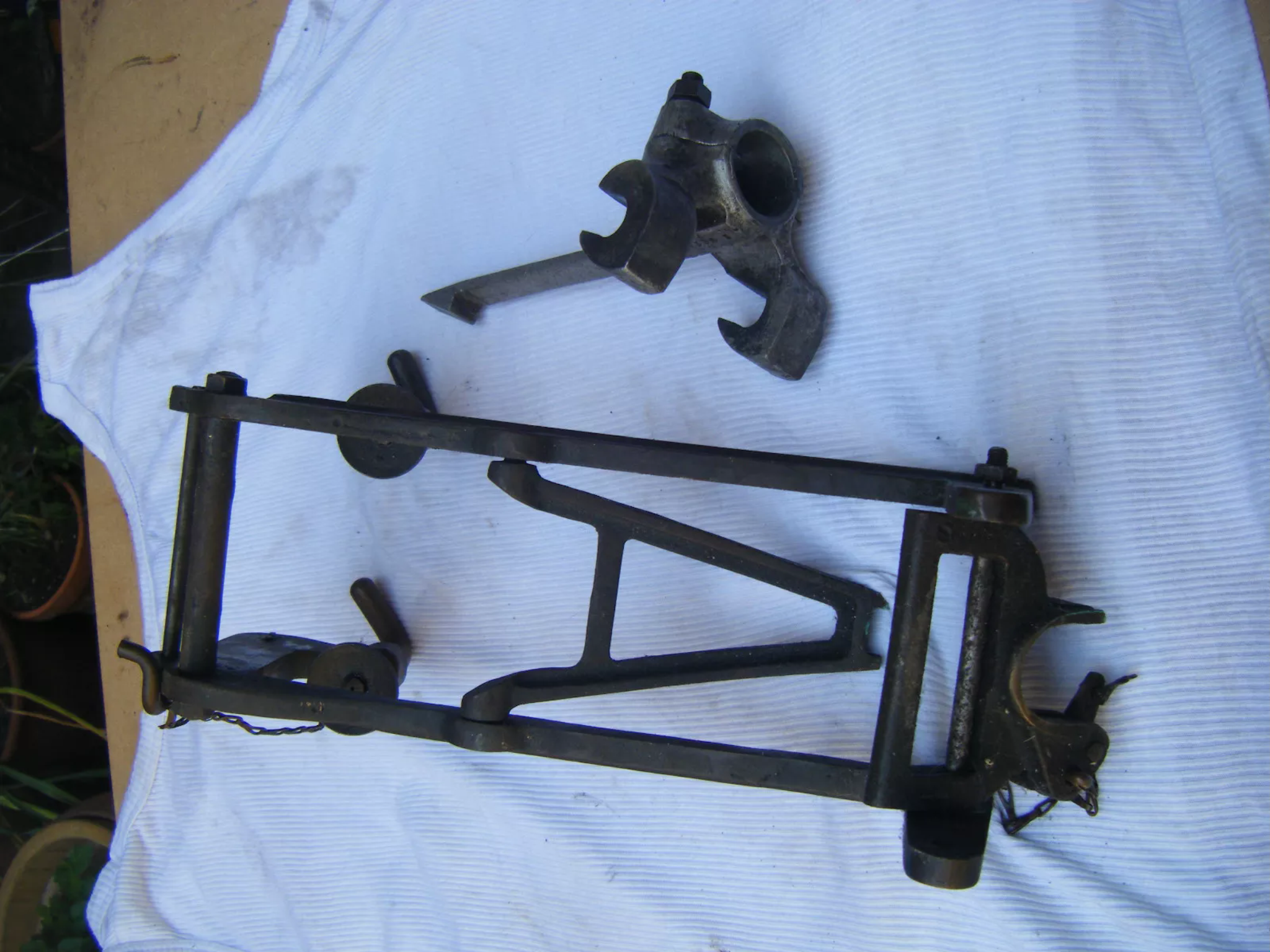

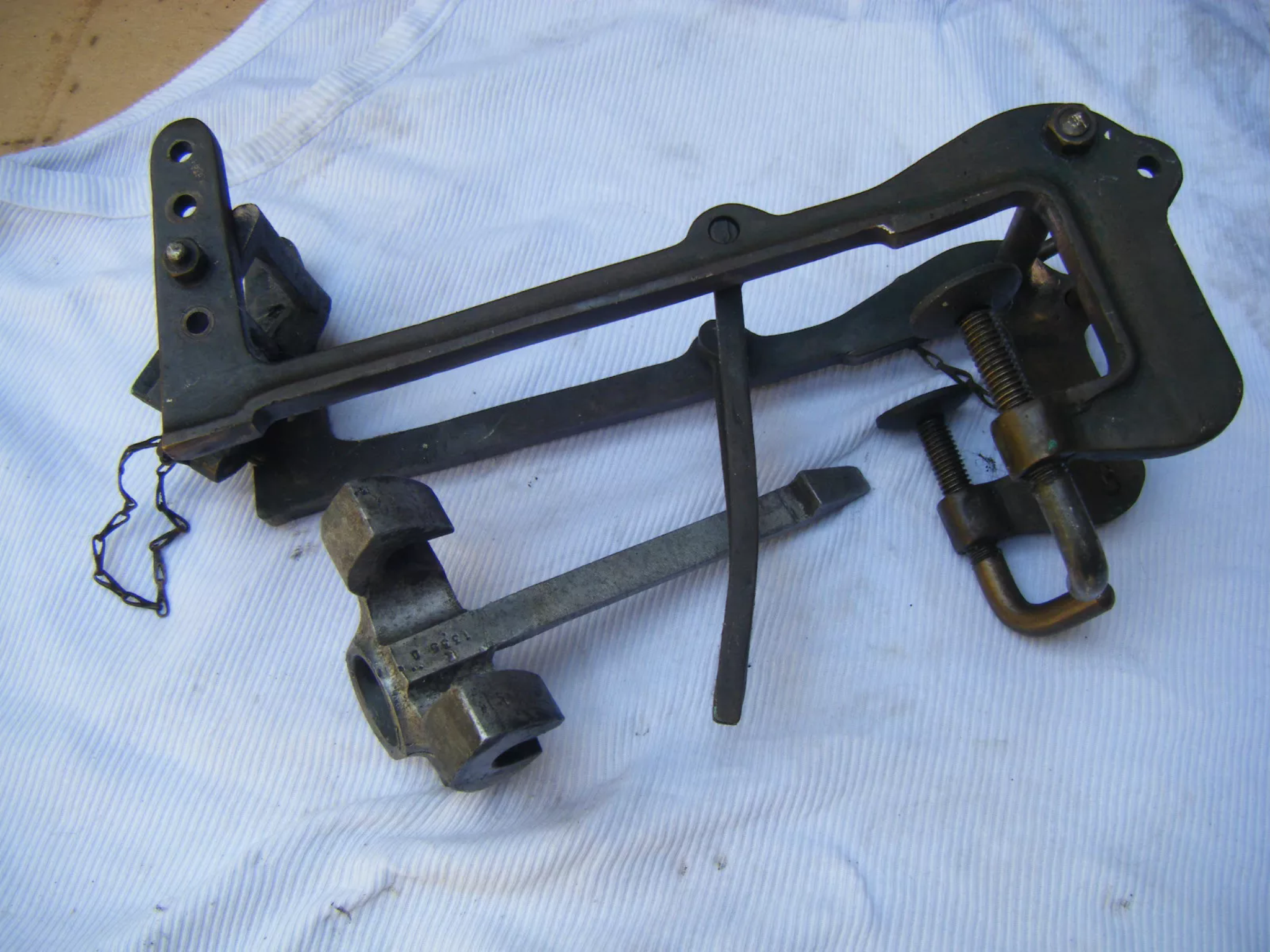

Re: Skeletal Bracket

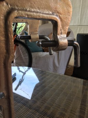

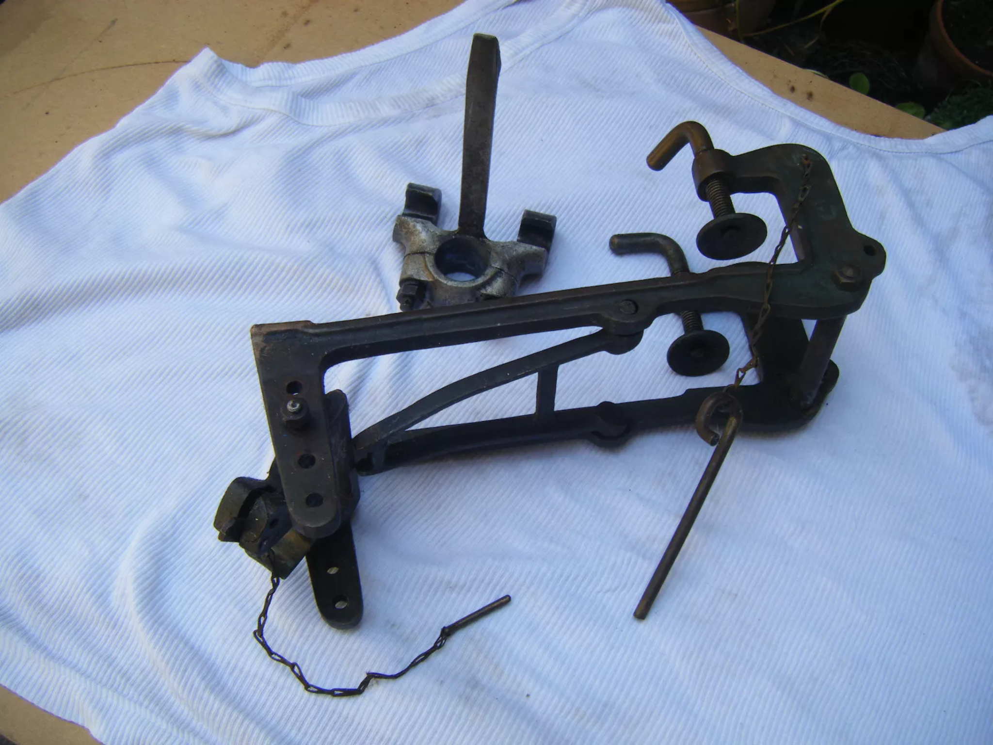

Here are some photos of mine for you to compare. My understanding is that bent thumbscrews were brass, and they are available from SOS. The pressure pads are made from steel, stainless I think. The marston ones are different as they have cast alloy pads and wing nuts. The replacement later thumbscrews are beautifully made, well worth the cost I think.

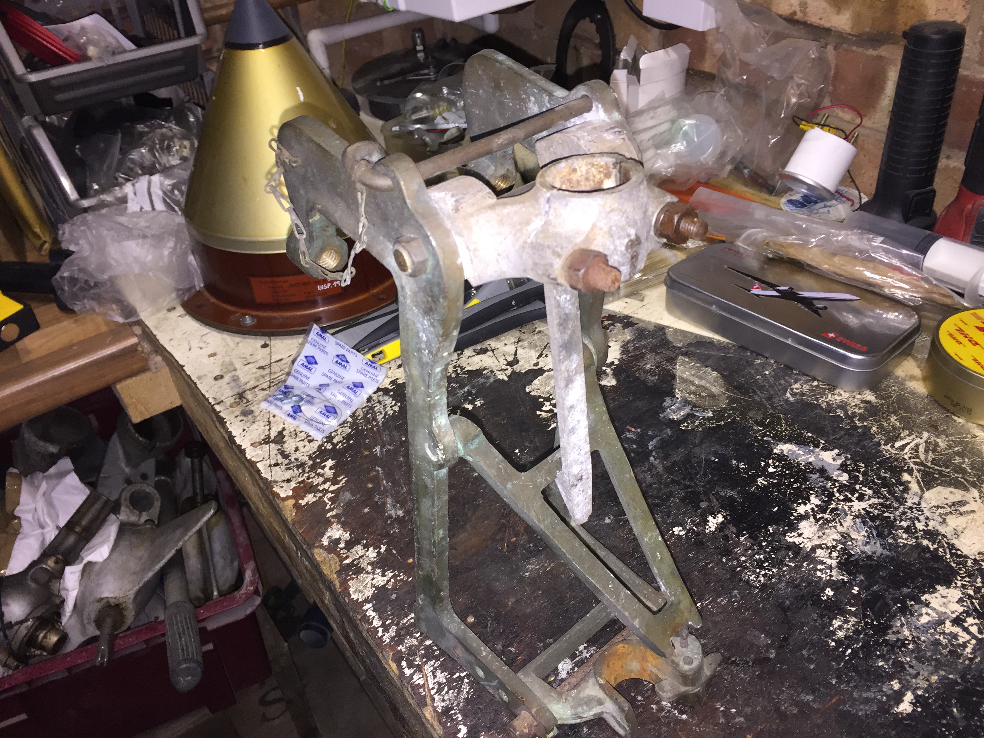

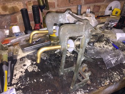

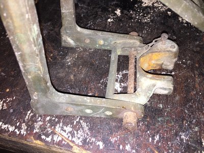

Some more pics

Thank you both.
Looks like the bolts are steel, any idea of diameter & thread for the upper & lower mounting studs?
Yep, brass thumbscrews.
Note extra bolt across, above thumb screws. Strengthen bracket mod by BS?

Measured up the stainless (monel, maybe?) thumbscrews - 3/8" diameter, not the usual 7/16". Strange.
Given the ball ends - maybe an early run, a stepping stone between the Marston thumbscrews with pads & the brass L's..? Doesn't explain the smaller diameter, though (assuming all of the Marston thumbscrews also measured 7/16"..?)
Thanks, have a good one.
