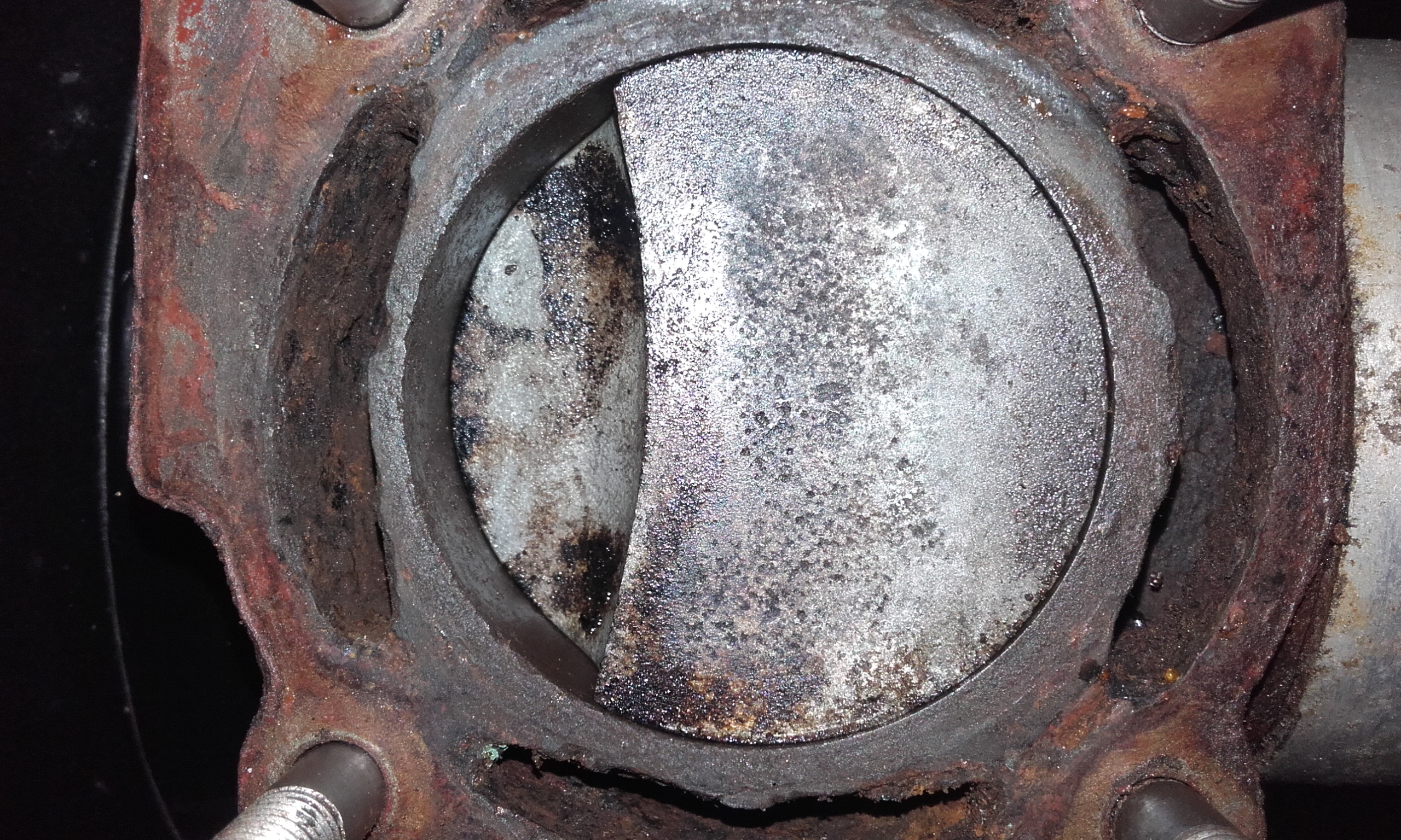

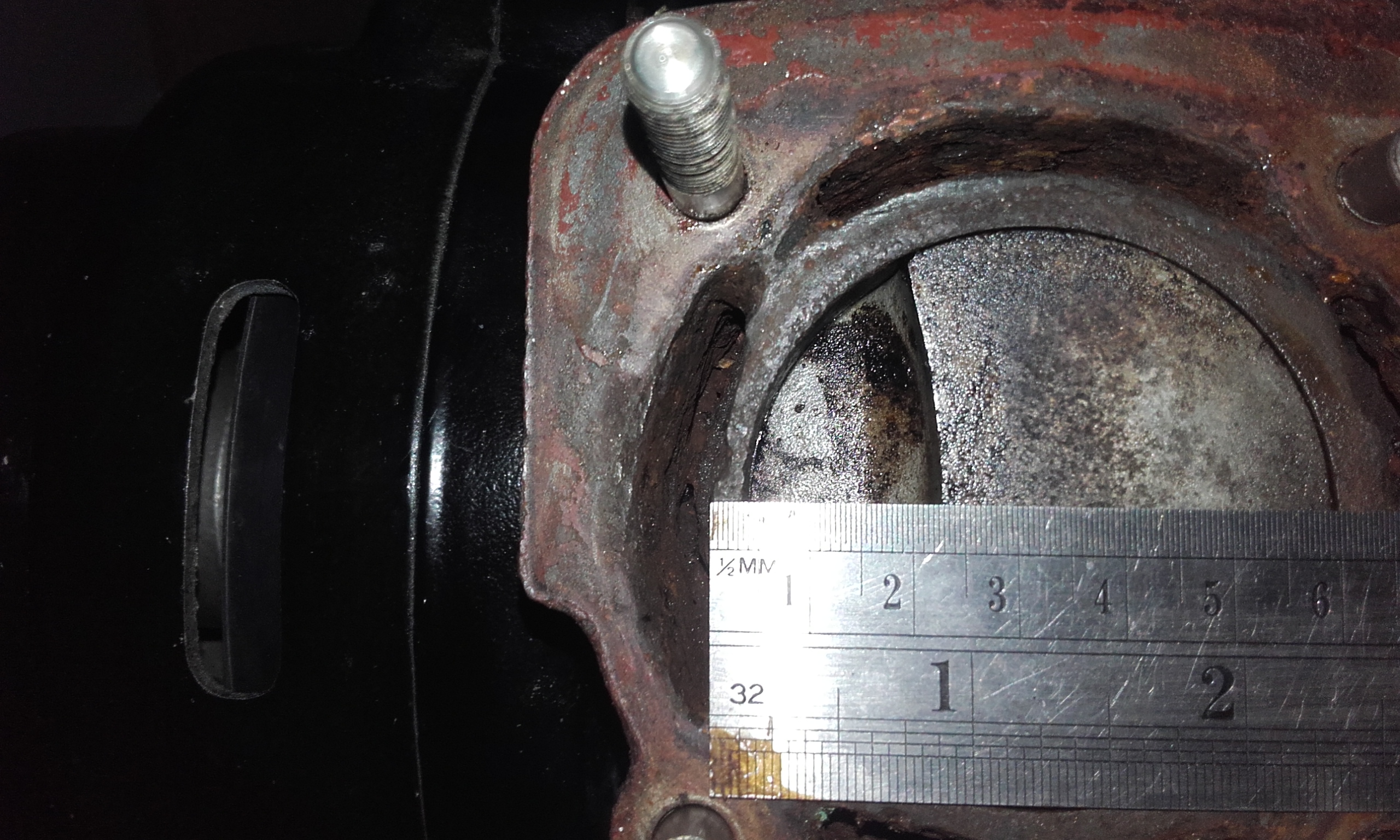

Charles, Not sure what measurement you mean but have attached photos .... as you can see there was a fair bit of corrosion within the jacket with the top part of the cylinder greatly thinned. Inside surface of bore looks fine and piston running smoothly.

I need the distance between the top of the piston & the top of the cylinder wall at TDC, so that I can make an educated guess how much to skim the head face of the cylinder.
The cylinder looks like it's getting near the end of it's life, but as they're no longer available you've not got a lot of choice.
Your piston looks like it's running hot, give the carb a real good cleaning including the main jet & float chamber & give me the number stamped on one of the flat sides of the hexagonal main jet, it should be a 115.

Seems to be 32 thou. Jet is a 115.
Re: Kingfisher / Osprey
Can't skim much off that, try 12 thou off the top of the cylinder, anyone with a mill could do it.
