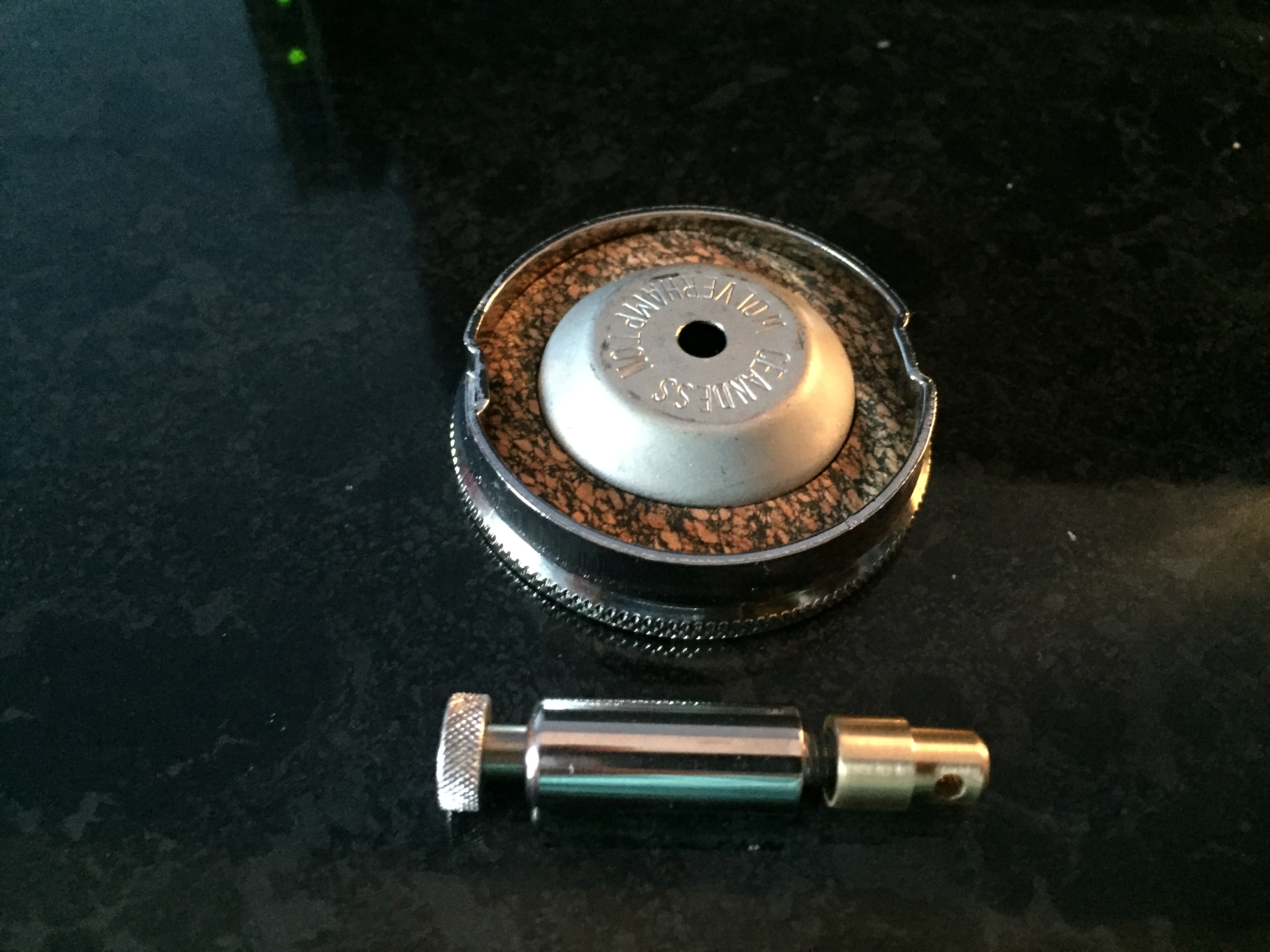

The vented ones have a small drilled hole in the inner diaphragm, around 020" this is to allow fuel tanks to vent. Here's a new one before the vent hole is added, with a replica air vent.
The originals were chromed brass, the new ones are chromed steel. Ceandess have been making these since the 1930s 8)

i have the same cap in your picture with no vent.
I would like to make a replica air vent for the cap, but how does the vent work?
i know the needle opens a hole in the centre, but were does this vent to?
cheers Jan
Re: seagull 102 SD fueltankcap
There is a tiny vent hole in the side of the air vent. When you tighten the screw, no air can vent through this hole.

If i understand this correctly there is a tiny hole in the side of the airvent wich breathes in between the inner and outer cover of the cap.
Do you have a picture where the hole is?
