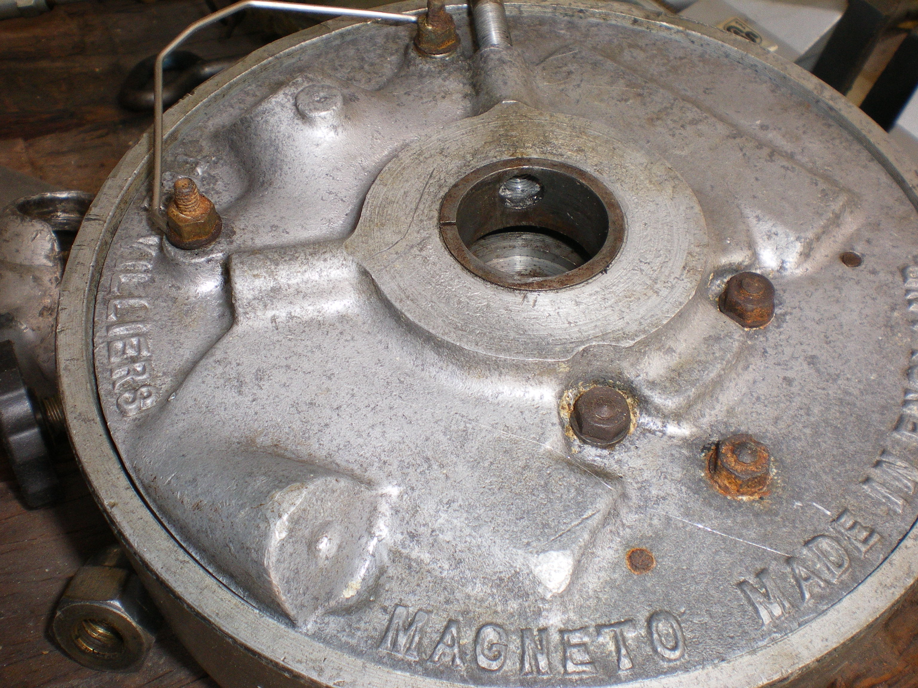

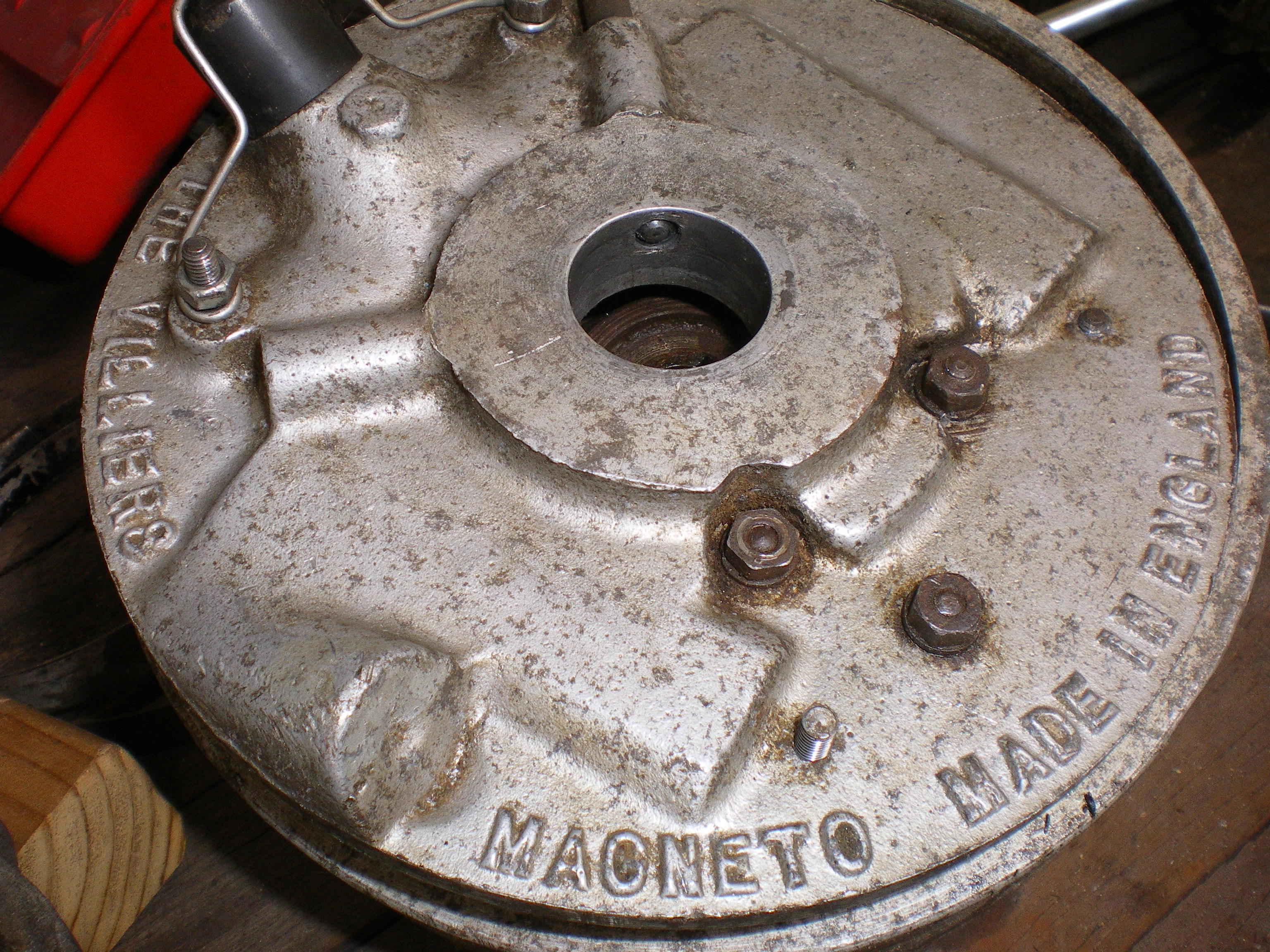

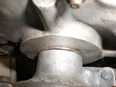

Two different JM base plates
Later JM11731 without split ring and locating screw all the way through:
Earlier JM2438 with split ring and locating screw all the way through: Dimple on SD9242 Any chance of a photo of the underside of a Marston JM mag?

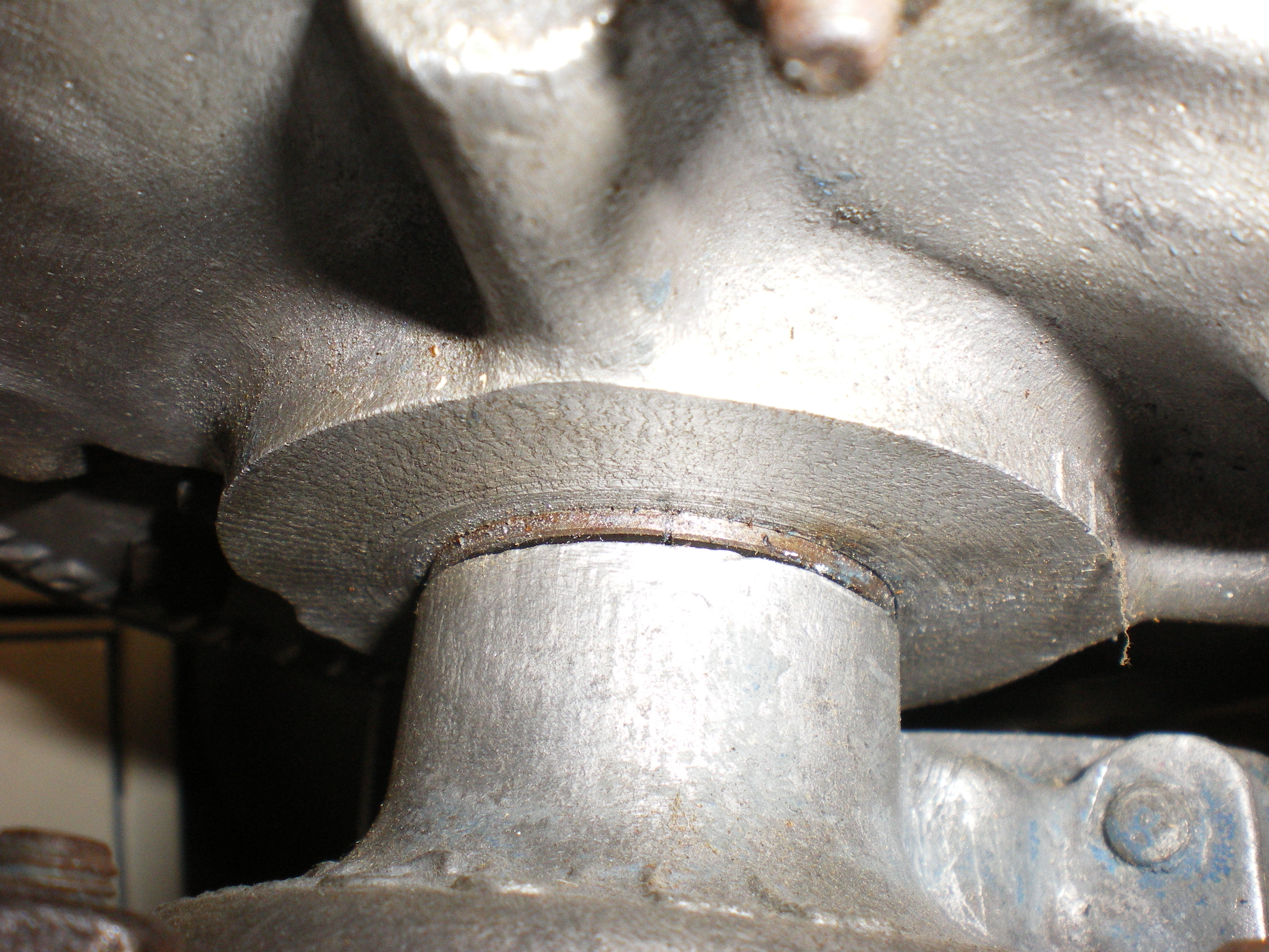

Re: Coolie ignition timing
Yes, the SD I own, and several I have sold on have had dimples in the crankcases. This could have been added later of course.

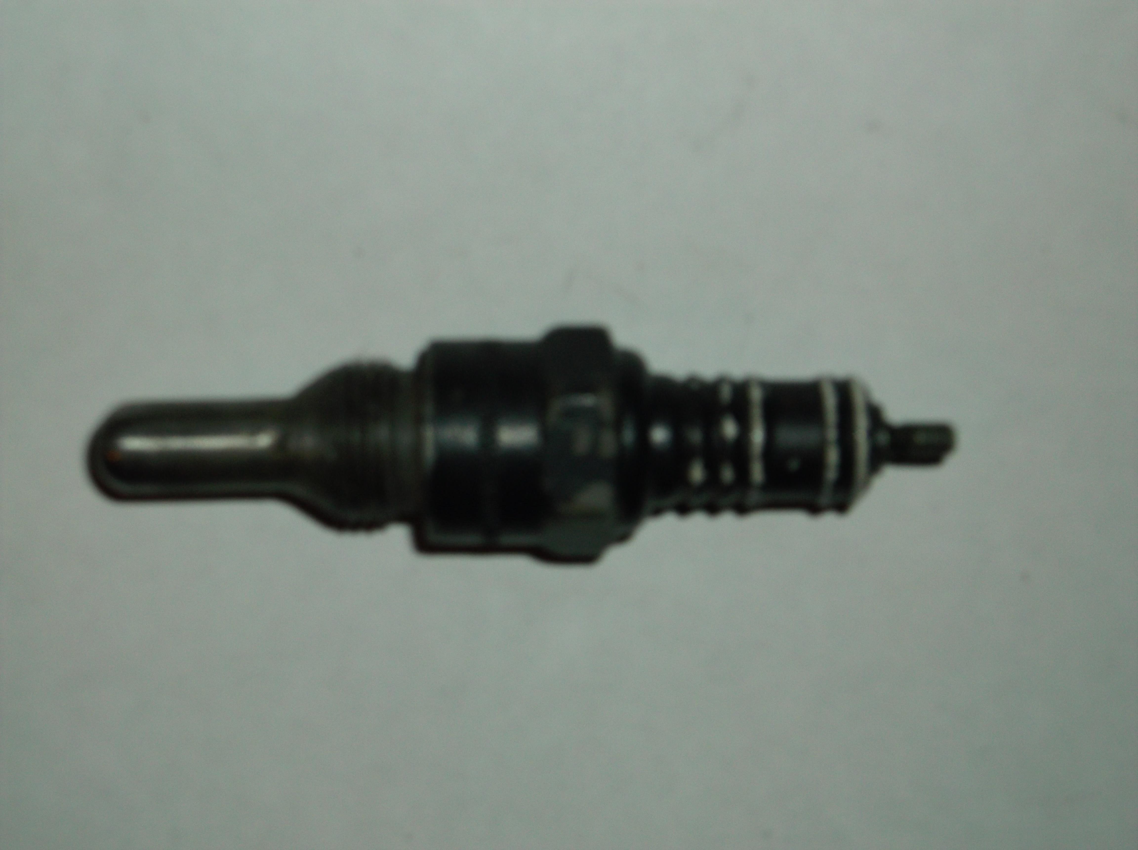

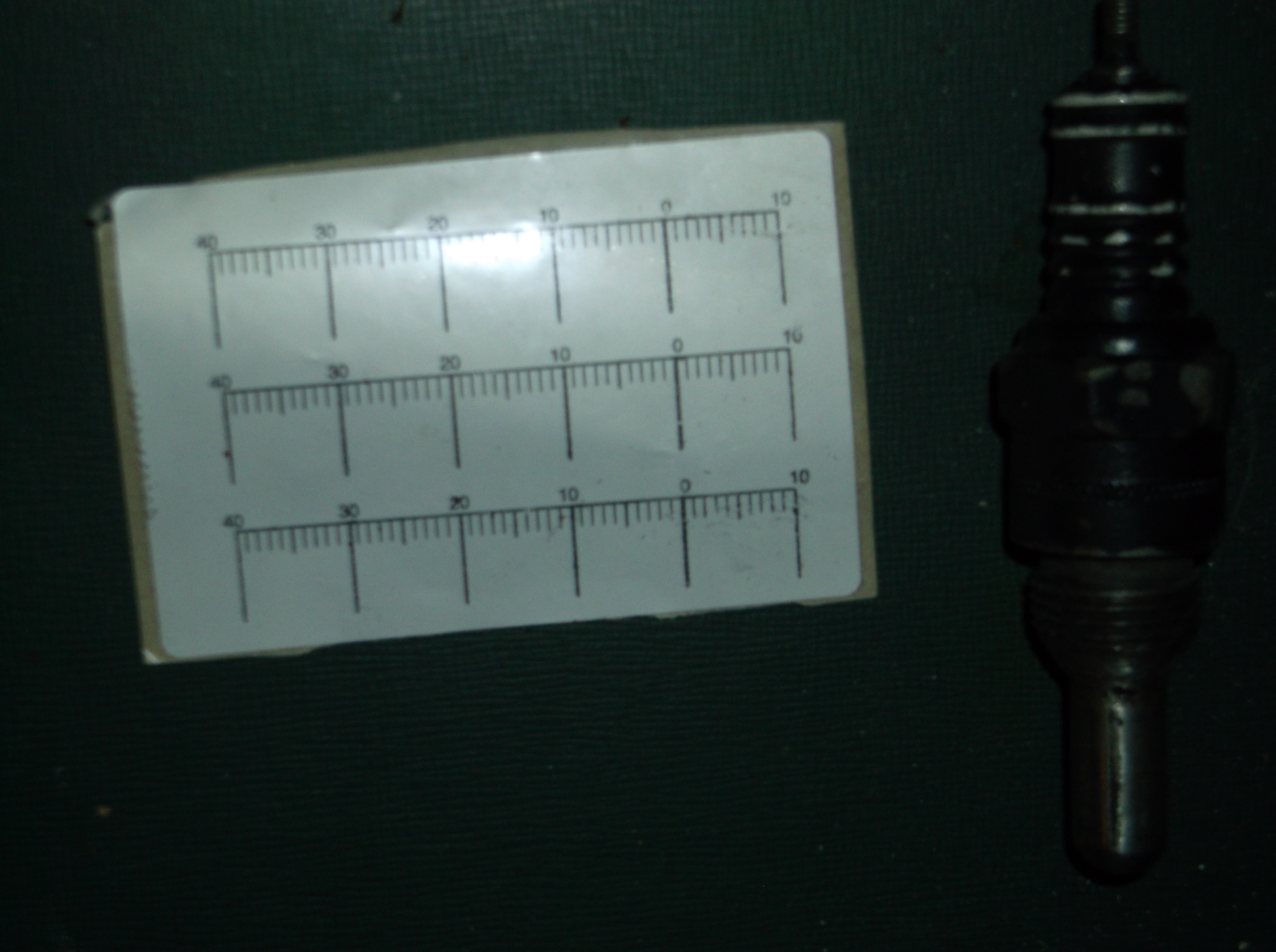

Jacob here's a picture of the 18mm sparkplug with the welded in piston stop for find TDC. & a CDI timing label.
The sparkplug also work as protection for the plug hole when painting cylinders.
As it's so difficult because of the flywheel shape to affix a 360 degree protractor to the Coolie/JM flywheel, the masking tape method is the cheapest accurate method, certainly well within your ability, let me know what figure you arrive at.

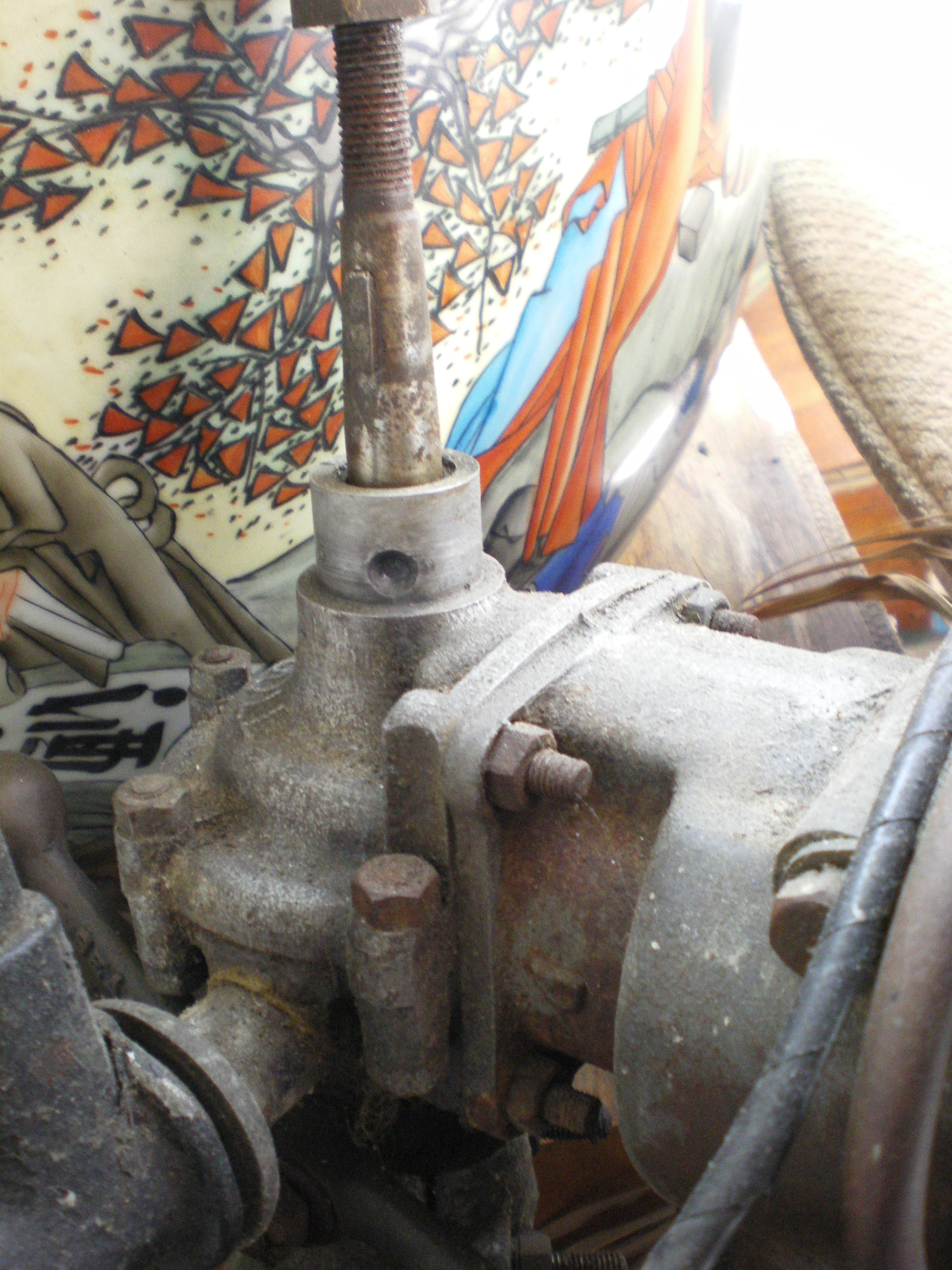

I note on my SD125 the split ring on the base plate is visible without removing magneto. If you guys can look at yours in your own good time it would be appreciated.
