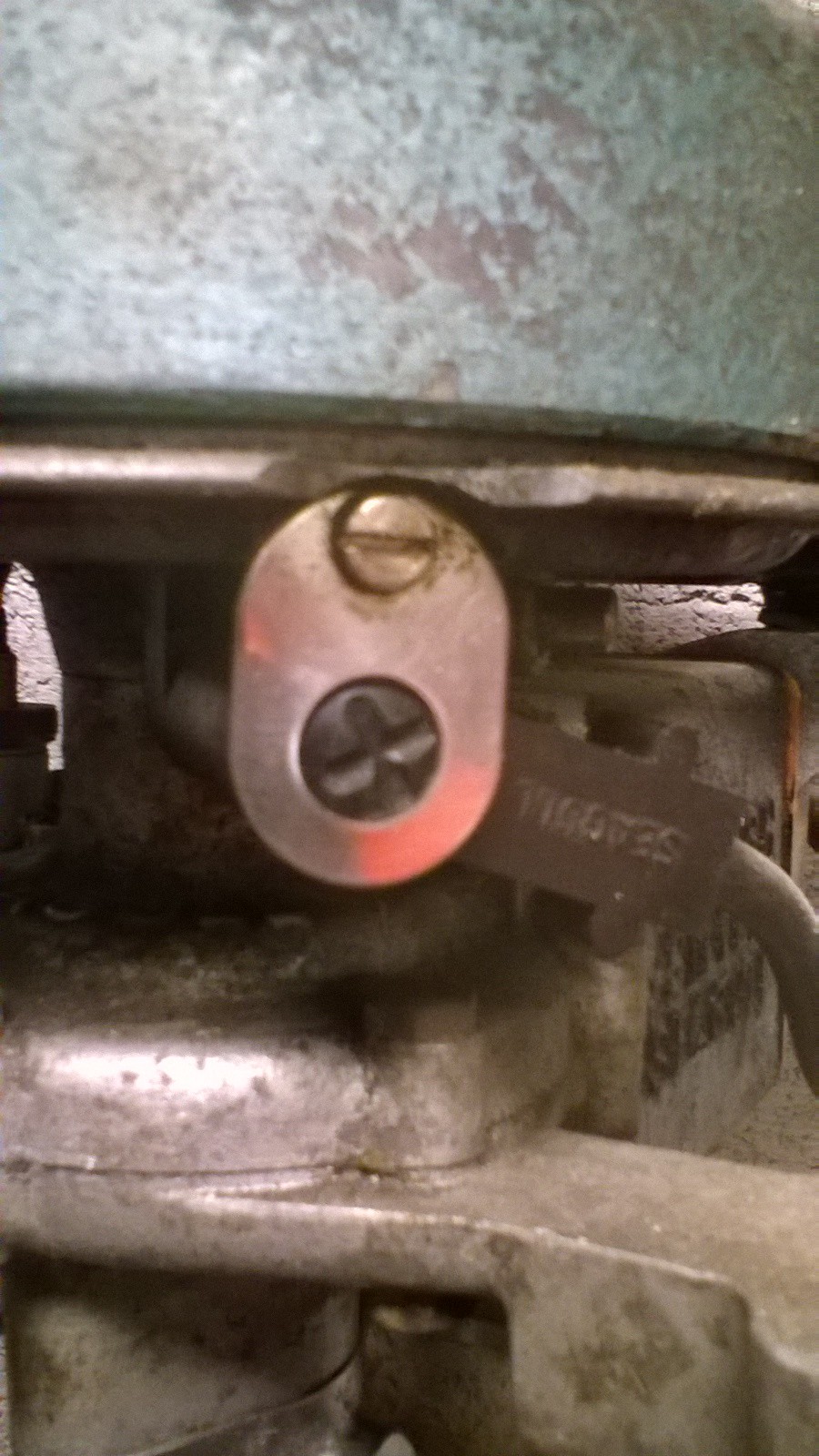

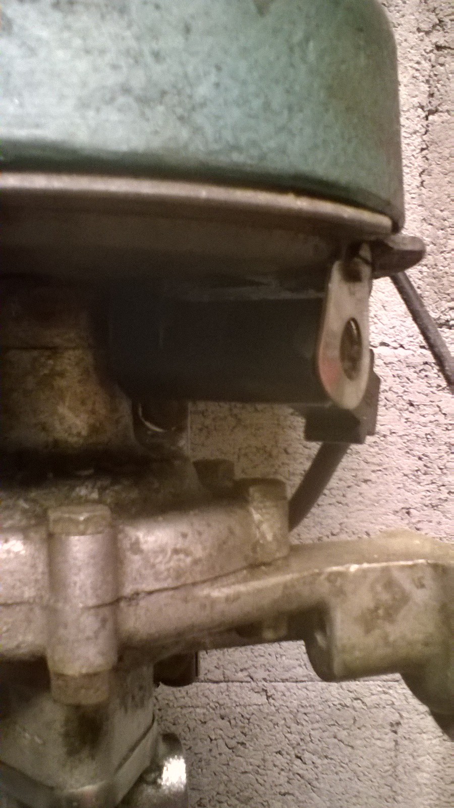

Hi all.my newly acquired seagull is a century 100 model,engine No.. LLS 29111.its had a big rudder fin made and flitted by the previous owner but that looks like the only mod at first glance (brothers reckonings) but where the ht lead plugs into the stator is a Very Loose fit.he thinks there should be some sort of plate? for the spring on the iead to butt against???.transom Mount is missing along with the hight collar also needs a plug and cap (no probs) but is in reasonable condition generally. No pics yet as I'm still on my boat and gull is on land.so my collection is now 2 gulls (40+..century). As soon as I can get ashore ile post some pics but in the mean time if anyone can shed some light on the ht lead connection system i would be very grateful. Cheers for reading..byeee

These pictures may be of some use to you.hairyjim wrote:Hi all.my newly acquired seagull is a century 100 model,engine No.. LLS 29111.where the ht lead plugs into the stator is a Very Loose fit.he thinks there should be some sort of plate? for the spring on the iead to butt against???.
...but in the mean time if anyone can shed some light on the ht lead connection system i would be very grateful. Cheers for reading..byeee

Quite possibly, I didn't look up the engine code before I posted the pictures...Keith.P wrote:Would it not have a Villiers ignition, Manufacture Date: 1961 to 1962.
I was just posting the pictures to show the missing "plate", so does the Villiers ignition have a "plate"?

http://www.saving-old-seagulls.co.uk/i_ ... series.htm
Here is a picture from SOS main site, showing century with villiers ignition, with lead held in place with steel wire.
Re: New member
There are grooves in the bakelite plug that the wire springy thingo locates onto.
