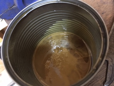

I just used a weetabix box for that gasket! I did also use sealant though.
The clutch dog is steel and what i meant is that the steel crown wheel and the steel clutch dog rusted together.
You are definitely right that it leaks because after 5 mins running time the new oil looks horrid!
It also looks like somebody has poorly tried to fix the problem as a home made copper pipe collar was round the bottom of the drive shaft.
