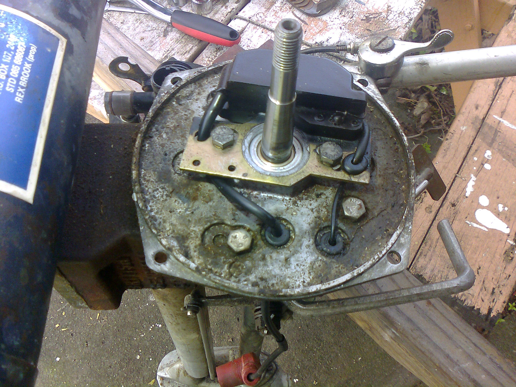

Looking at the brown box on the base plate I can't see any markings on it, so can someone who knows about these things tell me if it is the correct CDI unit for a Model 55 - think it's meant to be a Wipac 3...?
And is it it possible to replace the HT lead on its own? It seems to be firmly fixed and not easy to remove, so am not sure how it would come off..?
And what's that extra (small) wire coming out of the other side of the CDI that seems to terminate in a red female plug fitting. Could that be meant to go to a kill switch..?? [Which I wasn't aware any Seagull's had, so is it an "aftermarket" CDI unit or what's the story..?]

Wipac Mk4 CDI, standard fitting on yours.
Your right that is the kill switch wire (earth to stop) this could be the problem, if you can cut off cleanly right next to where is soldered, you will remove the possibility of it shorting.
The HT lead is not replaceable on the Mk4 only possible on the Mk3, CDI's suffer the problems of all modern electrics, they either work perfect or don't, & are not repairable, I believe John Williams has new ones in stock.
