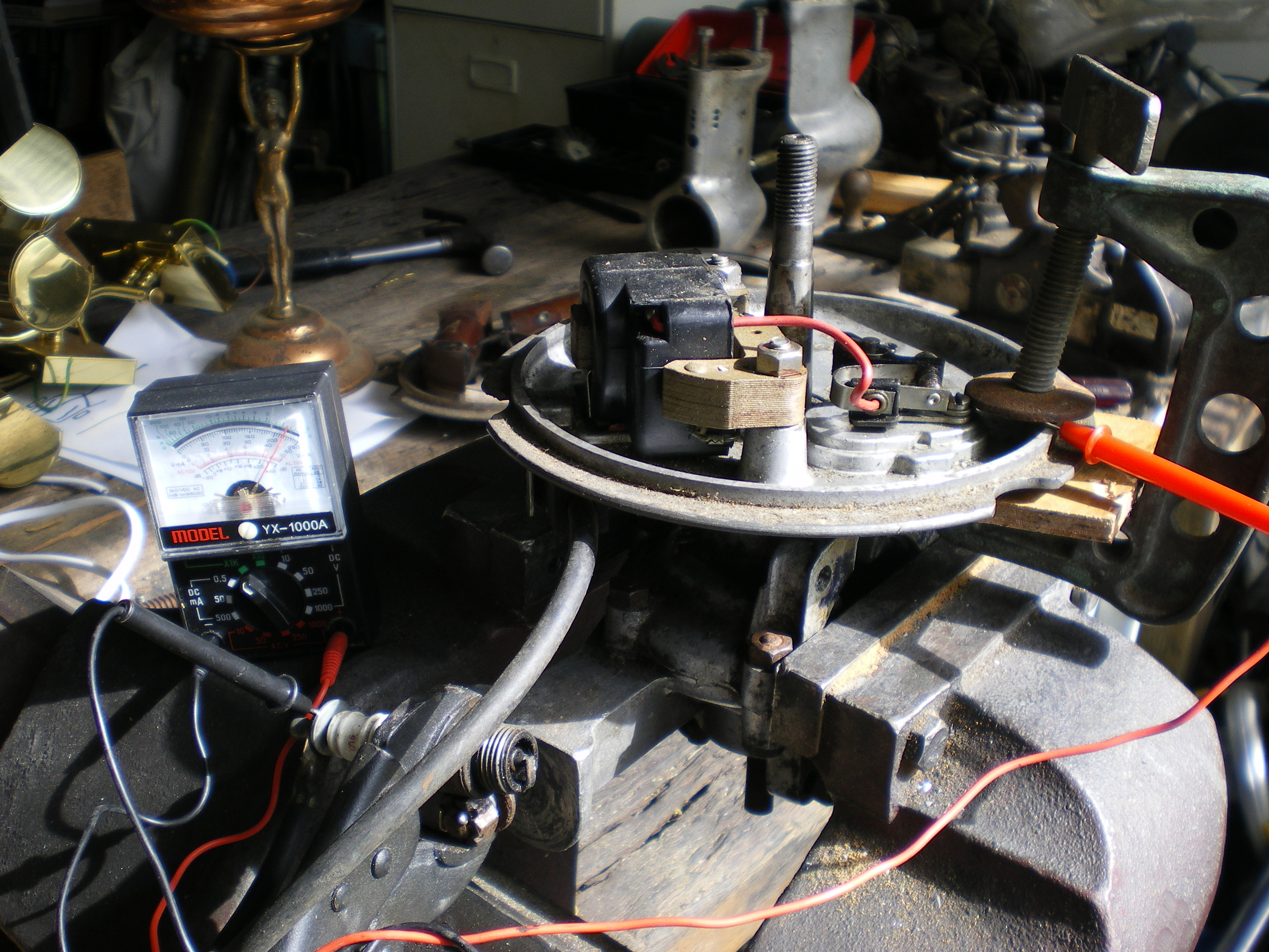

Would be worth putting a meter on the secondary winding. Base of magneto connection (or end of lead if good) to earth. This fully functioning wipac returned a reading of .9 ohms. From the red wire to earth is a dead short as the primary windings are a lot less and bigger wires creating a very low resistance. I need a fluke!!

Hopefully almost got to the source of the problem. Have done a continuity check as suggested by Hugz and the lowest reading I get is 4600 ohms!!
So I'm guessing the fault is within the Wipac that I will be unable to repair. Seems strange that from picking up a running motor and a one and a half hour journey in the back of the car that it turns out like this. Or could I have done something that may have damaged it? So now not too sure what to do, do I get back to the seller and ask for a replacement Wipac ignition system? source one myself off somewhere like ebay? or does John at SOS do the parts?

Just looking back... I had an engine with a dud wipac magneto. I did the same test on the dud one then on a good one. The strange thing was I got the same reading with both??Would be worth putting a meter on the secondary winding. Base of magneto connection (or end of lead if good) to earth. This fully functioning wipac returned a reading of .9 ohms. From the red wire to earth is a dead short as the primary windings are a lot less and bigger wires creating a very low resistance. I need a fluke!!

The coil was ok then. Something else wrong with the maggy.
I think maybe an air gap in the secondary winding of Chris's one. How else can it splutter with such a high resistance?
