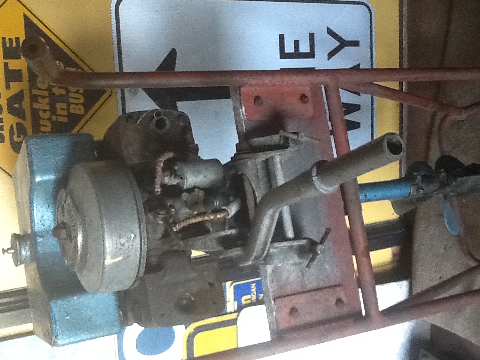

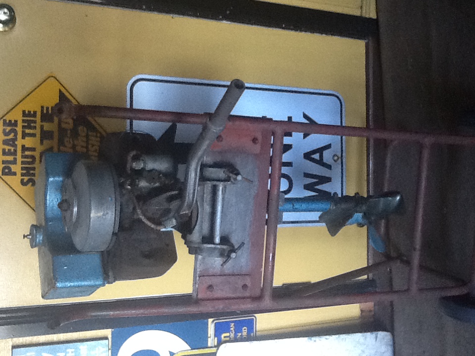

Hi All,
I have just purchased this BMB Outboard, along with a couple of others. This motor looks to be all there, except for a water pipe and a wire spring thing, that attaches beside the spark plug.
Can anybody advise what year and model this may be. It seems to be pre 1948 , going by pictures I have seen.
Thanks.
PS, not sure why the pics are laying down. maybe they are tired, like their owner lol

Nice engines the BMB. What you have there is what I think of the middle model, introduced aprox mid 1930s. The lightwin came first around 1930 ish or even the very late 1920s. The model you have used a comon powerhead shared between outboard, inboard (Wirt gearbox drive) and an outboard/inboard called a midi.
These do show up on ebay here a few times per year. Hard to find parts!
You have the outboard version obviously, but the cylinders seem quite different. See attached pics. Can you take some better quality pics showing more detail?
The swordfish was introduced in the early post war period approx 1946. You can see the different tank etc. Beyond this we don't have a huge amount of hard facts.

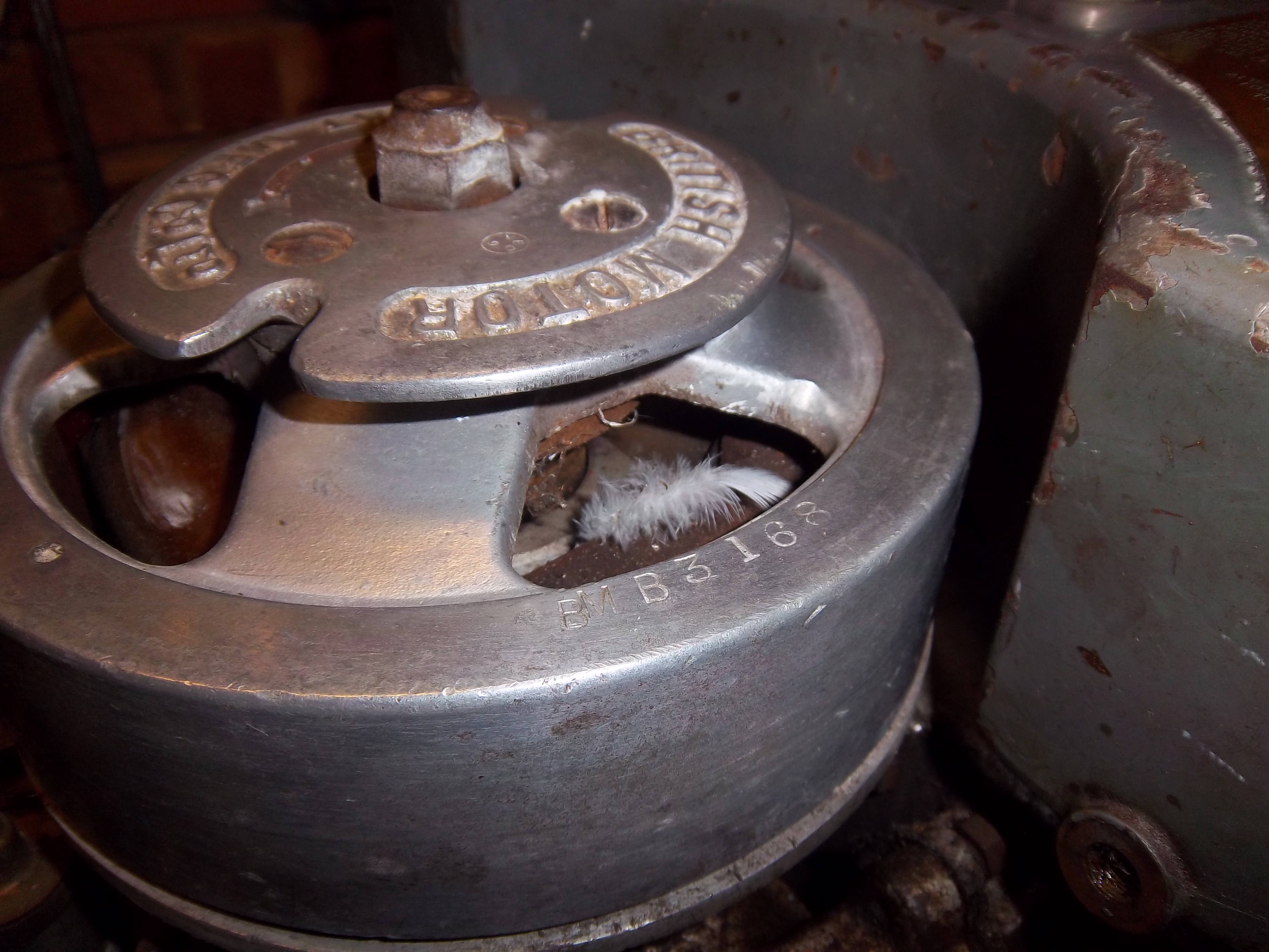

- Similar model to yours I rebuilt a few years ago

The lightwin looks like the attached photos of one of mine. It has an air cooled exhaust silencer, which is a lot simpler!
The weakness of the BMB models are the cylinder castings, which often rot out, as they don't drain very well.

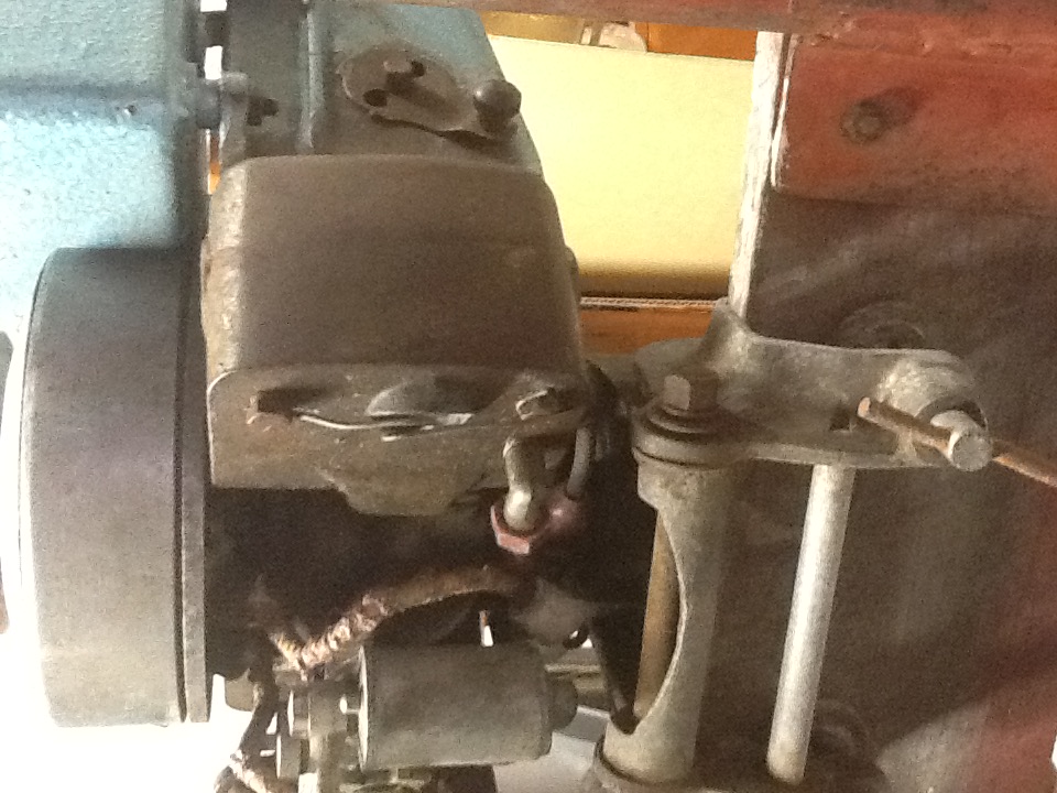

Thanks very much for the info, and pics. I have taken a few more, showing better details of the barrels.

Also interested in the carby. Is this correct for this model.? It seems odd, with the little throttle lever.

The carb is correct, but the throttle lever arrangement looks like it has come from a Middy model. You can fit the correct throttle body top which is the same as a seagull 102 and also fit a seagull throttle lever and cable. IT should fit. Correct throttle lever is the bronze amal lever as fitted to Seagull SD engines. See my pics posted above.
Whats intriguing is the cylinders and exhaust collector. I've not seen anything like that before. Fascinating

I believe the outboard that Notav8 has is actually a Britannia Ensign from the late 30's. It should have a cast aluminium cover which protects the spark plugs and carb - hence the different style of cylinders. The carb and throttle are correct as both the throttle and choke lever would protrude through the cover.
