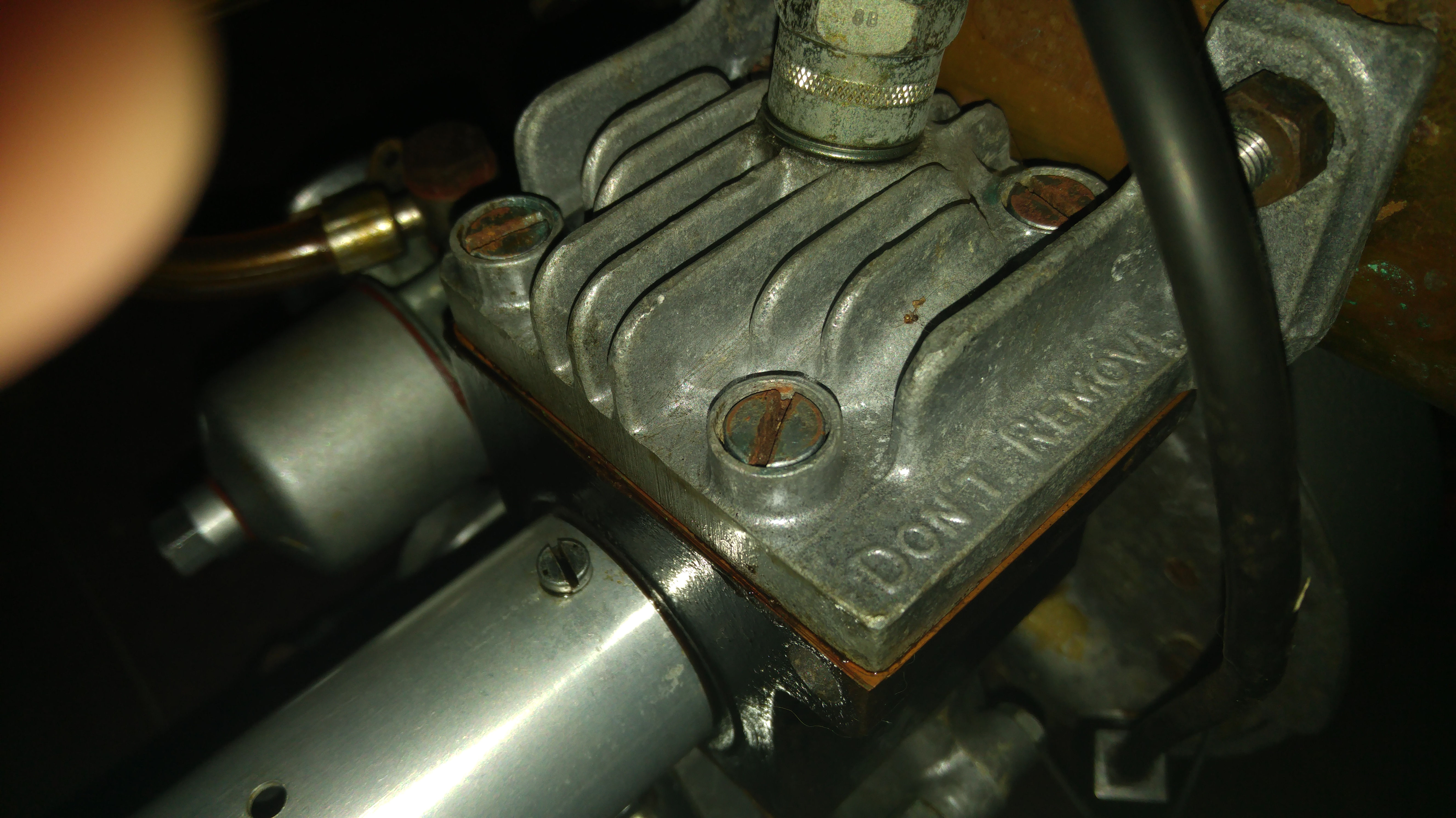

Sightly different font style on some of the DONT REMOVE heads.
Not sure whether you'd noticed.

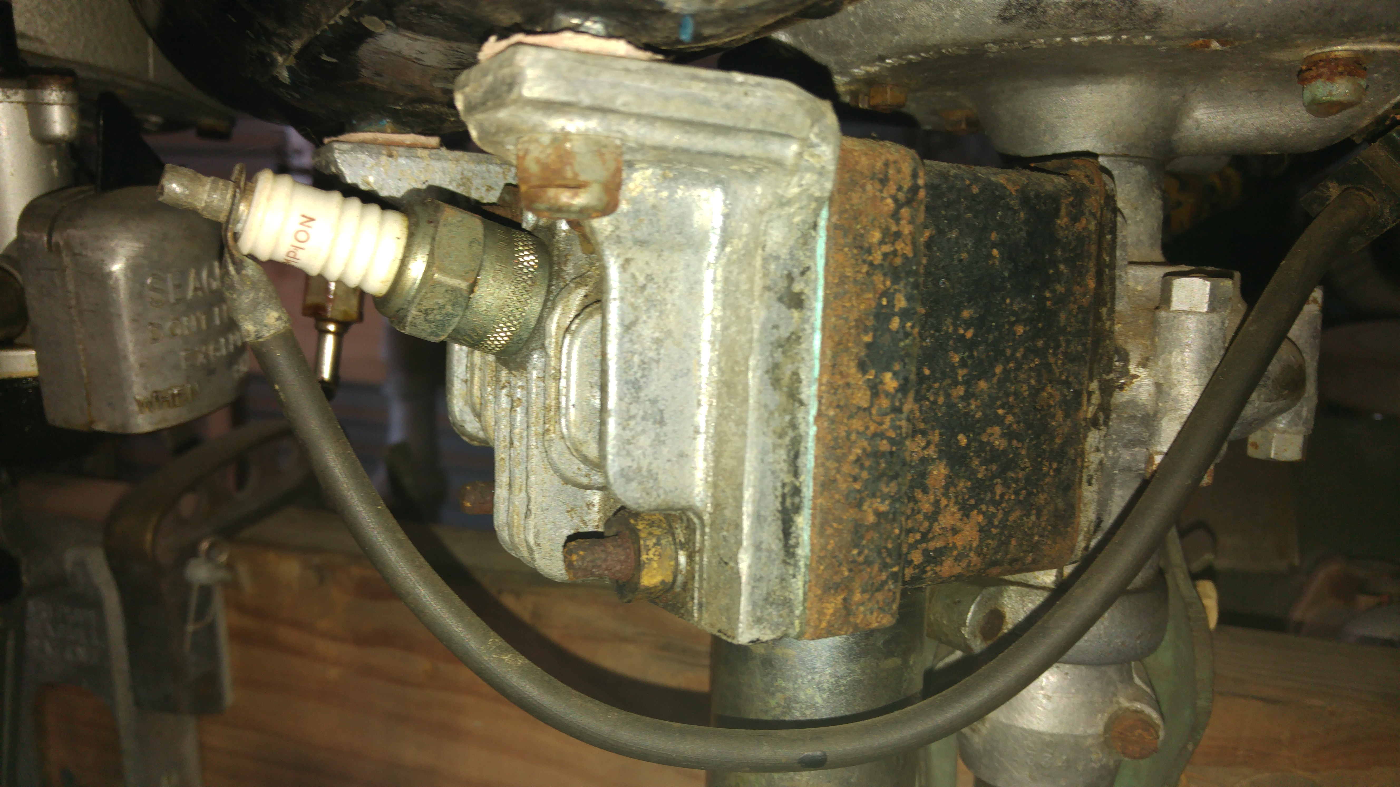

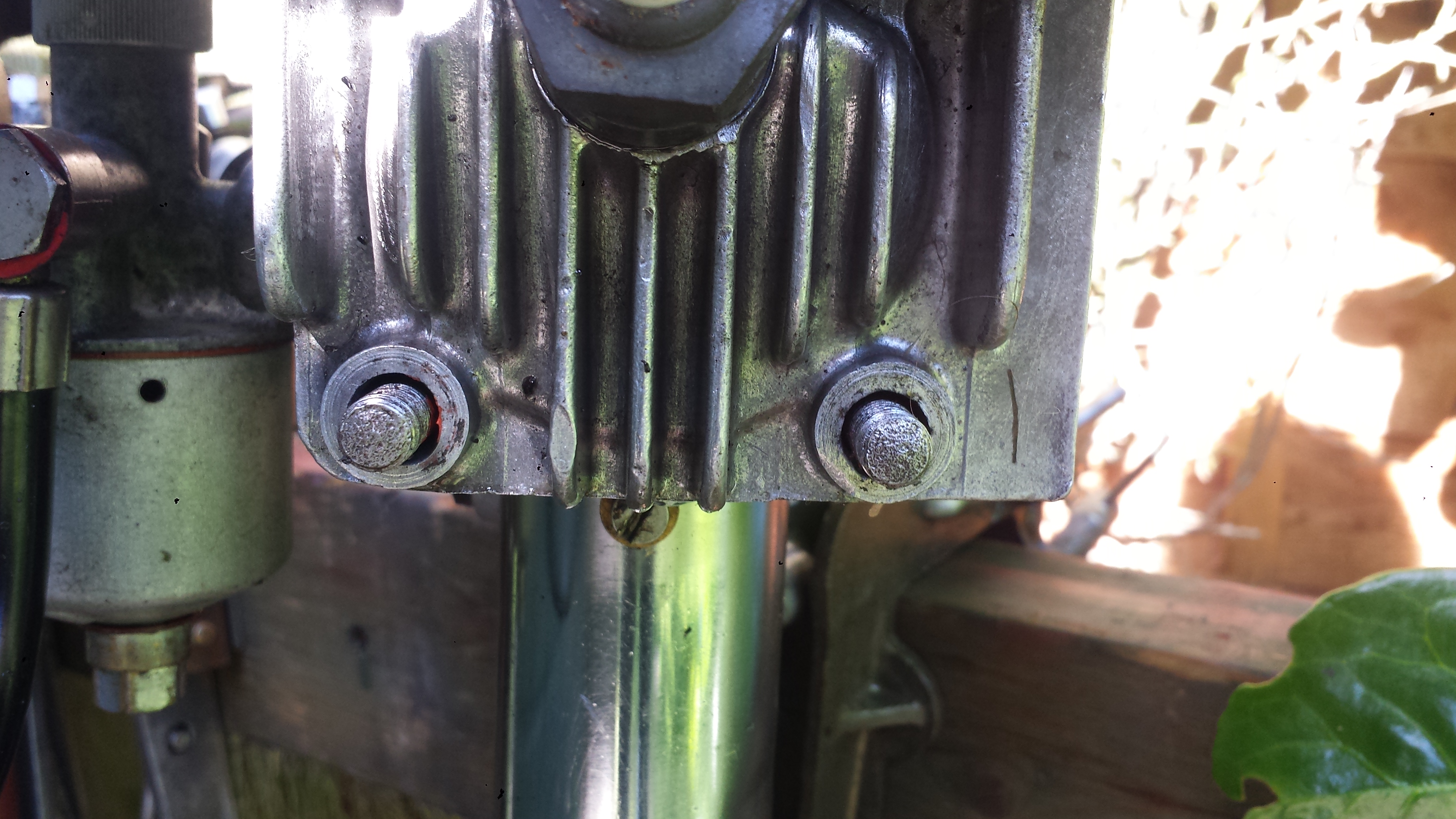

Here is a pic of the head showing studs and washers on a FLAT surface. My LS26125.
Studs and nut/washer attachment = flat surface.
Here is a pic of the head showing the encapsulated slotted fasteners. My SJM 661L5
This what I think the head is on LS25048 and I believe that the studs are over size.
It will probably come apart very nicely.

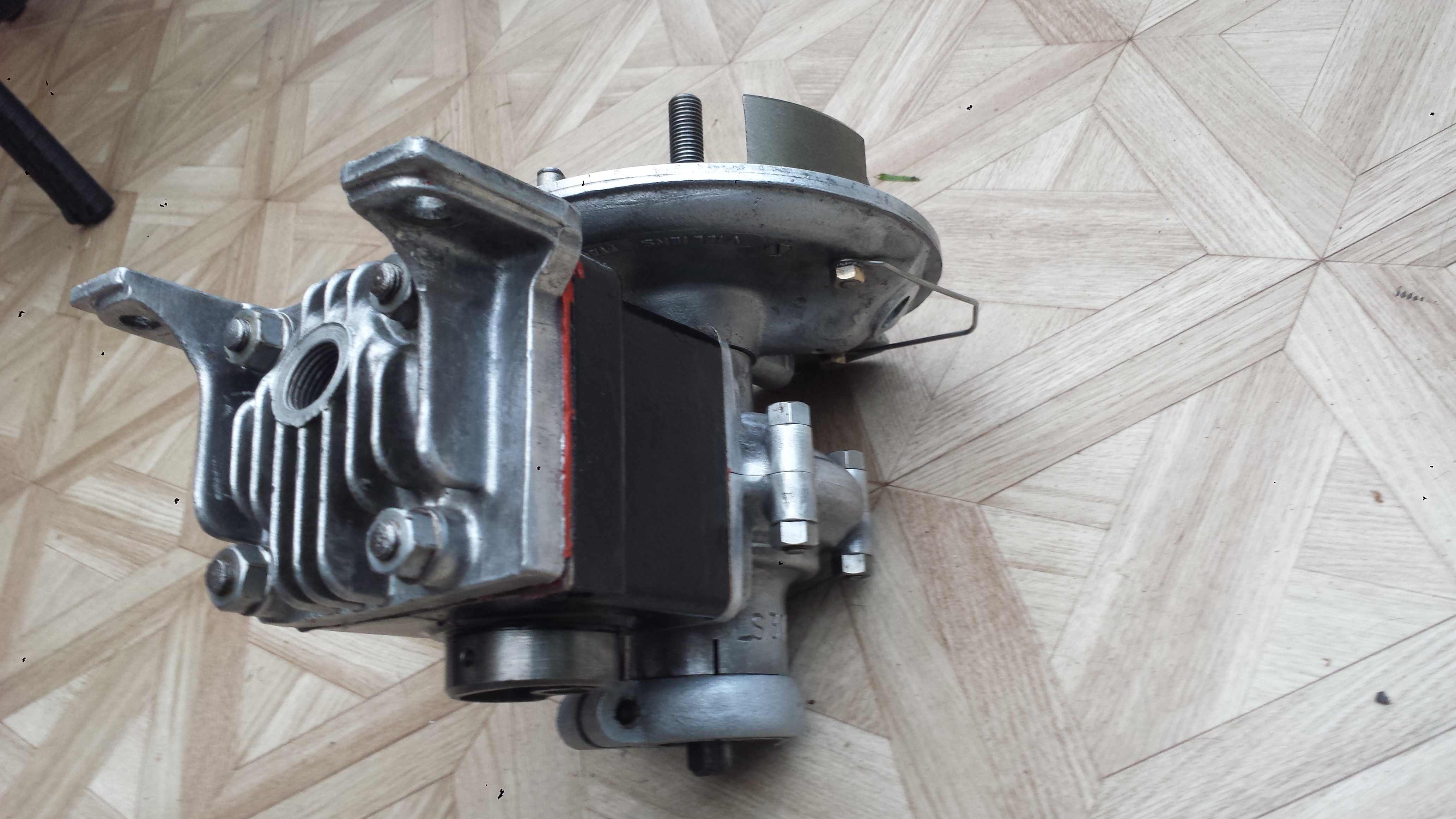

LS37902

I guess that we will never know now.............
But
Makes no mechanical sense using a nut and washer on a hollow casting.
I have said and still question the mechanical application if BS actually sold as such.
And the stud would have a different part number as obviously........it is longer just to do the job.

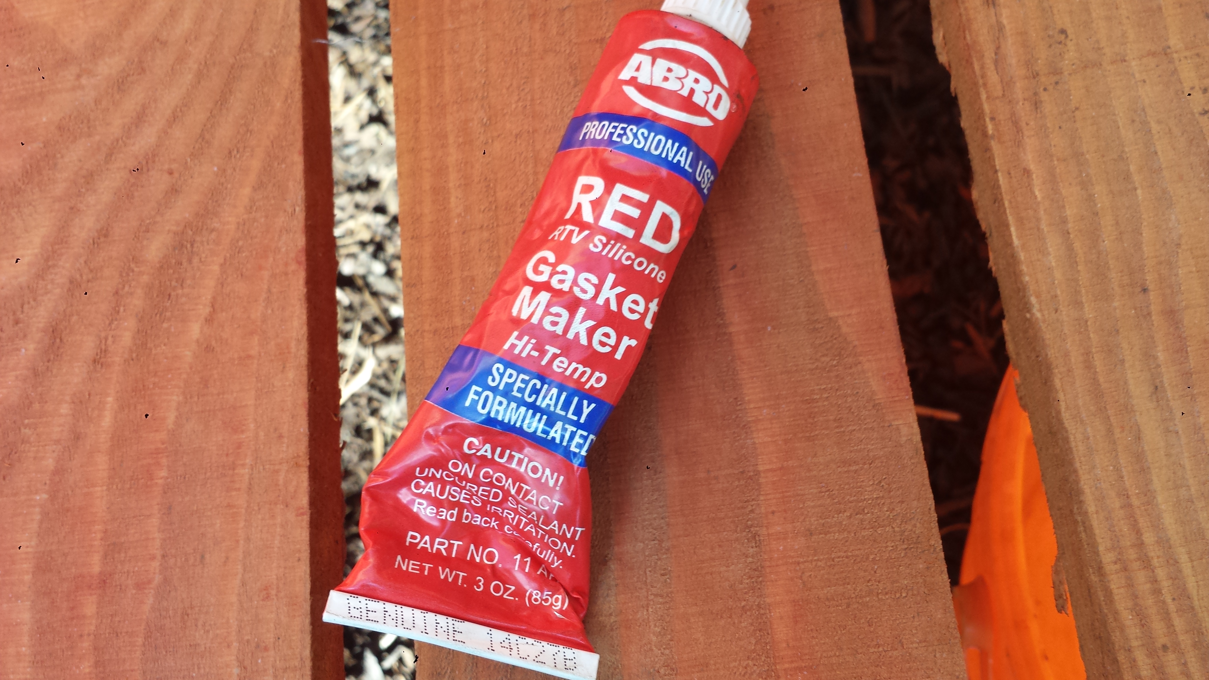

PS: What is that red stuff on the head gasket? .......that looks like it not fitting A1

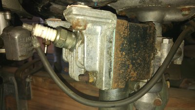

As soon as I get home I will post a lot more photos, I can't remember the "do not remove"
But I might have missed it, as you know I have very little knowledge of Seagulls but having looked at this one my first thought was that it looked like some of the nuts were newer than the head, likewise some of the bolts

Nice pics there B.
That shows perfectly the differences in head attachment between the 2 types of engines.
Tam's "old faithful" is another example of what i term make do and mend. (i hadn't noticed that until now) Not entirely correct, should work ok for a while, but as Bruce has mentioned far from an ideal situation.

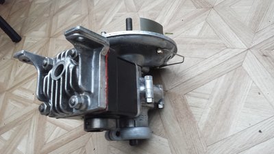

Re: Little Forty ls
Mmmmmm (not hollow)

I have never seen that raised non hollow.....................................
Over to others from here-on methinks!
Very Interesting and thanks for that Tam.

Only ever seen Hollow heads on SJMS which makes me think that old faithful is spot on and that flyguys LS will be exactly the same £5 to charity if I'm wrong ...

Ref head/ Studs. The non hollow raised portion is typical on all FV/FVPs that I have seen. . (The first 1200 (very very approx) are slightly different. I think that the raised area around the studs is quite correct. Exactly what happened when the LS head was introduced i am not sure, but it would be understandable if the same design (in this area) was carried forward from the FV/FVPs, which is what I expect happened. Tam's late LS37902, rather suggests that was the case.
If the wrong part (ie a head) has been fitted onto an engine, it is far far more likely to be a later, more numerous part that has been fitted, rather than an earlier, rarer part.
My money is on LS37902 having its original specification head.
