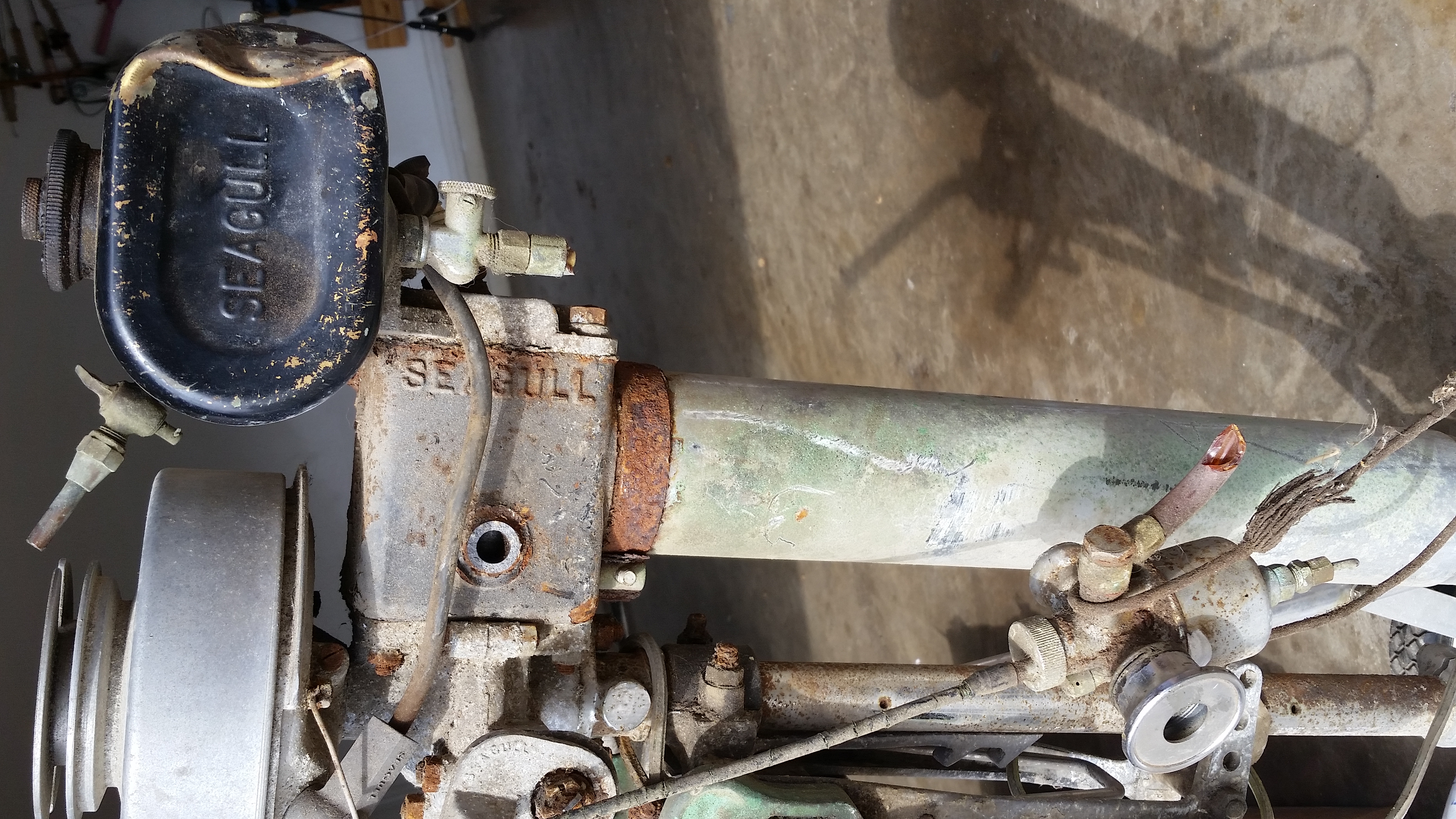

Well, to my dilemma. I purchased a 1963 Seagull LSS model 100 4hp motor. Needless to say, the UPS postal service decided it was going to try and destroy another old dear. The tank was damage pretty bad and they also damaged the powerhead. Pretty hard to do, but they did a splendid job of it. The power head portion that was damaged was where the carburetor connects to it. The rounded portion was broken clean off. What type of metal is the powerhead made of and can it be welded?

If it was mine, I would replace the block. If you are going to restore the engine, it will have to be dismantled for cleaning etc, so you will be able to decide then. Im sure it could be welded, but its unlikely to look "Factory". Century blocks are reasonably easy to find.

The cheapest fix would be to take it into your local engineering workshop with the broken off bit & ask them to turn up a threaded inlet stub & ask them to drill & tap the cylinder to suit, almost invisible.

Charles' idea can possibly work, if you have a lathe maybe it might pay to try yourself...

Neat. Looks like there's an extra fuel inlet for the tank annnnd an extra pulley atop the flywheel. an alternator rig of some sort?

Charles uk wrote:The cheapest fix would be to take it into your local engineering workshop with the broken off bit & ask them to turn up a threaded inlet stub & ask them to drill & tap the cylinder to suit, almost invisible.
Charles UK, what an excellent idea! Before you responded, I was contemplating boring out the power head's nipple for the carb and sliding in a sleeve held in place with some high temp JB weld. I like your idea better.
AUSOB_COLLECTOR, good to see you here on the SOS forum! I am planning to take down the power head and evaluate the cylinder bore and look at the crank and piston. If the power head is not salvageable, then John the SOS owner will get an email from me inquiring a price for a used model 100 powerhead.
Mutineers, I know little to nothing about this motor. I got this motor on ebay, hoping to rehab and clean up the motor. UPS, decided to treat it very poorly. I noticed the fuel valve added onto the tank. It probably supplied fuel mix from a larger gravity tank for long trips. I did not think about the additional attachment on top of the flywheel as being a for alternator or generator. Cool idea !
