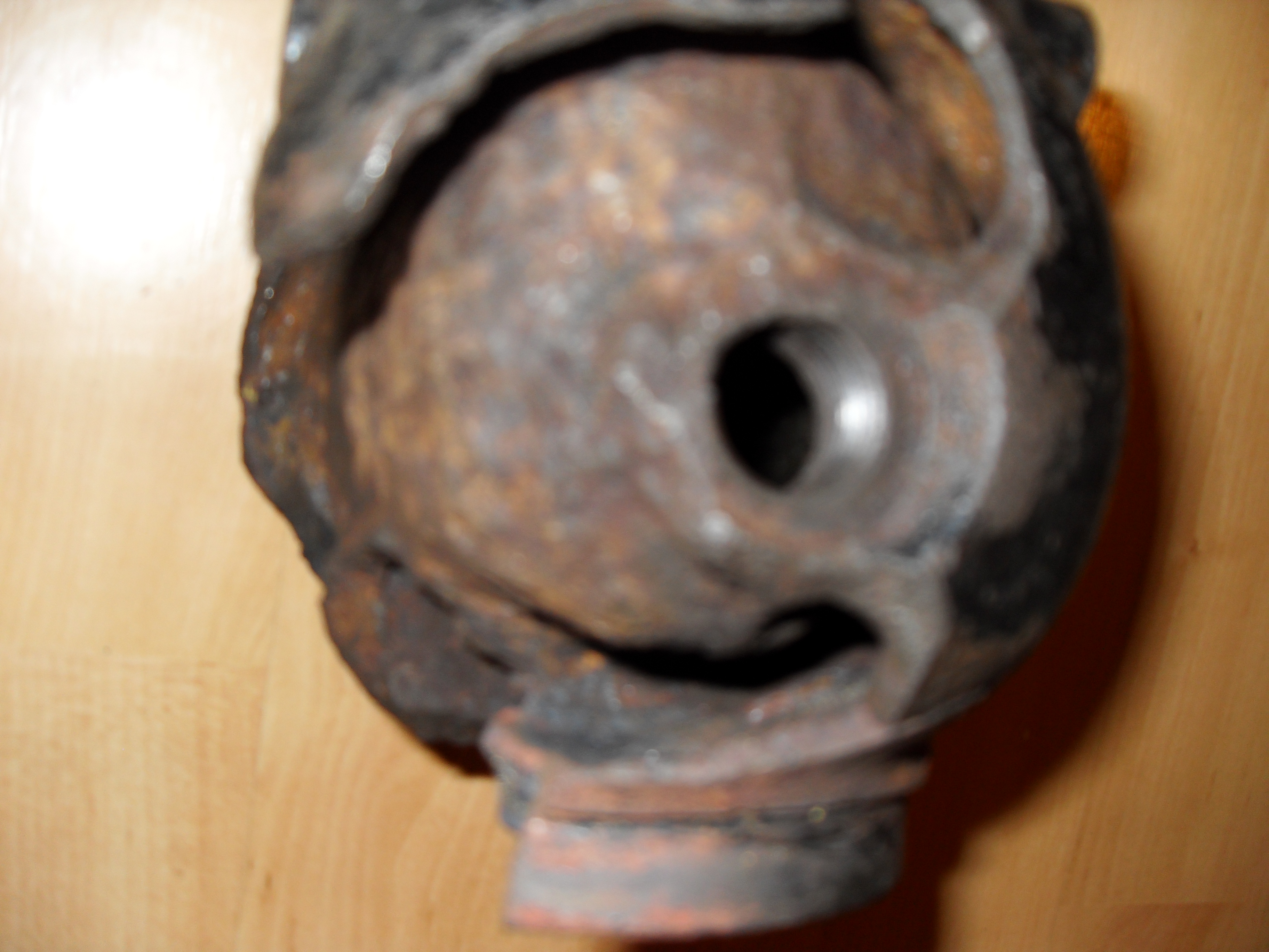

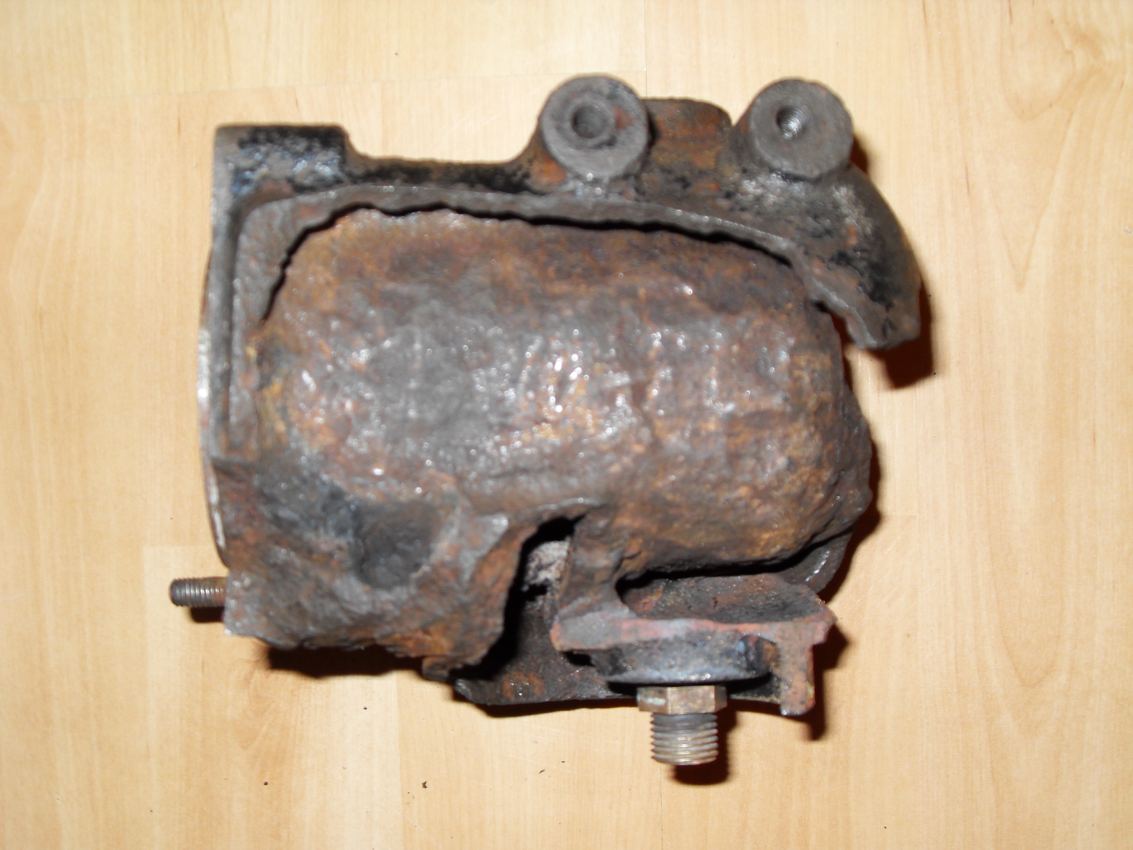

Pics below might help with where the waterjacket begins and ends. (dont worry it's just for reference purposes that i still have this)

Use the pics as a guide to help you.

I promise you, you'll be amazed at what will come out. (use the pics at the start of this topic to help you find where the waterjacket runs from and to)
