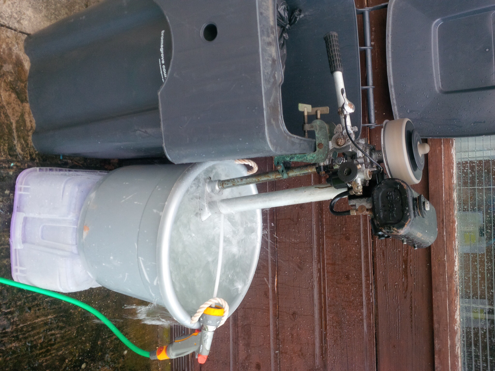

I plan to use it on a little zodiac tender that I use when my boats on a mooring to replace an overweight 4 hp 4 stroke suzuki.
Please see a picture, does it need to be deeper in the water to get the water to circulate through and out of the tell tale, didn't see anything out of the tell tale but didn't run it too long, was just relieved to hear it running again

You would need it a little deeper,halfway between the gearbox clamp and the bottom on the transom would be a good starting point, try running it in the wheelie bin.
If you still don't get any water running, flush the water ways out with your hose, at the cylinder head end.
Its nice to see it come back home, so any help you need to keep her running, just ask in the forum and someone will point you in the right direction.

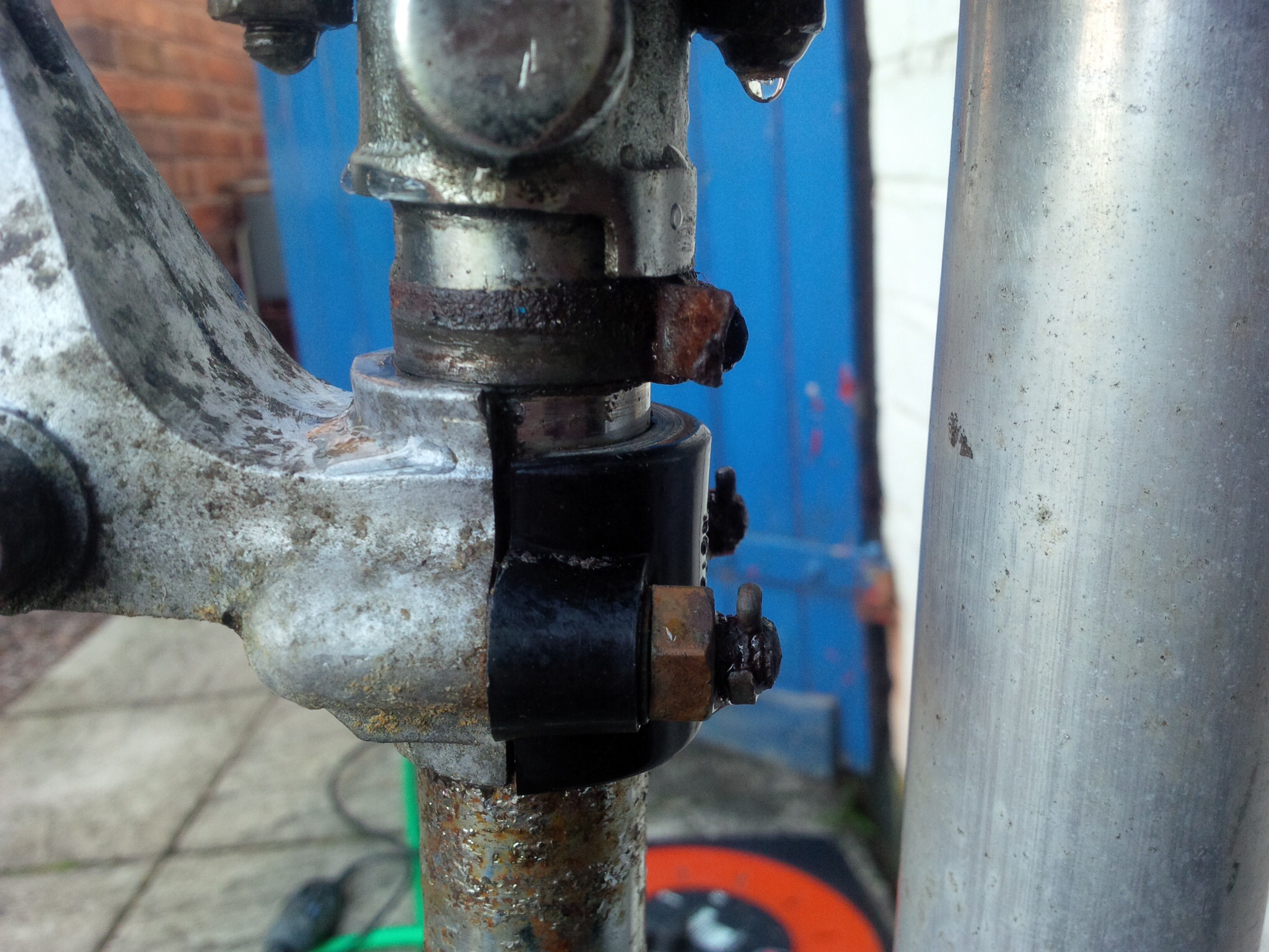

Does this also look right, I wonder if my dad or previous owner added this jubilee clip to offer a higher mounting, cant see any other reason?, is this a popular mod, I am tempted to check it on the transom and if need be remove.
Any ideas anyone, thanks for reading

Its either for a little more high or, which is more likely, to increase the angle the motor will turn.

Thanks for the advice, filled the wheelie bin quite high, removed the prop and weed remnants! from behind the prop and had the forty plus running sweet in the wheelie bin, pumping water spritely through the port.Keith.P wrote:You would need it a little deeper,halfway between the gearbox clamp and the bottom on the transom would be a good starting point, try running it in the wheelie bin.
Really pleased, can't wait to use it now.
