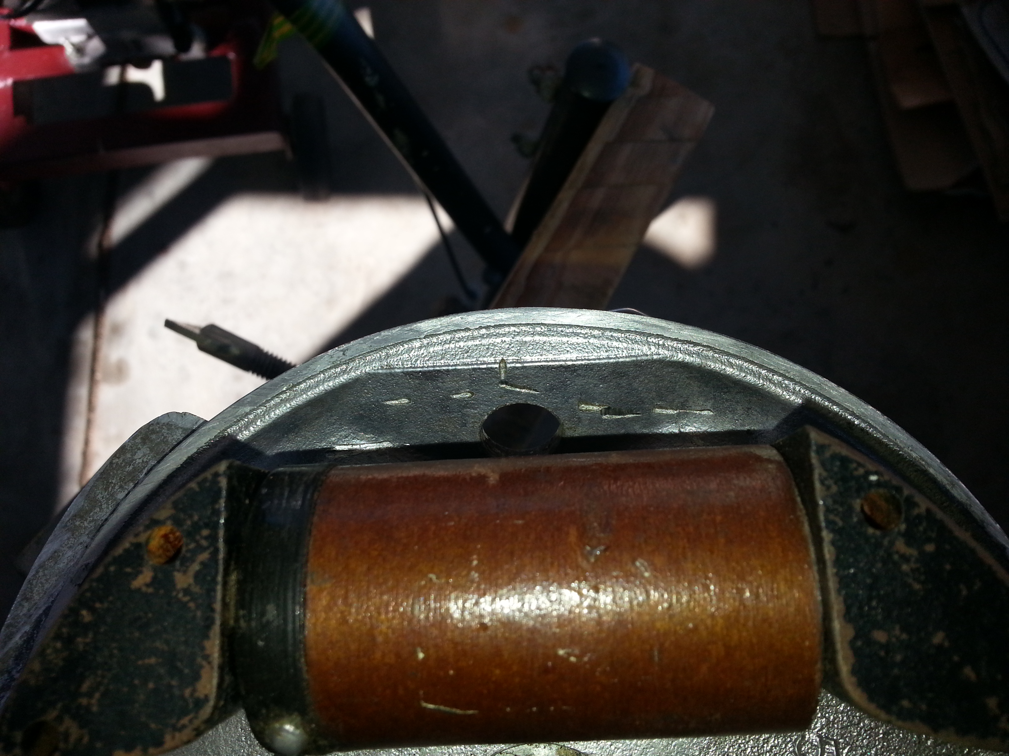

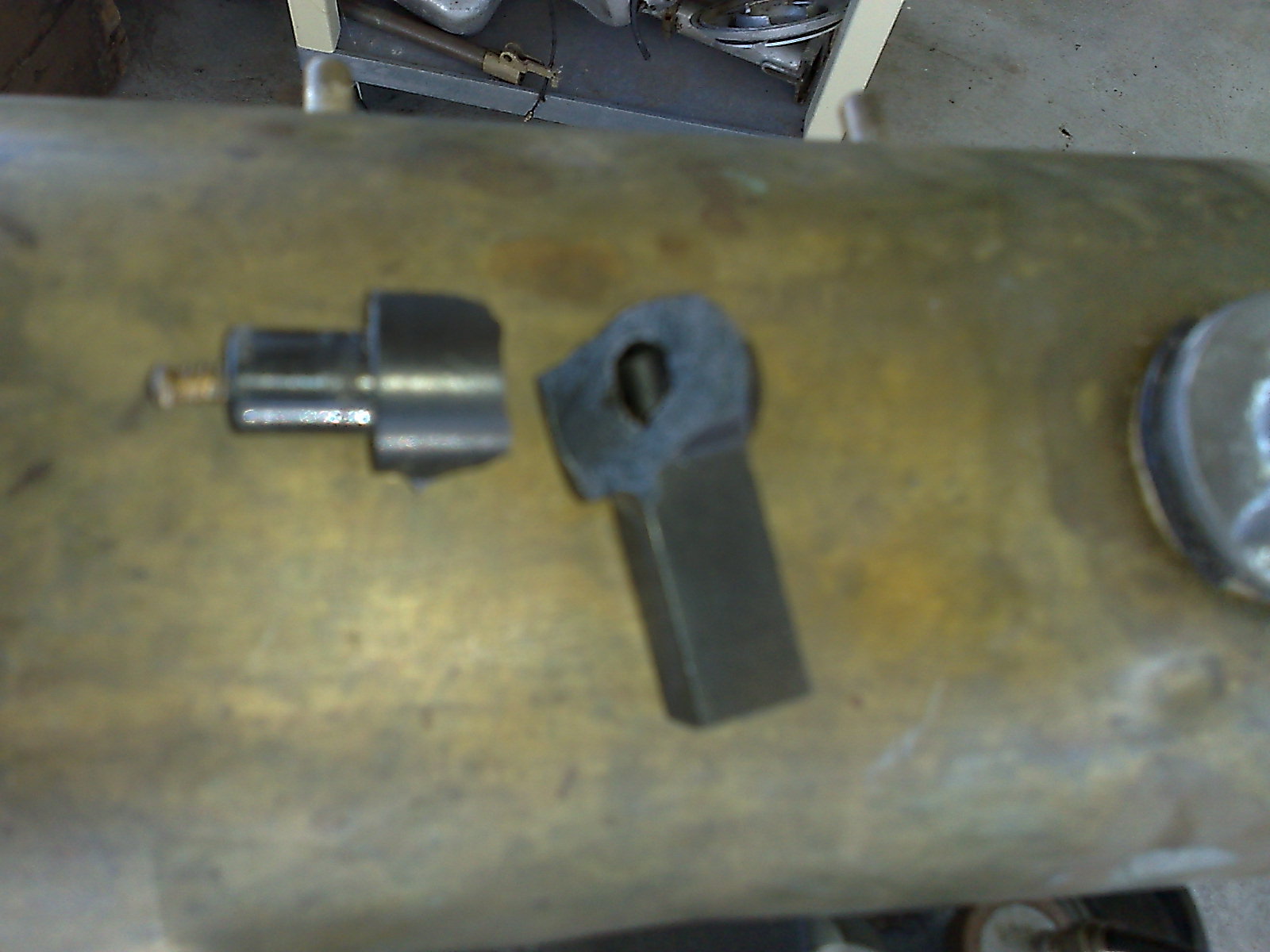

Direct hit flywheel and the most delicate of casting around coil pickup area go figure that................I am sure the Old Sod did this just to wake me up aye!
Flywheel did not turn at all when I picked it up..........I thought the worst. Locked solid.
Pics below. Sorted today Monday...........................had a day off from work just to sort this. How could anyone NOT have a Butchers Hook!
I applied some gentle screwdriver via hammer adjustments, another flywheel and some by hand file work all good. Crankshaft is OK..................an hour setting up a mag base and dial indicator on coil plate...... 8)

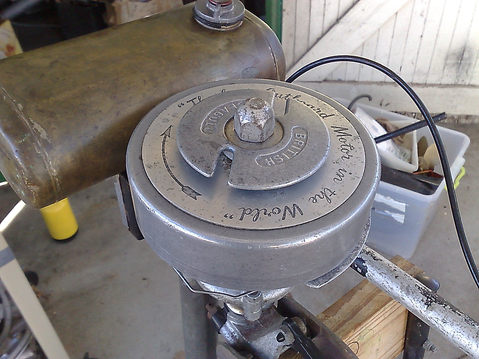

The repair is neat and tidy. It now has a 1960 flywheel so that will go with the replacement barrel "That is Not Correct Year".....see original post aye.
I used a "In The World" plate in the short term to give SJP2497 some confidence that I hold it in some regard after being a dick.

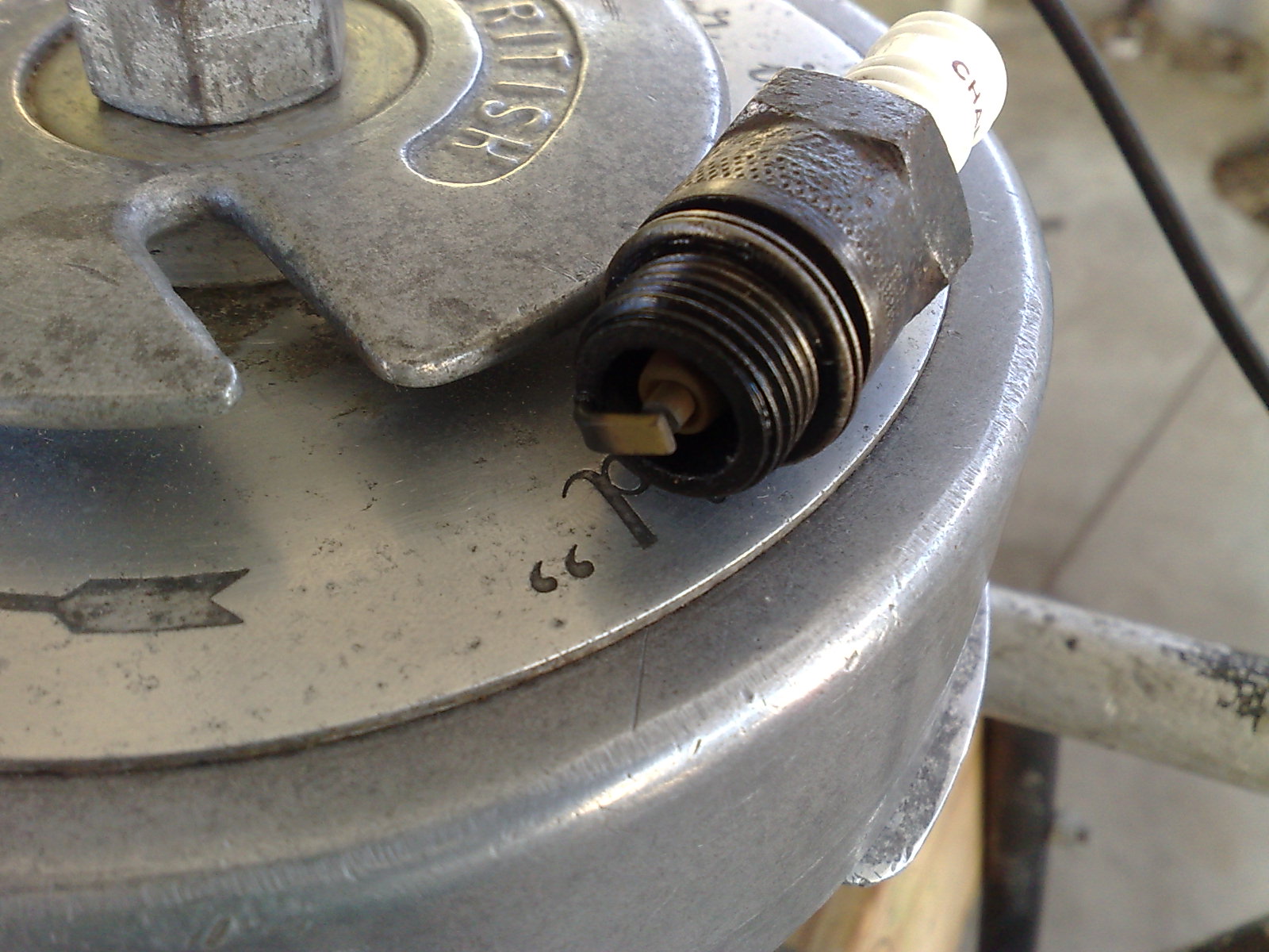

By the way......The Old Thing did run very nicely as mentioned on large boat.
Check the plug aye!
