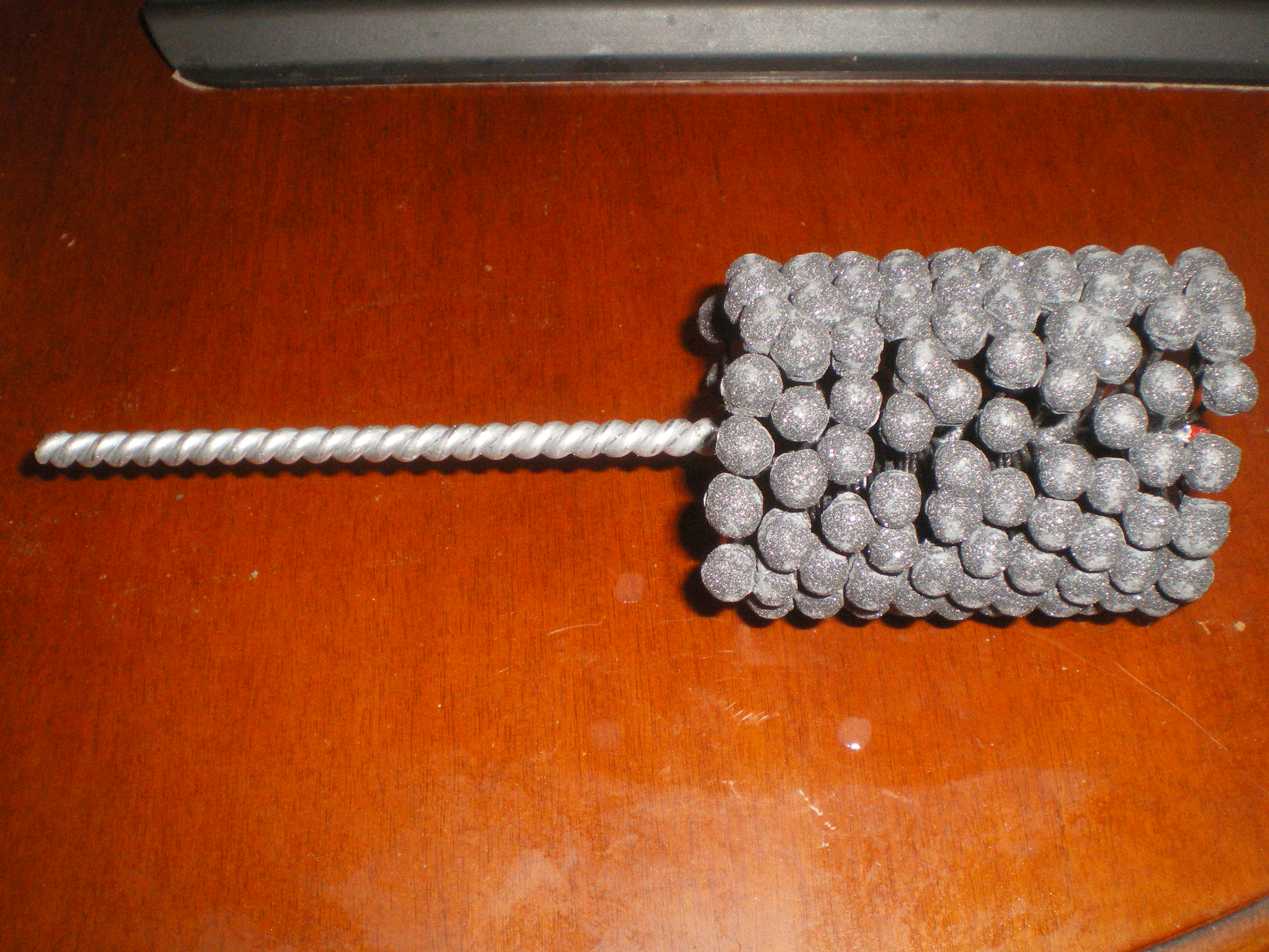

Is it worthwhile to get a silver centuary block rebored.I have one that has lay about for many years and bore is pretty rusty .I would like to save it if possible IS it worth doing.
Re: block rebore
If it is just surface rust then a honing tool will clean her up. They are relatively cheap and effective. I understand BS used then. If reboring, are oversize pistons rings available? I use a BRM (made state side) flexi-hone. 58mm/2 1/4inch. Think it cost about $40au.
