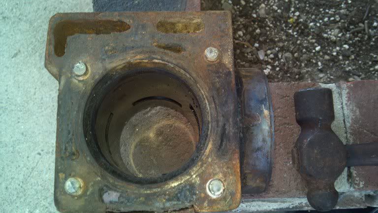

Re: Cracked Cylinder Silver Century Plus
Posted: Wed May 14, 2014 6:02 am
by Stelios_Rjk
It's a quest but it can happen! Did you check the exhaust port for cracks?
Posted: Wed May 14, 2014 1:09 pm
by Gashog
Stelios_Rjk wrote:It's a quest but it can happen! Did you check the exhaust port for cracks?
I did.
I couldn't find any cracks other then the burst water jacket.
There are casting seams that I examined very closely.
I wound up breaking the "cookie" off the cylinder, digging out all the rust, wire wheeling the cracks and brazing it all back together.
I rose budded the whole block evenly and melted a big blob of brass over everything.
I extracted the broken head bolts and chased the threads.
I "milled" the cylinder with a flat file. I'll clean it up and fill the pits with JB Weld and it will be done.
I'll cut a paper base gasket and re use the copper head gasket with shellac.
It'll run! :lol:
Posted: Wed May 14, 2014 7:15 pm
by Gashog
Stelios_Rjk wrote:It's half job without pictures! Let us see what you did, it sound most interesting!
I am not sure about shelac, would it withstand the pressure?
I was afraid you were going to ask that! :lol:
I'll post a pic later today.
I'd rather just post a video of it running to distract you from the cludged repair.
I'm actually happy with it, despite the "cold braze".
My "shellac" is actually Indian Head head gasket sealant.
It's definitely not alcohol soluble. I tried to thin it once and the alcohol just floated to the top.
Posted: Wed May 14, 2014 11:29 pm
by Gashog
See! You can barely tell! :lol:
Place your bets!
