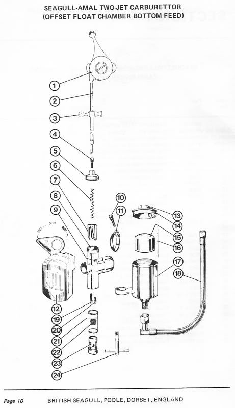

have you verified that it has the right jet for 25:1 or have you tried a 10:1 mix as I suggested.
See what charlesP says in his reply to john1952 about the effects of using the wrong mixture for the jet fitted. Agrees with what I already said I think!

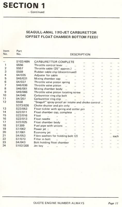

I've checked the carb and according to SOS FAQ's the number 40 indicates it's had the 25-1 conversion.

For those who may not be aware of it, the cable adjustment allows you to setup the throttle, so that the throttle body [moveable piece] in the carb is shut with the throttle all the way off. That is way the motor is intended to be shut off. Remove the storm cowl to see and adjust it.
phil
Posts: 775
Location: nova scotia, canada
Post by phil »
According to the diagram Vic supplied, I should have called it the "throttle valve piston" item#7, rather than throttle body.
