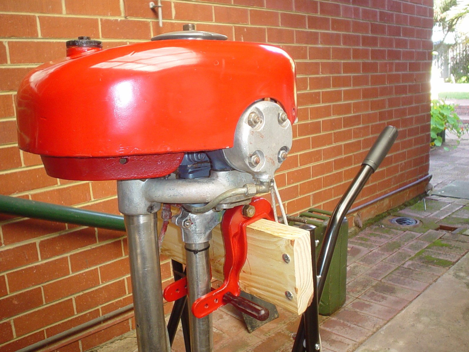

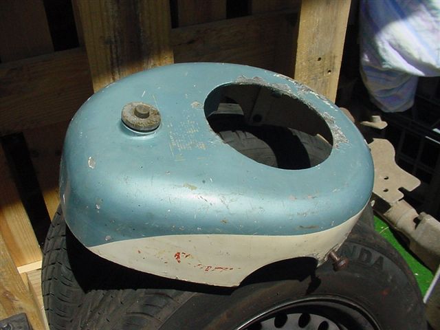

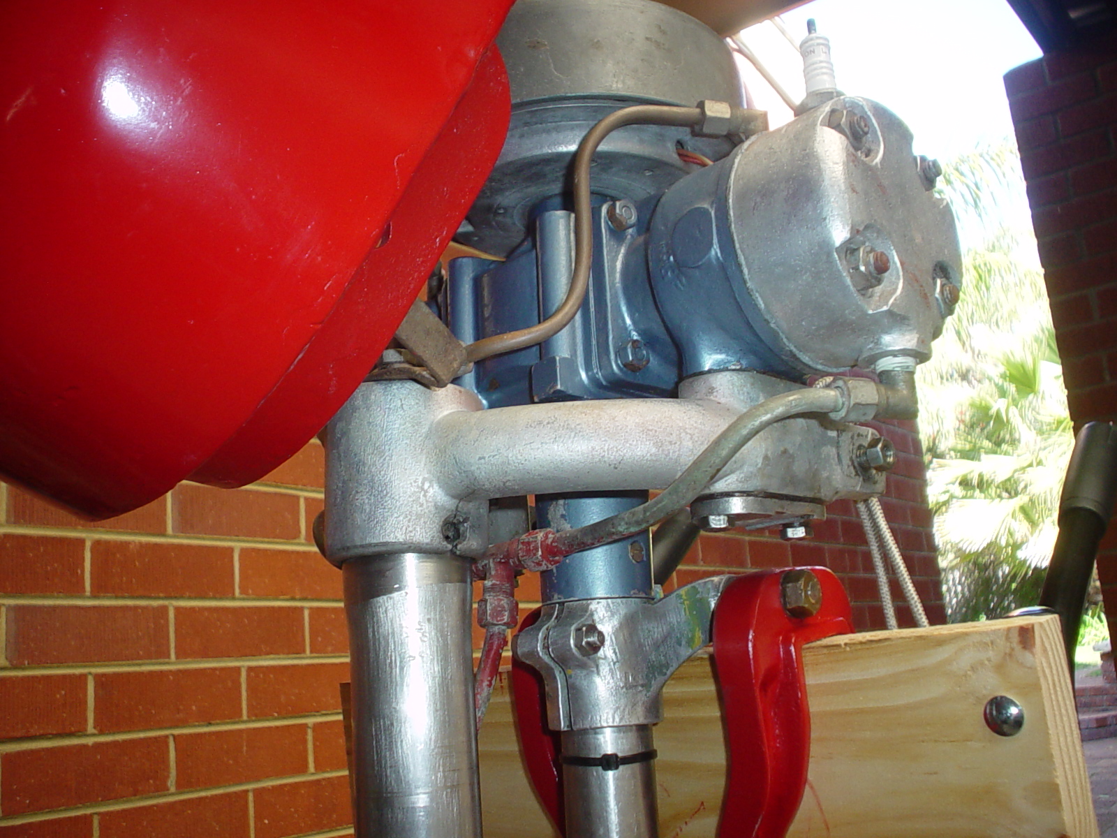

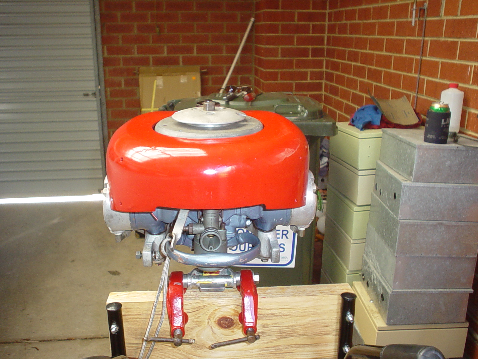

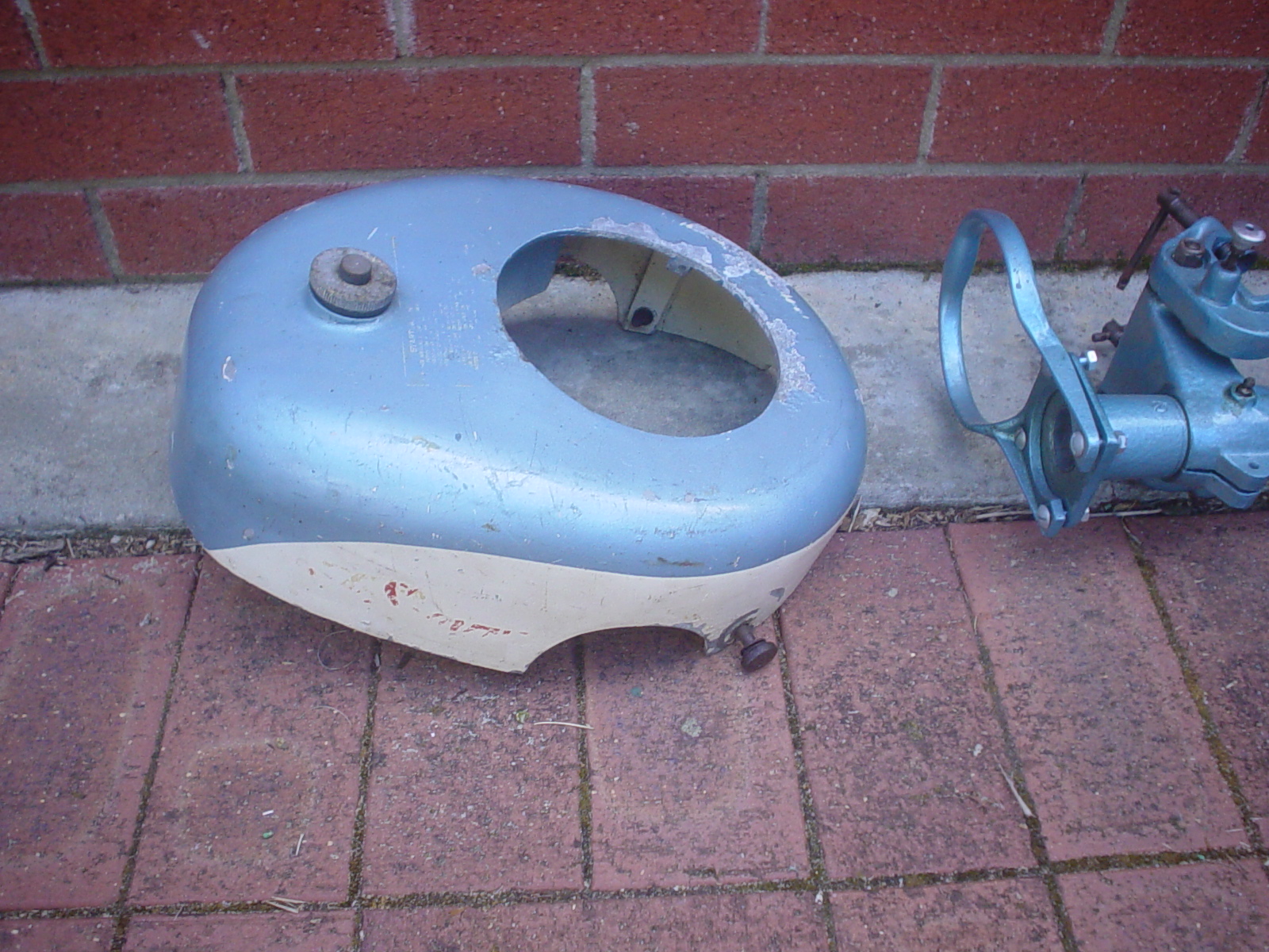

There was a Sea Scout. Here are some pics of a couple. The blue and white tank shows remains of decals of unknown year. The tanks are sand box cast aluminium supported by extra brackets and hinged at the rear. The advance lever was changed as well of course. The motors all had engine numbers starting "SS"
Carbs were S.P.C. and Amal (No idea when they changed).......
The Victa carb that you see is how I got that one. It has an Amal on it know. The blue and white one has S.P.C.
BnS[/color]

As per the pics above SS.......
While always on my radar I have not seen one mentioned or for sale since I obtained these.
2006 the red one and 2008 for the the blue one.

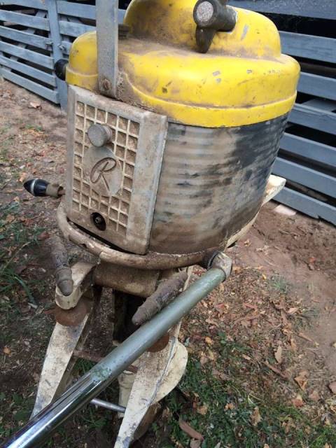

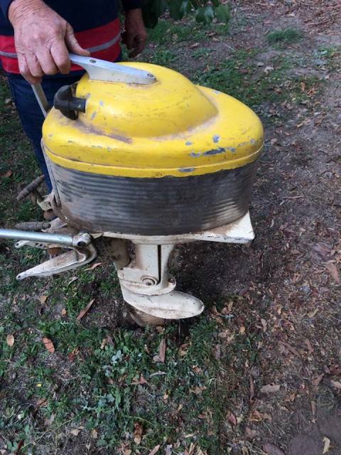

I stumbled across an image of a Riptide Sportsman on Facebook along with a request for assistance with identification. Responded to that and several days later found myself talking to the owner. He had found it under a house he had purchased some 18 months ago, and had no interest in it what so ever. As there was a chance it would end up at the local tip, I offered him fair money for it and arranged to meet at an agreed location some 300km from home.
About 10 minutes prior to arriving at the meeting place, I received a call from my brother to say that my father had passed. My plans now are to restore in memory of my father and to display it in my study.
Facebook photos

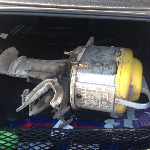

No time to inspect. Cash handed over, loaded in to the boot of the car and straight back to Melbourne.

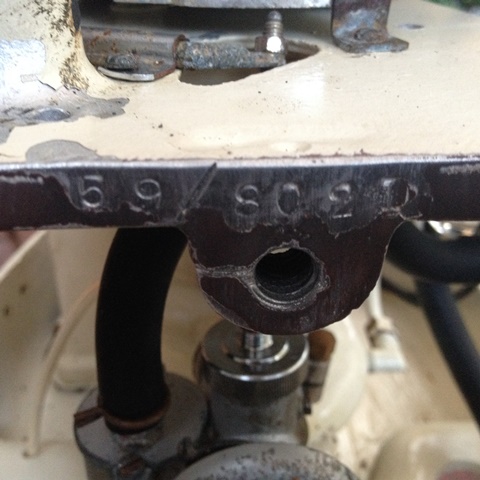

Serial number. Note my other is 60 8020 so 1 year apart. Otherwise mechanically identical in every respect.

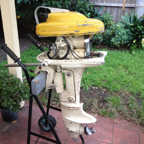

After a high pressure wash and with wrap around cowl removed. Prior to purchasing, was advised that the engine was locked up. Have therefore had the head off to check the bores. Only a light surface oxidisation on visible. Am confident it will be fairly easy to free up.
Need to pull my finger out and reassemble the other before I go much further with this one.
