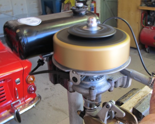

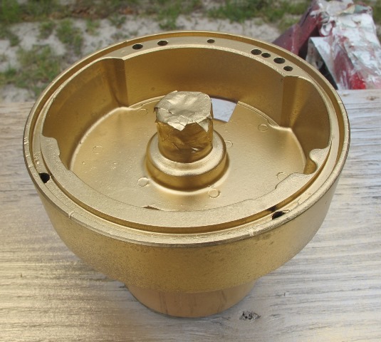

Wipac 2 units, would painting the flywheel affect the output?
It was originally painted and inside and out, I removed the old paints, applied etch primer then top coat in new gold, it should be old gold?
It is hard to follow this problem as it has a few threads. Is the motor in water and if so how high is the water? Maybe too high causing difficult in breathing. I think a lot of us have experience enough of these motors that we can 'feel' what is right. Without actually being able to feel the rope pulling on the sheave it is difficult to comment. If it was mine and l have spark l would be try to start it out of water. I would also try different spark gaps ie close it down a bit to say 16°. Each motor runs a little different. I would check your fuel, any water in it? How long do you pull the motor, how many wraps around the pulley? How fast and hard do you pull it. Way to many variables. Can you make a video please showing as much as you can when starting. Are you an enthusist or a trader? This is beginning to annoy me.

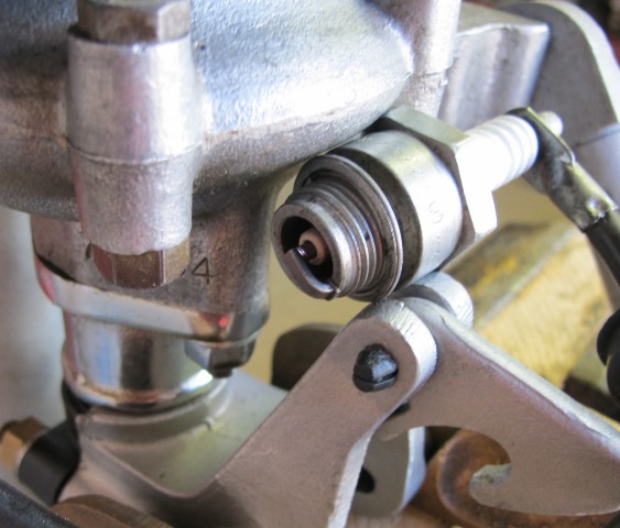

into the coil). I see you have changed plugs (I use D16 and had no issues) was the spark between the electrodes? You
cleaned and reset the points, the gap is correct? As you have good spark I think it is not an ignition issue.

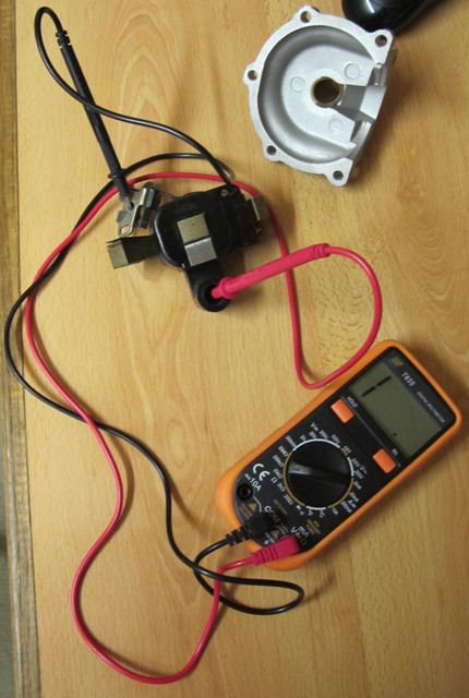

With the advice from more than one forum member, plus the Search function I have learned how to test the Wipac coil.
John at SOS told me that a reading of 3500 to 4500 Ohms was good, I later found out from him that 5000 Ohms is even better, The one on my none starting reads 5.0 Ohms on the meter.
I have now tested three of my Seagull motors plus a spare that came with a job lot crate of Seagull parts.
All are good, even the one on the 102 Powerhead I have !
The crankcase half was one of the parts in the job lot, cleaned off I find it to be near new, I have the other half as well.
Note, the Multimeter that I have reads as 3.5, 4.5 or 5.0 etc,

John, Thanks for your posting, I have swoped the carb over for another one and with no success, The Wipac reads 5.0 Ohms which I am told is good.

The points have been cleaned with alcohol as per the handbook, then set to 0.5mm , there is a spark at the plug anyway.

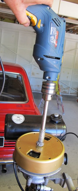

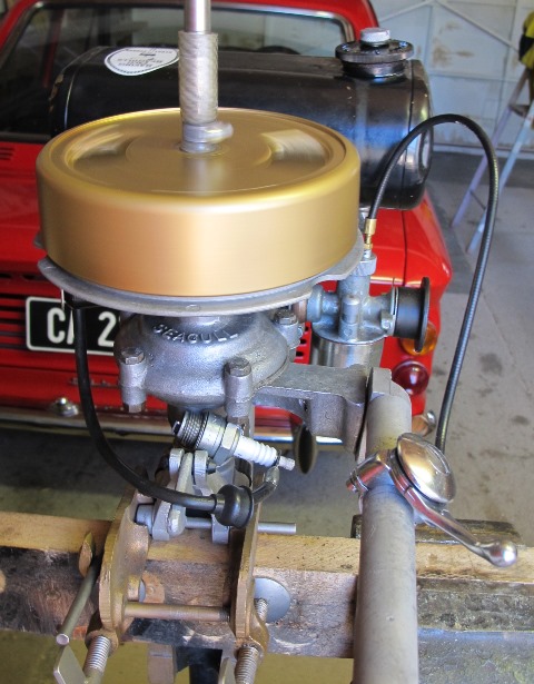

I have just powered the engine up with an electric drill, as soon as the flywheel starts so does a nice blue spark but as the revs pick up the spark stops, so that is why I cannot start this motor !

I have a spare Wipac coil, using the power drill as the method to torn the flywheel and changing over from the original Wipac that was on the engine brought me a nice fat spark and in a constant fashion.

With the flywheel nut re tightened and the start rope fitted, fuel tap on with the fuel bowl full, I set the choke and turned the throttle to full power.
The engine started first pull and ran perfectly :P
