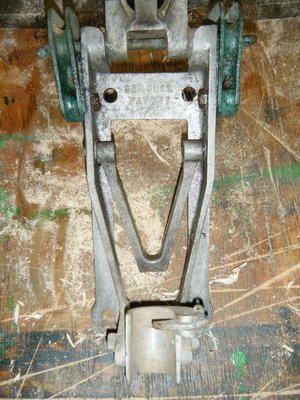

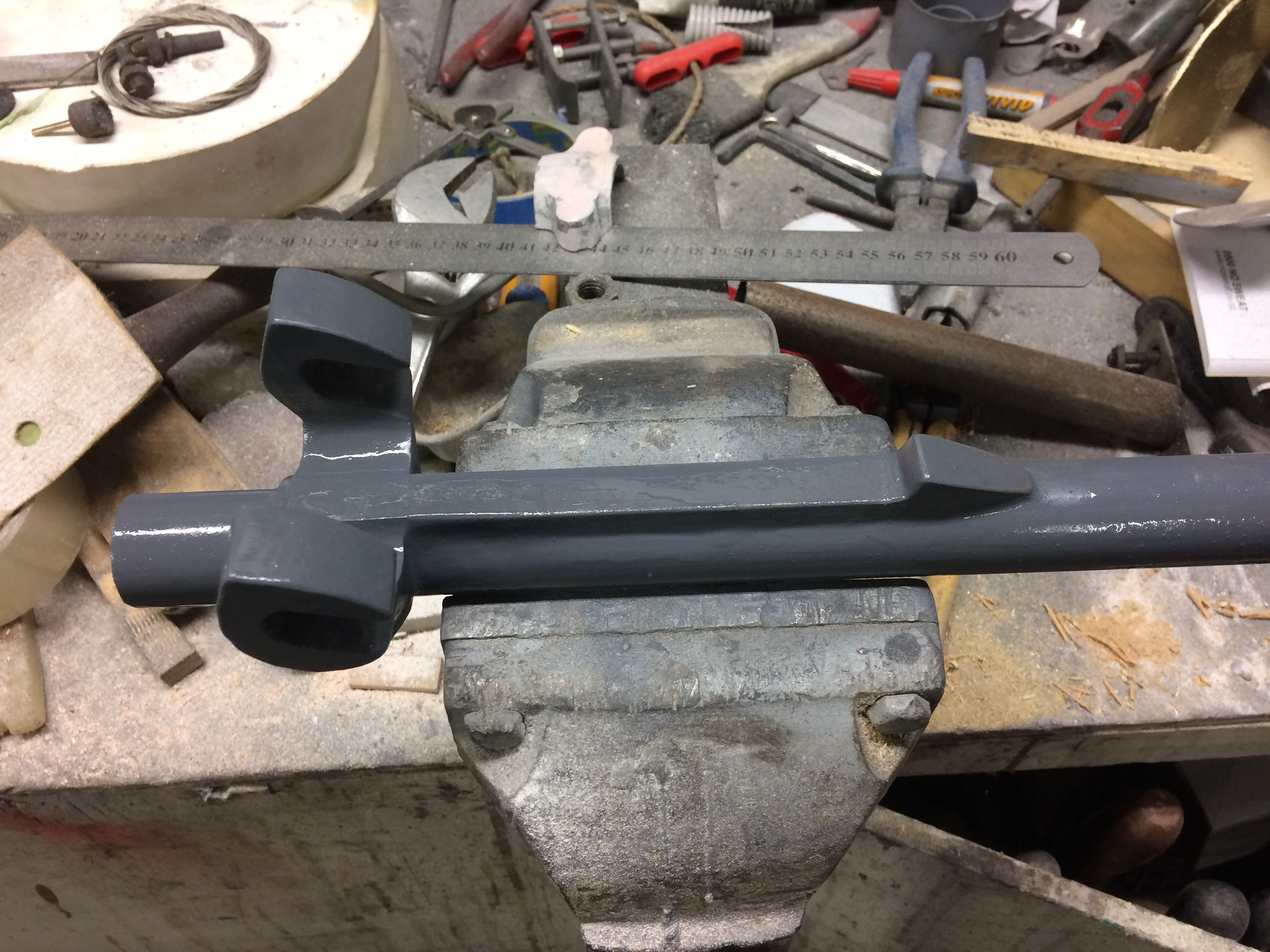

Got the filler and a bit of paint on the donor bracket / pattern.
Took it to the foundry late last week for them to have a look at and give there opinion. He is going to have a go at it and come back to me.....
Still not the easiest part to cast, we think it was made with a 2 part pattern ( I dont want to cut this one to make it like that)

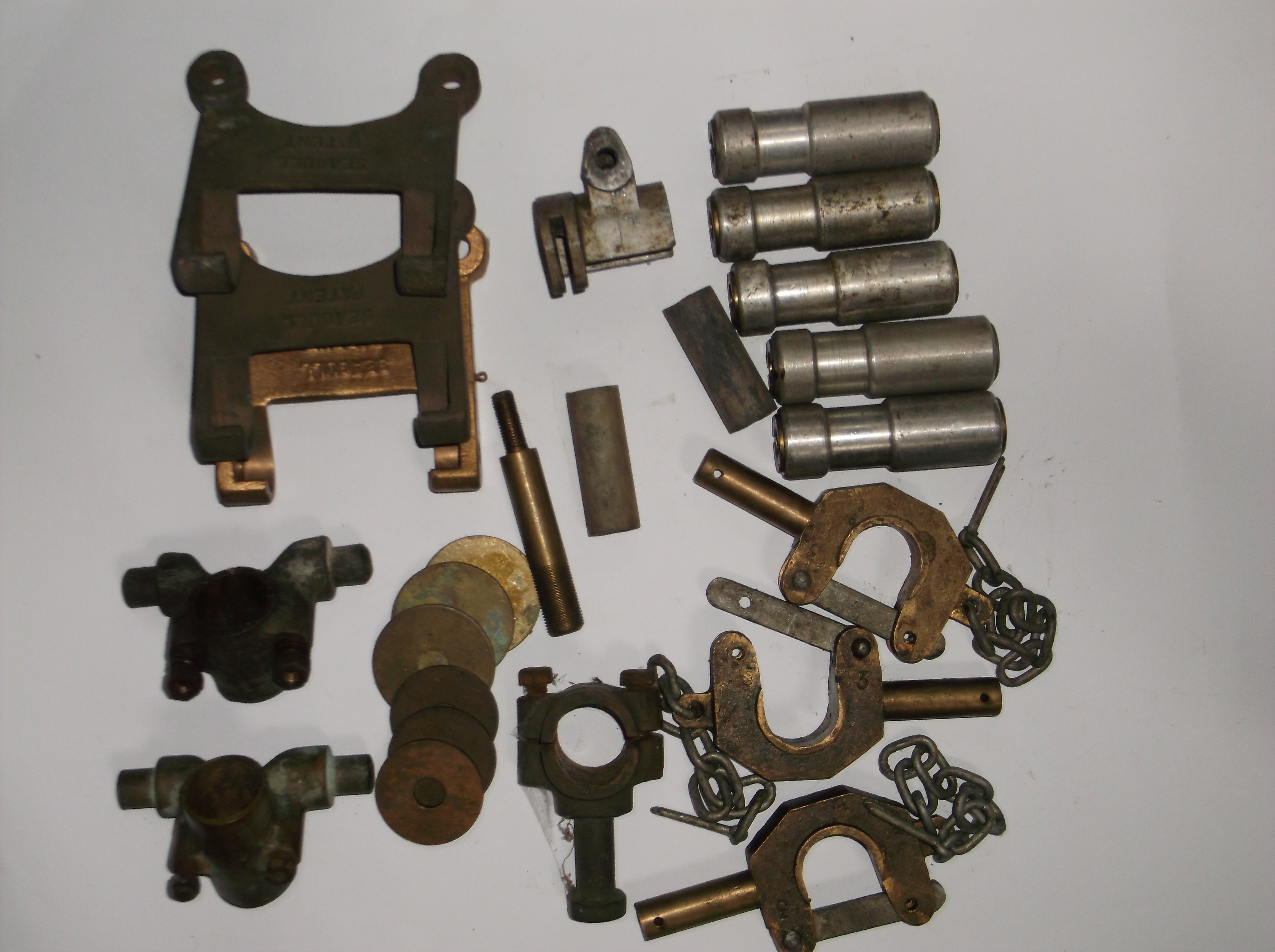

Spiro you can still find the original upper & lower bronze bits for the iron side mount bracket.
Let me know what you need.
For a complete NEW skeletal bracket, one off, finished, I'd guess very close to $1000 aus. Silly money!
Noted Hugz, was just asking in order to understand what's already on the go. Definitely not asking for anything to be added to the list.Hugz wrote:The bit that clamps on to the driveshaft. Chris is voluntarily doing a terrific job. Lets not overload his largesse....
Nice bag of bit Charles. I really won't know what i need until the SD arrives ... hopefully next week. At this stage, I'm thinking just the lower clamp for the iron side mount but i may need other parts as well.Charles uk wrote:Spiro you can still find the original upper & lower bronze bits for the iron side mount bracket.022.JPG
Let me know what you need.!
If you have a lower clamp for sale, please don't hesitate to pm me.

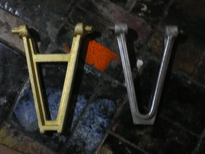

Why not cast an aluminium alloy one, I'd like one 'cause I snapped one of mine. I looked at my motors and have a brass one and an alloy one, with an almost complete mounting clamp.
All of my brackets do not have the central web (maybe thats why it broke.)
Looks like a simple casting job.
We are talking about the brass skeletal bracket which is a different bracket to the standard one. There is a slight difference in the V struts and it needs to be brass/bronze to keep to original. Plenty of parts for your bracket are available Rob.
- Rob Ripley
- Posts: 442
Interesting that my brass strut does not have the centre bar, and that its an identical casting the the alloy V-strut.
Of course you could also bend up a 6mm round bar as an emergency V-strut.
They did make that model of transom bracket in brass but l've never see a brass V on an alloy bracket. Others?

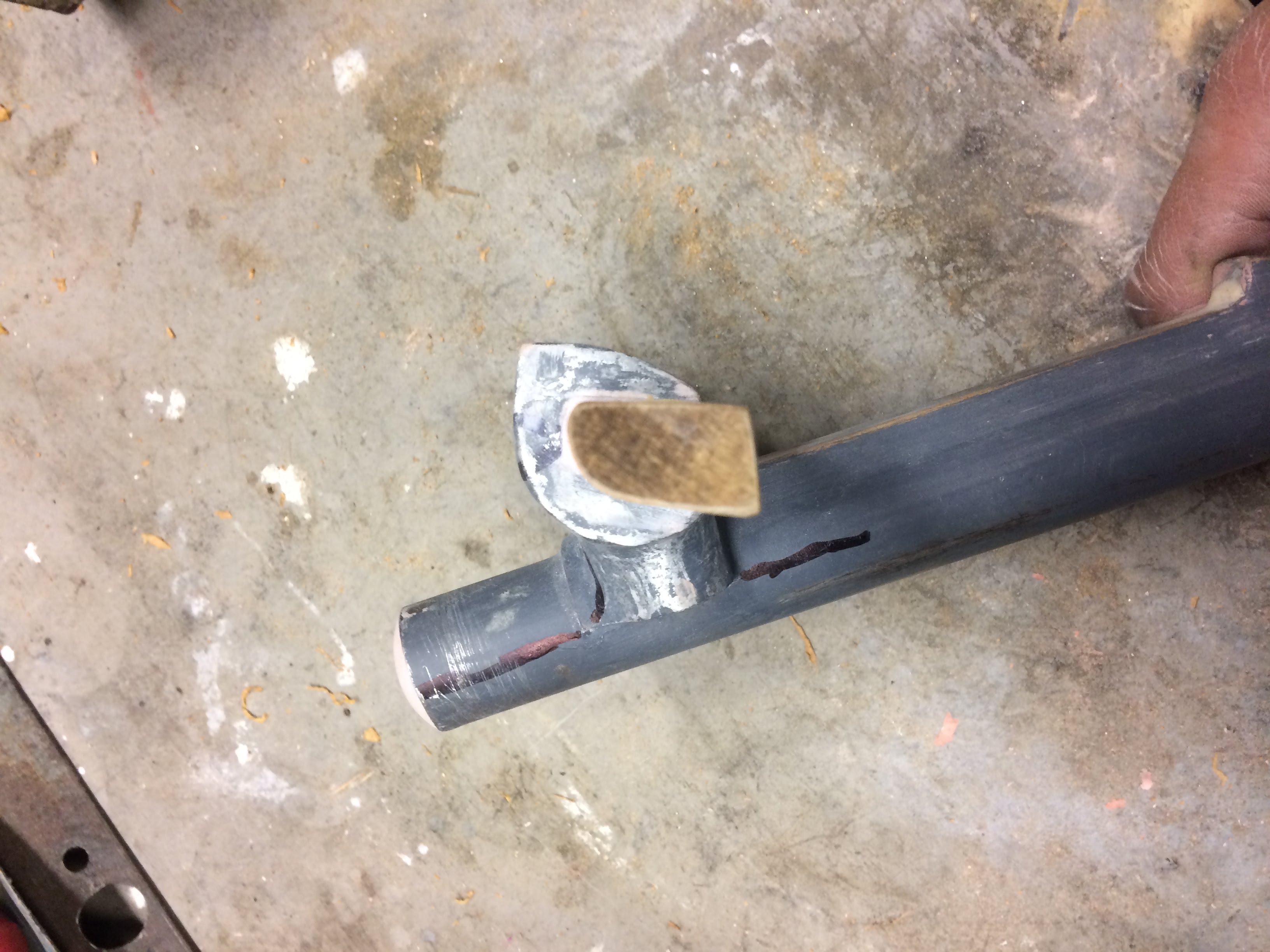

I have not forgoten....
Quite the oppisite....

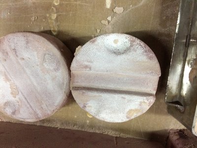

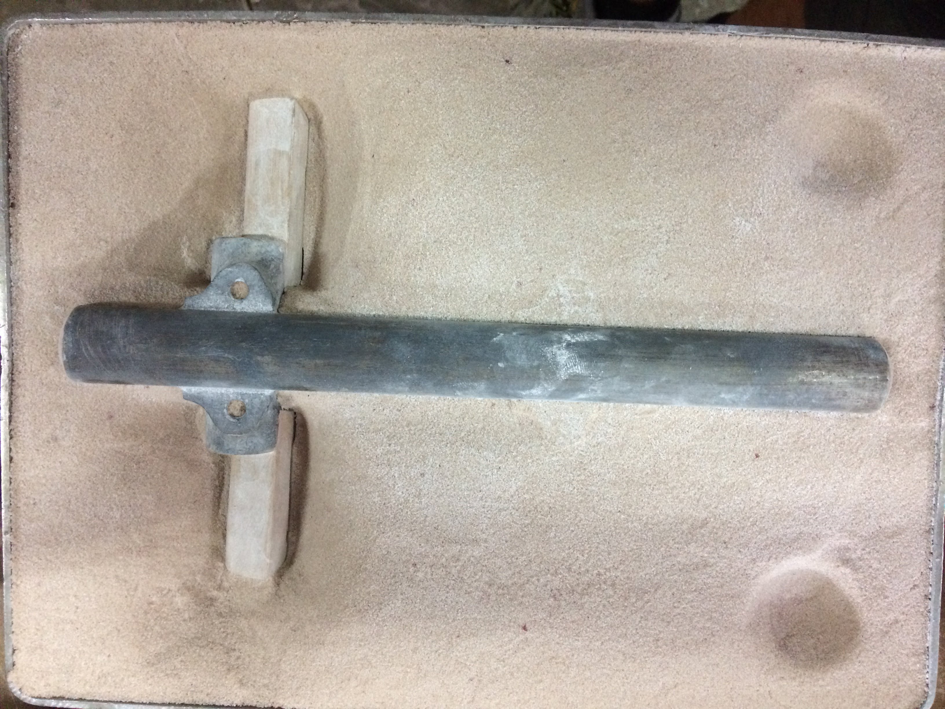

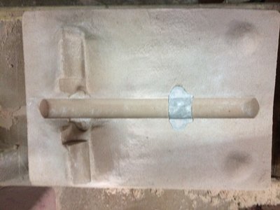

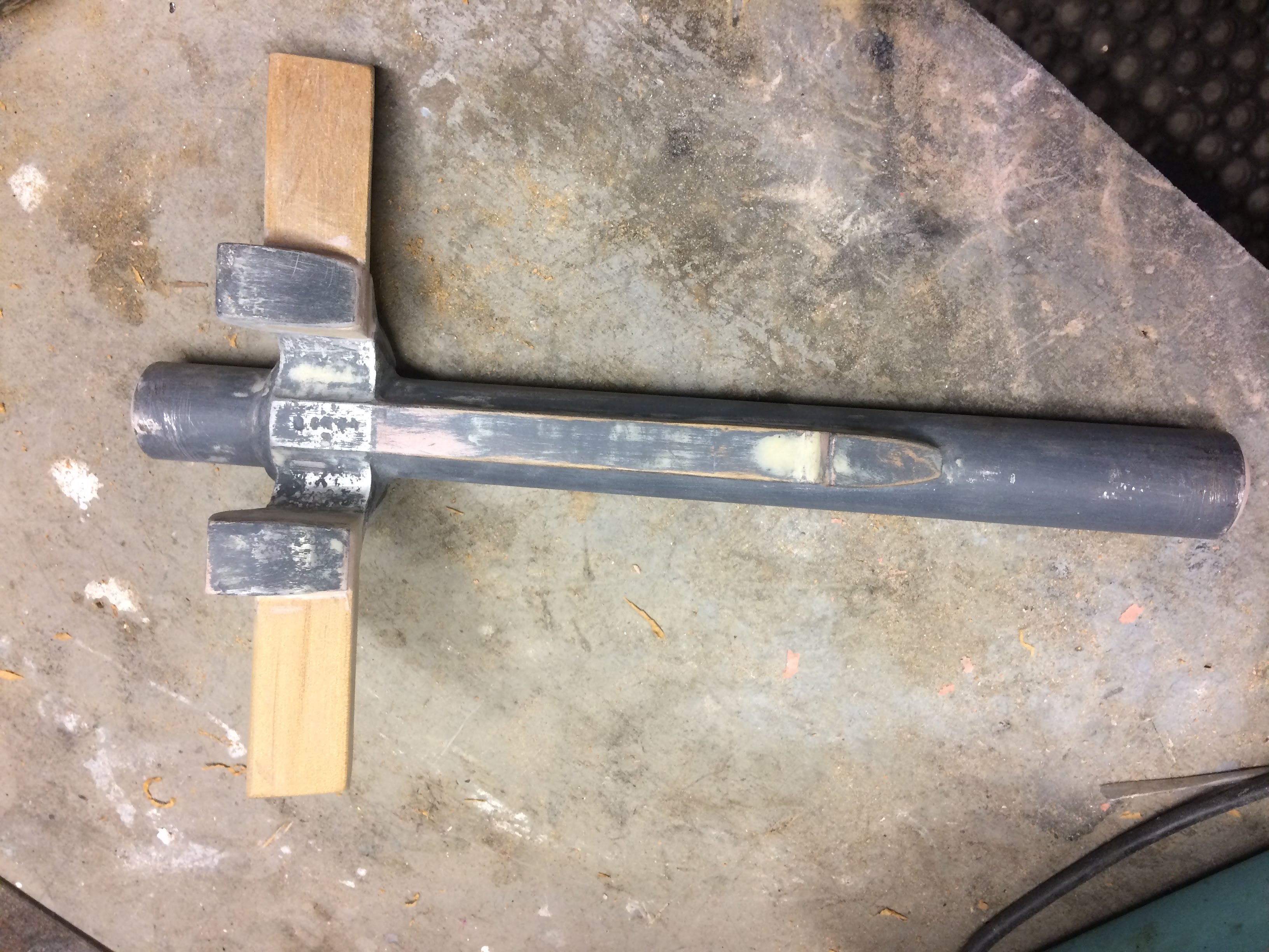

Had to make another core and print to be able to get the part out of the sand. Then in between jobs (Some of us still have to work
) I got back down to the foundry to start making some moulds
Even the core box is made in sand (if the run was any bigger I would make a wooden core box)
Now the biggest problem is the time it takes for the sand to harden, the colder the day the longer it takes. On a warm day there is about 5 ~ 10 min working time at the moment it is more like 15~ 20 min. The part can't be demoulded for a further 15 ~ 20min depending on the temp.
More to come
More to come
