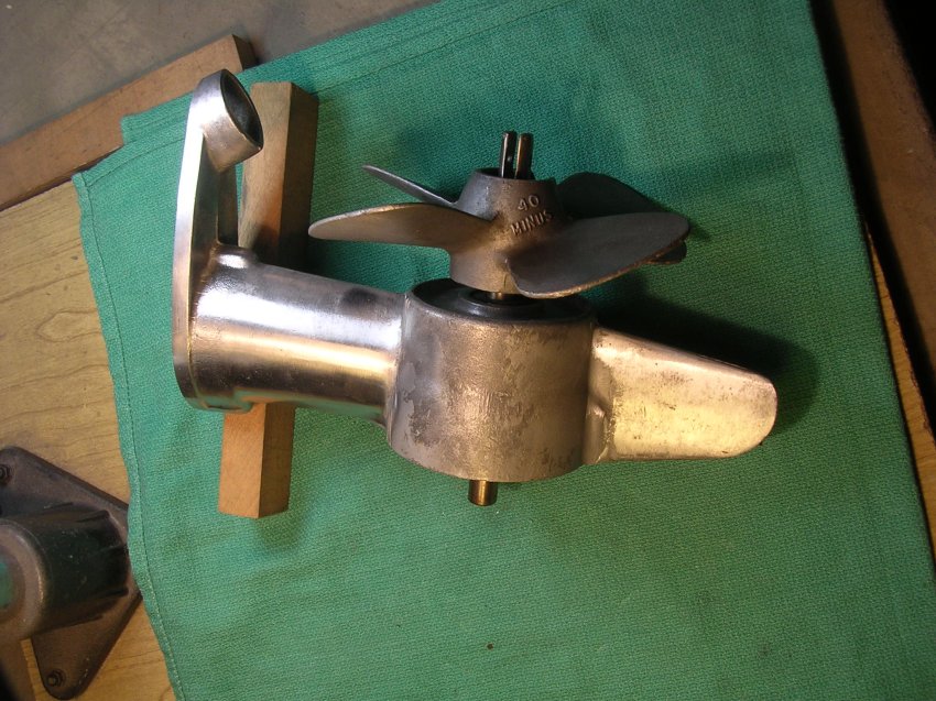

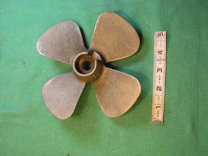

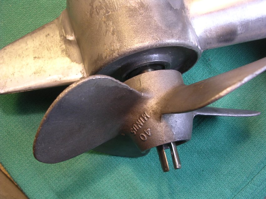

Now propellers: Which is the correct prop for the larger FVP and LS gearbox? See pictures. 4 blade clover leaf marked 40 minus has a much smaller hub than the gear box front. Should the four blade marked "100 only" be used ?. That has a bigger hub and larger diameter. WB

That prop marked 40 MInus is for the SJM.
The prop that your LS should have has a similar form but is bigger at nominally 9".
Cheers,

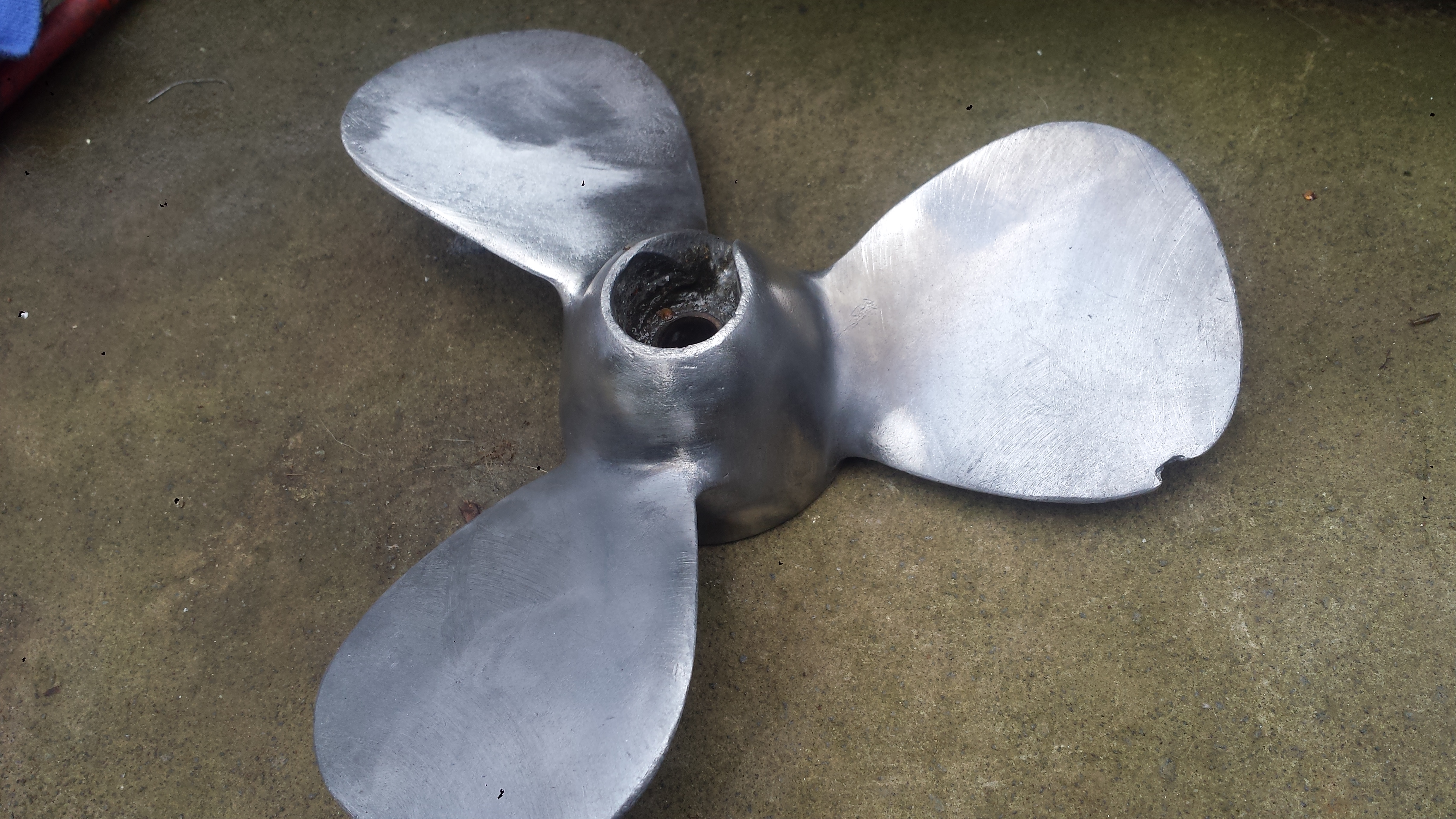

Fvp=3 blade prop

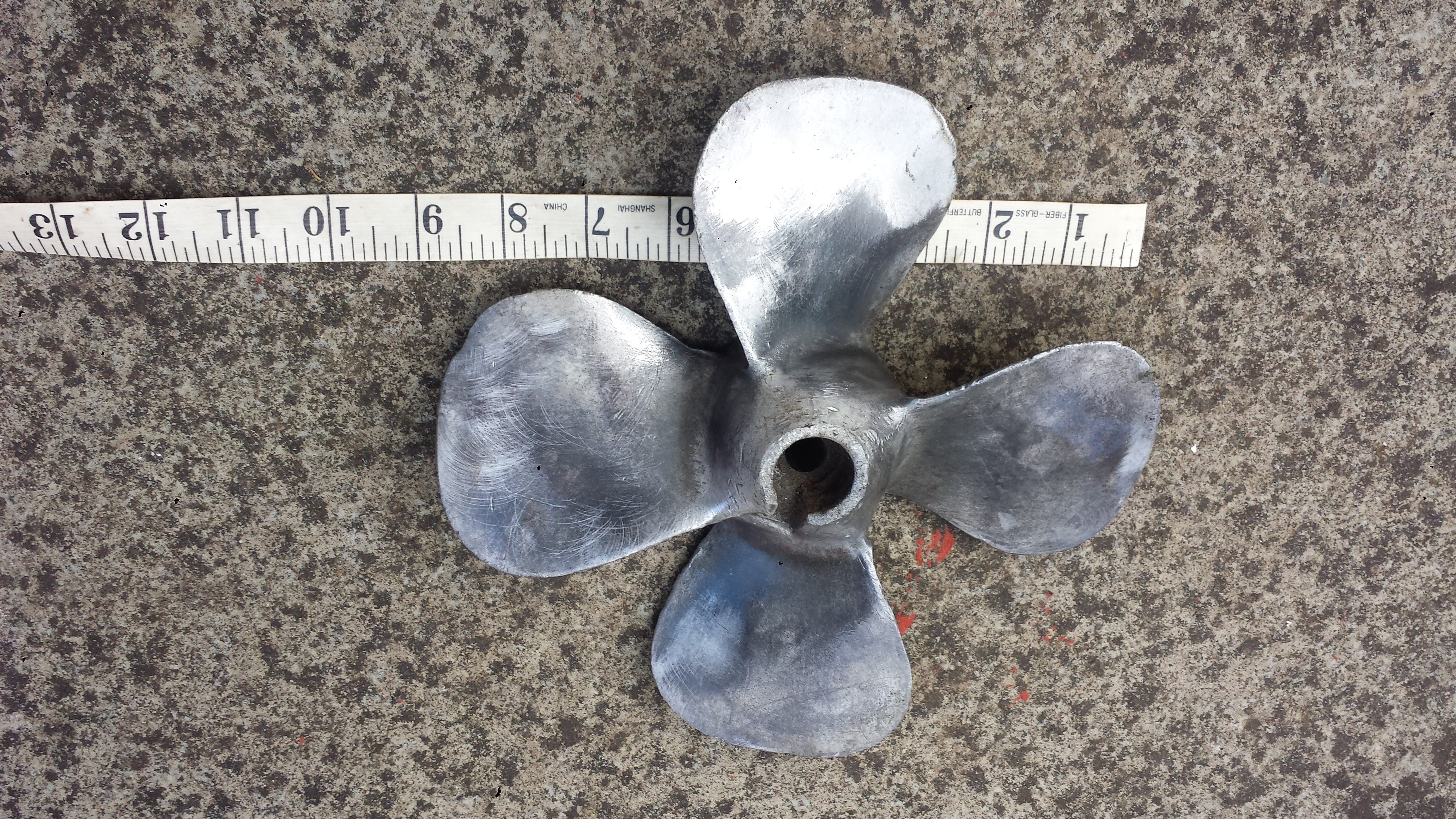

Ls=4 leaf prop both are known as clover leaf my understanding is that there is no markings on either hubs hope this helps

Thinking out loud there art I'm thinking that prop is not for that gearbox if it's marked 40- then it's for a 40- and I'm thinking that's not a minus gearbox. ... (iv been wrong befofe) more like a 40+water bug wrote:Now propellers: Which is the correct prop for the larger FVP and LS gearbox? See pictures. 4 blade clover leaf marked 40 minus has a much smaller hub than the gear box front. Should the four blade marked "100 only" be used ?. That has a bigger hub and larger diameter. WBDSCN9158s.JPGDSCN9159s.JPGDSCN9160s.JPG

Jeremy I'm sure I have seen a 4 bladed cloverleaf prop with 40+ on the hub, am I dreaming?

The three blade clover leaf props don't seen as common as the four, I think seagull still sell them, you see the four blade's more often but mainly the bigger props for the 102.

I would think that it is quite likely that a 9" 4 bladed prop would have 40 + ( or Forty Plus) on it. But I haven't got one to check.
The 6" 4 bladed cloverleaf has 40 Minus on it - at least mine do!
Interestingly the 9" 3 bladed doesn't have any markings - at least mine don't.
