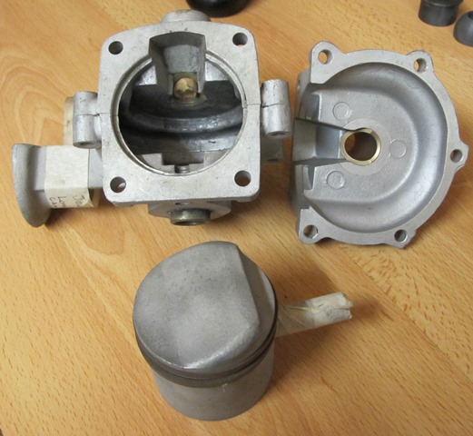

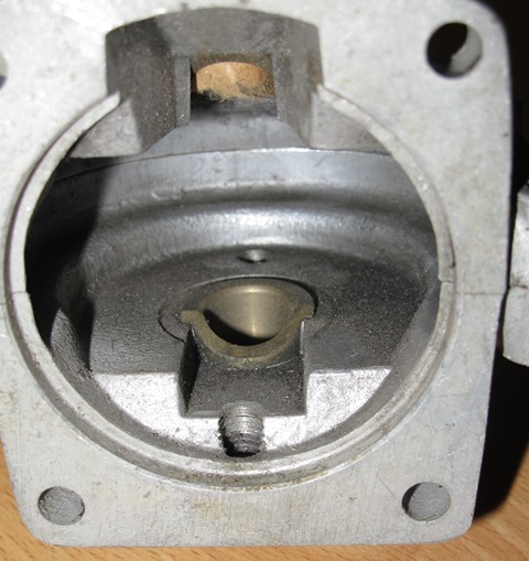

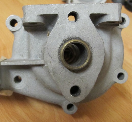

I am in a sea of despair and now clutching at straws to save myself?
Should the drive shaft tube to the crank case be fitted with a sealing gasket and paste? I would assume if a leak was happening I would be seeing a fuel mix exiting the same joint?
I have not removed the two studs, assuming they were sealed on assembly by whoever did that job?
I ask as I have not done this and if the two threaded holes in the crank case leak, the suction of fuel from the craburetor will be affected?
The two halves of a crankcase are spares marked WSCL 1451CC8 I did not get the block or crank with them.
Dated July 1976 Silver Century 4.5hp, long shaft, clutch drive and Wipac ignition ( info taken from Johns SOS web pages )

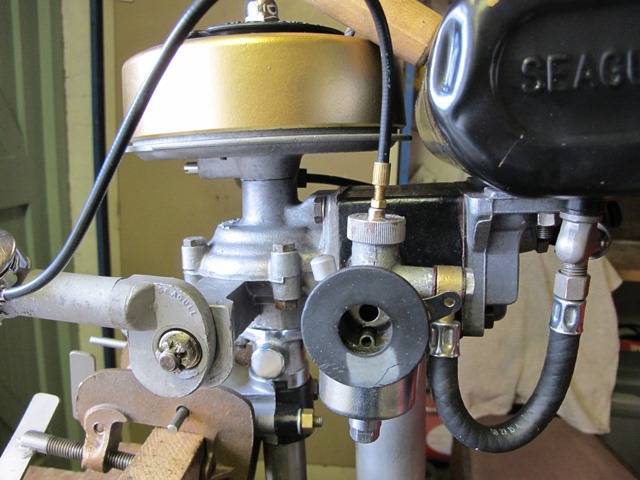

This has now drifted of the topic of Wipac 2 fault?
I will leave things here for now,
I have just removed the carburetor, laid the engine on the bench with the fuel intake facing up, then force fed the crank case and the piston with a fuel mix.
I then set everything back up, carb on fuel pipe connected and filled the carb fuel bowl, I then tried to start the engine and got nothing again.
Note, the spark plug remains dry, why would this be?

Have you checked the piston orientation?
Is there any likelihood that the wrong crankshaft has been put in this engine?
Your gasket problem might be answered if you read other earlier threads on the same subject.
african imp
Posts: 395
Location: Hout Bay
Post by african imp »
Charles uk wrote:Have you checked the piston orientation?
I have just been reading the SOS manual Service Sheet # 3 , re the orientation of the piston, will it be possible to view the crown and the Inlet Deflector via the spark plug hole?
Yes, it is.
I have just checked and also on another (working) forty, both are the same , piston is the correct way around.
Stamped on the front of the piston in my motor ate the letters STD-R I assume that means a standard piston?
Re the wrong crankshaft?
I have no idea of my engines past but by turning over the spare (working) motor I can see that the piston skirt opens the port and that the rings appear and stop in eactly the same position, the join in the top rings are clearly visible.
So the cranks are the same?
