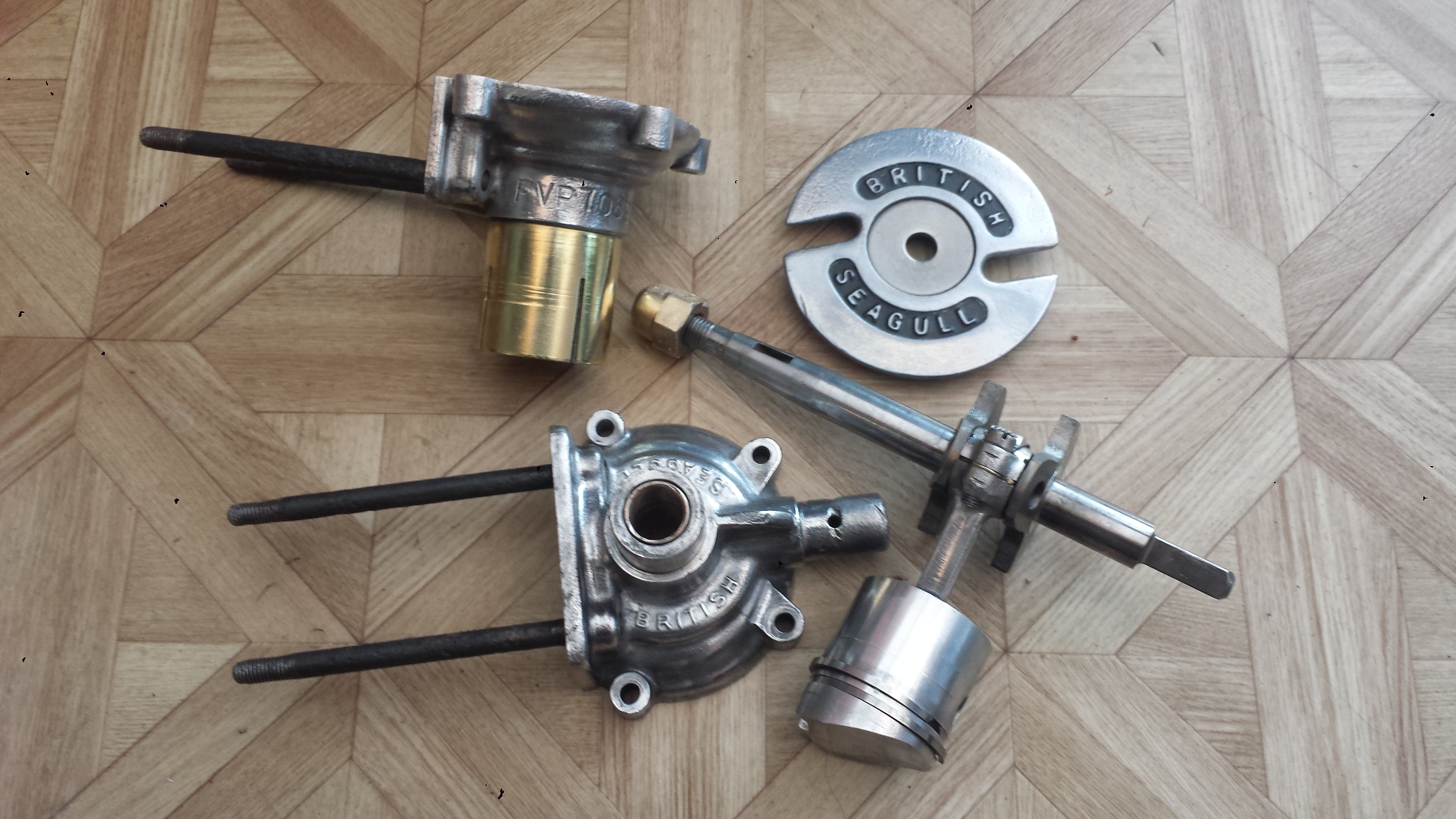

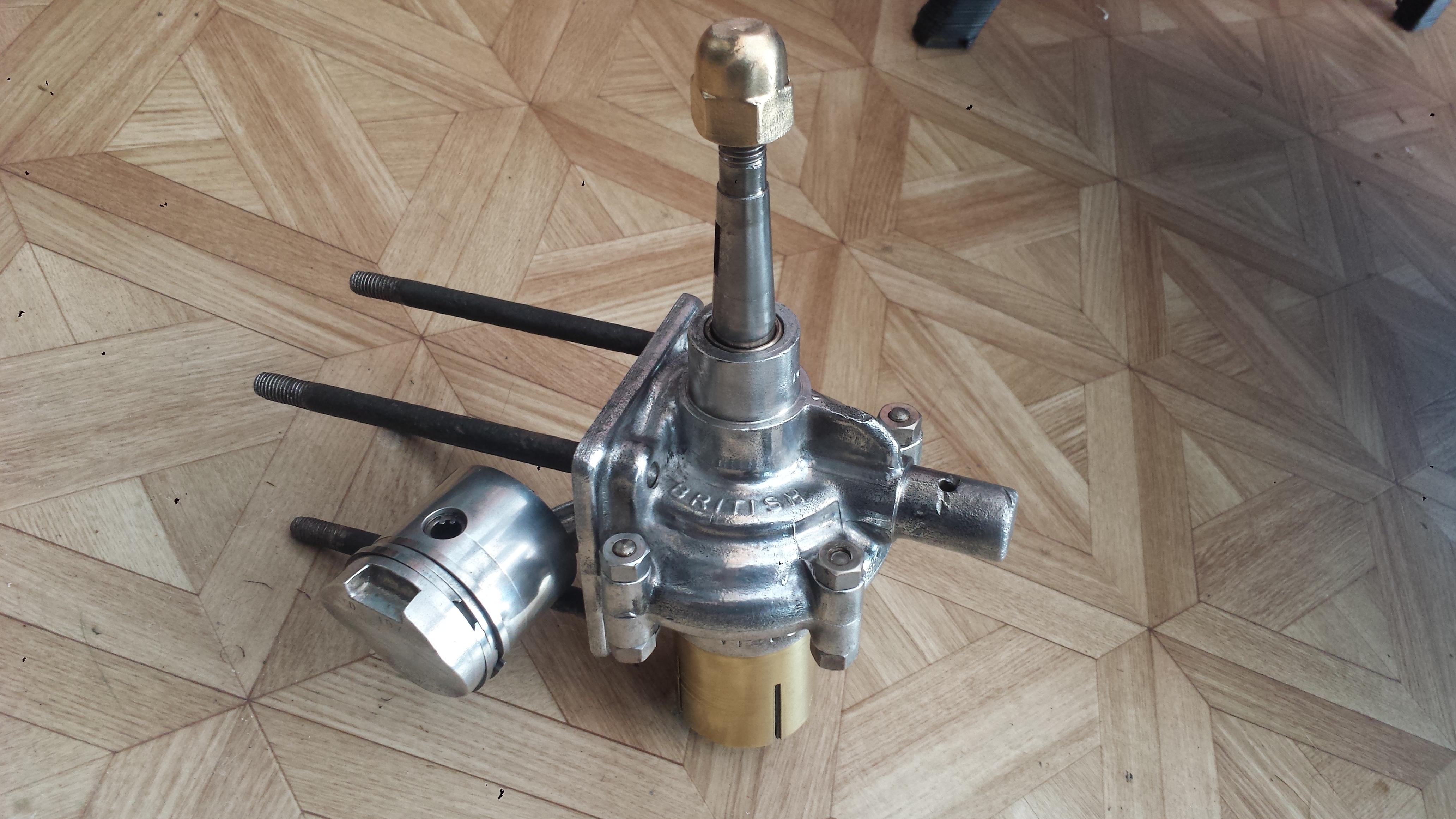

Spot on C I reemed the bush a bit all good now might of went ott with the polished piston. .....

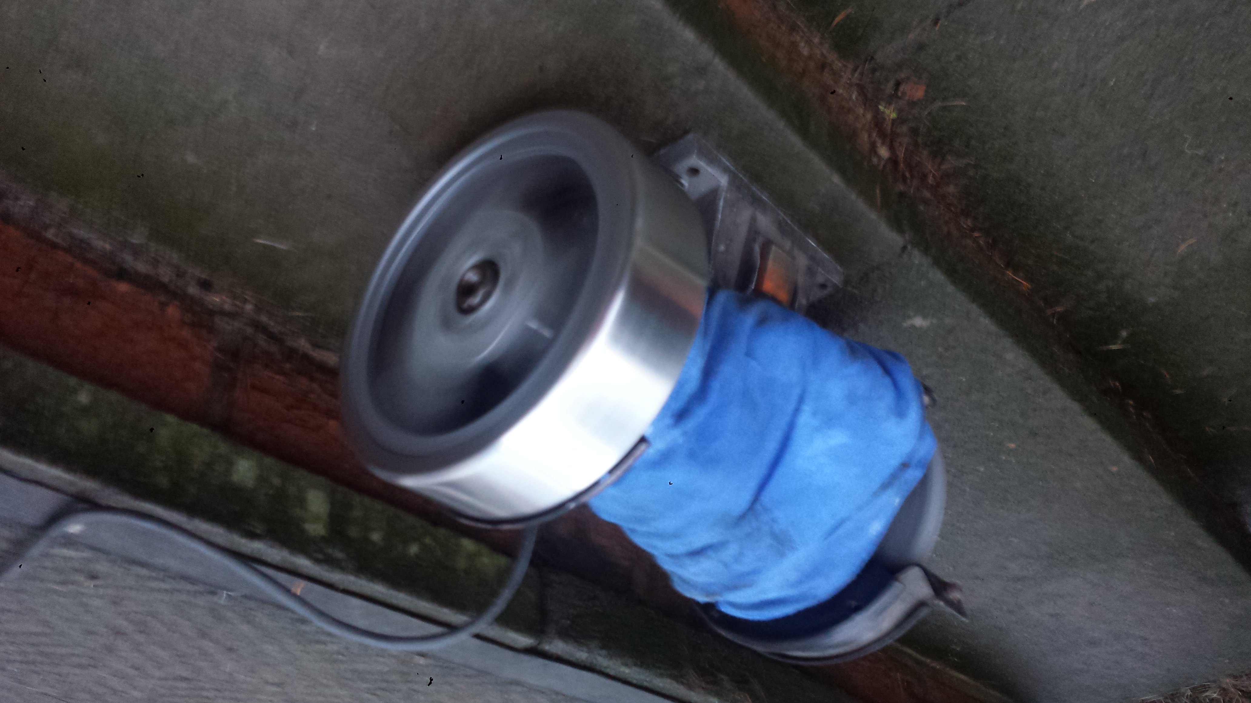

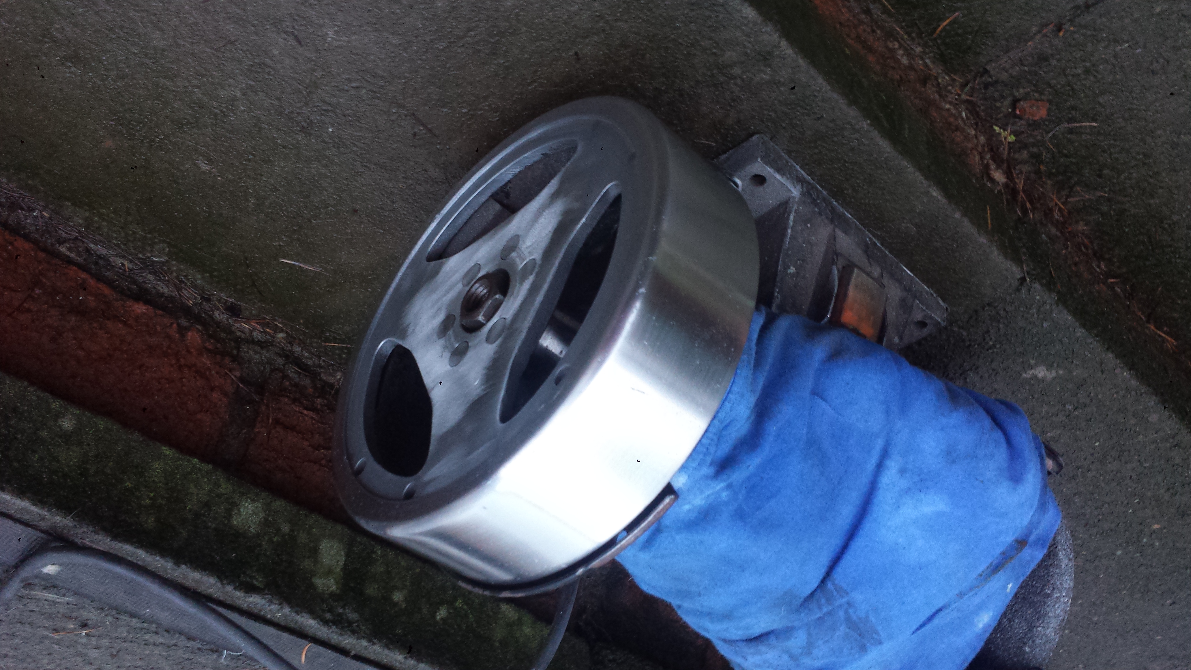

As for flywheel polishing, I generally spin them up on a pedestal drill and hold a polishing cloth against them as they spin. Depending on starting condition however, some require a sanding first ie to remove scratches and the like.
I have found an inconsistency in the alloy. Some will polish up very nicely, others not so much.
