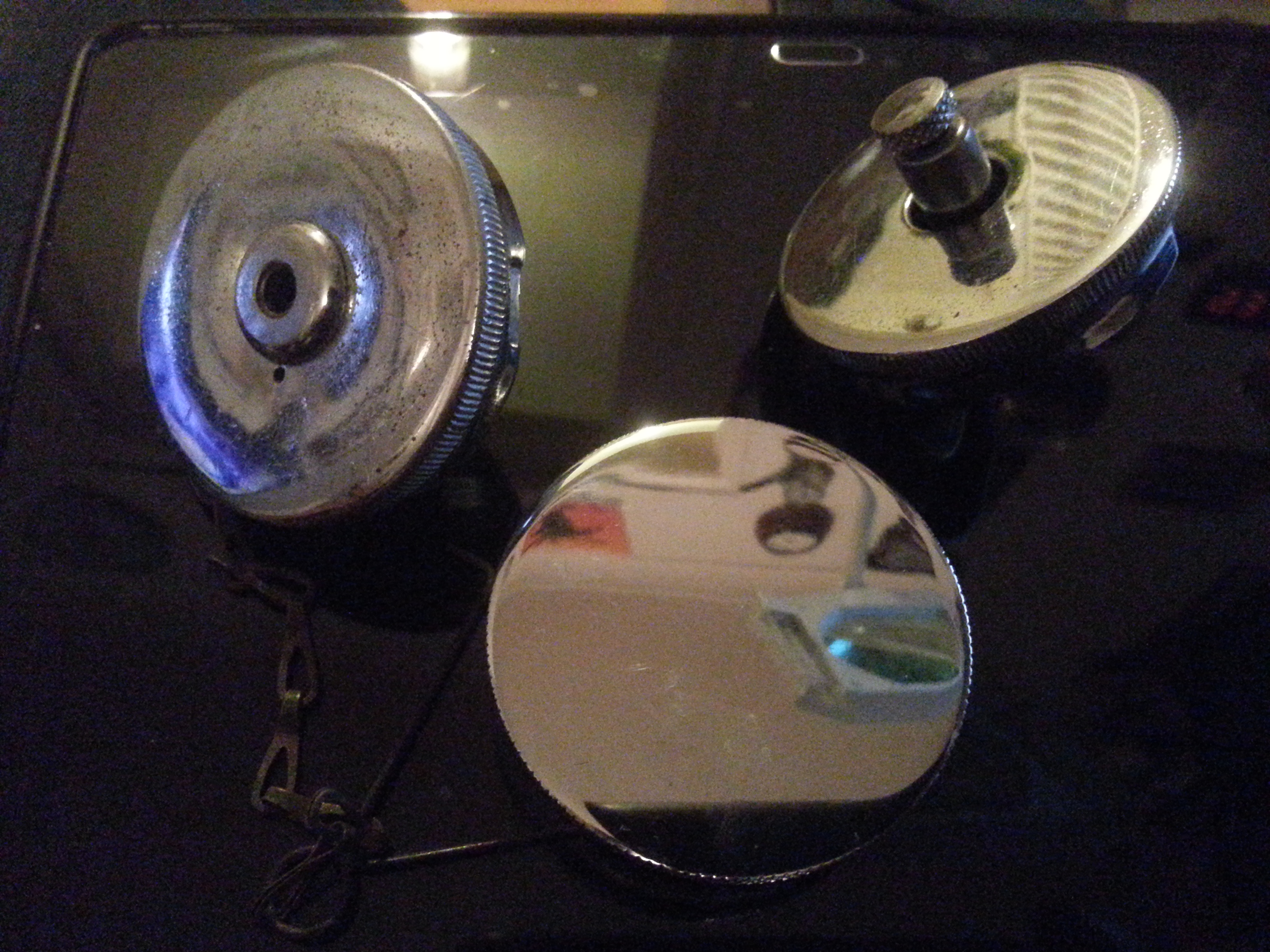

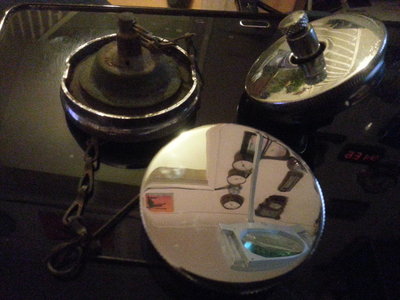

Here is one I forgotten about.
The one on the left , was on one of my OA's.
Different vent setup, still made by Ceandess, and this has a Pat No. stamped on the side.
