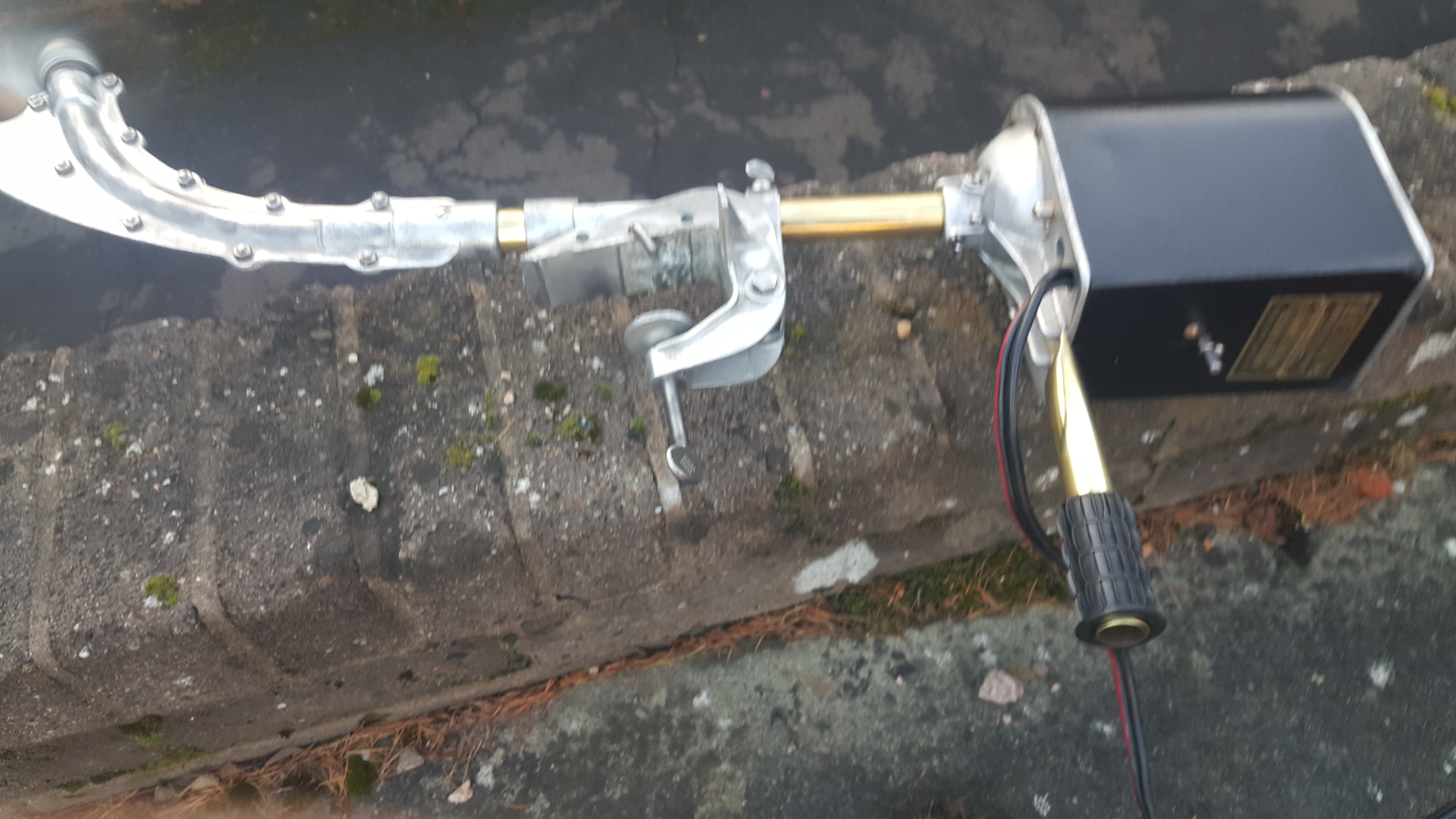

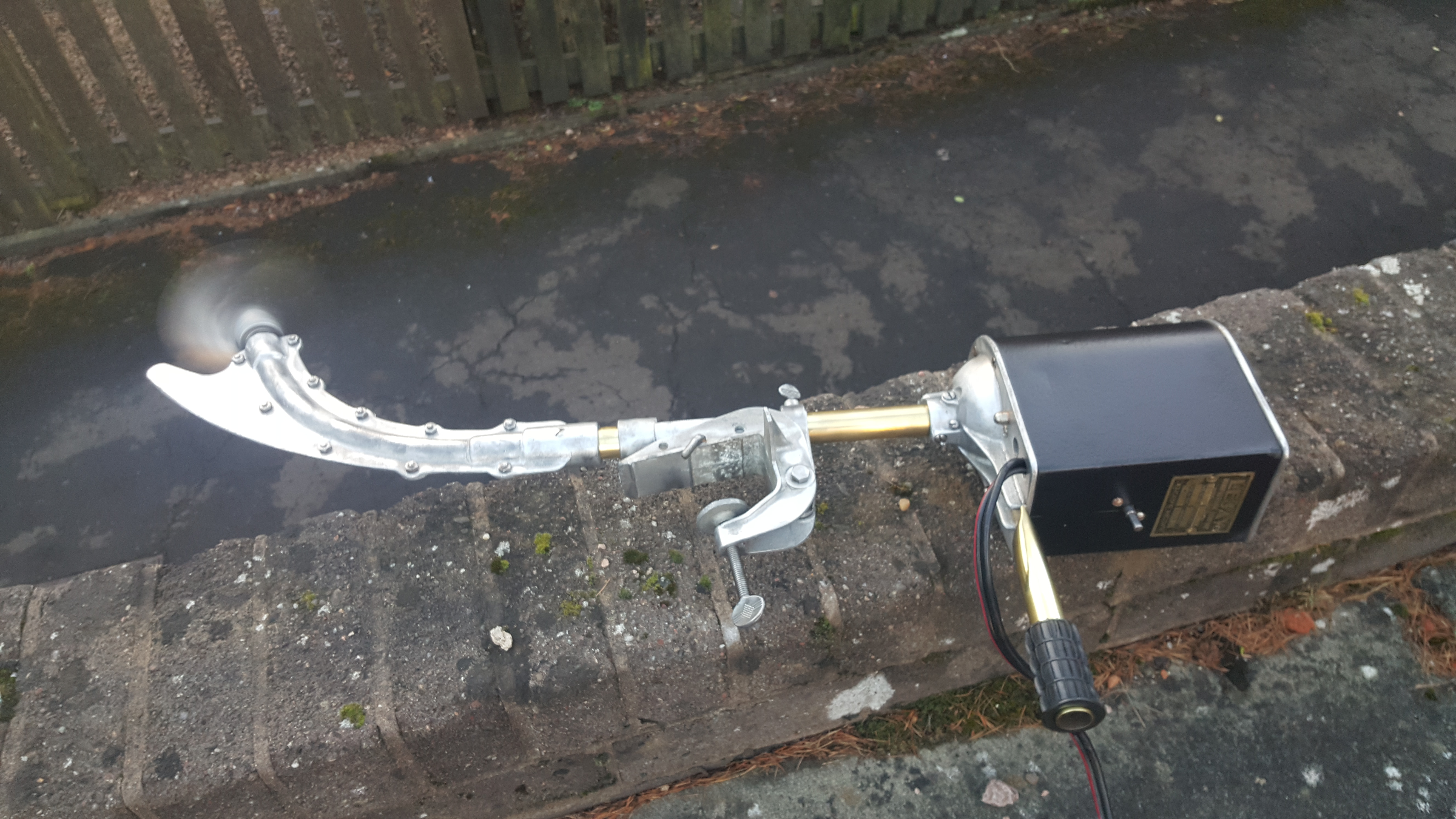

The wee midgie is now a runner.... :lol:missing a bakalite on/off knob shouldn't be too hard to find

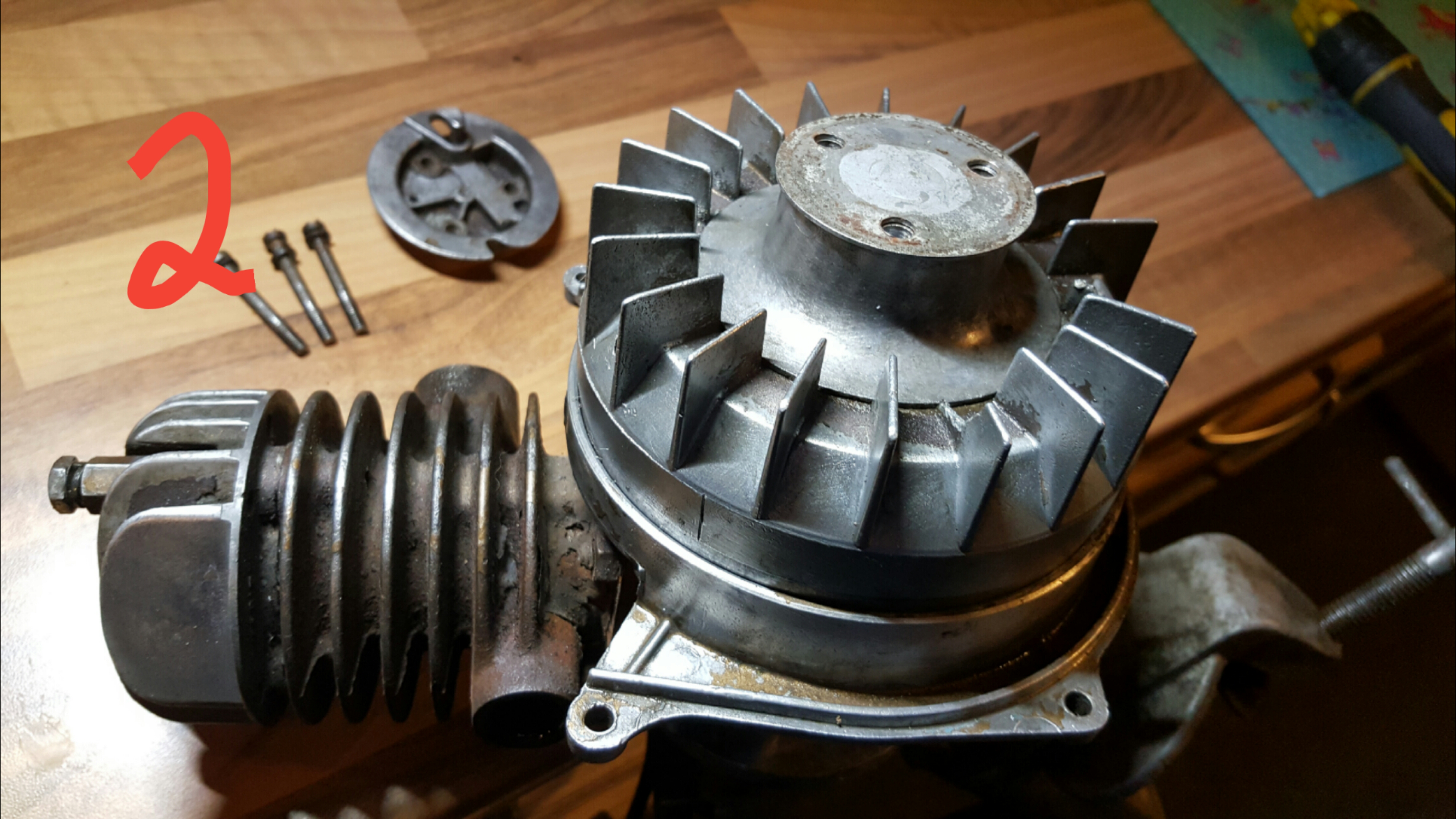

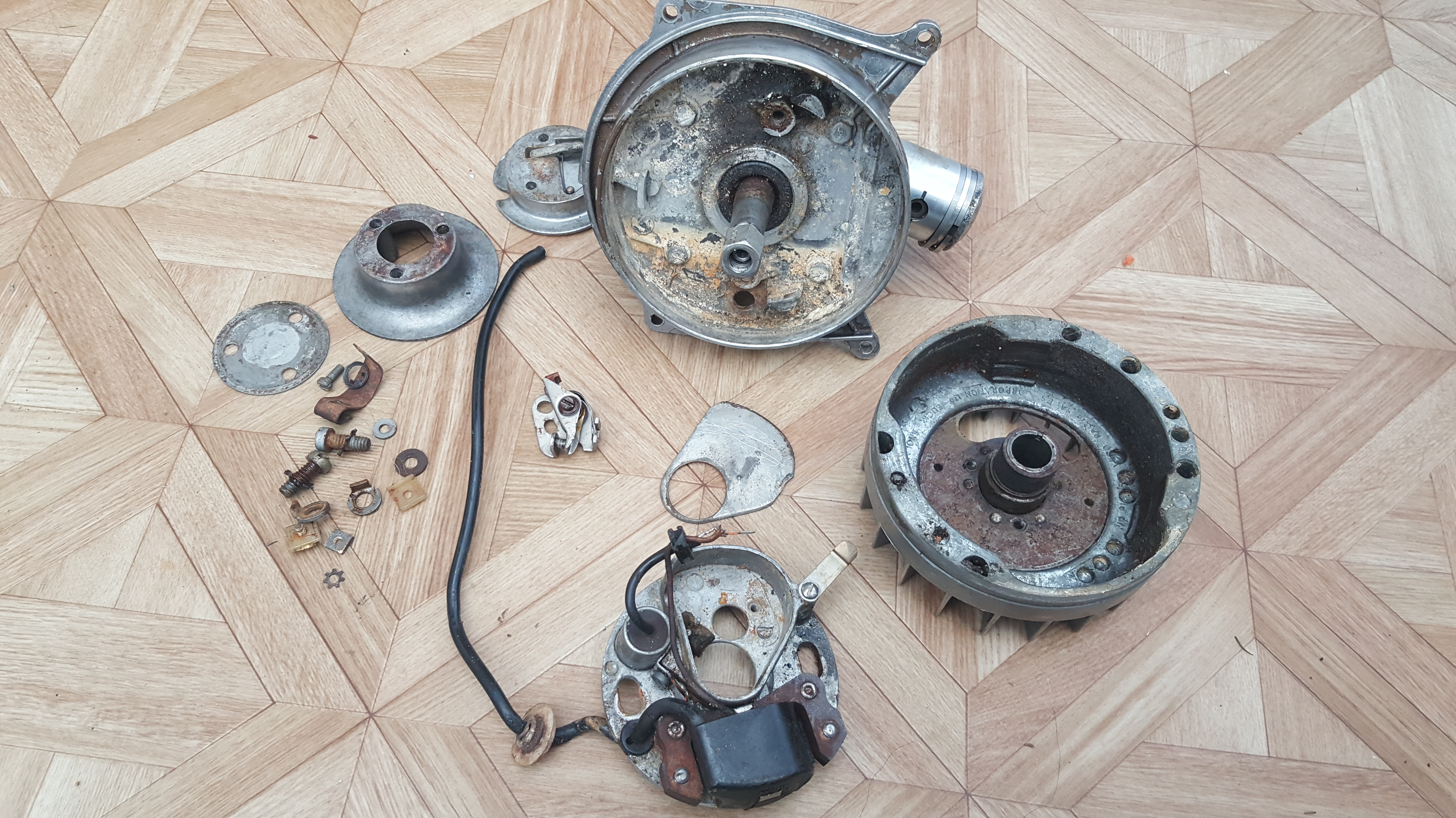

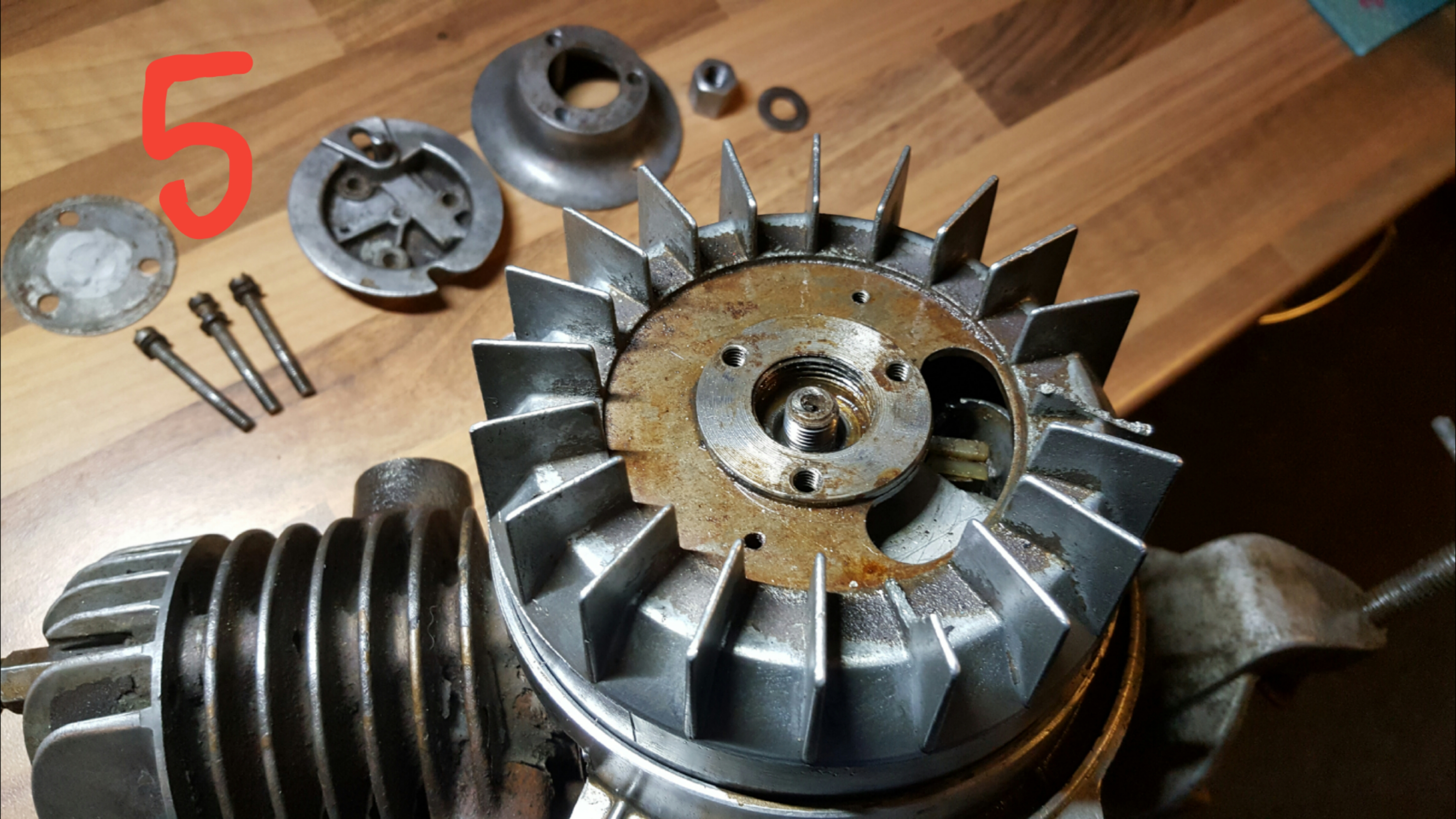

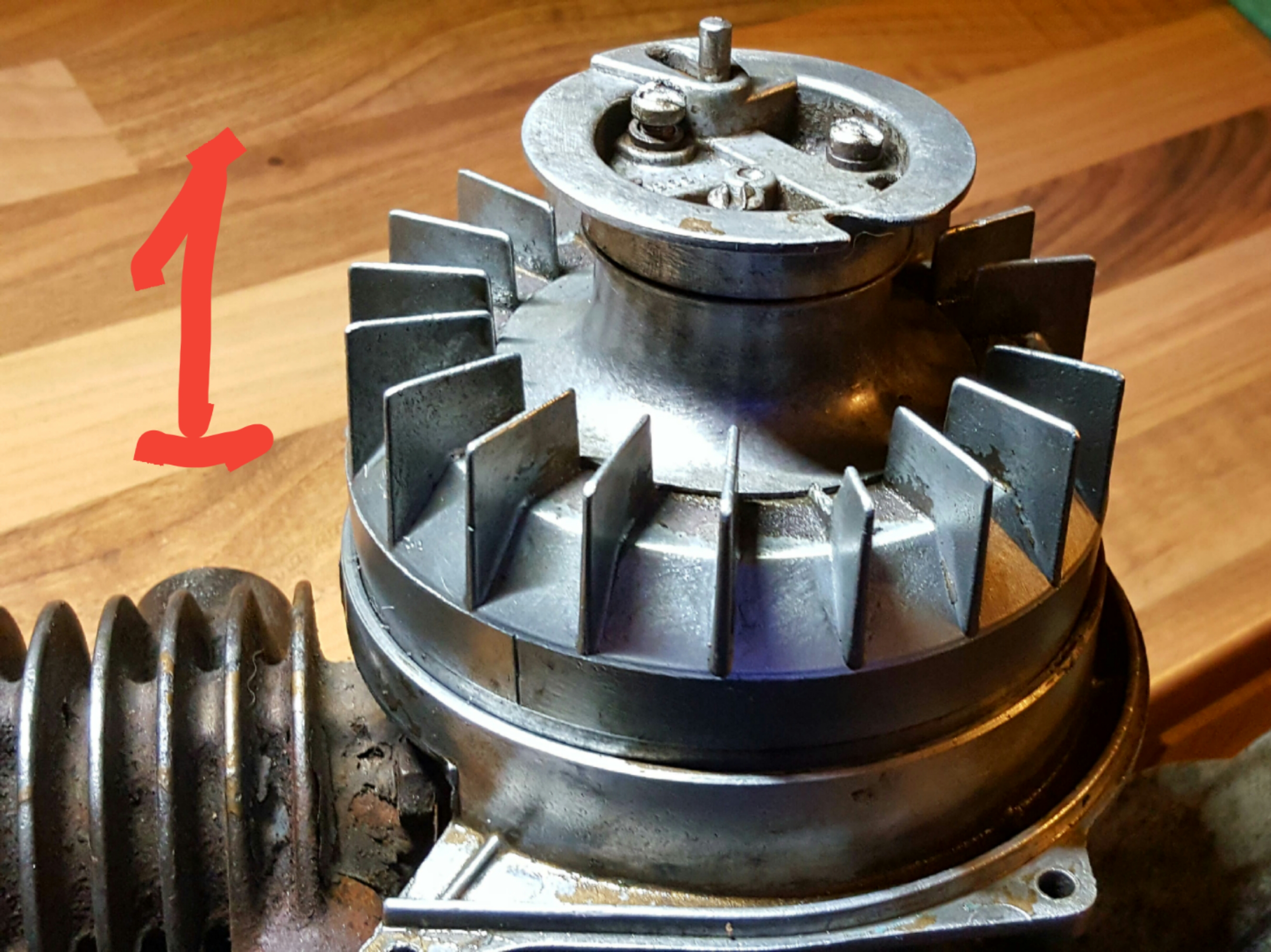

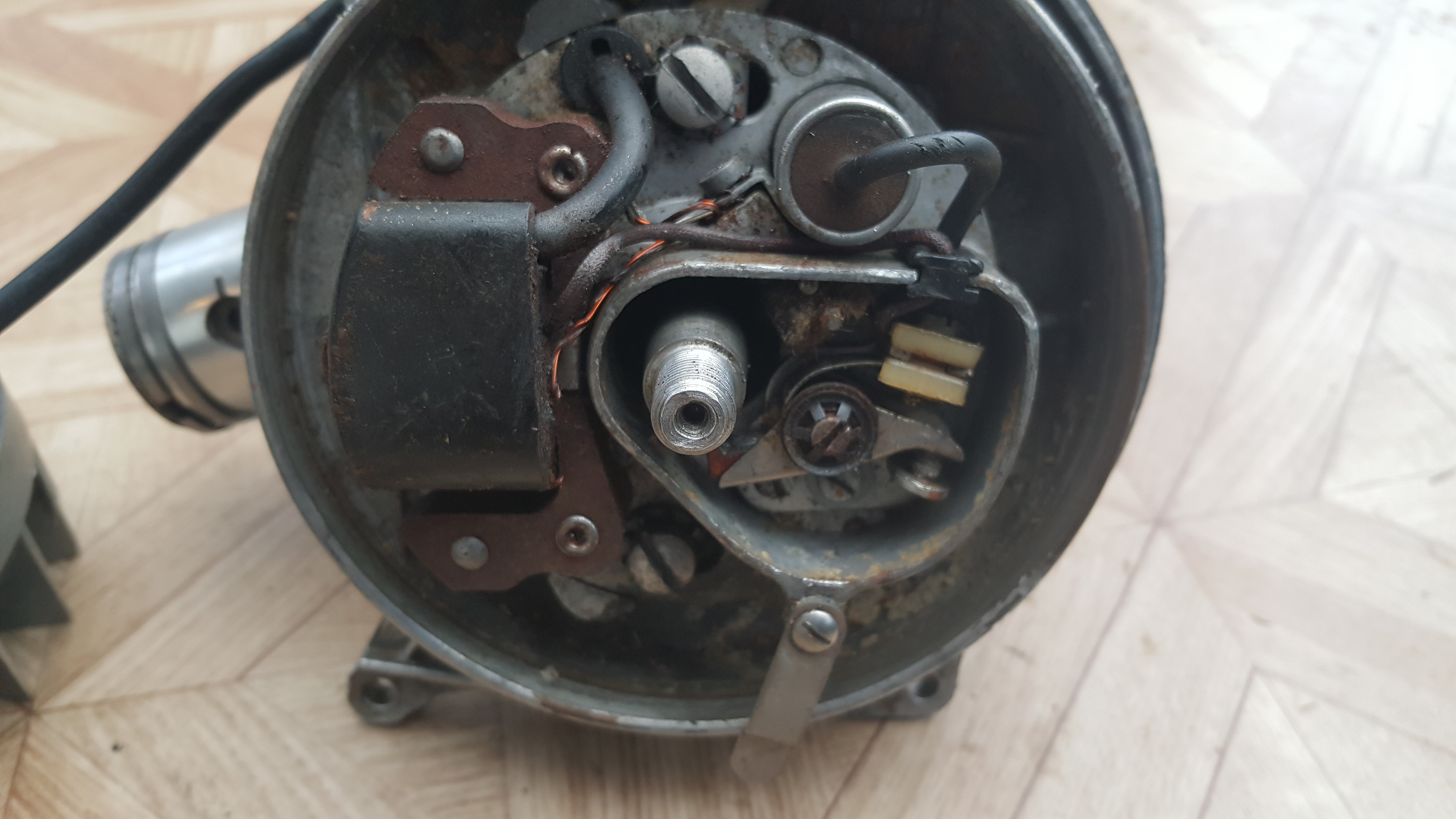

Made a Start on this one non sparking noticed the points aren't functioning how does this flywheel come away...

Looking good! Rubber grommet where cable comes out if using a lot.

Waiting on a selection of grommets and a bakalite knobs coming...Hugz wrote:Looking good! Rubber grommet where cable comes out if using a lot.

Looks like you will need to make a puller (flat plate with holes that match the ones in the flywheel) find some bolts that fit in the holes in the flywheel.how does this flywheel come away...
Put the nut on the crank so it is just undone a bit. put the plate with the holes in over the top, then wind the bolts evenly and it should pop off. If it feel like it is getting too tight you may need to give it a tap to help it.
If you bend or break anything it is not my fault user discretion advised!

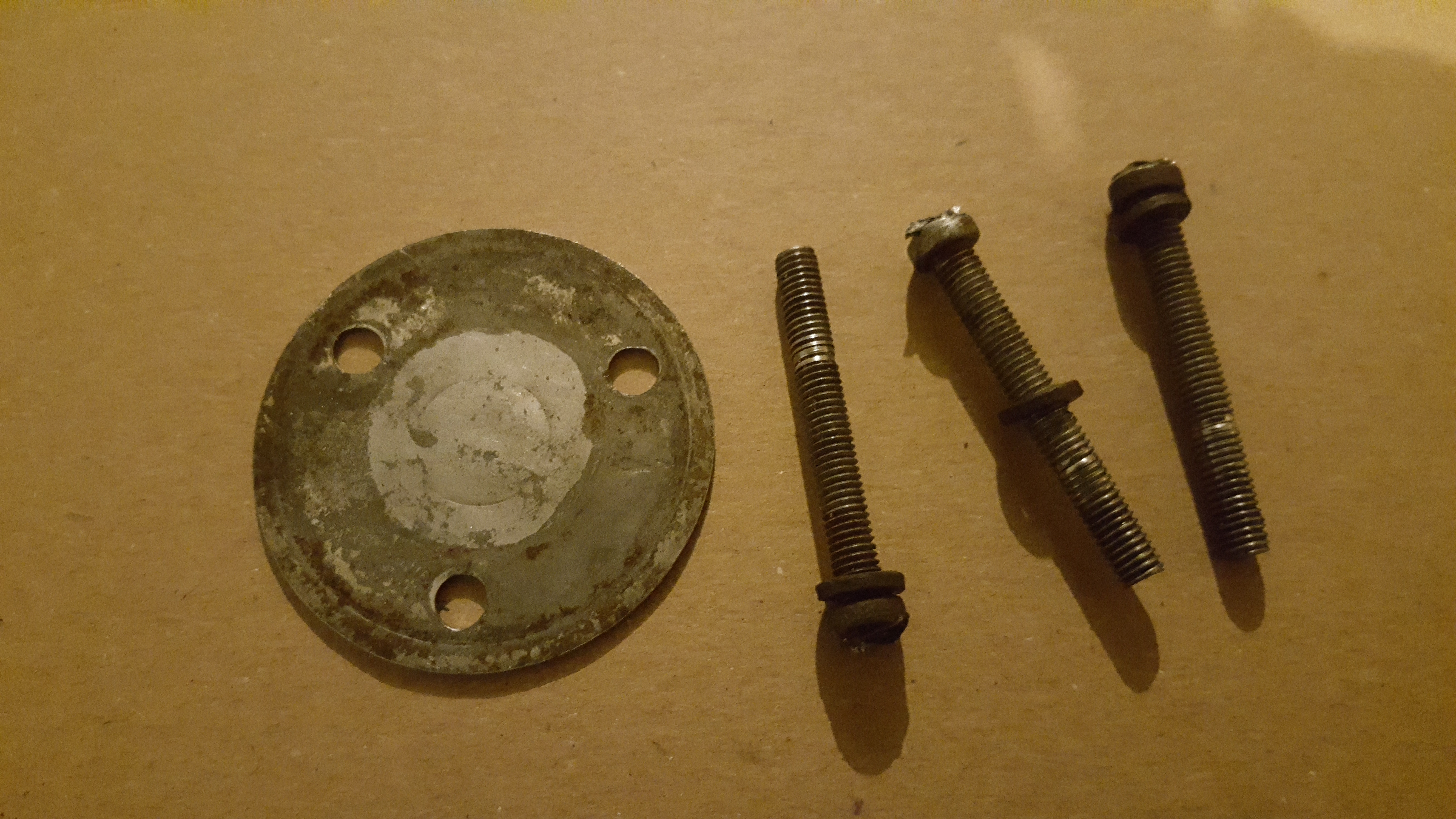

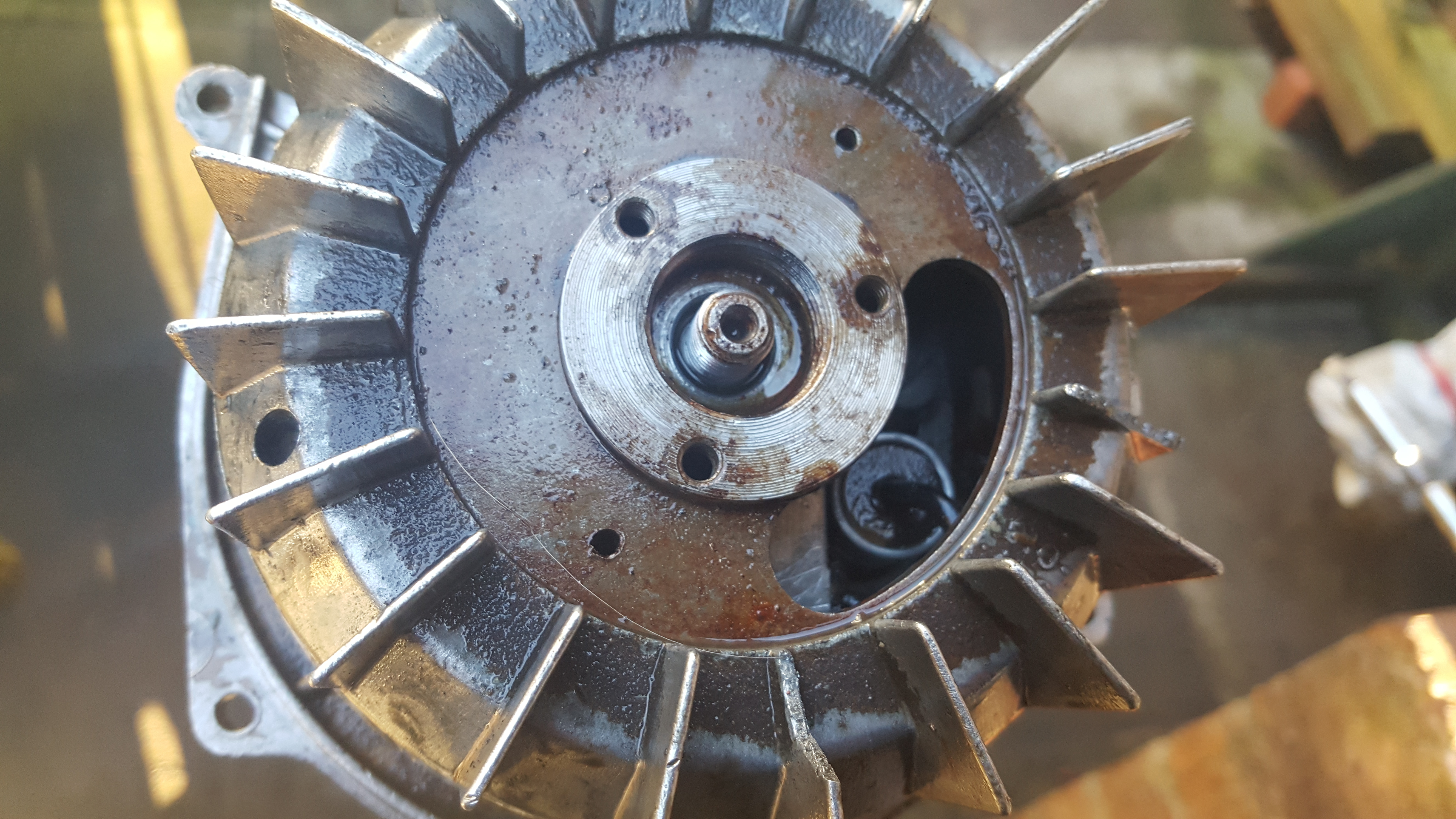

Nice one china i think this has its own puller attached tried what you suggested with these parts it started to bend round plate so think I'll have to get heavier gauge plate and bolts to suit cheers...

Dem bolts look a bit sick
where they like that or did you do it to them while trying to remove the flywheel?
Put some WD40 down the taper for a day or two then have another look.

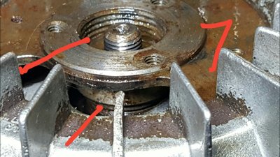

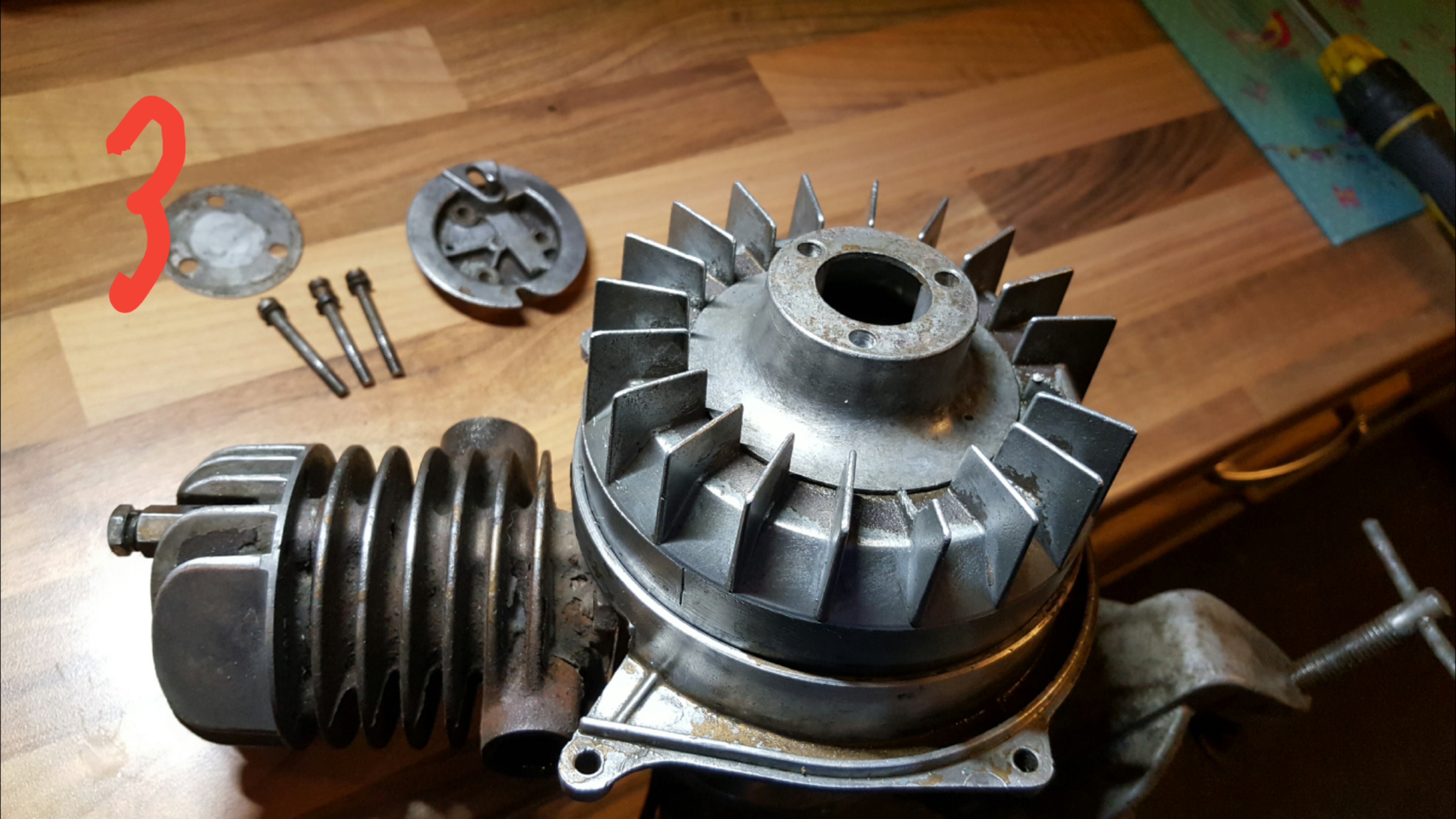

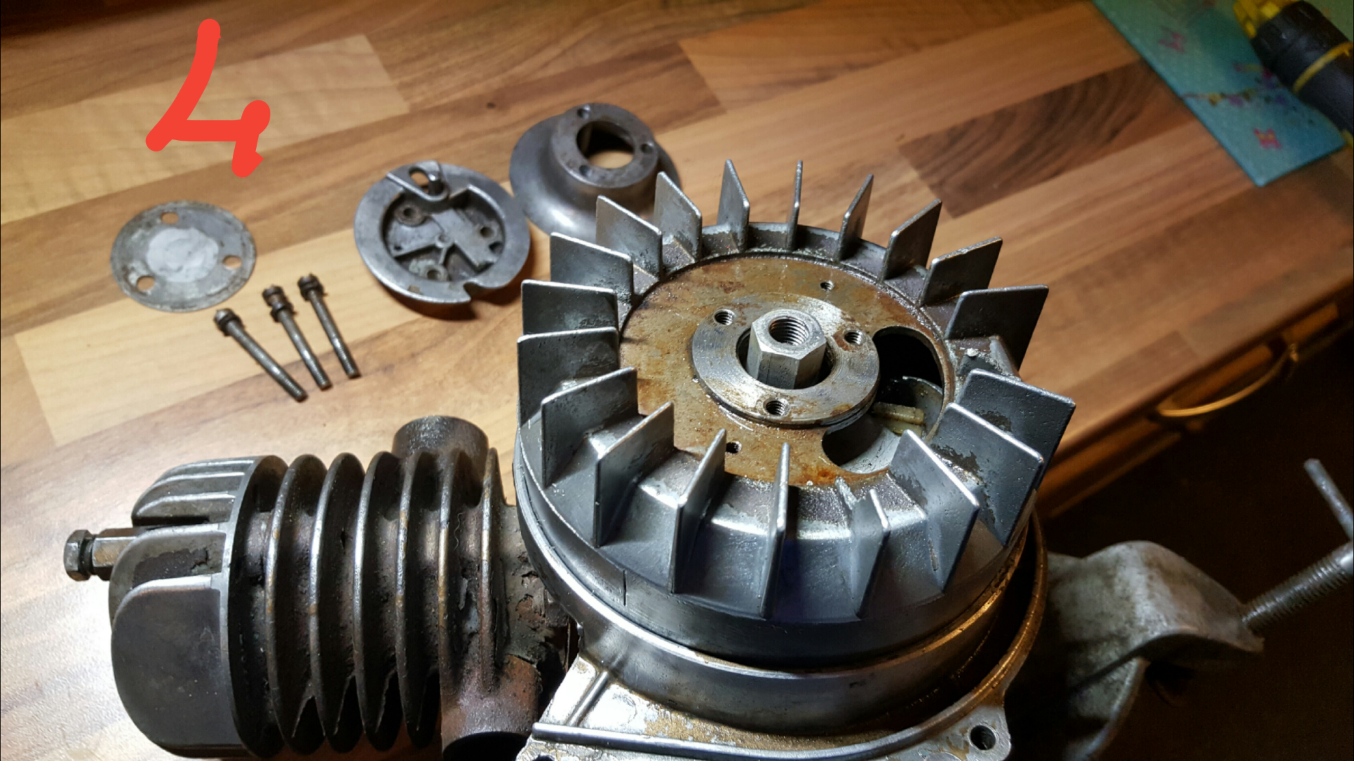

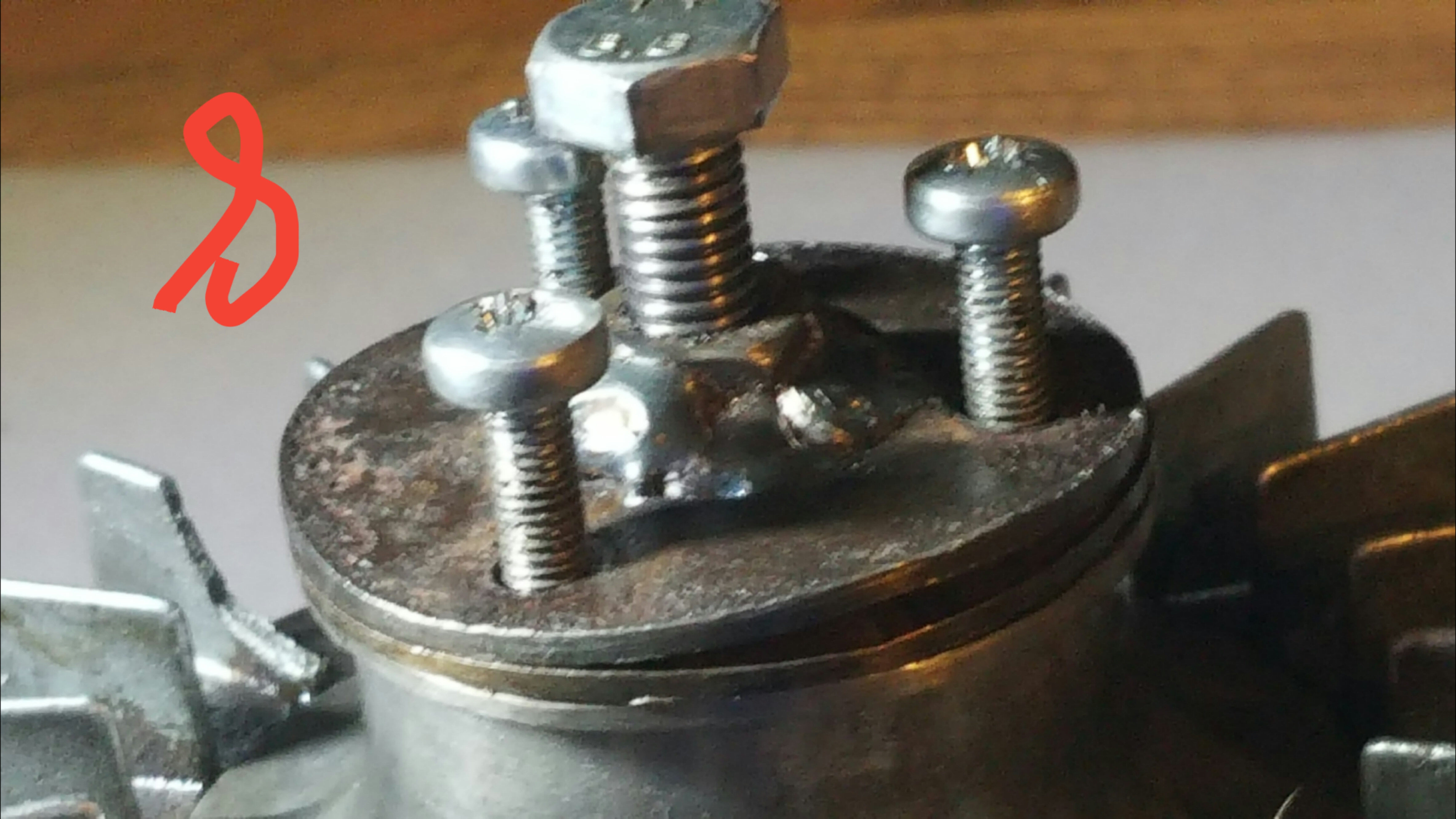

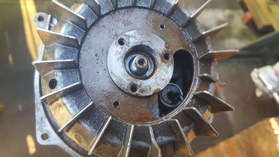

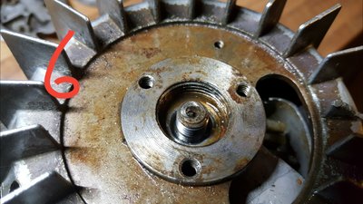

After making up a wee puller I thought I'd give it a go not a shread of movement so back to the drawing board Here's my thoughts please check pic 7 could this flywheel be threaded.
Re: Non seagull outboard I. D
Last 3 pics any thoughts welcome...low and behold it's bending the puller.....

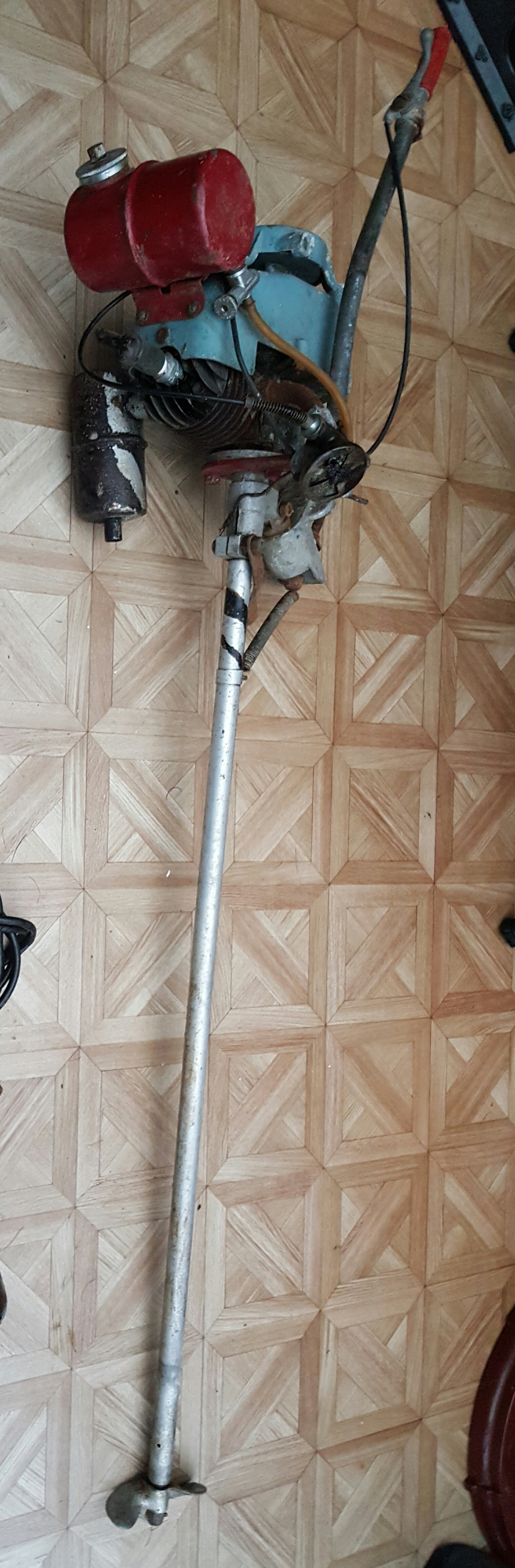

I think it may be a JAP model "O" type 2 34cc two-stroke engine (the type 2 or 28 are the same apart from where the spark plug is)
This may / may not help https://sellfy.com/p/AbD5/
And this https://www.smokstak.com/forum/showthread.php?t=97298
Many thanks nudge the head is now of longer bolt and a heavier hammer done the trick.
