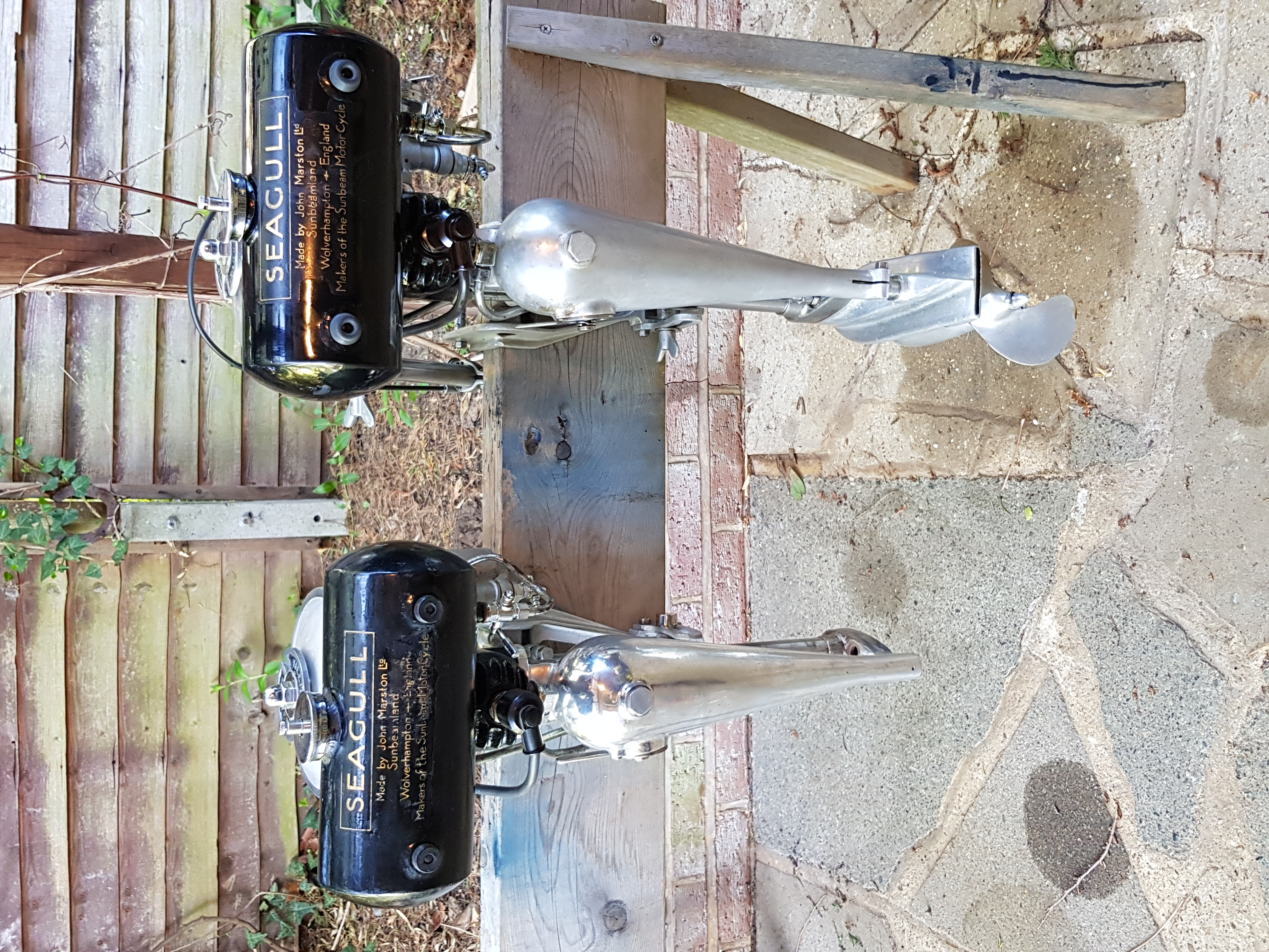

Restoring a Marston OA
Re: Restoring a Marston OA

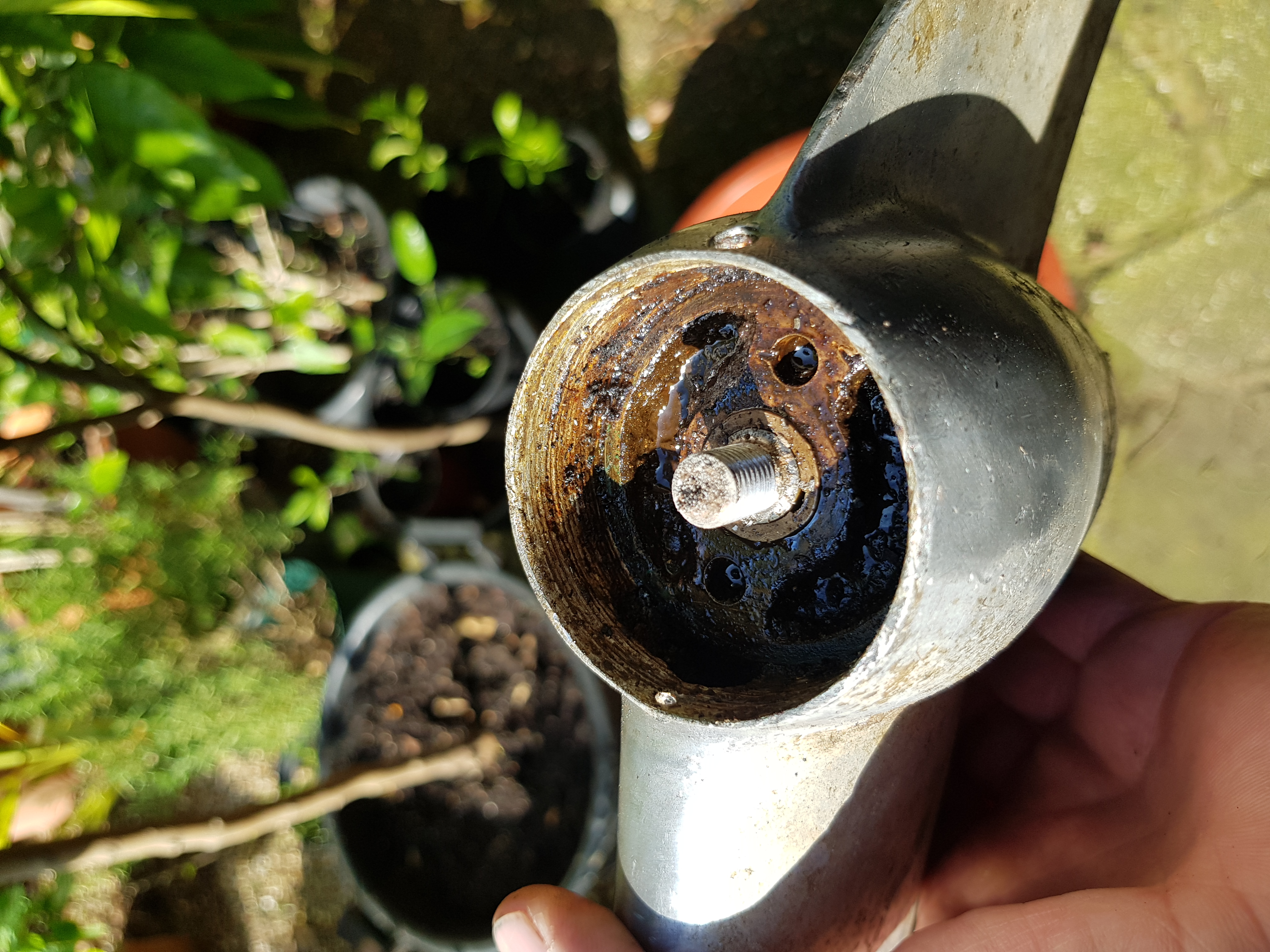

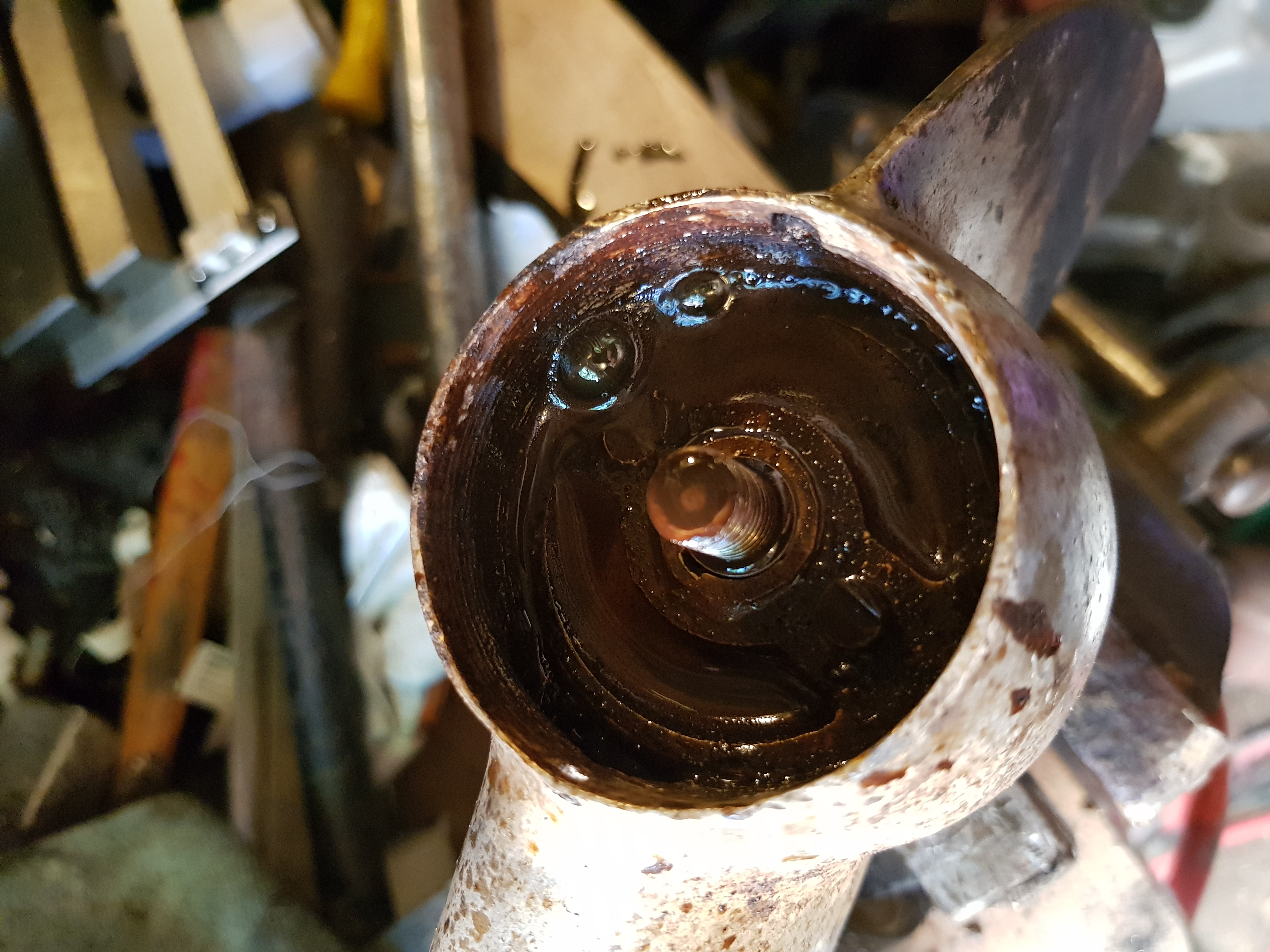

Have tried to remove the impeller, but it wont budge.
Will take pictures of the process.

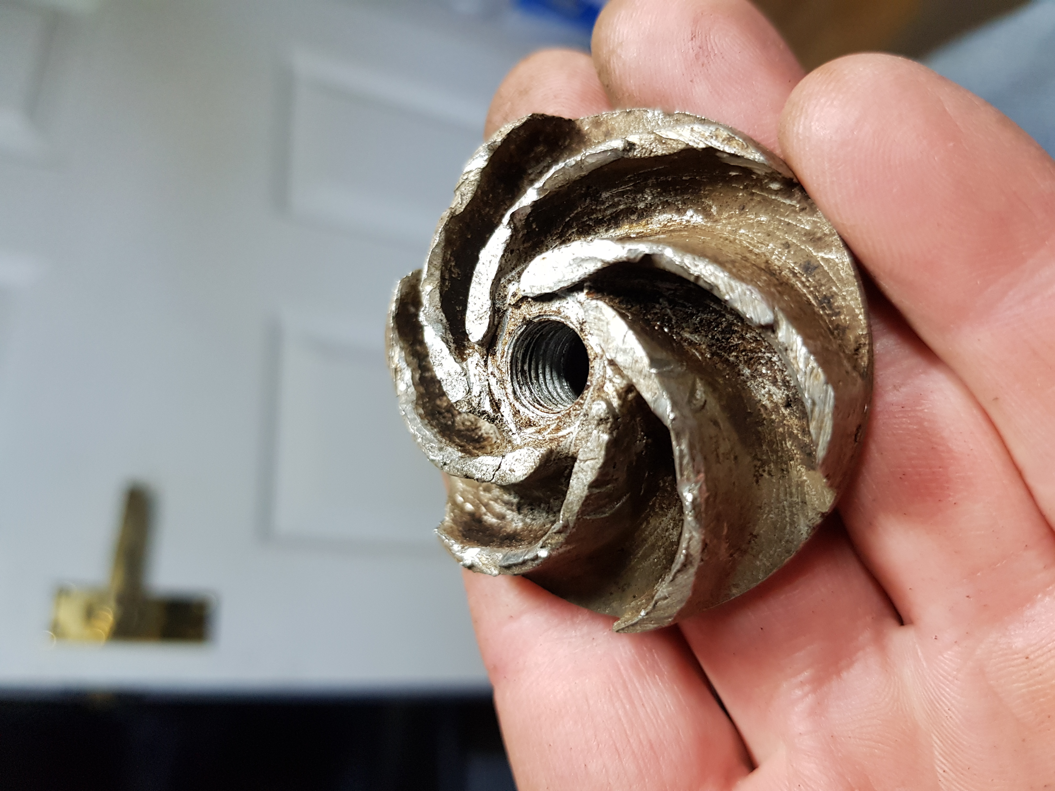

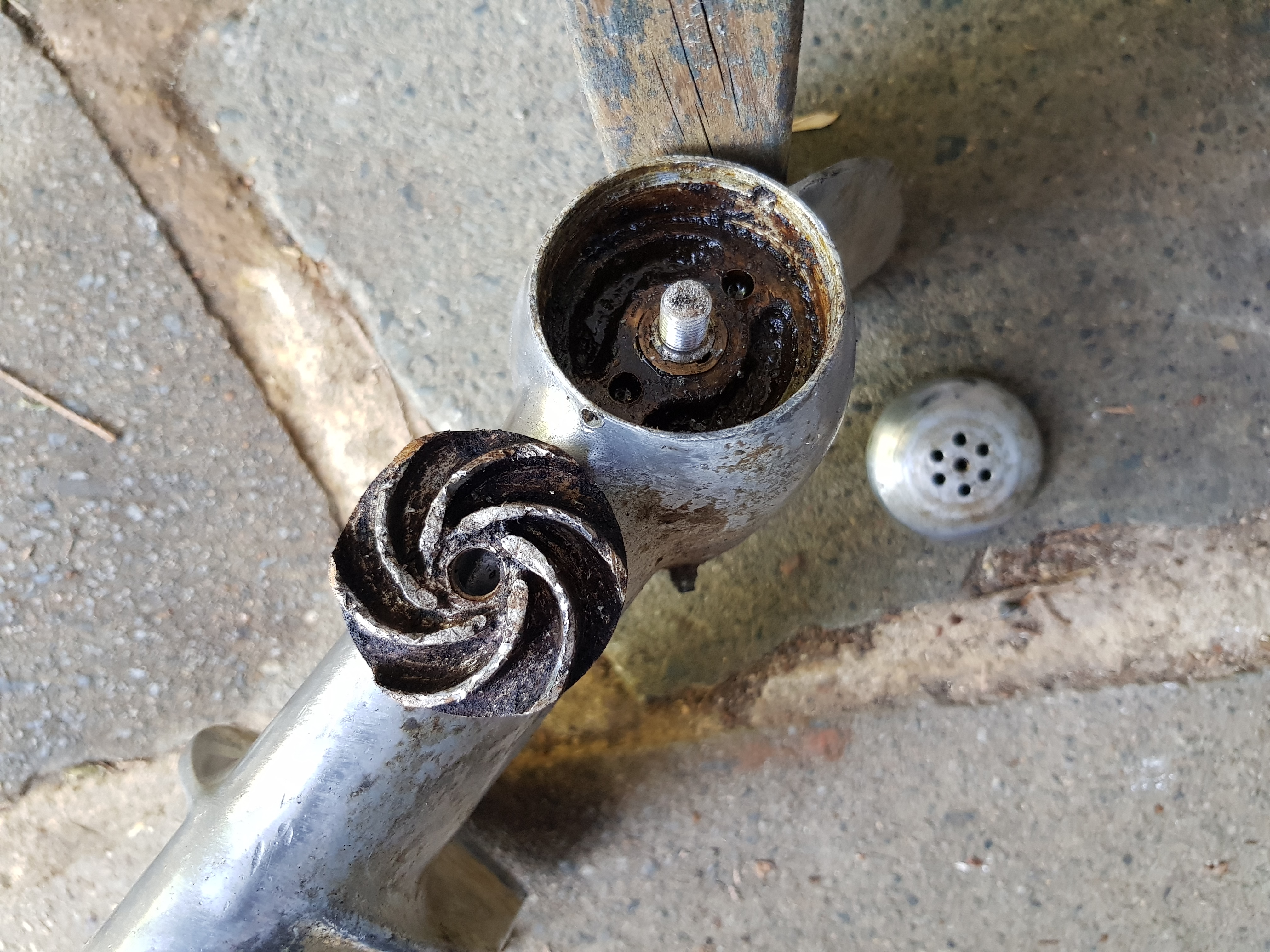

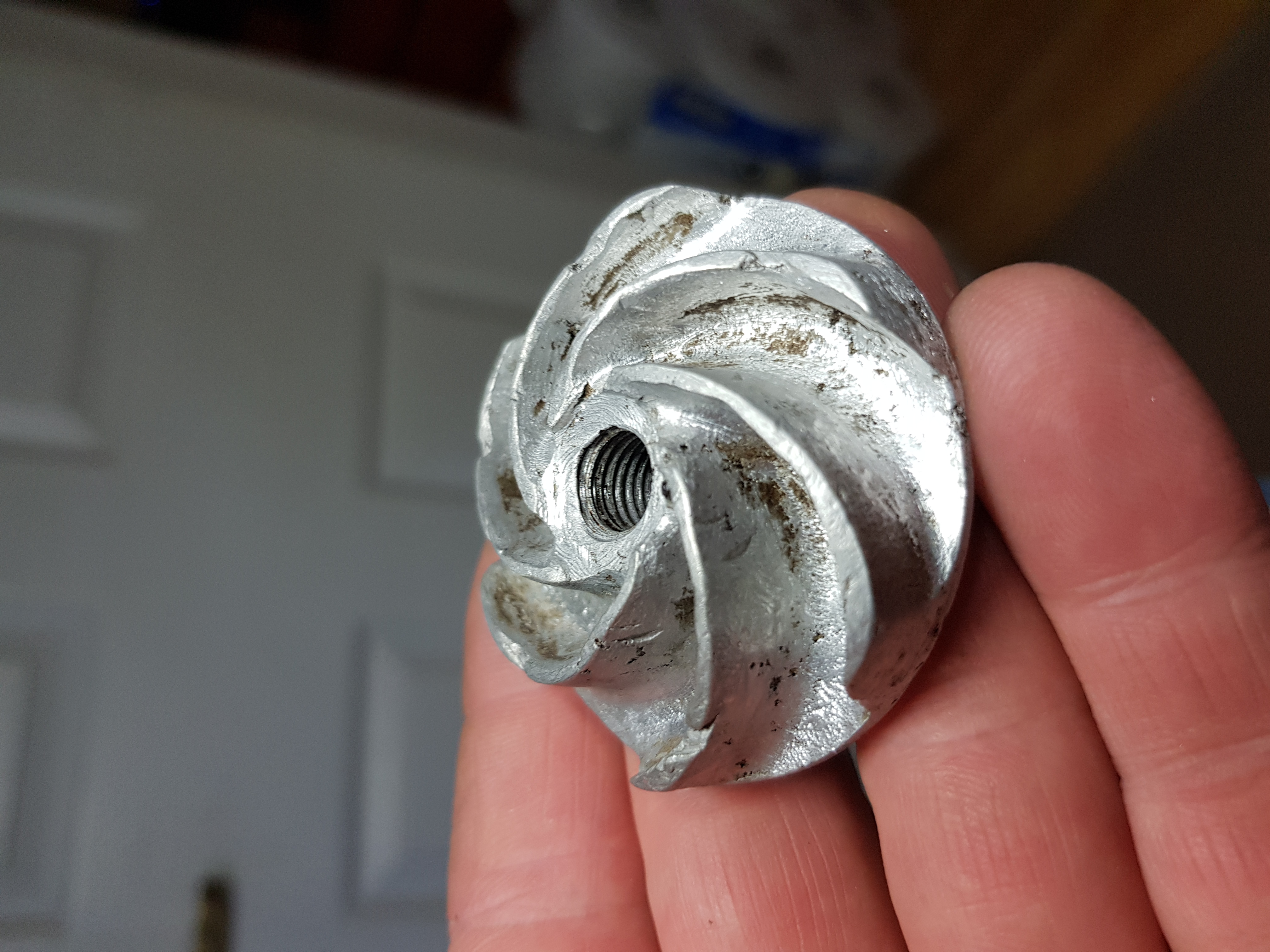

Have taken the impeller off bit bashed by previous maintenance.
Impeller has a right hand thread, gearbox cap has a left hand thread, this cap is an un-threaded replacement.
Threads in box look quite good.
Cleaned up impeller with a dremmel.

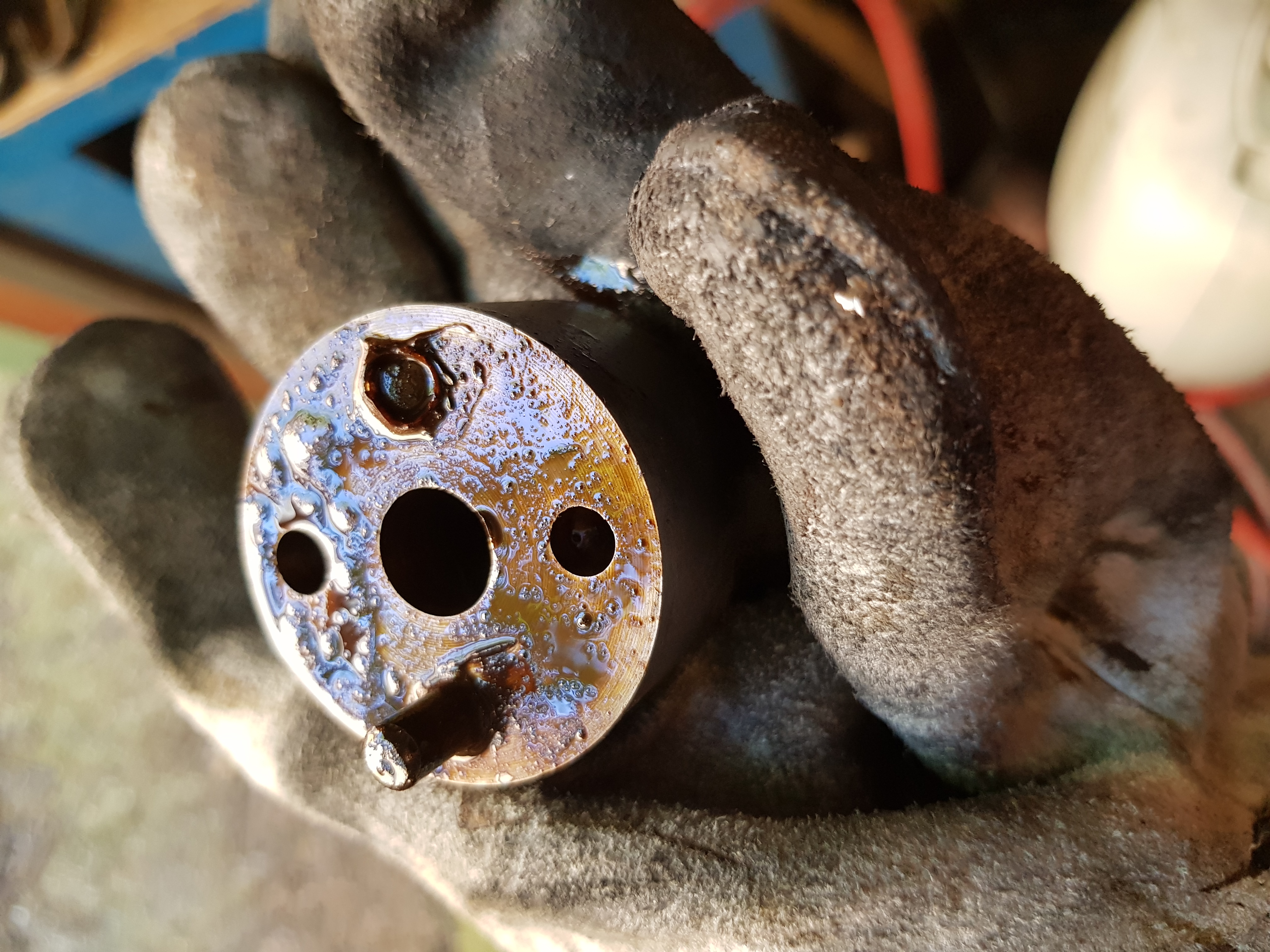

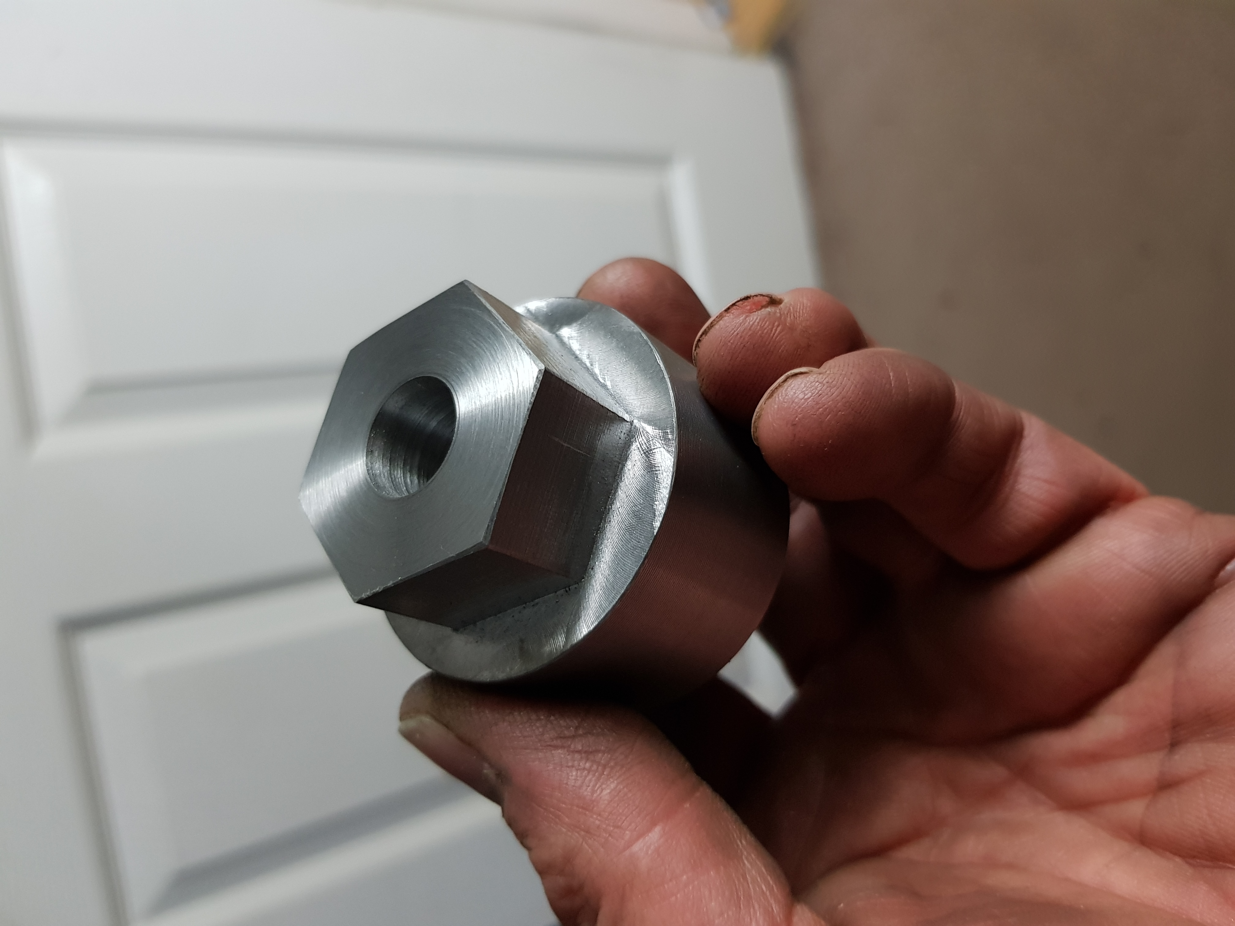

Popped down the shed for an hour, to make the gearbox bearing removal tool.
Just need to fit 2 hardened pins and that should do the trick.
I think Adrian Dale made a similar one when he stripped his gearbox.

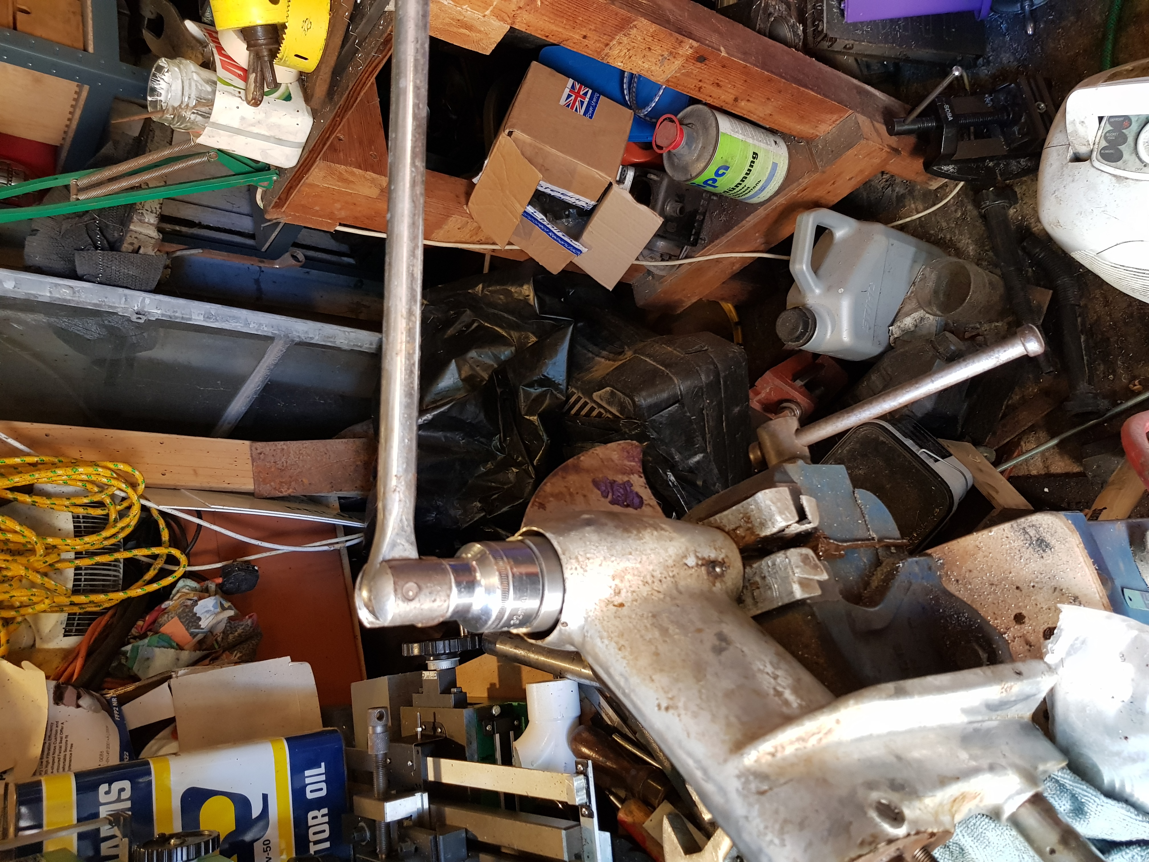

Well that broke :) I did drill 4 holes for pegs just in case
I gave it loads of heat, and got a 3 foot breaker bar on it.
Started to move.
Was quite exciting when the vaporised grease/water in the box, squirted out under great pressure and ignited :shock:
Big ball of flame.
Will try more heat, don't want to melt it.
