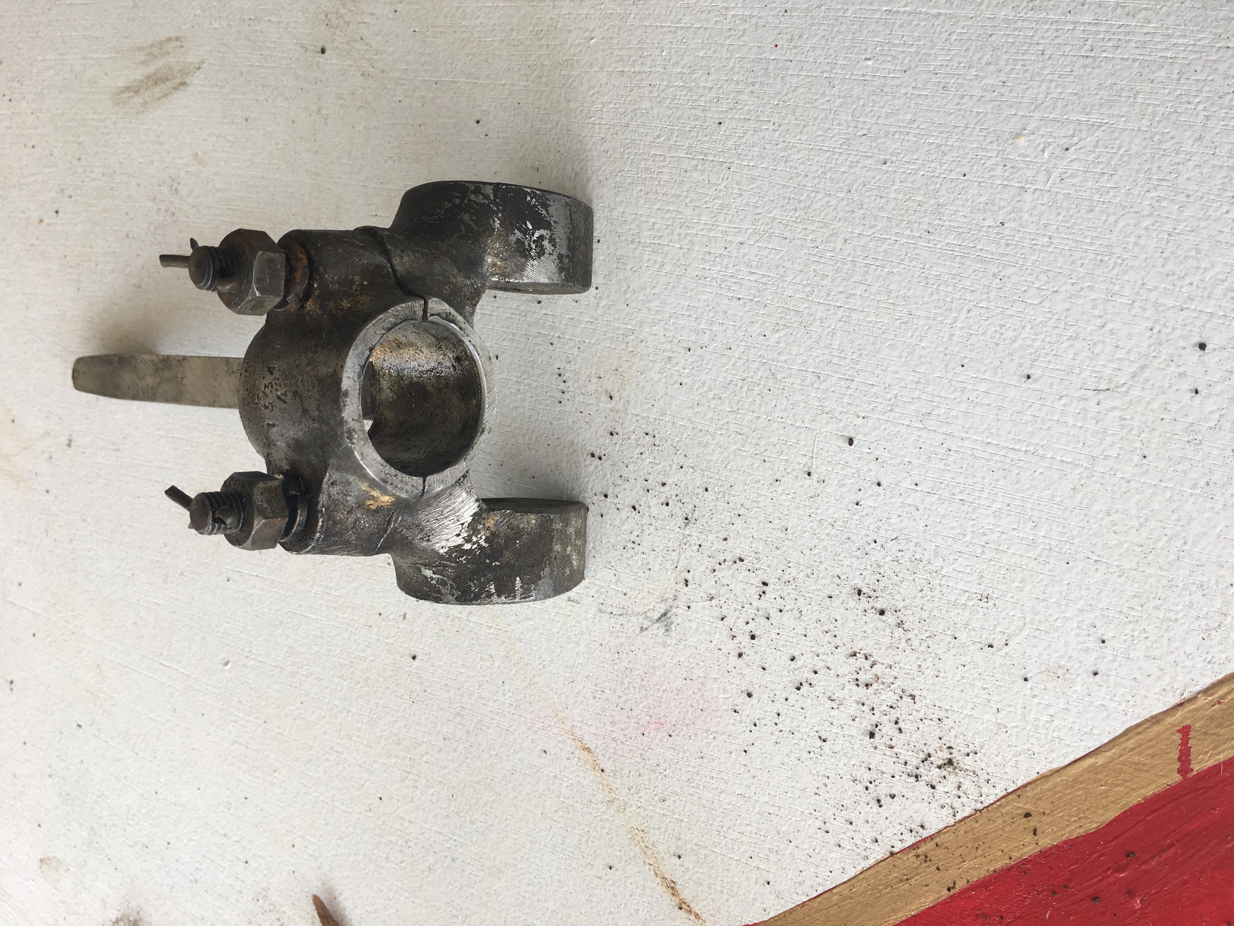

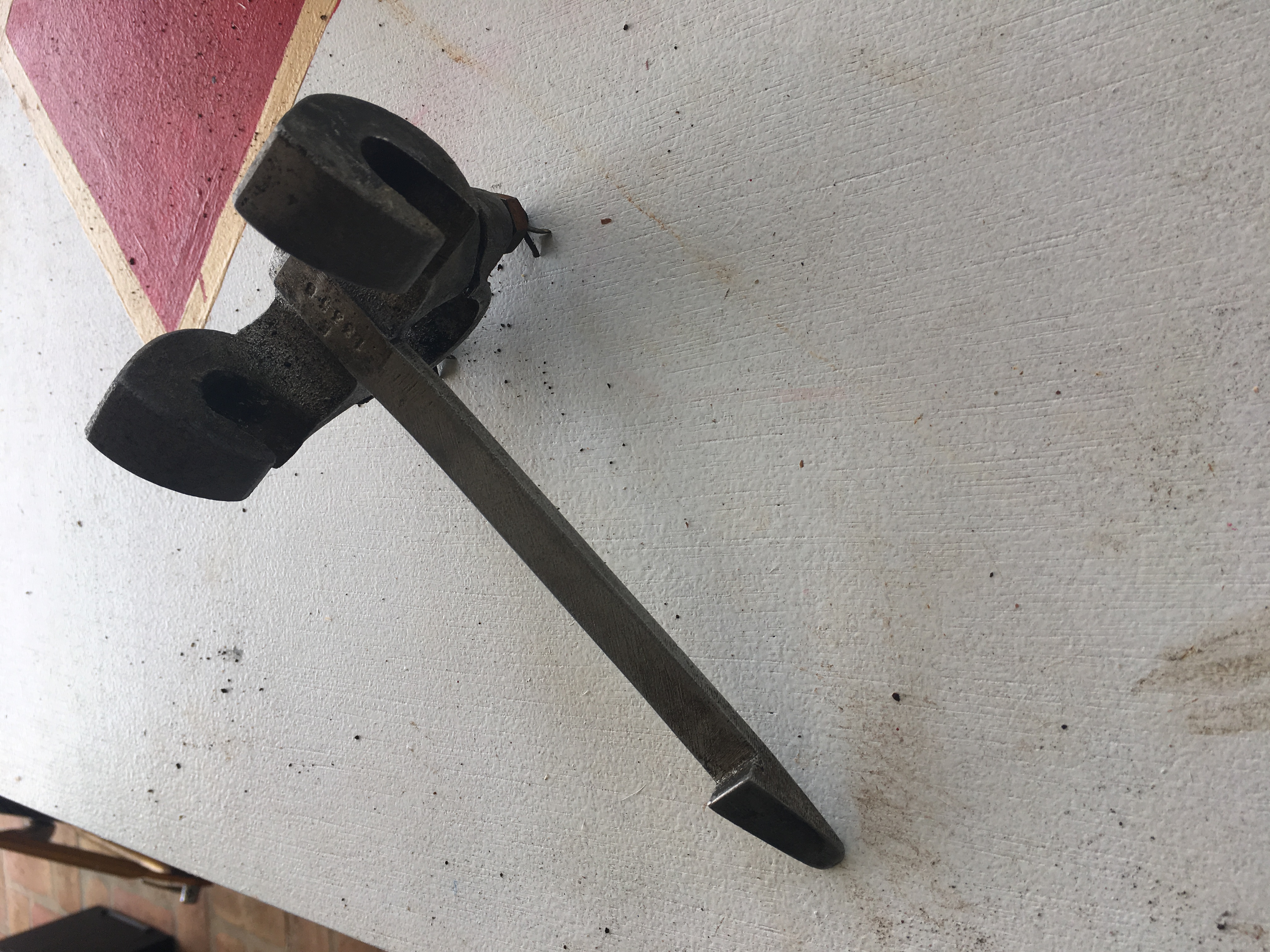

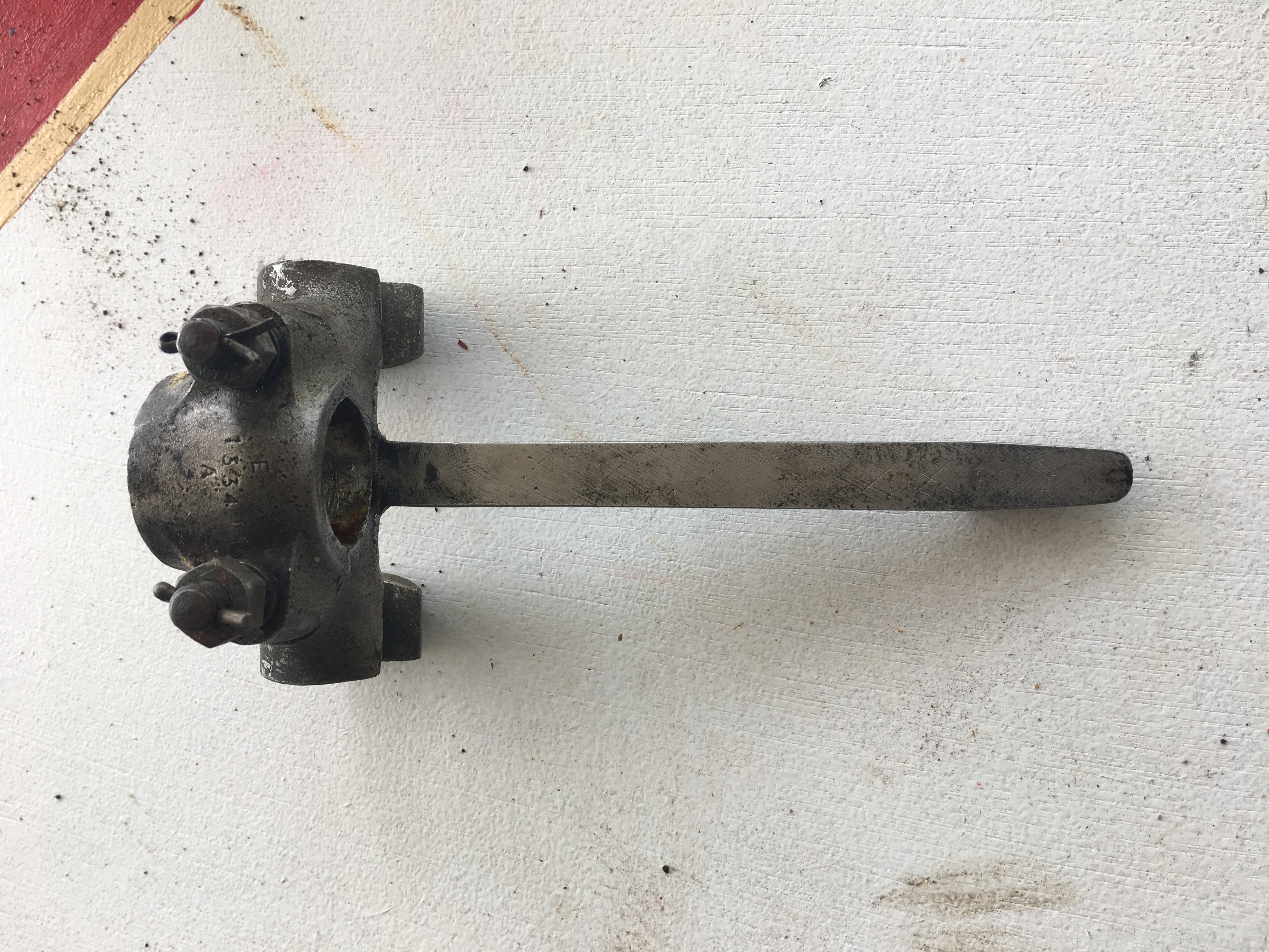

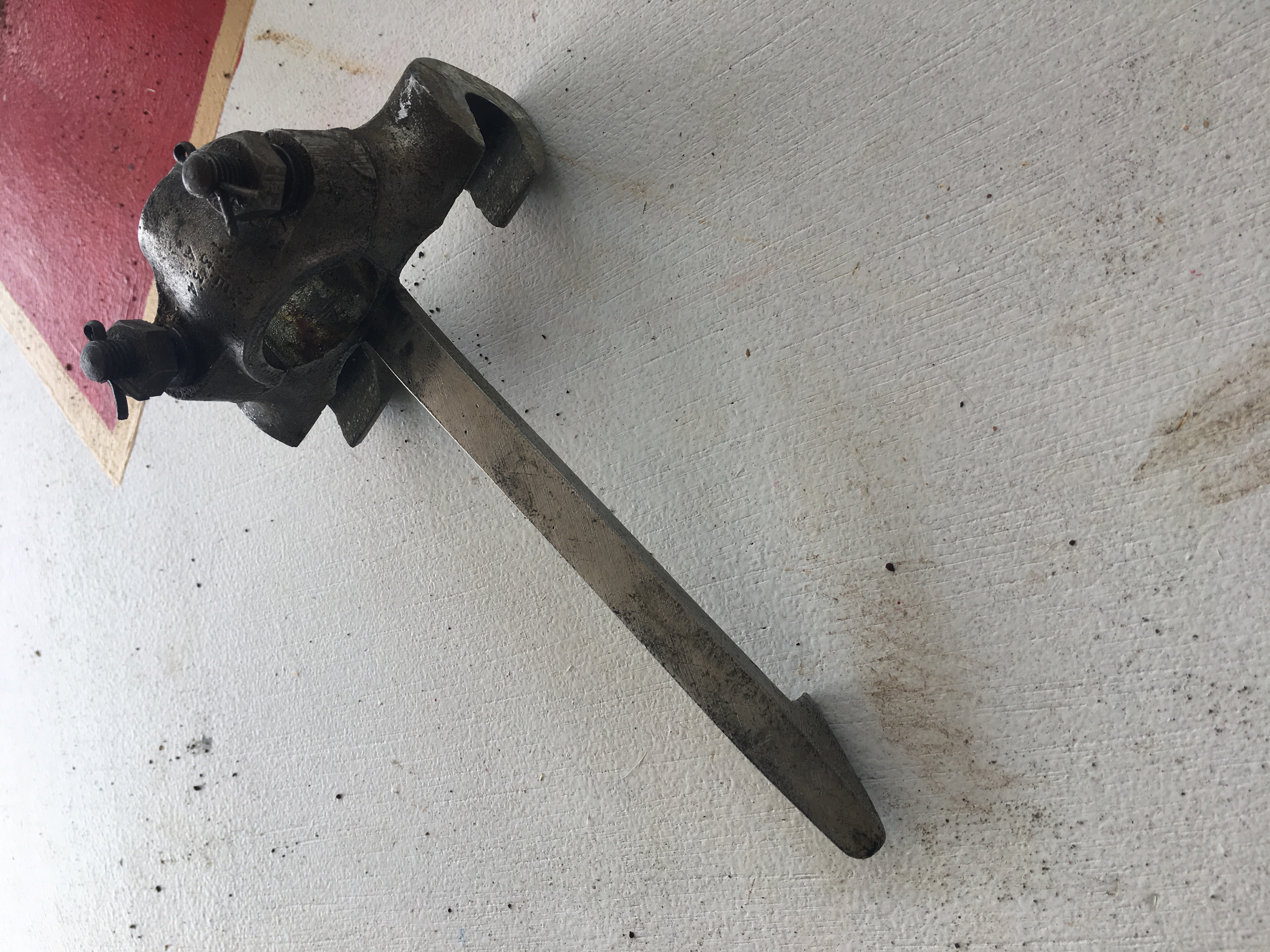

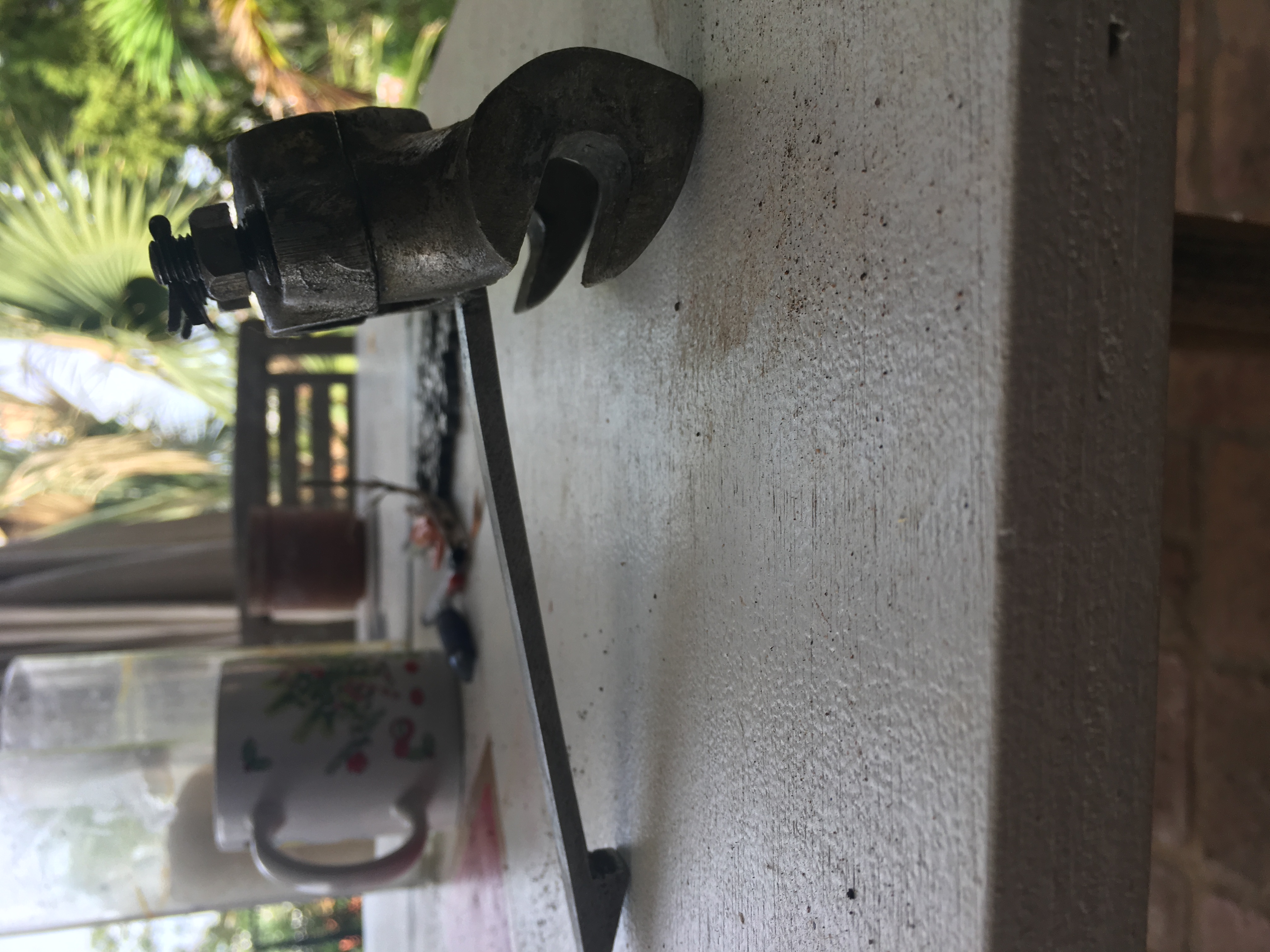

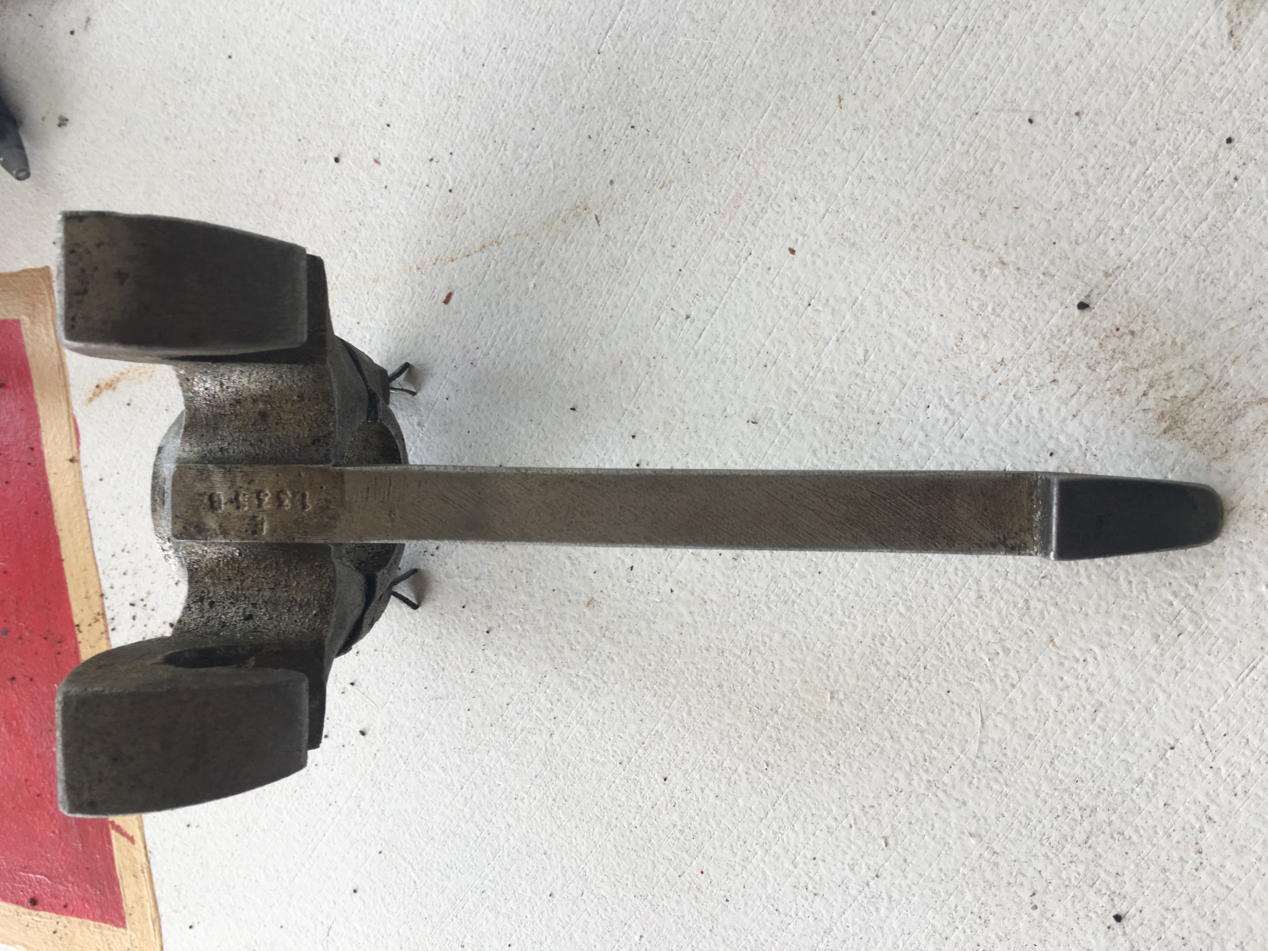

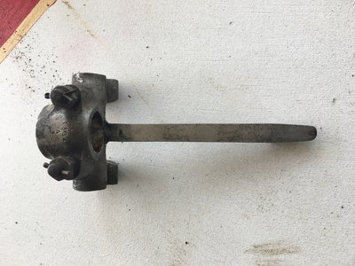

That's not an easy sand cast, can someone post pics from all sides so Nudge can pass comment after he's got a mental picture of what we're talking about.
That's almost a couple of hours draftsman time on the STL drawing

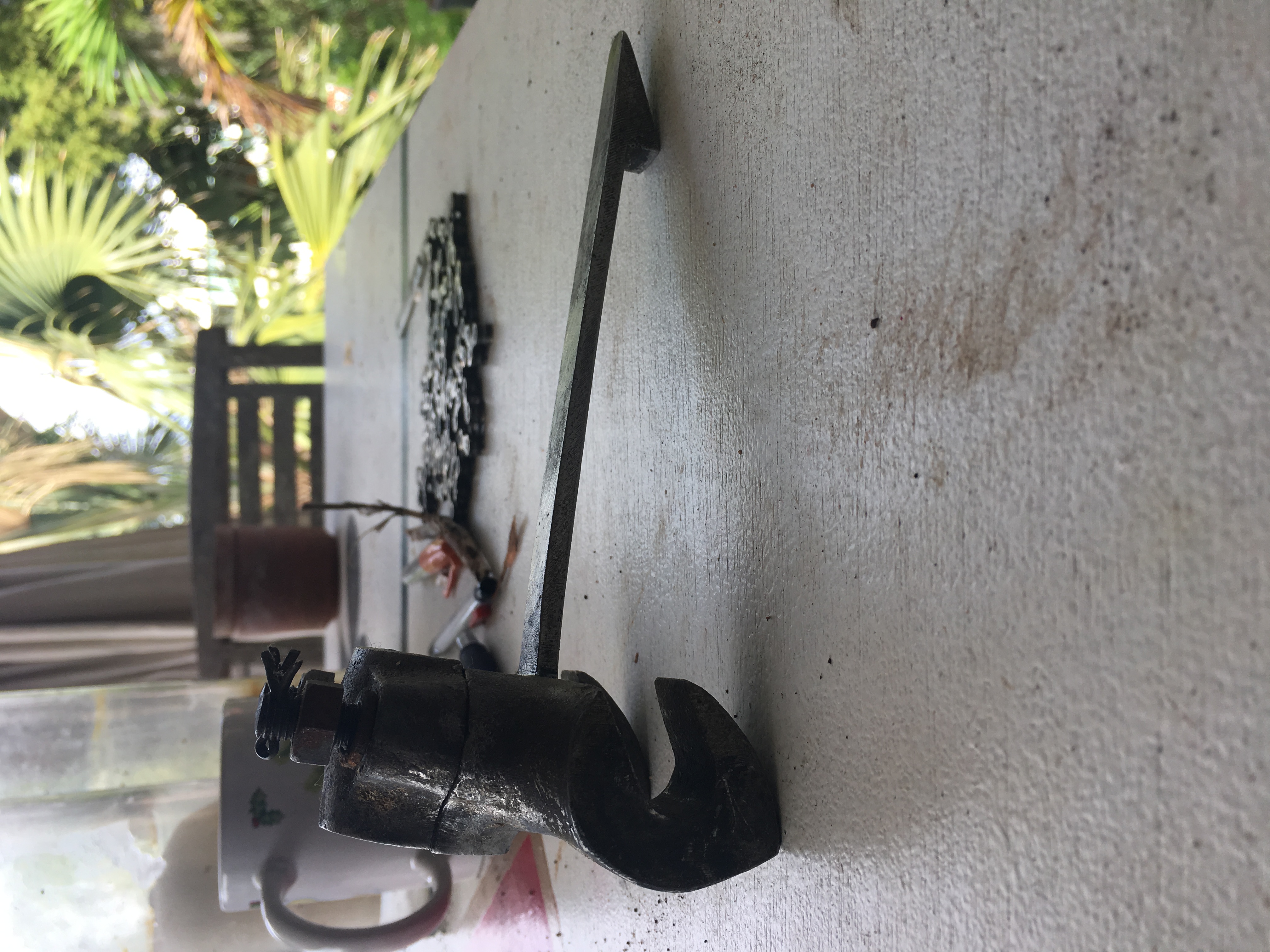

I'd guess a one piece casting then, remove all flashing, clean up with angle grinder, drill for the threads, cap cut off, holes tapped & drilled for clearance, assembled, the drive shaft tube hole drilled out to 1 1/8", then the parting line skimmed on the cap so it will lock up, then scotch-brite up to almost polished level of finish.
Originals are sand cast & the hook slots looked machined not cast.
We are not talking a quick easy job here!

Hugo - I have 2 ali hook ons in good shape with tilt supports intact. I only need one so you're welcome to the other if you'd like. Shoot me an email, if so..?

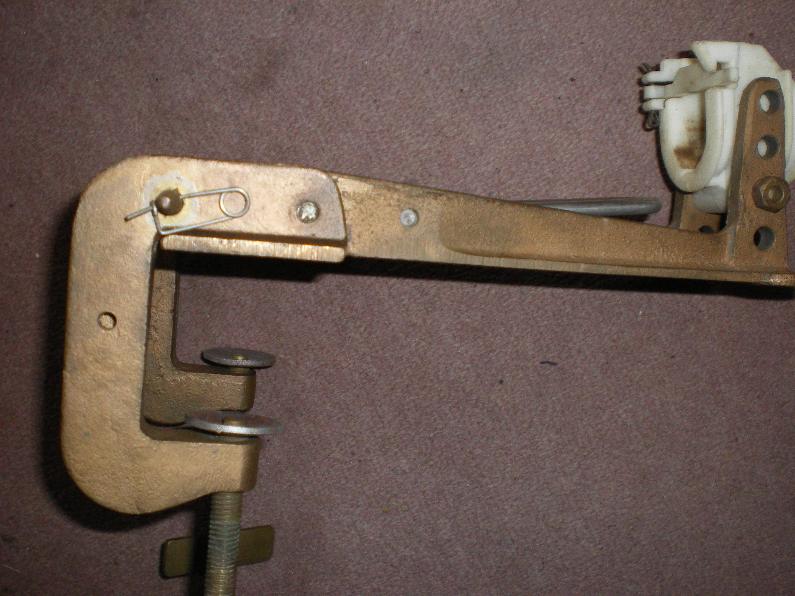

Has anyone found the finish on the brass std later brackets to be appalling?
Drilling 1 1/8"" centre hole is out of my reach but drill/tap, slicing cap and fettling is within my capabilities.
Thought l recognised the balcony and after market coolie lid Adrian
- seagull101
- Posts: 405
- Location: Scottish islands
It's no better or worse than the standard aluminium ones.Has anyone found the finish on the brass std later brackets to be appalling?
Mine is definately worse. Photo probably doesn't show finish.

By the time we have a good part to use as the pattern (be it an orignal or a 3d printed part) there will be a cost to get the drawing done for the STL file OR the cost of posting a part. A part with a tilt hook missing will be ok to use as the pattern, I can 3d print a new part and add it (as long as some one can tell me the size it should be)
The cost of doing the casting itself is another thing altogether, I think I know how I would mould it up, but untill I have one in my hands to have a good look at....
