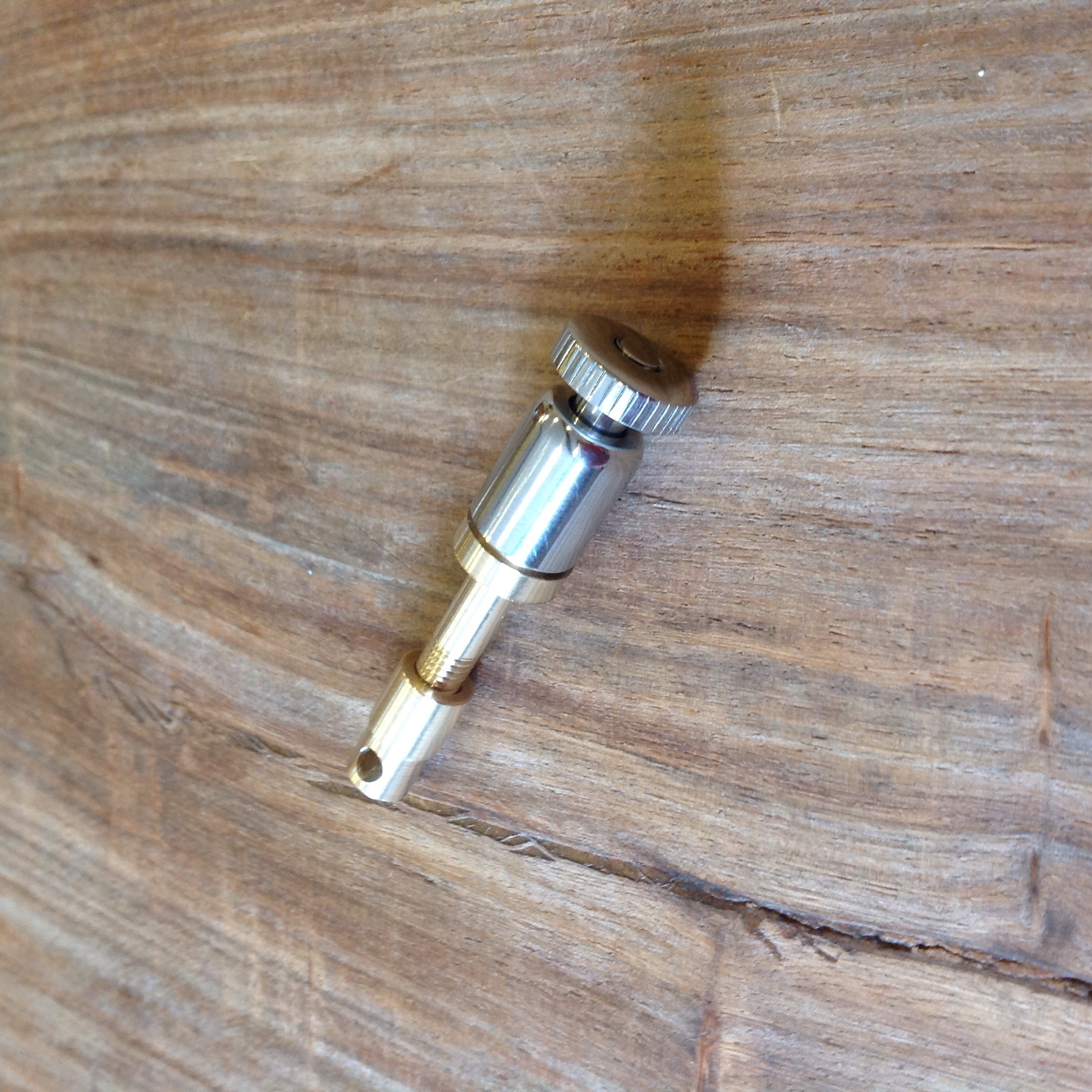

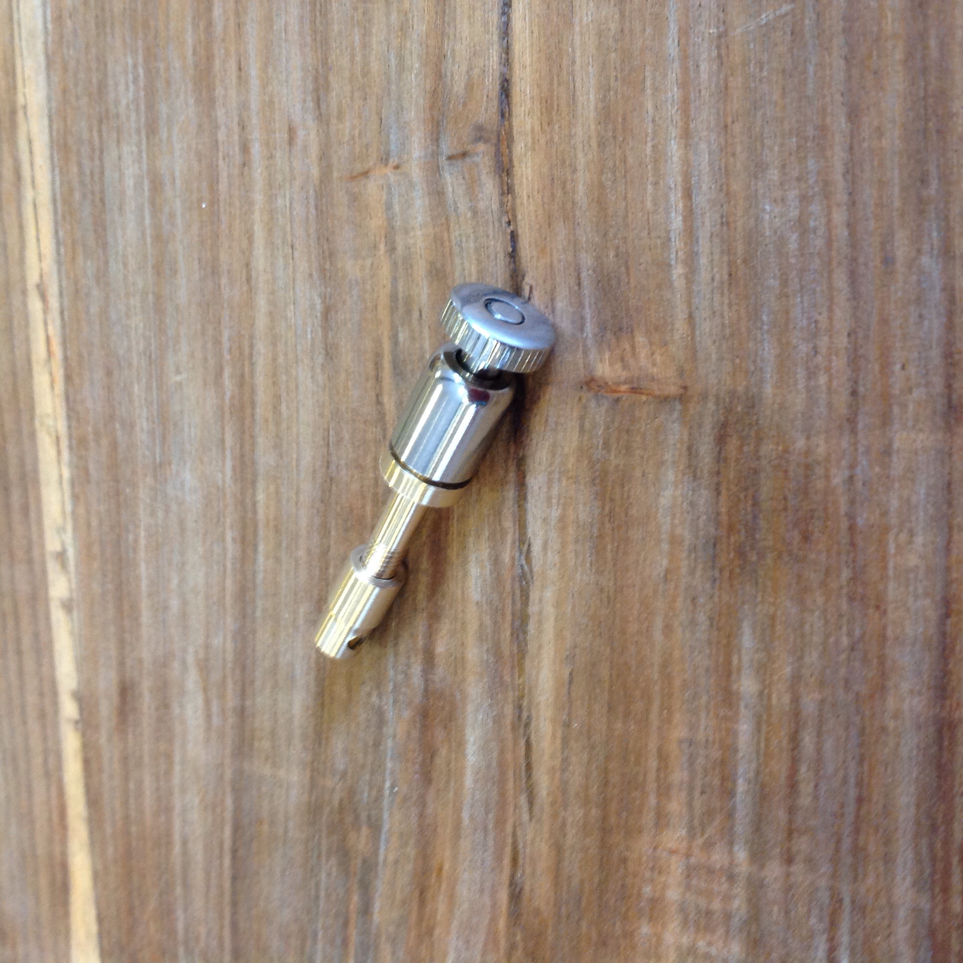

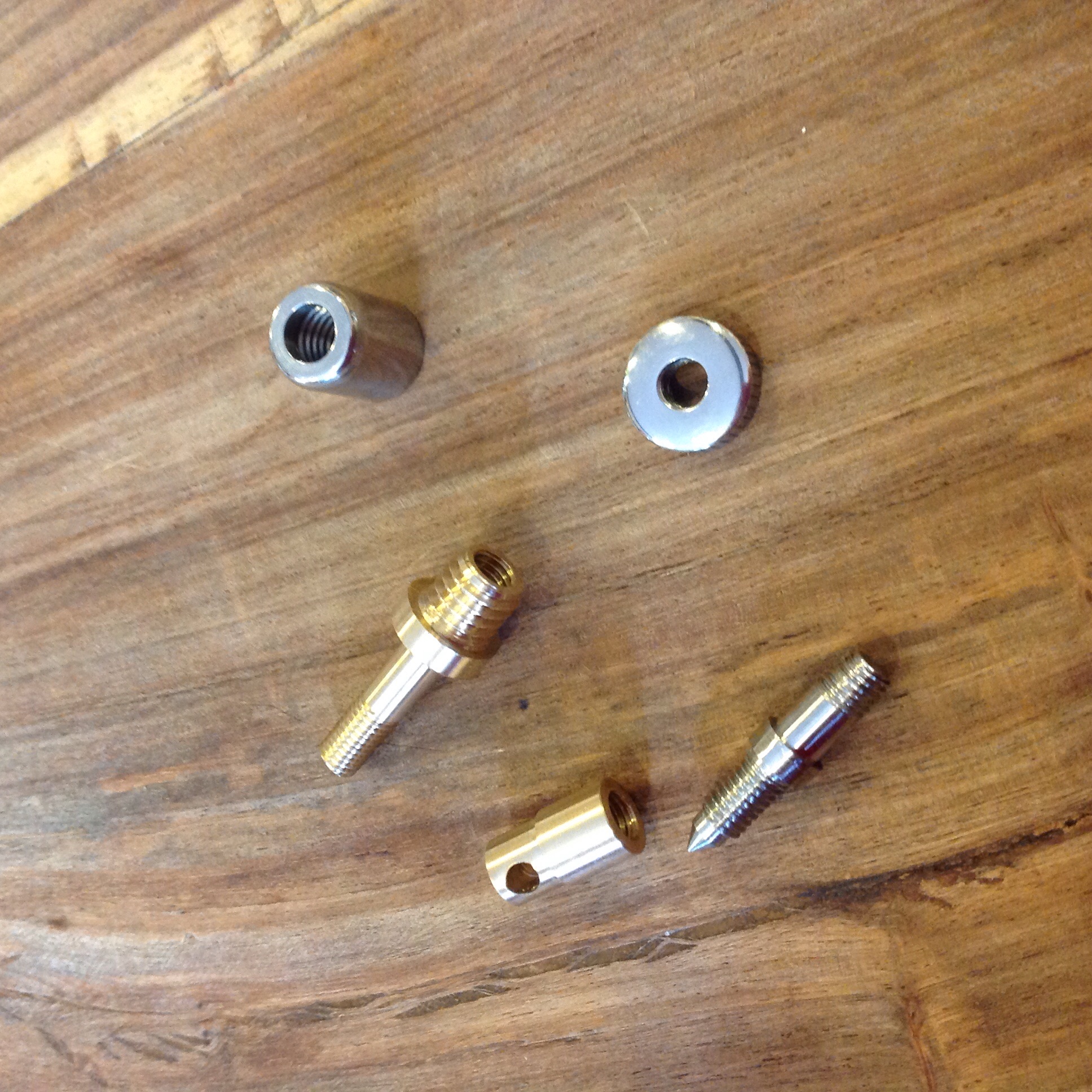

Well I had a couple of hours spare so I thought I'll fabricate an air valve, pretty basic machining, the original were made completely of brass with the visible parts chromed but due to being in Jersey and with no nearby chroming facility I made the visible parts in stainless, Just a bit of fun at the moment but when I make a batch they will be in brass then chromed. The knurled turn screw seems to have come in two sizes from the collection of caps I have, a larger diameter thinner one like the one I made with a diamond knurl and a lesser diameter slightly fatter one with a straight knurl. I put the wrong knurl on as the only diamond one I had was too coarse. Next I'm going to make the dies to press the brass discs, five parts, two to press one disk, two to press the other and one to press the whole lot into the cap, the brass discs are quite deep so I may have to press them in stages meaning I'll have to make an intermediate die.
I'll keep you posted with my progress as time allows,
All good fun.

To say I'm impressed is an understatement....Wow
Re: Bayonet Fuel cap
Nice piece of work Rene!
Nice work Rene, i like that a lot.
Are we going to make air breathers to fit into regular flat top fuel caps with all the necessary washers and fittings, or have i missed something!

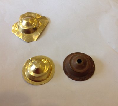

Well, mixed results with making these brass discs, I made several pressing tools but still getting a crease, you were right Charles, more thought needed, I'll get there in the end
