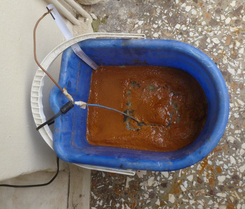

News about my experiment. I put the block on a larger tank and I use as electrode a metal tape doing rounds around the block. It look to be working much better as the floating rust is more than before. The problem is that after one day and a half I have to rasp the electrode because something stuck on it and cuts of the current. The solution gets green under the rust so I suspect that there might be copper (from the gasket) mixed with the rust of the block.
