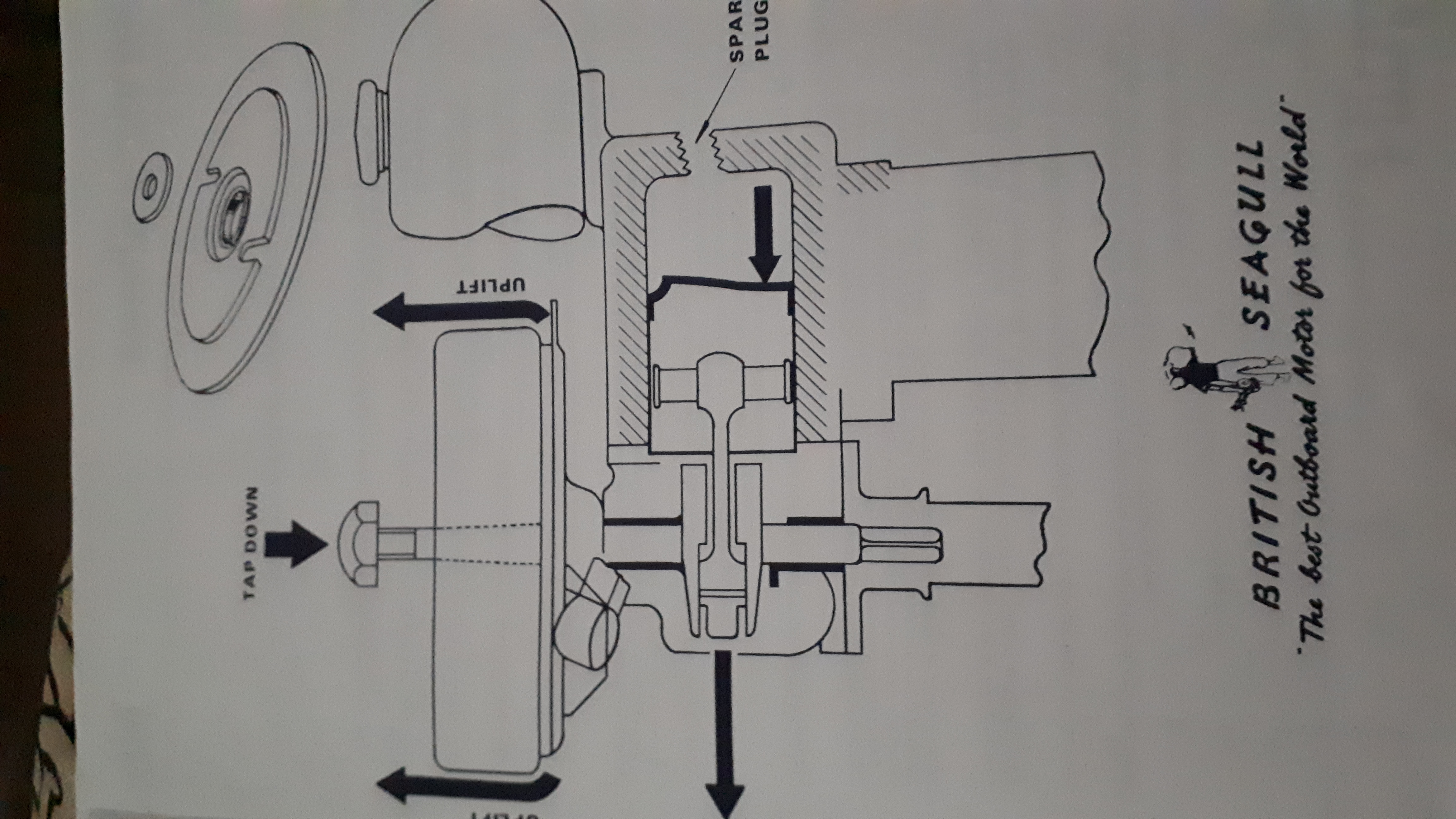

A question, the Service Sheet Number 2 and on the removal of the Flywheel tells you how to remove the flywheel.
It tells you to remove the dome nut, take the cover off and oil the keyway, that is what I did last night.
It them tells you to replace the dome nut and then SCREW IT DOWN FULLY.
If it is fully down how will the shaft free off from the flywheel when you hit the dome nut?
Ok, now I understand, as there are no washers under the nut there is free space for the acrion to happen
It won't screw down fully if you remove rope puller I'd use an old (unbashed) Dome nut.
Posts: 3295
You leave the starter-pulley-plate off. Now you have a space for the flywheel to travel up. Get a mate to hold the flywheel with two hands and the engine off the ground and hit nut with hammer which will break the seal between tapered shaft and flywheel. Undo nut and lift off.....

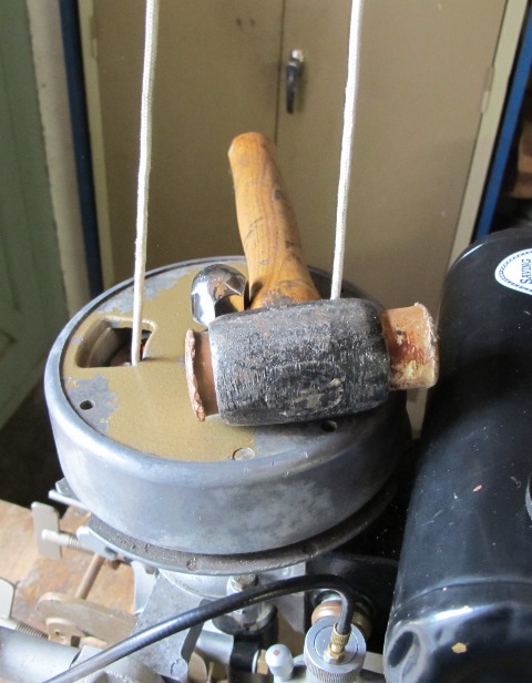

Another question, the user manual part 2 also says the removal of the flywheel is a two man job.
In may case I am alone, can I suspend the motor from a secure point above and then use my 1 pound copper faced hammer to drive the shaft downwards?
I saw a picture where a Cats Cradle of lines was fastened around the outer edges of the flywheel, I can do that option also>
Advice please.

A brave man would stick 2 fingers in the flywheel recess and take the weight of motor in one hand whilst whacking with the other remember the further that it's of the ground the further it's conna fall...
