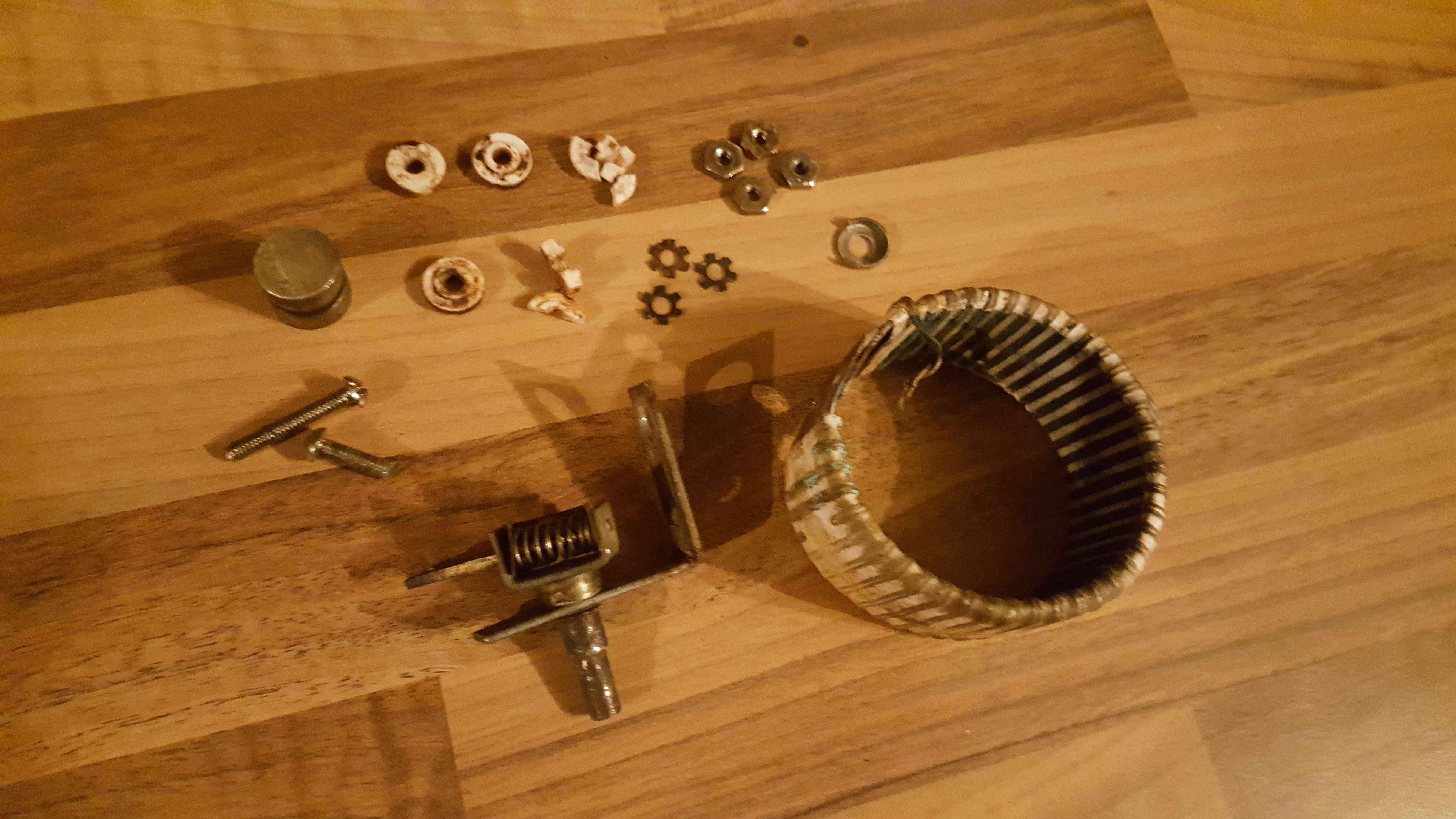

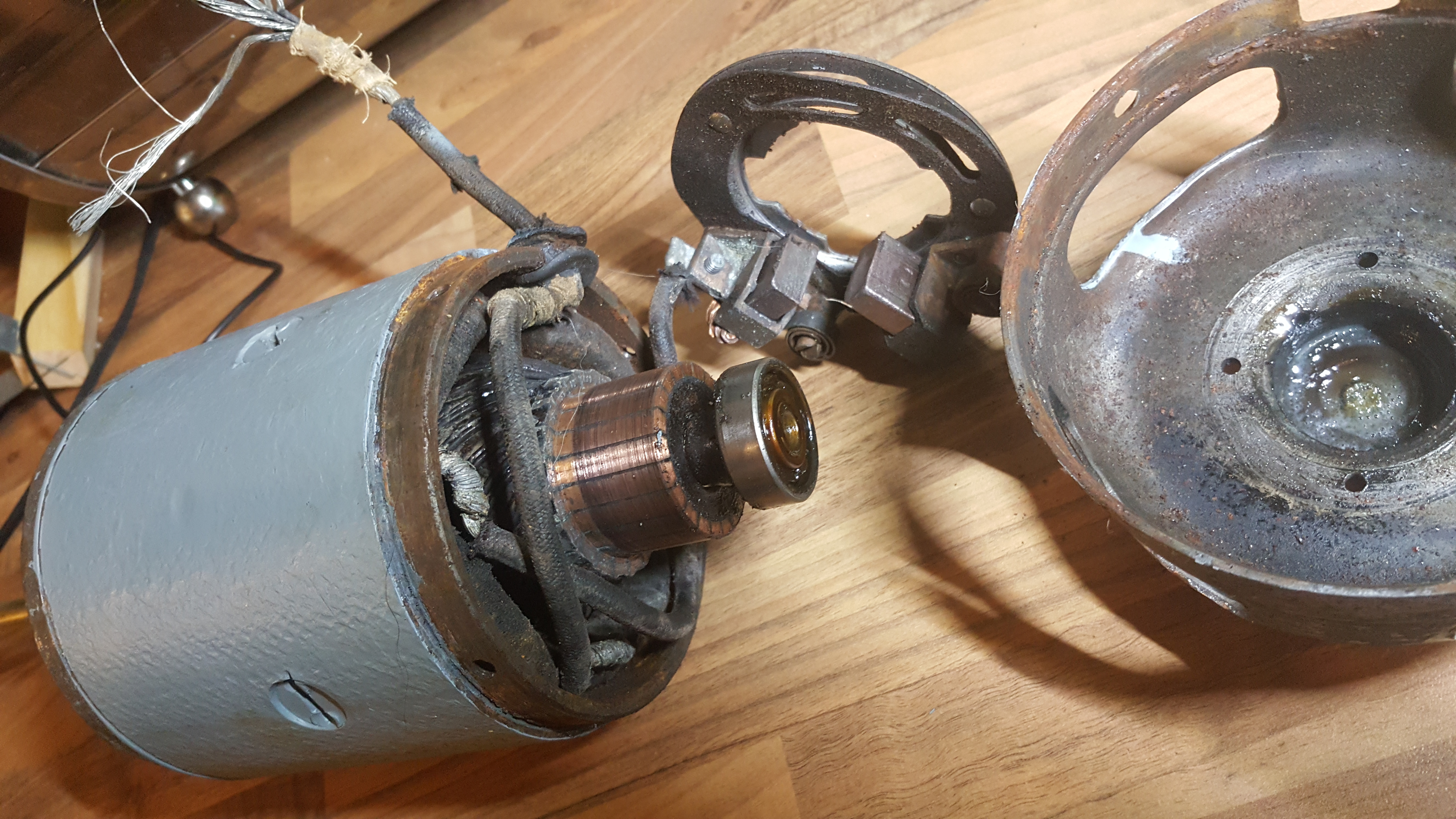

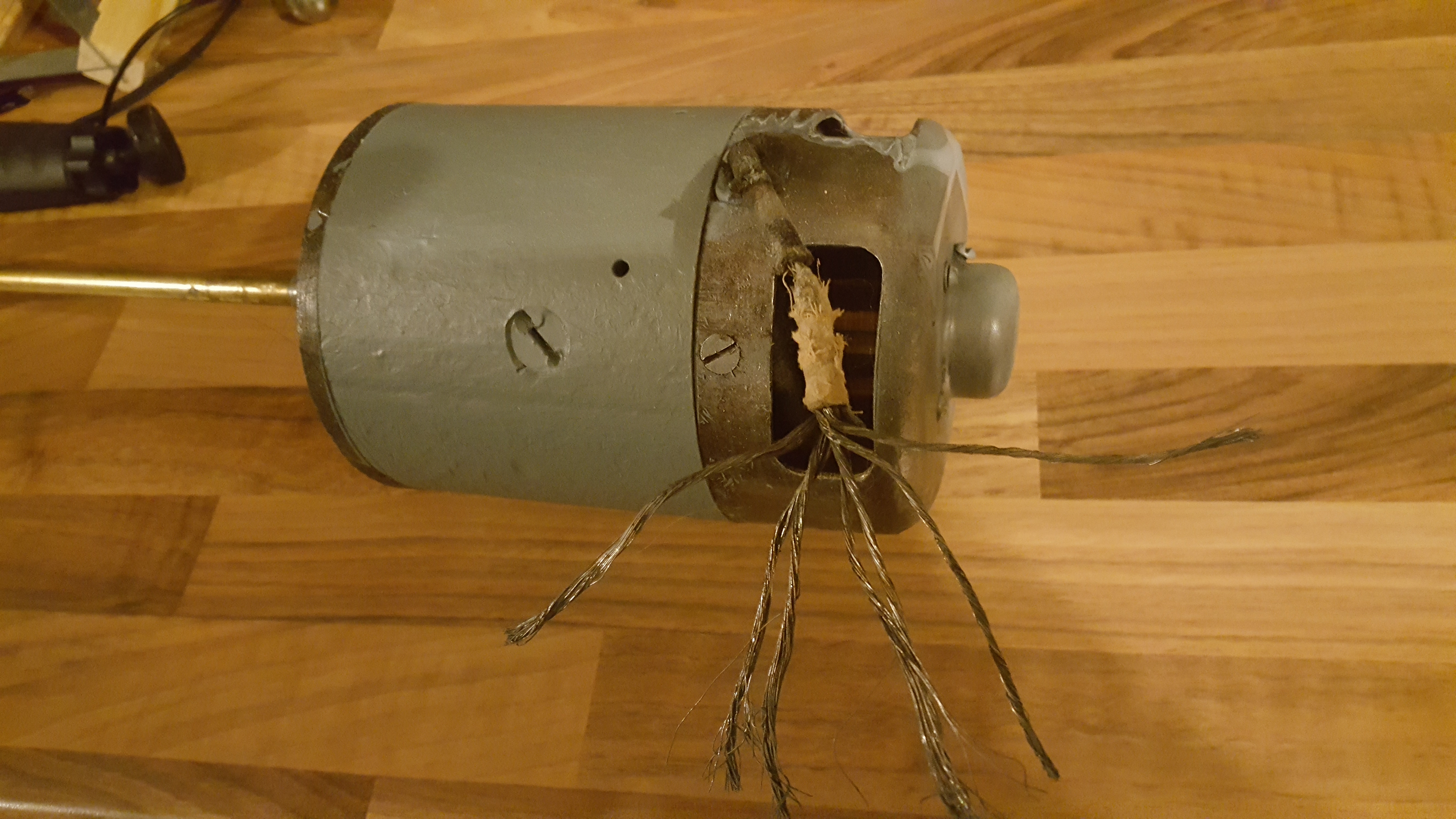

There is a chance that it is asbestos in which case l would suggest you give it a light scrub in a mixture of water and vinegar (no dust) with a toothbrush. Clean the inside windings with a fine grade emery cloth so there is good connectivity as well as the slider. Use a bit of masking tape on the inside, slider contact and connection terminals and varnish the rest (rattle can varnish).

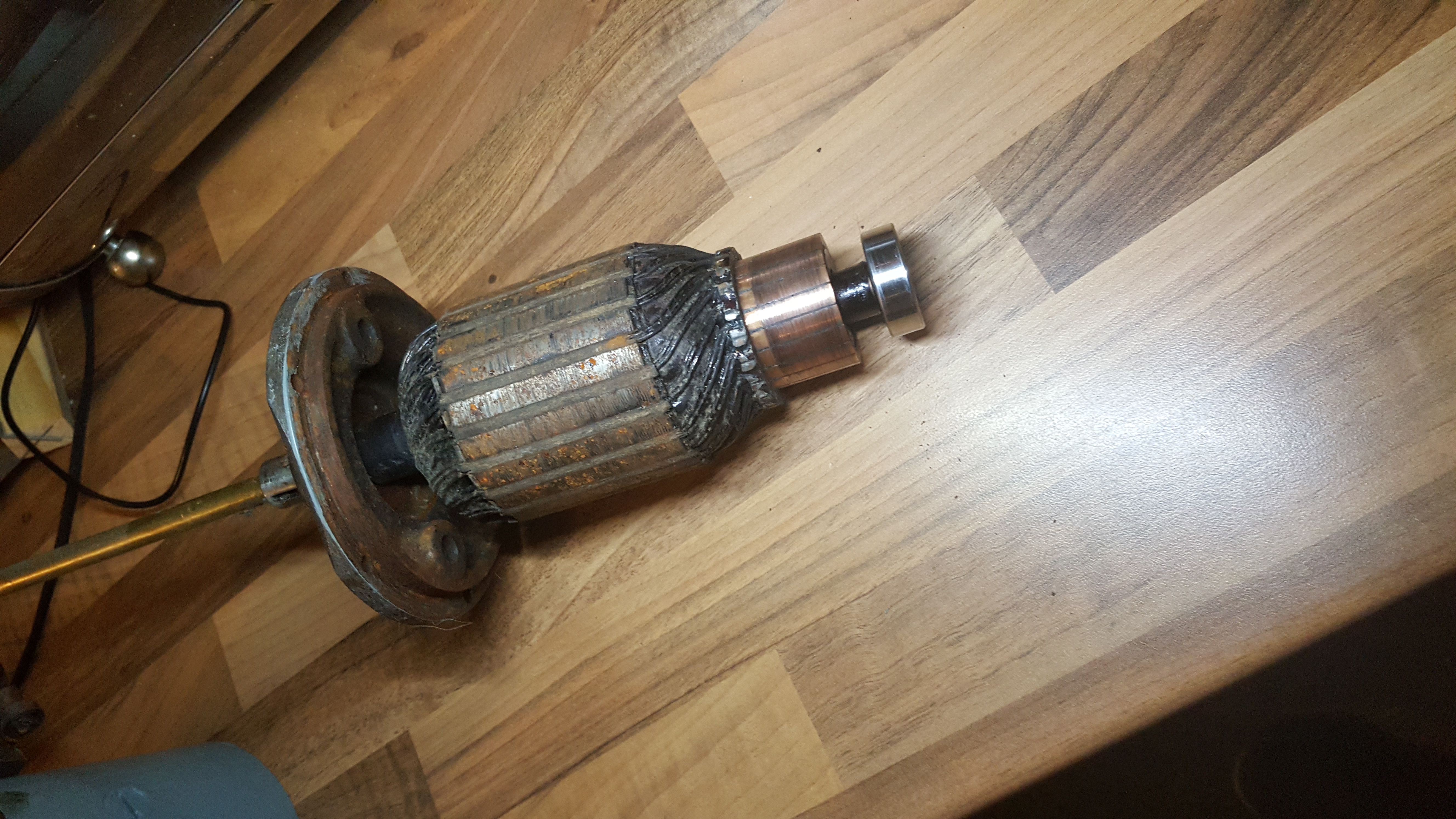

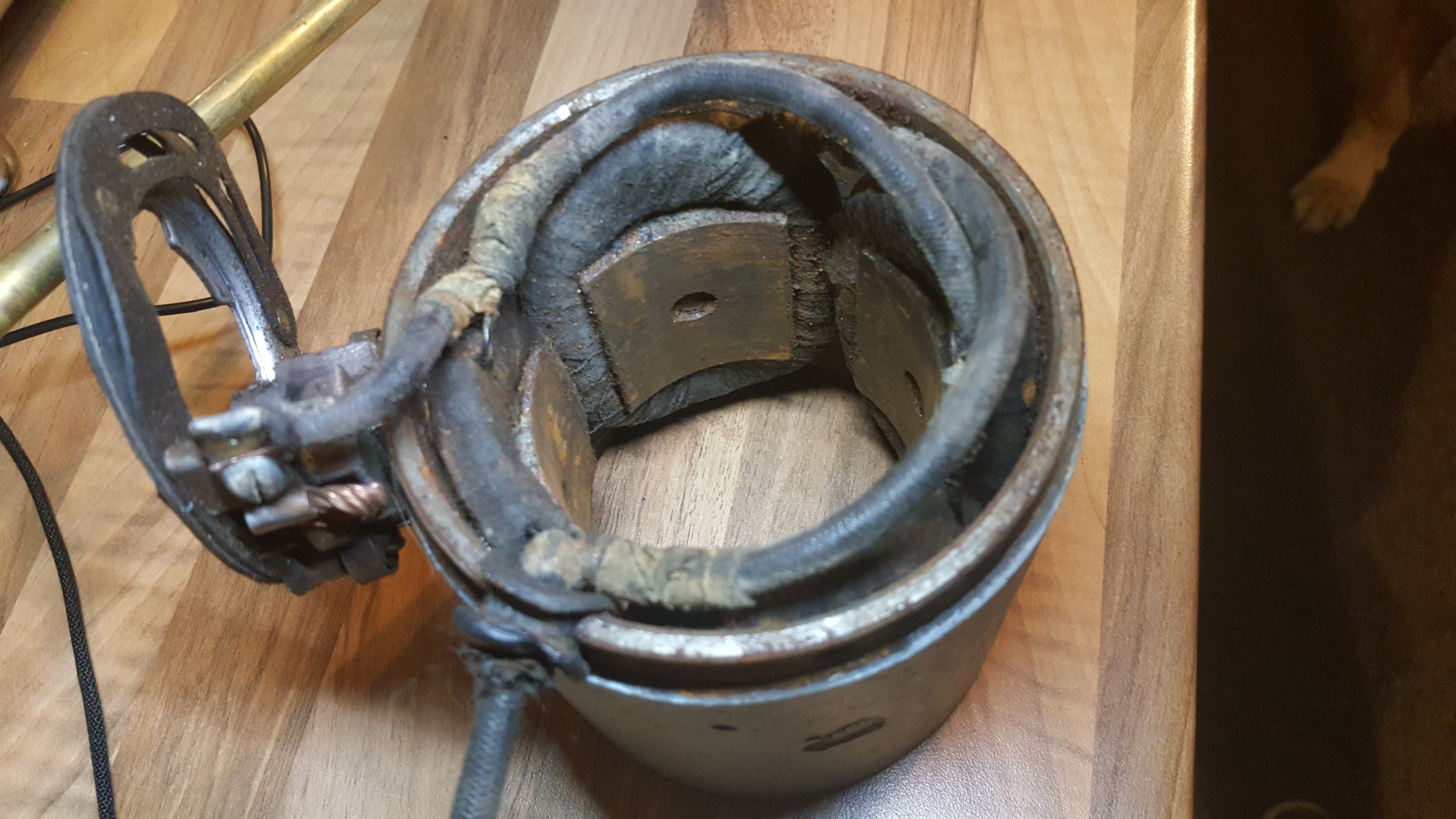

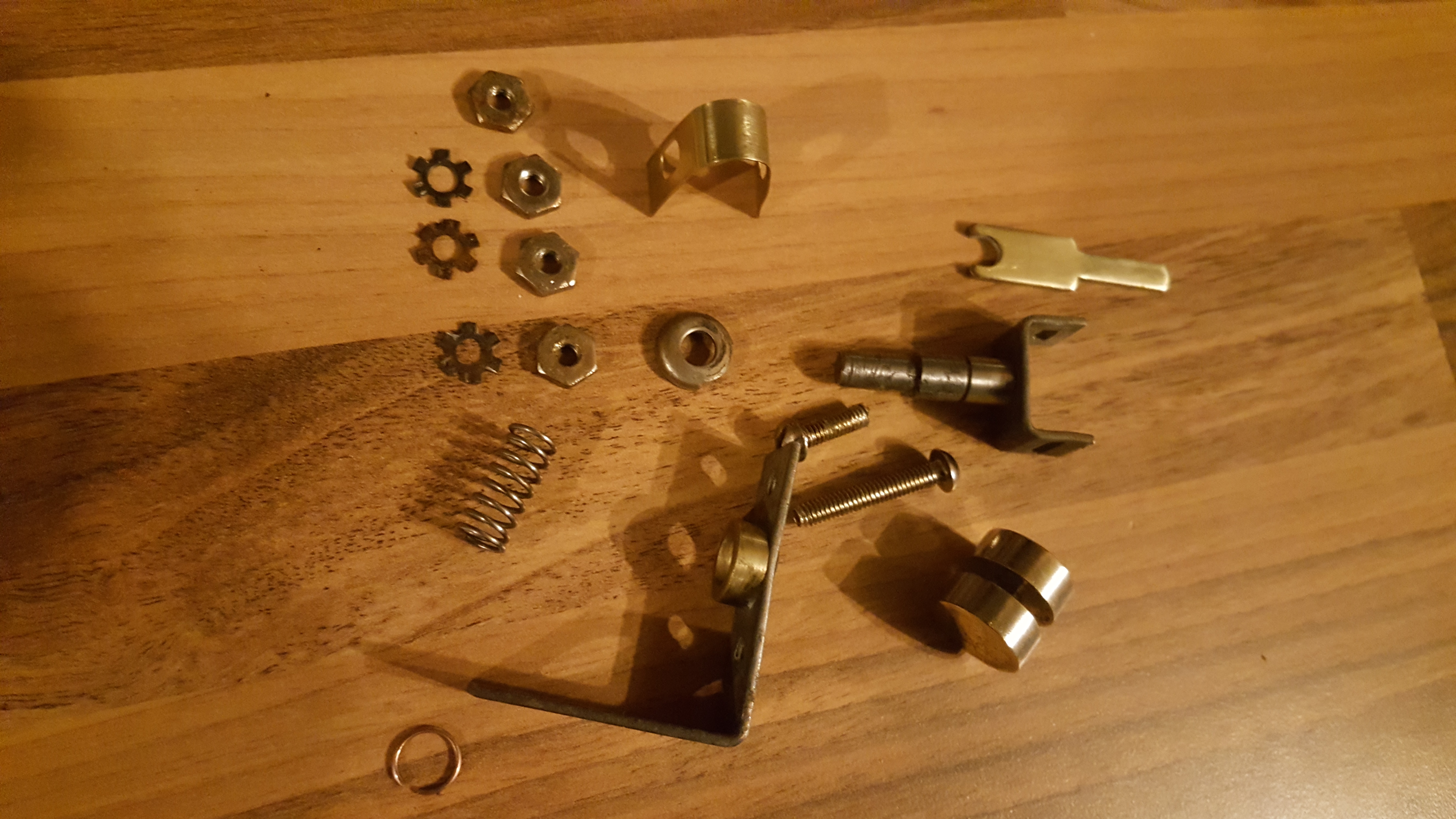

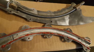

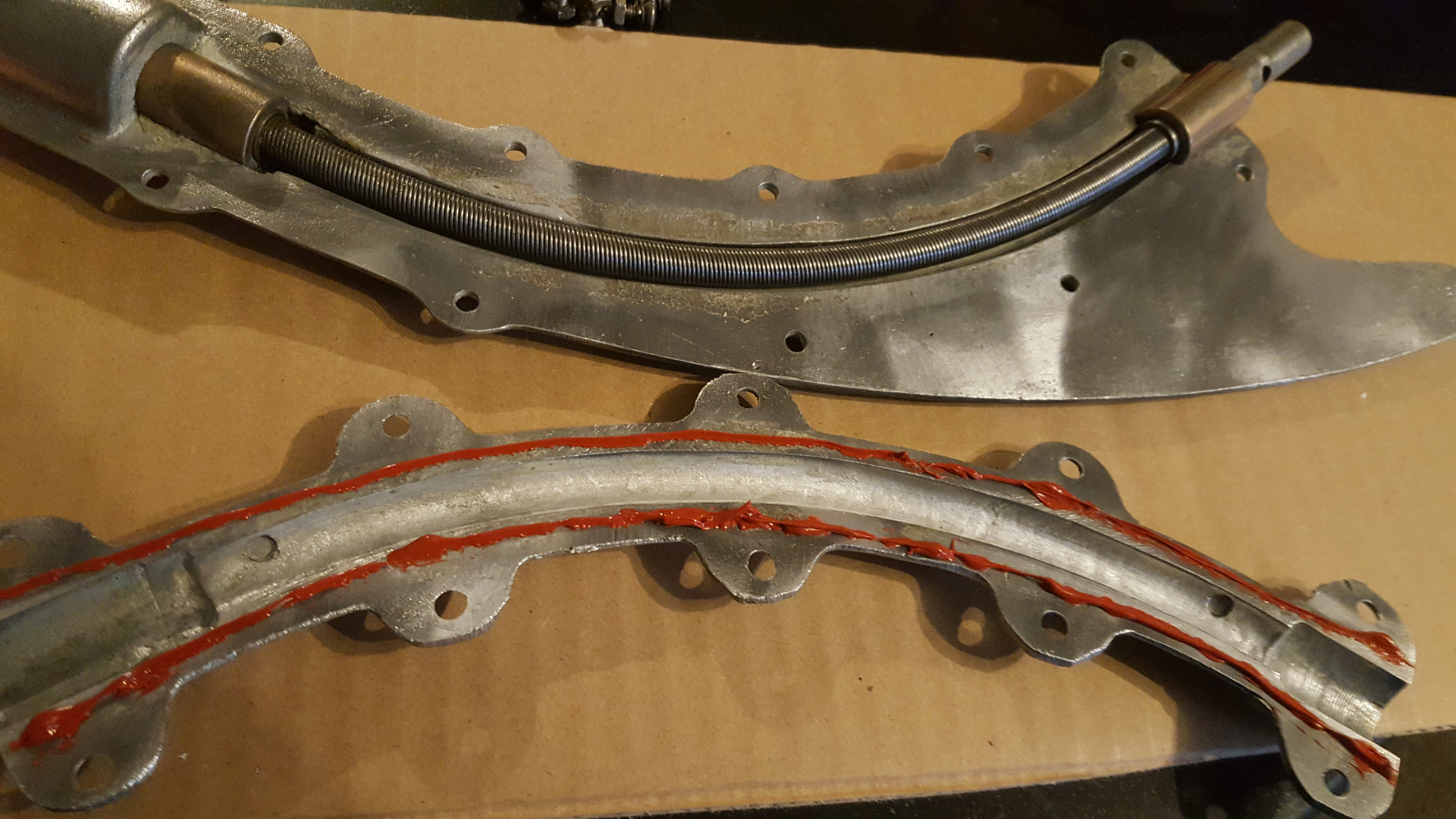

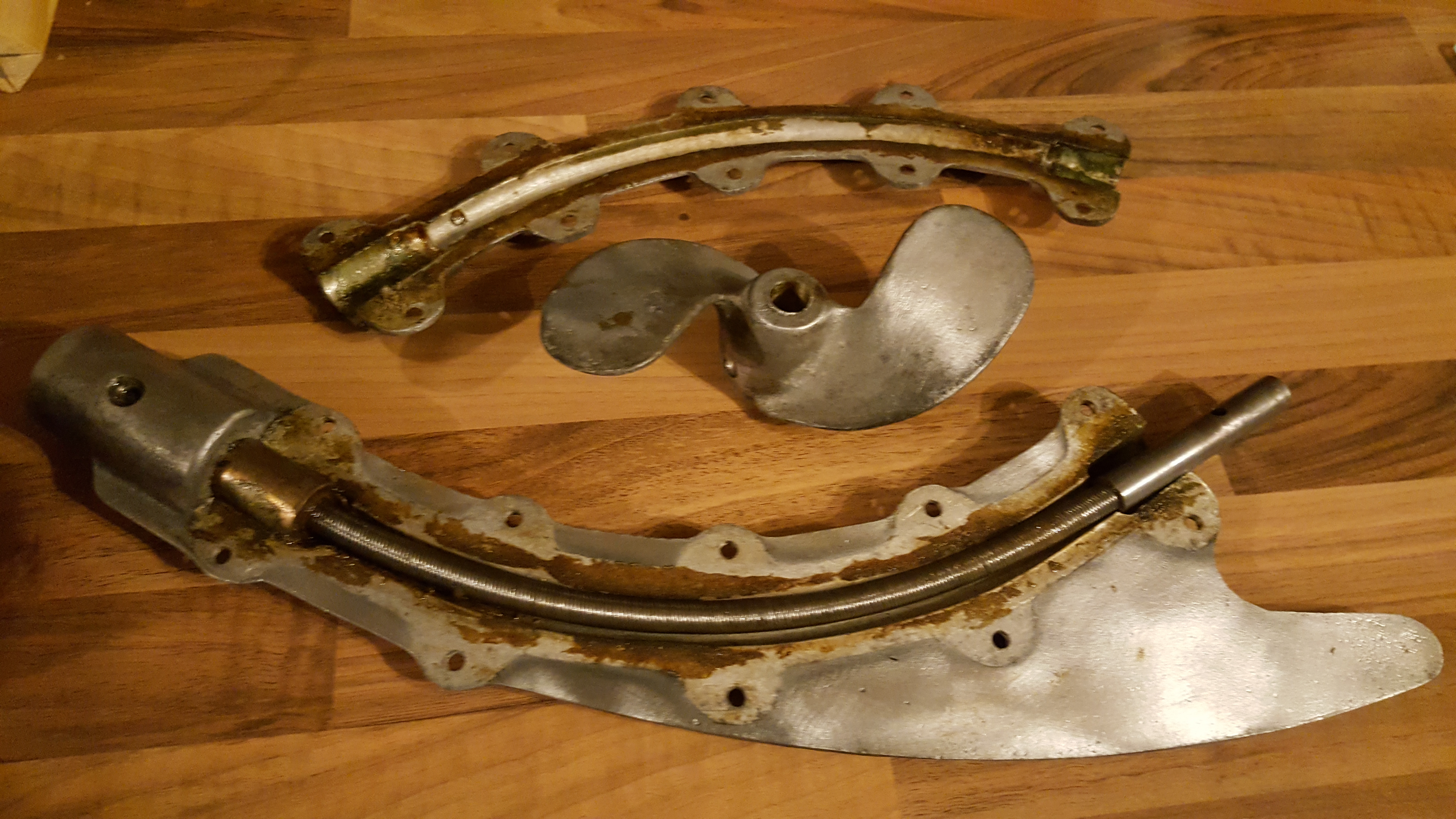

Stripped down ready for rebuild new 6mm cable should arrive tomorrow hopefully get wrapped up this weekend..
 ceramic washers look to be past there best will get away with making a few rubber one's

Only if they don't get hot?ceramic washers look to be past there best will get away with making a few rubber one's
Re: Non seagull outboard I. D
OH what a good thought that is. Back to the drawing board.Nudge wrote:Only if they don't get hot?ceramic washers look to be past there best will get away with making a few rubber one's
Try a fiber washer, it might be able to take the heat better (maybe)
Have a look on ebay
https://www.ebay.com/p/10-Sets-5mm-ID-H ... 2211008108
							Have a look on ebay

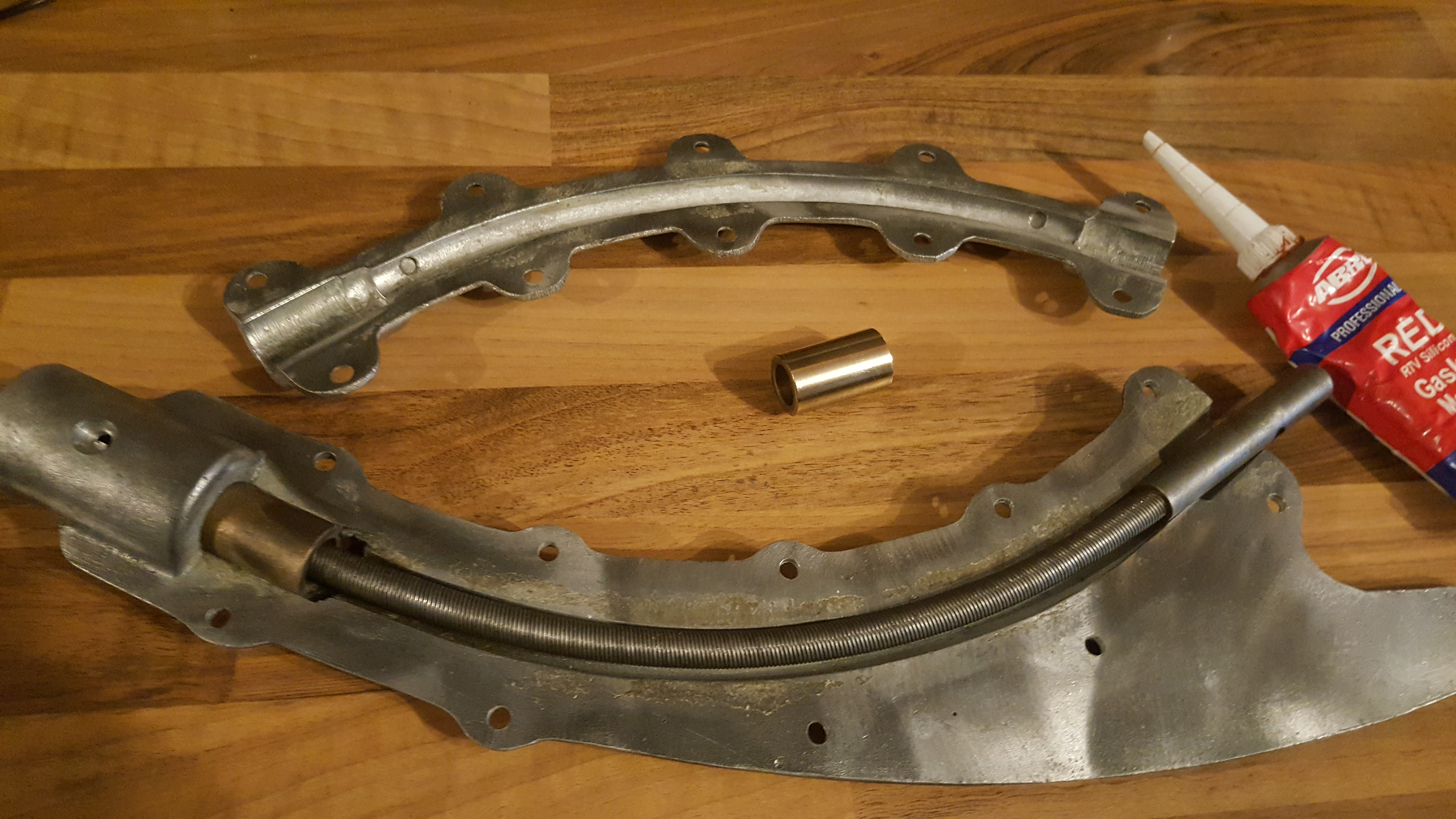

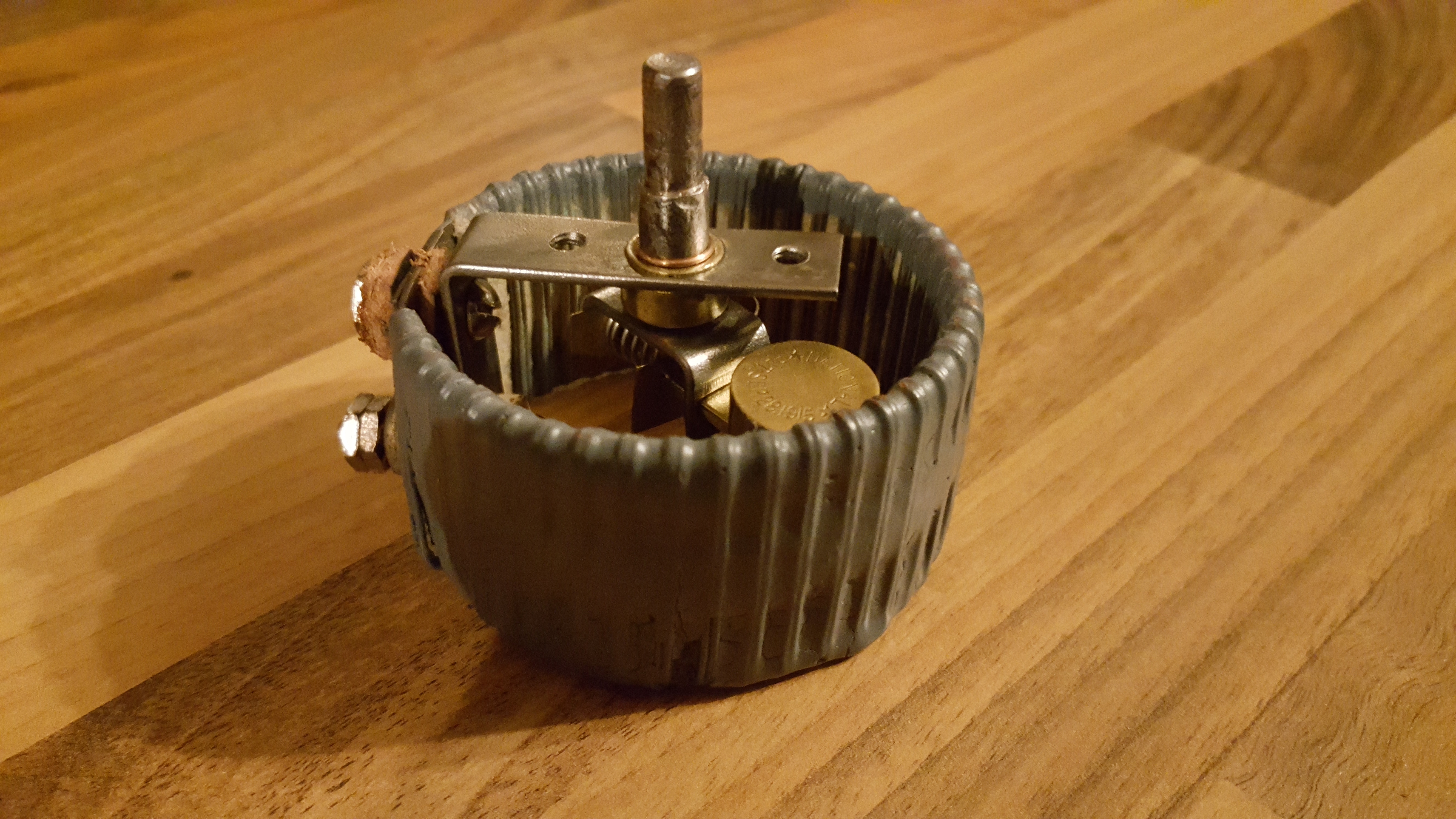

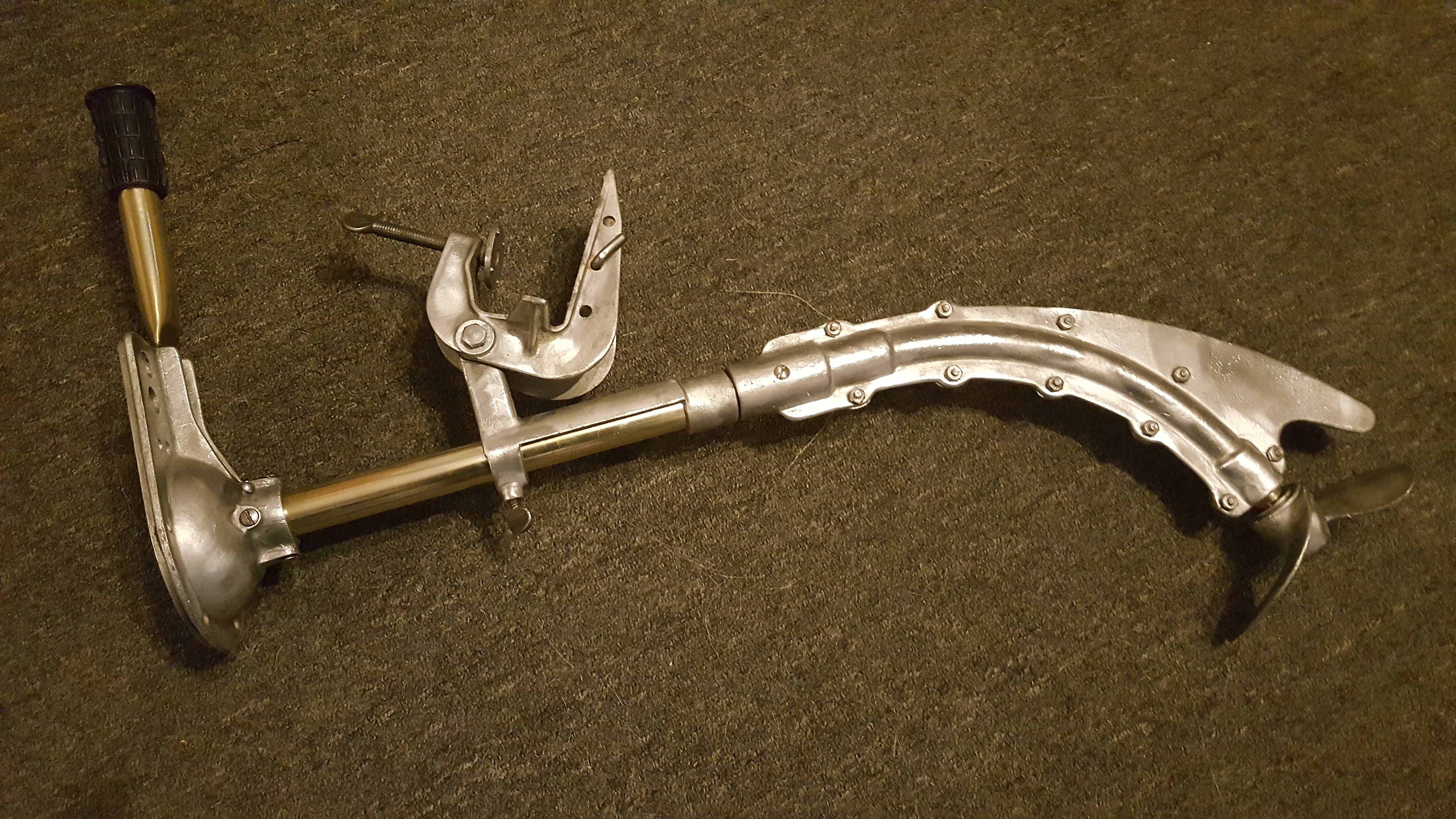

A simple flexible drive. Missing tiller get this shapped it should compliment it nicely.not truely understanding this speed controler just yet I done a simple light bulb test on it.a 9v battery and and bulb no matter where I touched it lite up.....
That is coming up well. Controller works on ohms law. Electrical current is proportional to voltage and inversely proportional to resistance.  So not enough current passing through globe to make a difference to voltage. Am l correct Spiro?

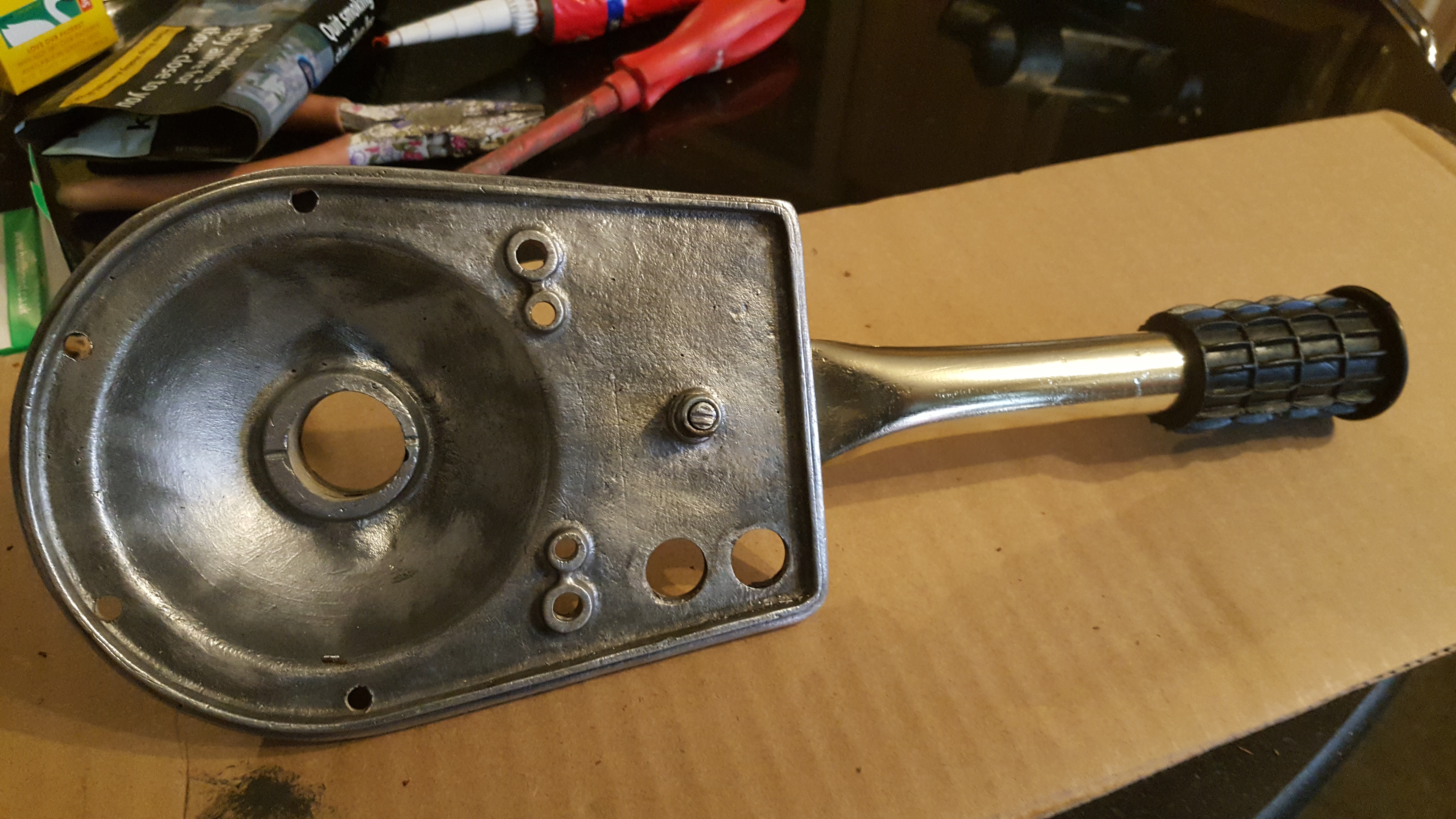

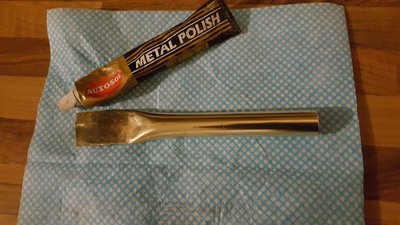

Still waiting for new cable's to arrive new bush fitted to bottom drive shaft (where's my other candle stick THOMAS) made a the missing tiller I think it compliments it nicely..
I'm assuming that these to screws are for inserting grease very ingenious  (yes I looked that word up chinas) also got an approximate date of 1938....hurry up cable's.
