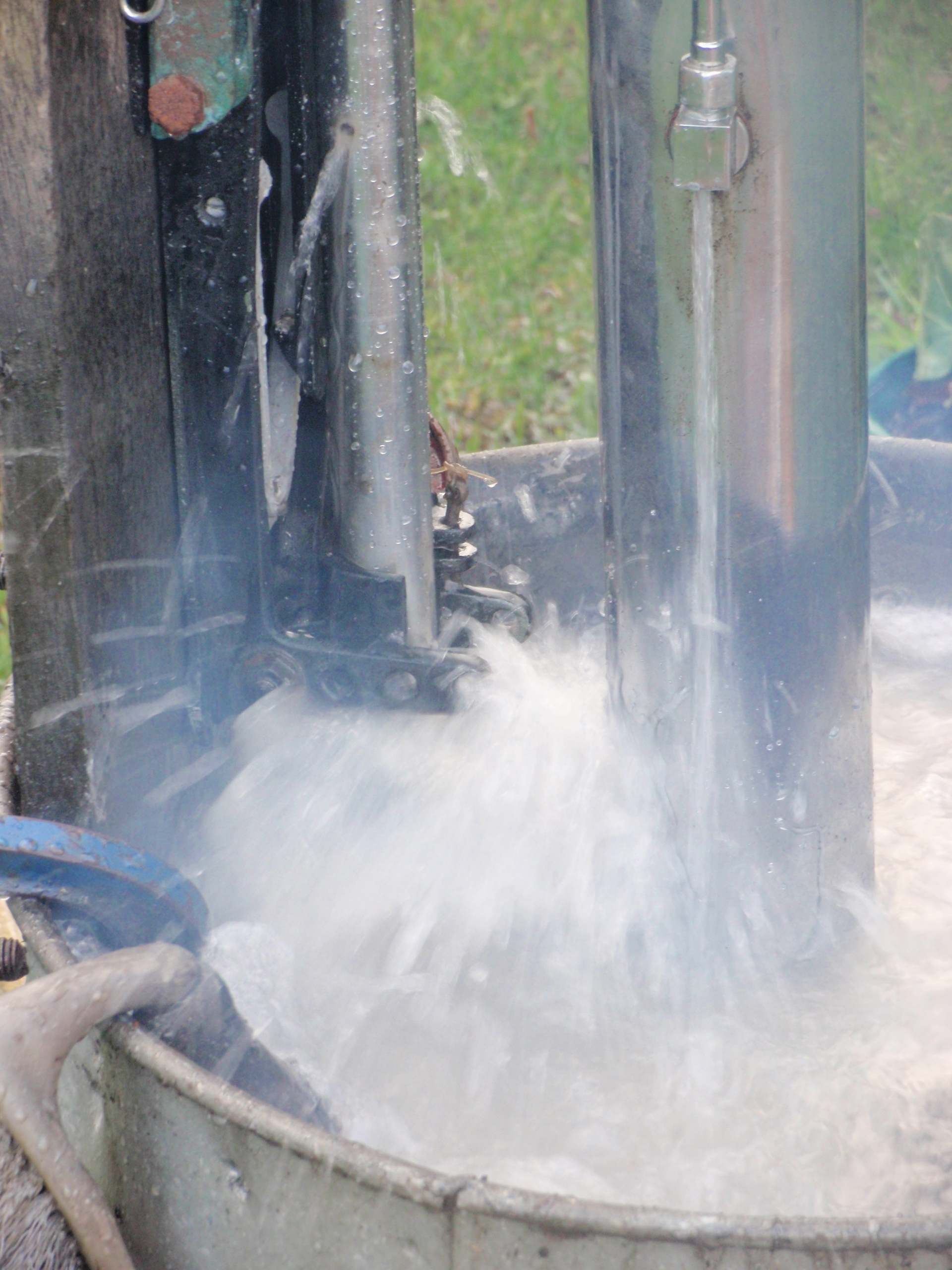

but has anyone every seen water coming out of the drive shaft tube vent holes when in use?
- Rob Ripley
- Posts: 442
Re: Who knew...?
Charles wrote .... "but has anyone every seen water coming out of the drive shaft tube vent holes when in use?"
Yes, I have.
Yes, I have.
Re: Who knew...?
Show us a picture when it's not in the test tank, please Rob.
The only time I've heard of that happening is on an SD water pump housing, with the pressure relief hole blocked up & a missing cotton reel bush.

- Rob Ripley
- Posts: 442
Re: Who knew...?
"...The only time I've heard of that happening is on an SD water pump housing, with the pressure relief hole blocked up & a missing cotton reel bush."
Yes, thats what happened, Charles.
I put a motor together from donated parts not noticing this 'repair' to the pump housing.
Re: Who knew...?
Your cotton reel bush must be very tired, as a lot of water is going past it.
That also illustrates very clearly the purpose of that hole!
Thanks.
Thanks.
