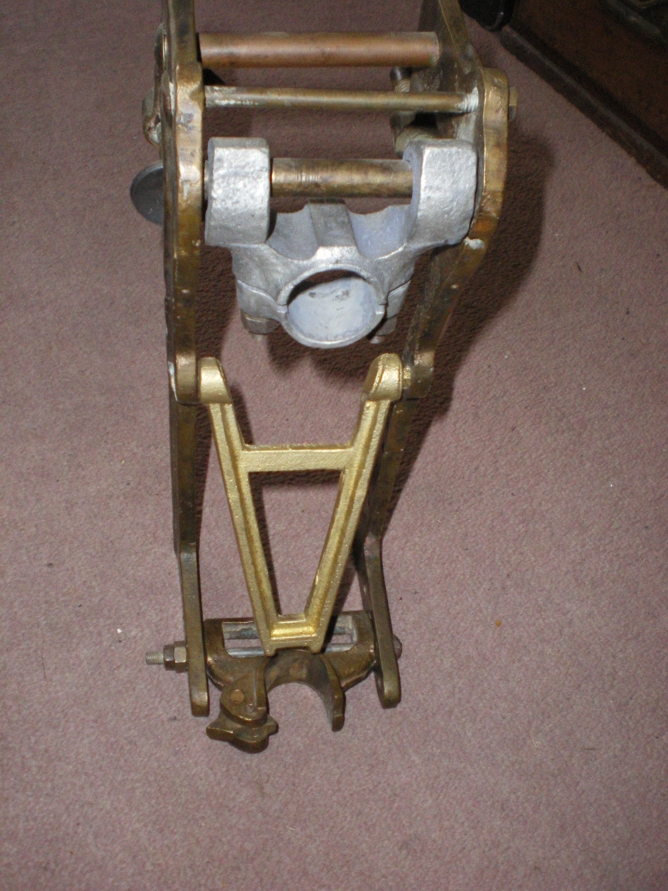

I couldn't find it but here is a bracket in question. Missing V strut :lol:
Left click to enlarge.
Installed. I used an angle grinder and hacksaw to fettle. I'll probably have to bribe the judge at the annual Seagull Concours de Elegance (coz of my fettling) but yes cool job bro's, particularly magic man Nudge!
Hay Hay! That looks the part, Just needs to tarnish up a bit! :P
Is that the other part that needs to be made in brass / bronze? (that Aluminium part)
Yep, the bit hanging from the top.

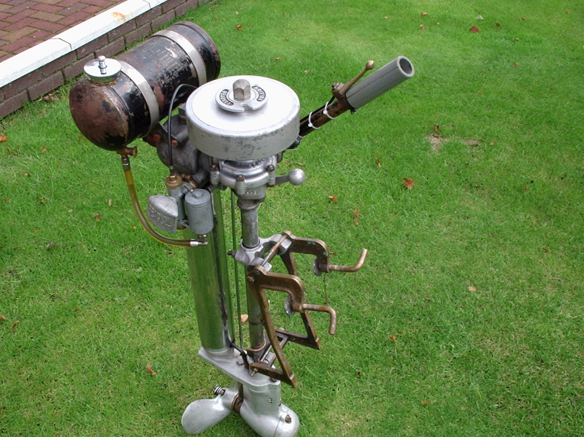

This thing?
Yes & it's got it's locking pin, shame it's not got its tilt support!
That removes any doubts! thanks.
