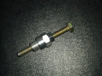

I would have to agree 100% with what you are saying. But when I was having a look it was the only thing I had with an 18mm thread.Nudge, I would say that that is too flimsy to find TDC, i borrowed something similar to do my Marston timing and it was a M10 bolt threaded through the nut part of the plug.

It was probably a device like this that Seagull 101 was talking about.
It's an 18mm adjustable piston stop, which works in all Seagull cylinders that use an 18mm spark plug, & can be adjusted to stop the piston at around 90 degrees, when it's traveling at it's fastest, giving the best accuracy.

Just a tad heaver than mine! I would have to be careful not to stuff that through the piston.
