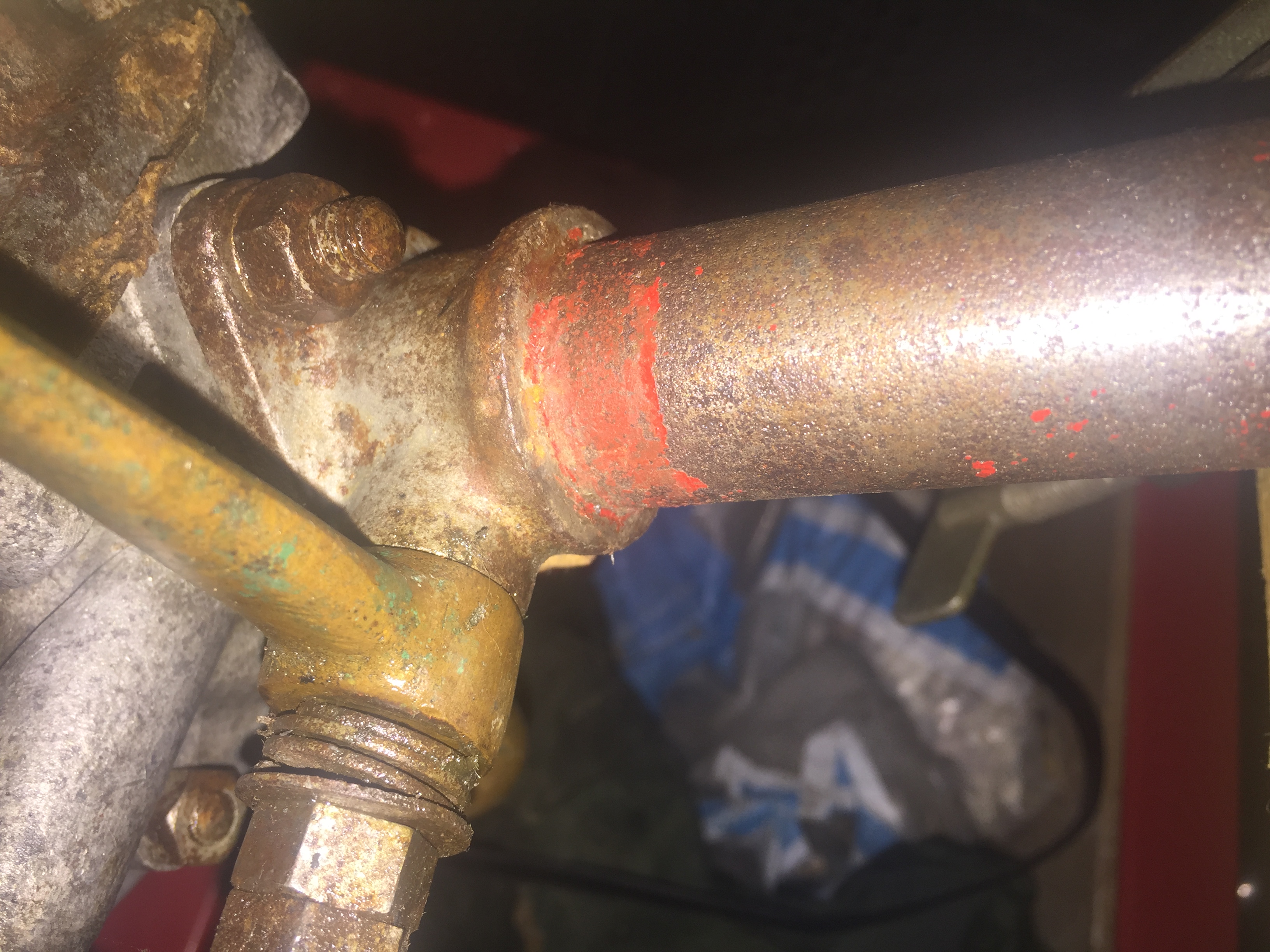

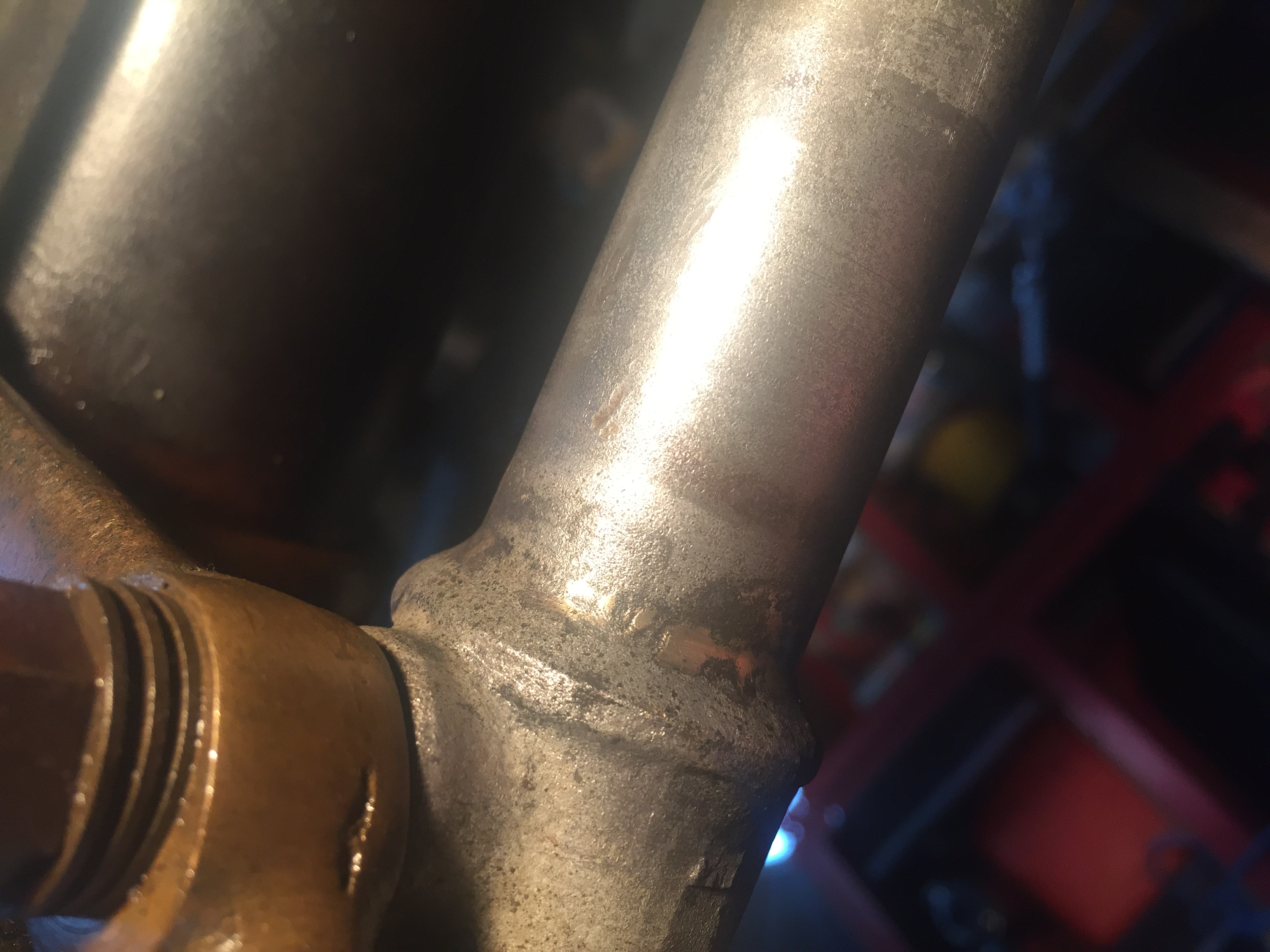

If at all possible, could I see a picture the HSD's top drive tube mount, without the transom in the way.
The shape of the top collar is different to all the others I have seen, even if it's not original to the motor or only used on this motor, its not the same as any other drive tube.

I've just been looking at the top of that driveshaft. Is it an odd finish, because the zinc coating happens to be in very good condition there?

It's a different shape!

The cover is the same as I got it has proper stitching etc it is of proper construction to last I am hoping the pictures arrive ok u will see one has tapered top but no stops as you mentioned I only have the sd as ref and it has similar but has shoulder stop I will send pics as probably easier to see than explain
Re: Flywheel numbers
It looks to be a much stickier top mount than the standard SD, Lucky you noticed it.
Do you think that someone has retubed it Keith? the ID would perhaps answer the question.

Not that I really want to know the answer, just thinking out loud, the HSD is basically a barge pusher, anyone seen a original transom for said motor, would you retube than re-plate said drive tube, or is it original.
Or is it just know one knows.

As there's very little actually known about these HSD's, for now all we go on is what the other motors look like within the same lineage (SD's and SDP's for example)and make comparisons accordingly. Educated guesses can sometimes pay off, but if i were a betting man i would say that BS at that time were churning out these things in such a short amount of time that to manufacture a bespoke tube for just one motor type, the HSD, would give rise to more costs to the production.
I think one generic type of tube fitted to all 3 types of motor just to keep things easy and simple.
I can start to see (i think) why some of these SD series motors had a "height adjuster" already fitted to them.(basically the same clamp that holds the carb onto the cylinder) With this odd looking arrangement at the top of the tube instead of a square shoulder there's no real need to have the engine bearer rubbing against a square shoulder as it's not going to be touching the top of the tube rather than against the bottom of the "collar" that's fastened around it. Goes back to the question of whether all the SD range was longshaft or not? This might be a possible answer here for the slight difference in the overall condition of the tube in this area. The plating does look very good for the first couple of inches in this area.There's only one real way to settle this and that's to dismantle this particular HSD and take a closer look at the inside of the tube for signs of previous welding and to see if there are any other witness marks over the rest of the upper part of the tube.
Transom brackets we can speculate the obvious here, for my money though i'd be leaning towards the type "b" No2 bracket, in the spares list referred to as " Gunmetal boat bracket for fixing to either side of folding boat, Mark III "
If there were any great number of these left over after the war they probably went through the same treatment as most of the others and ended up with a typical post-war bracket to attach them to a conventional type of boat, which we've seen all manner of different bracket types before now. It's possible i suppose that some of them may have had a gearbox swap at the same time when Mr. Bray got his hands on the surplus. You never know.
Other than that i don't know (yet)
