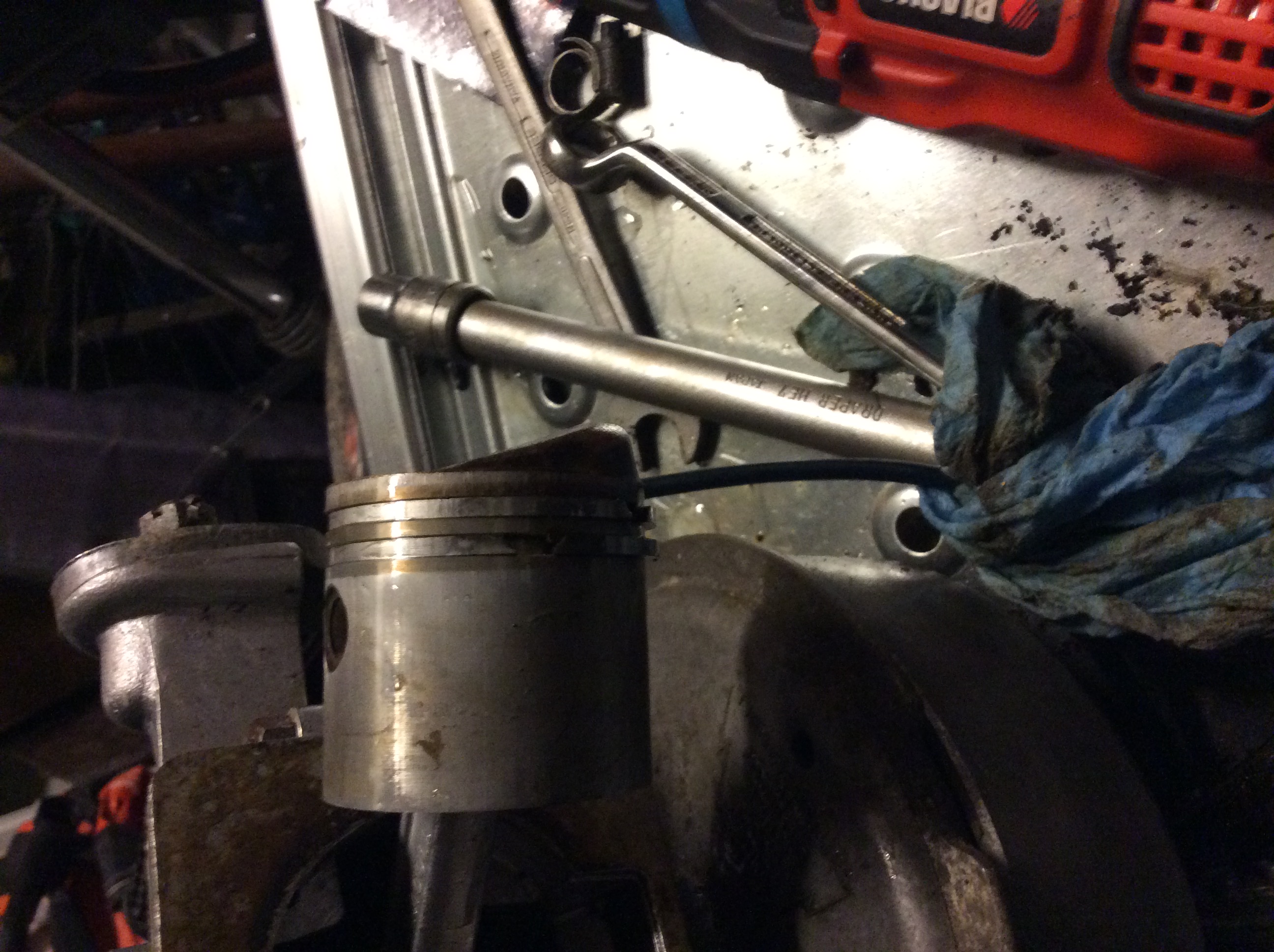

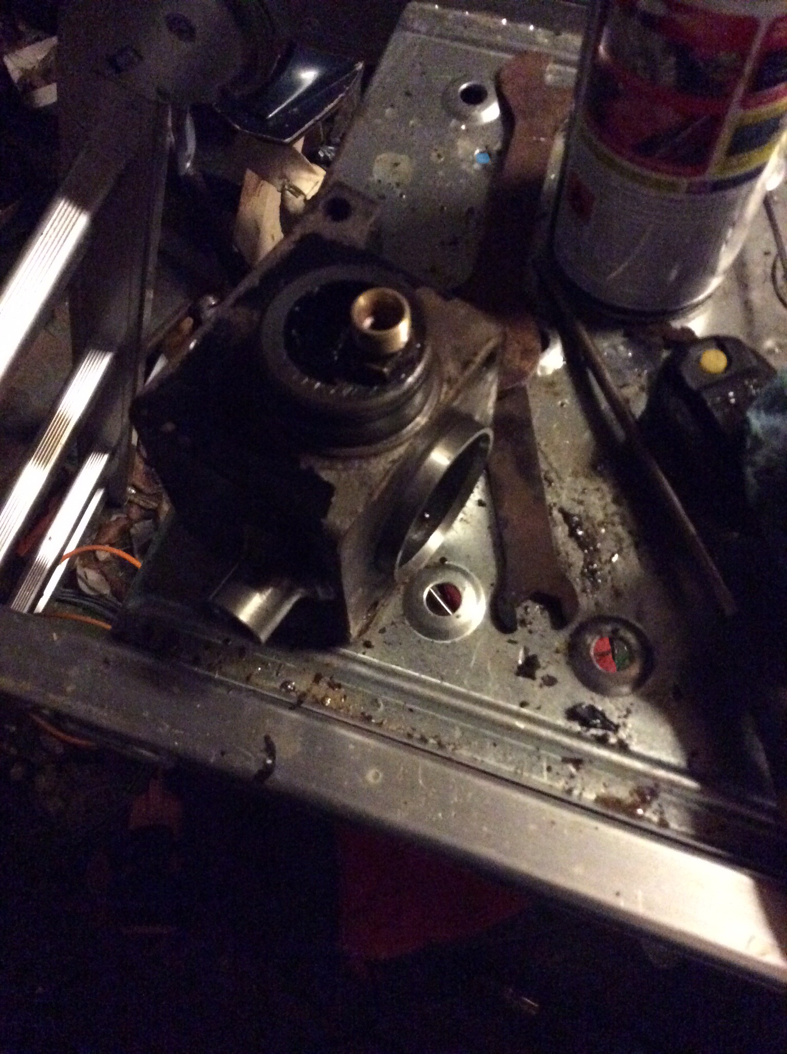

Photos of rings etc
And the exhaust port and water port
Crud is now clear to the extent that I can blow through easily
Steve

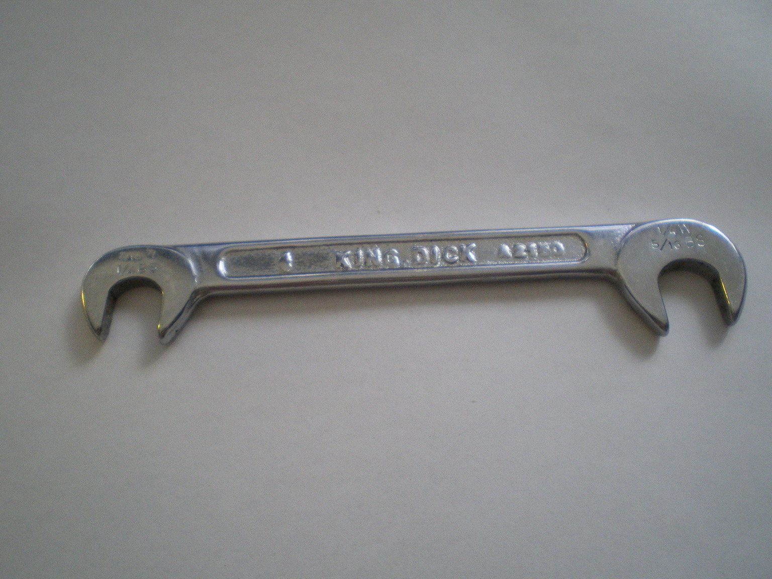

Re: GFP 40+ starts but won't get going
John stocks a tool kit with a spanner for that job, have a look.
I recently came across some nuts that were too badly corroded and considered a nut cracker <ouch>
Anyone used one?
Yes, as long as you can get it around the nut it use it.
Good point... it is not going to fit is it.
Heat and soak with penetrating fluid. Repeat as required.
Locking pliers (vice grips) work quite well, but may end up chewing the nut a bit. New nuts always available.
Shamba
Posts: 21
Joined: Wed Dec 30, 2015 6:40 pm
Location: South Devon
Post by Shamba »
That offset spanner works a treat. So far reassembly has gone well the hardest part being getting the exhaust lined up to allow the little screw into the block casting back in.
