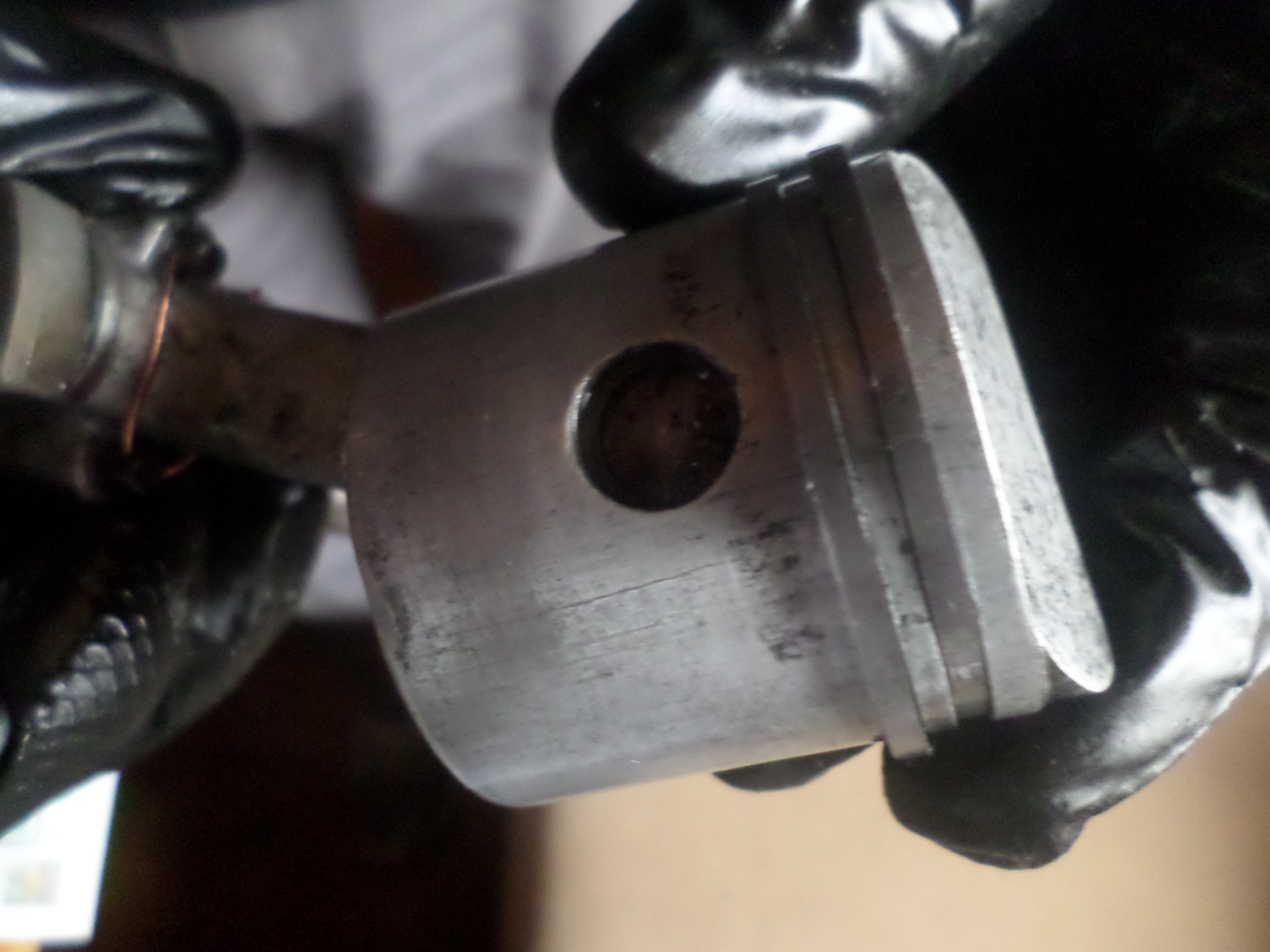

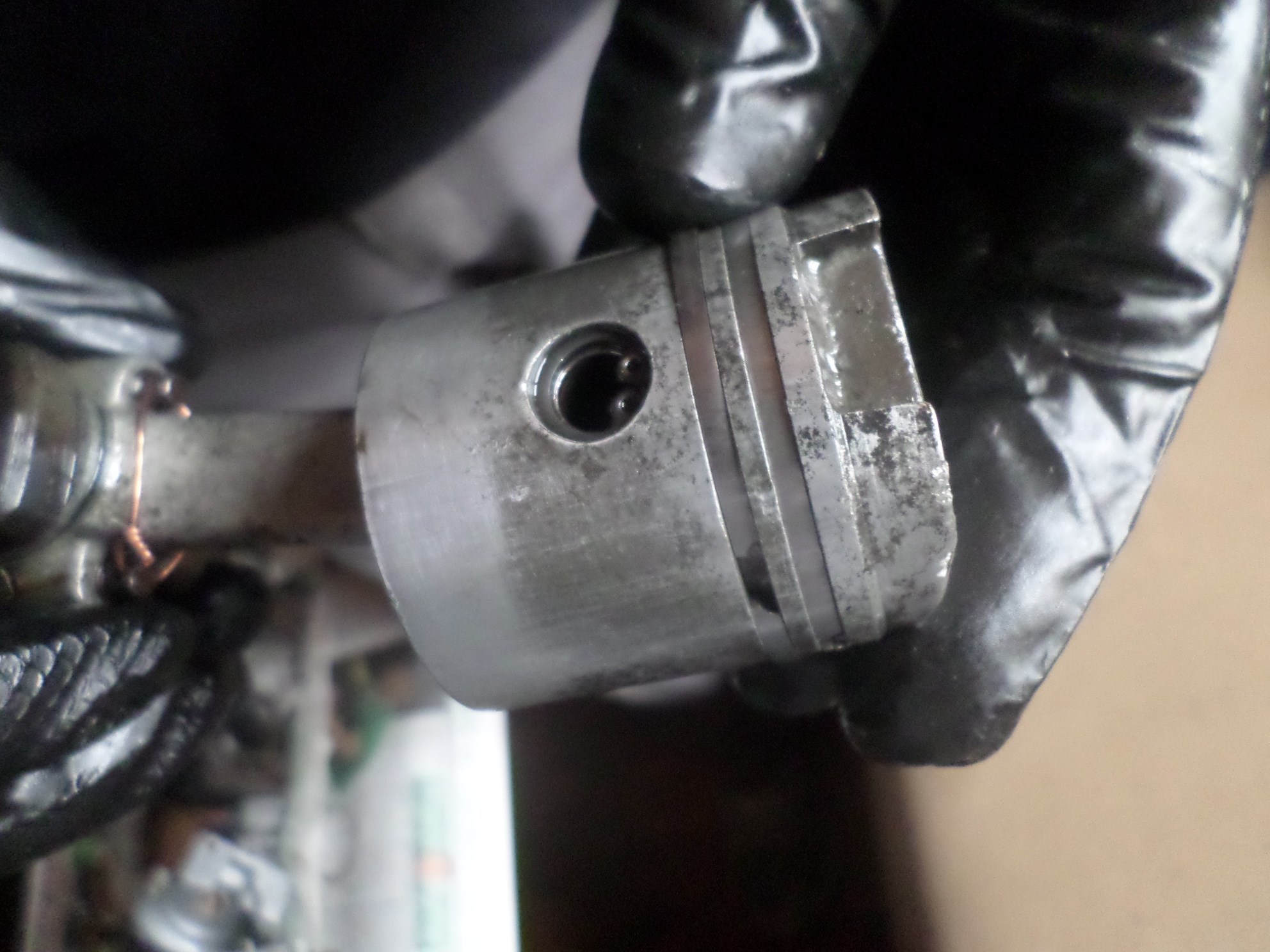

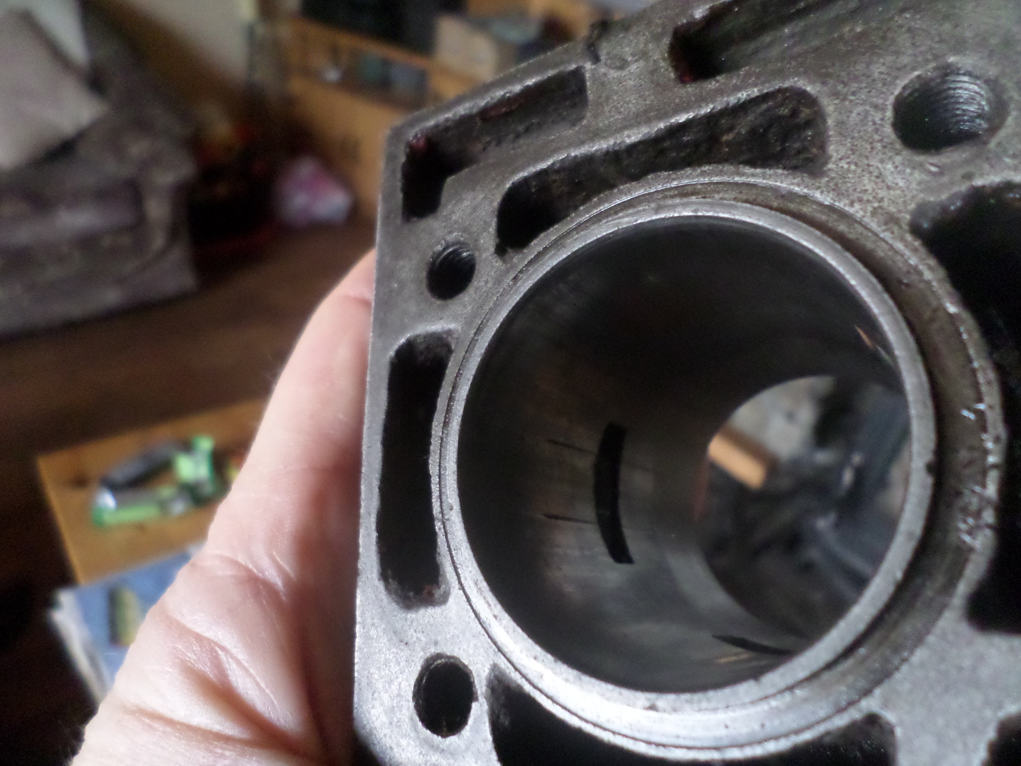

Well I fired up this afternoon and she ran beautifully for ten minutes,all I did was tighten down the head bolts.So I'm thinking the overheat caused the head to expand a little.
Anyway she ran for ten minutes,then started blowing bubbles out the crankcase.So it's a strip down and rebuild.........again.Ah well better than a pile of scrap.
Oh I always use a bit more than 10:1 'till I get her running right,more like 8:1

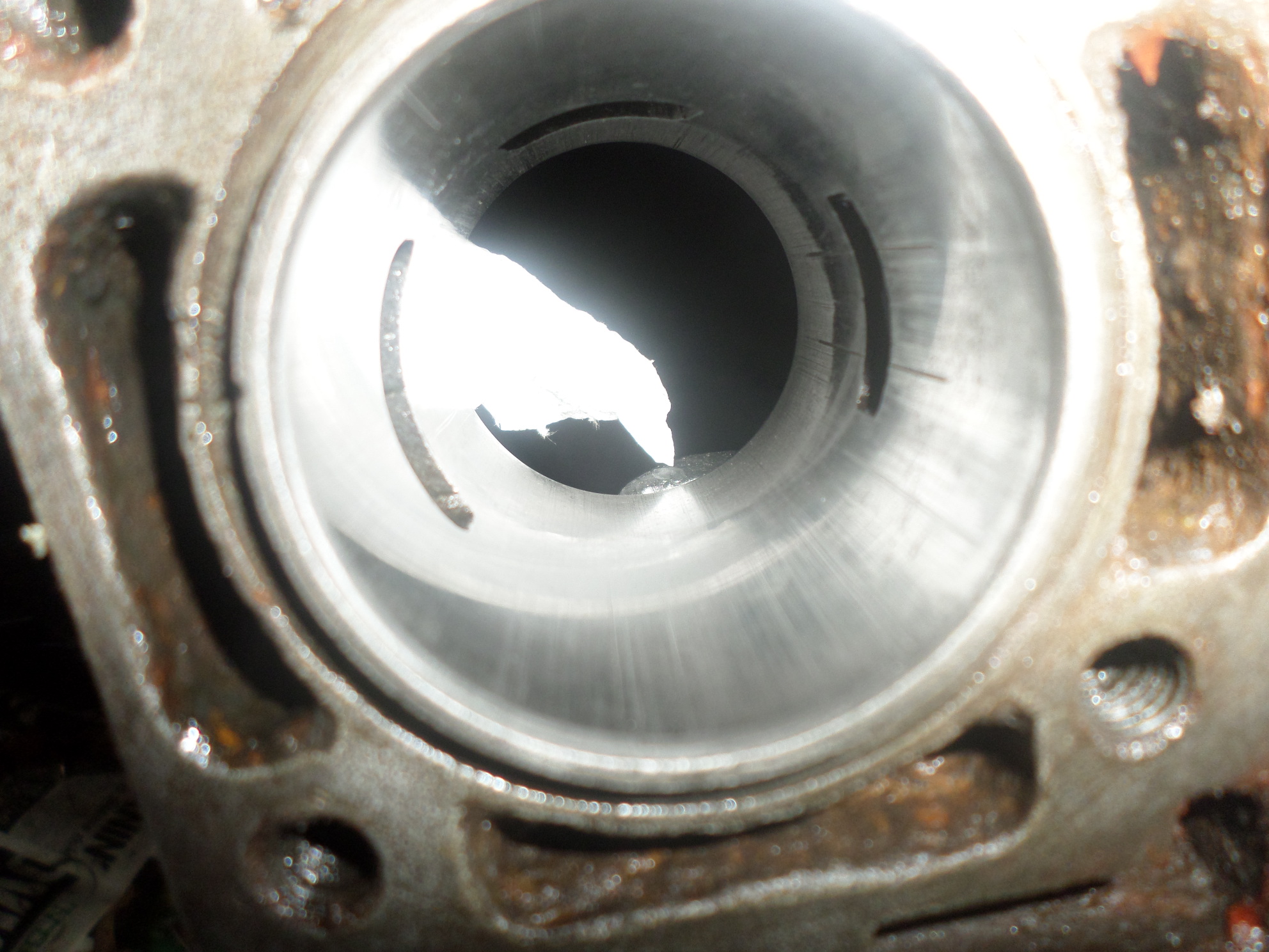

I would de-glaze the bore and fit some rings first.
A better barrel and piston can be had cheaply for piece of mind if required however. Yes I have seen worse. But I have had them in my hand to measure things up to make a decision.
What is a must for you before anything else.....get rid of the copper lock wire on the cap fasteners!
Use steal and hopefully stainless safety wire available from any precision machining establishment.
Good luck.
Good luck.

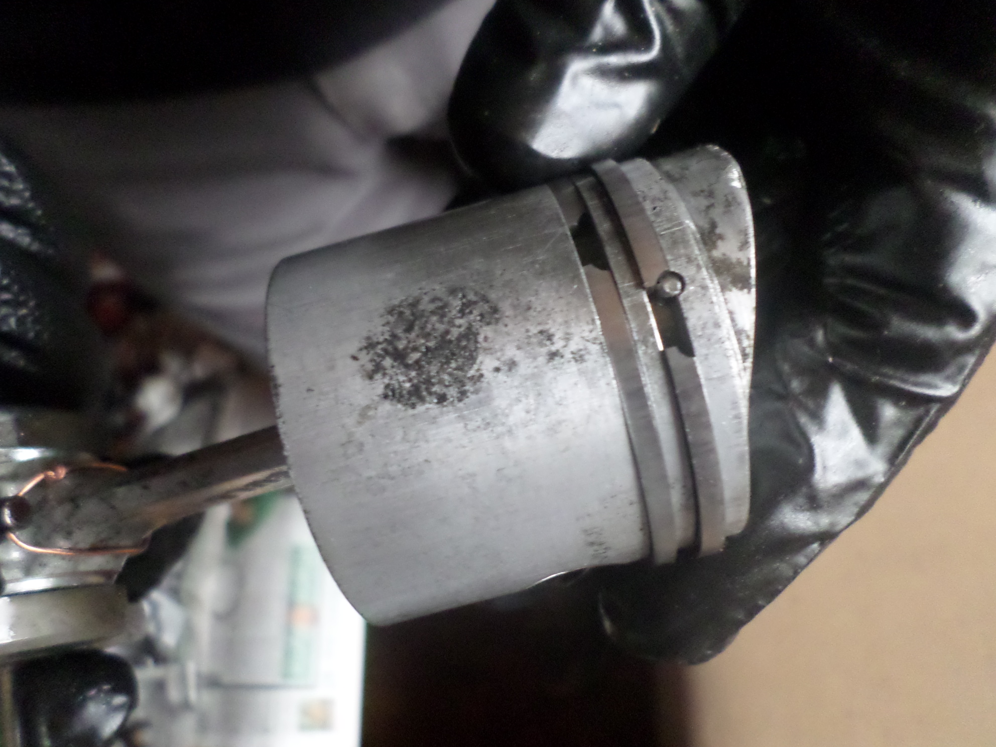

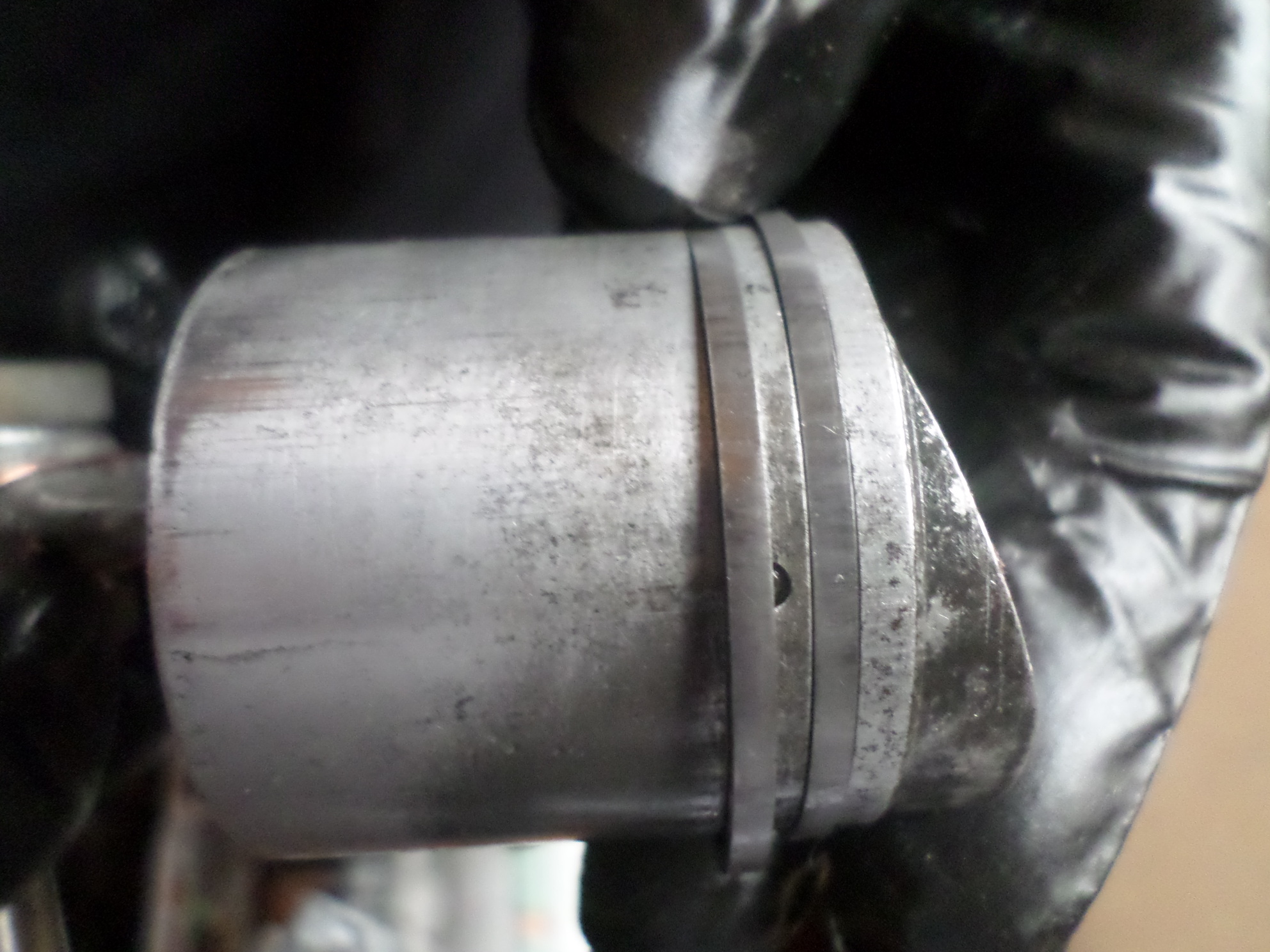

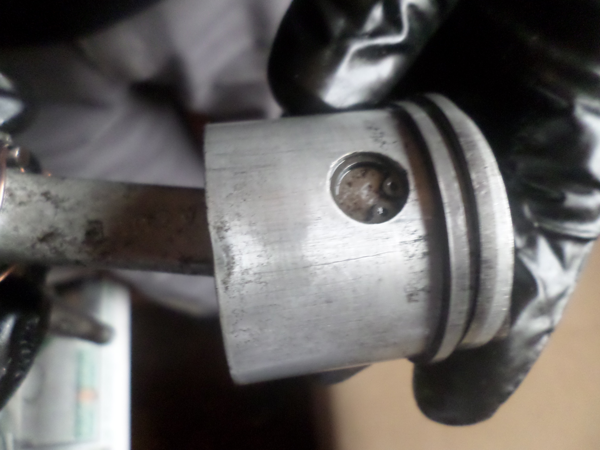

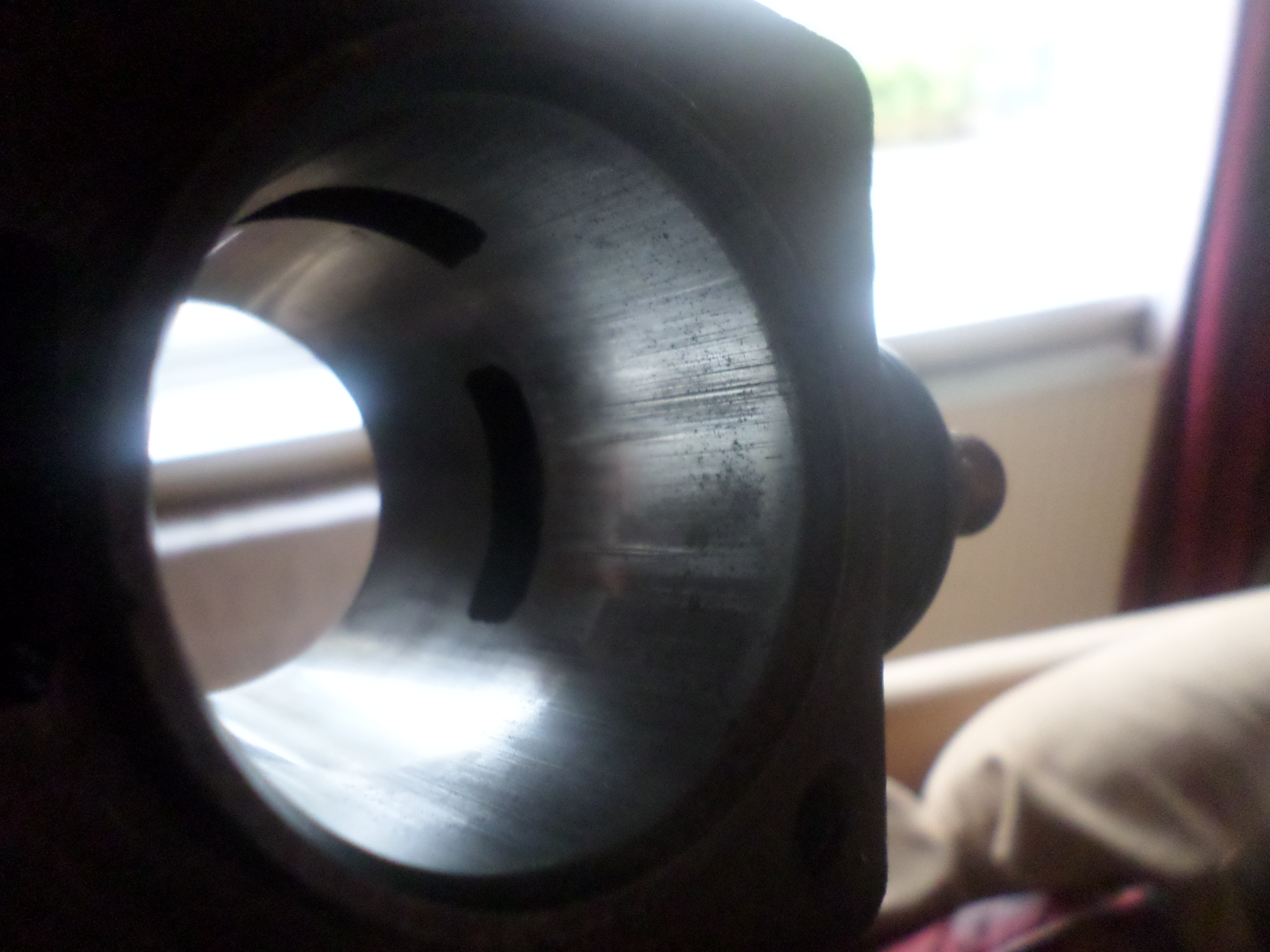

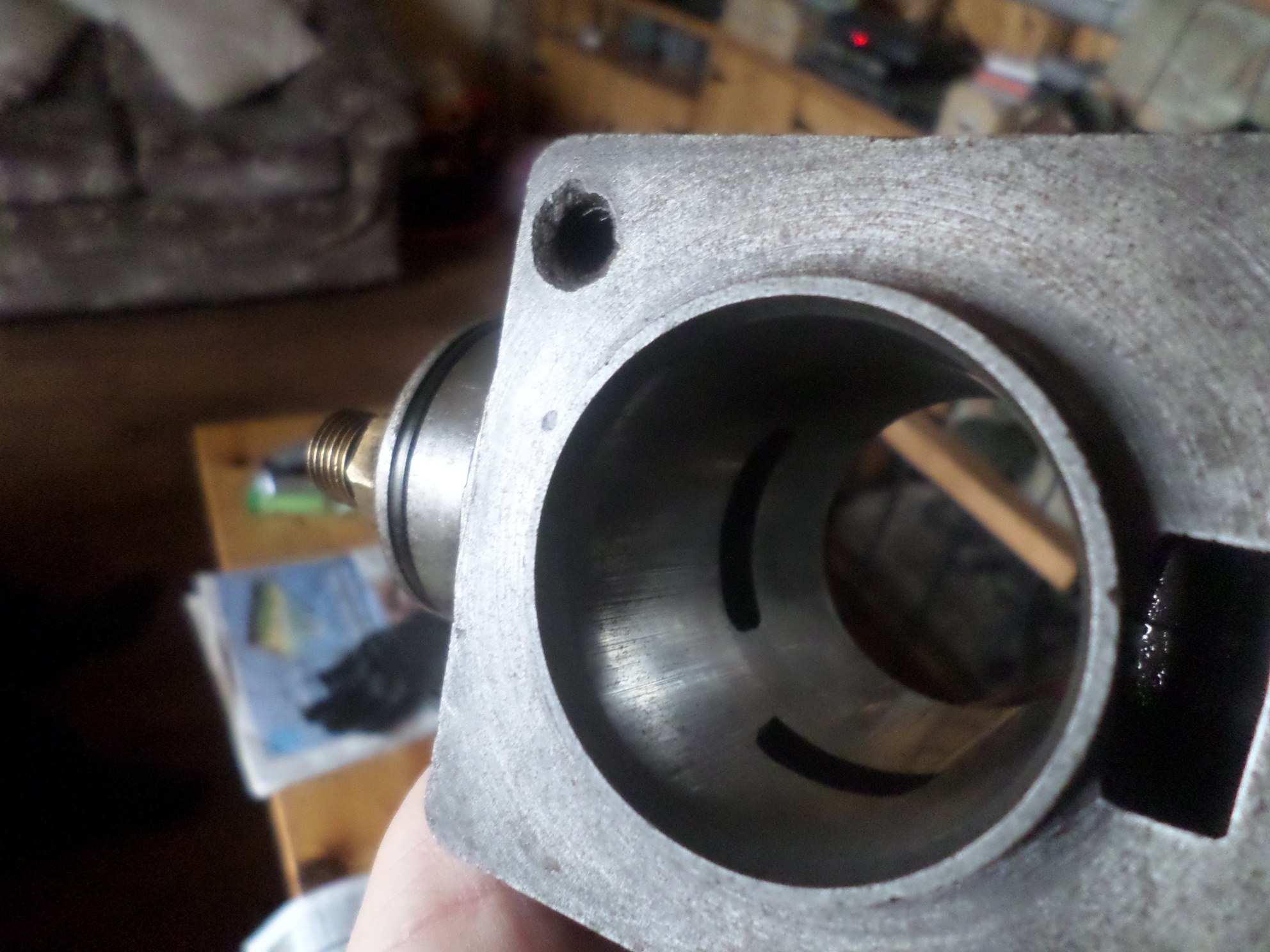

Right then, now we can see what you have.
The piston should clean up nicely with some steel wool. (looks more like corrosion from where the motor has been left idle for ages instead of heat damage to me)
Piston rings should go again. Place just the rings inside the bore and measure the gap between each end of the ring to see how worn they are.
0.004 inch or 0.1mm is what you're after, any more and it will probably need new rings.
Small cylinder hones are always a problem to source.
Tip : I use a worn flapwheel (worn just enough for a snug fit inside the bore but not so tight that it won't spin by the use of an electric power drill)
A quick wizz up and down usually takes out the worst of it. (30 seconds usually is about right) I 've done this many times on 40 series blocks with no ill-effects at all. I'd almost go as far saying it's nearly as good as a purpose made cylinder hone but for a fraction of the cost. It even puts very fine scratch marks onto the surface of the bore which will help hold some oil while your rings are bedding in.
Suck it and see Noel.
It will fly again.
It will fly again.

So I have used wet 'n' dry 600 to 1500 on piston and cyl,put it all back together,80psi,spark and fuel and she wants to run but,dumb dumb over tightened one of the head bolts,so I have two choices,take it all apart again and take it and get a helicoil,nowhere open 'til Monday,or tap insitu to M9 and blow through with air.
I have replaced the old bolts with new high tensile 5/16"BSF.But I am confident she will fly.
