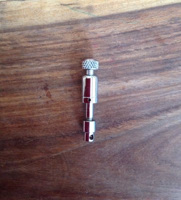

The actual article, a correct replica air valve

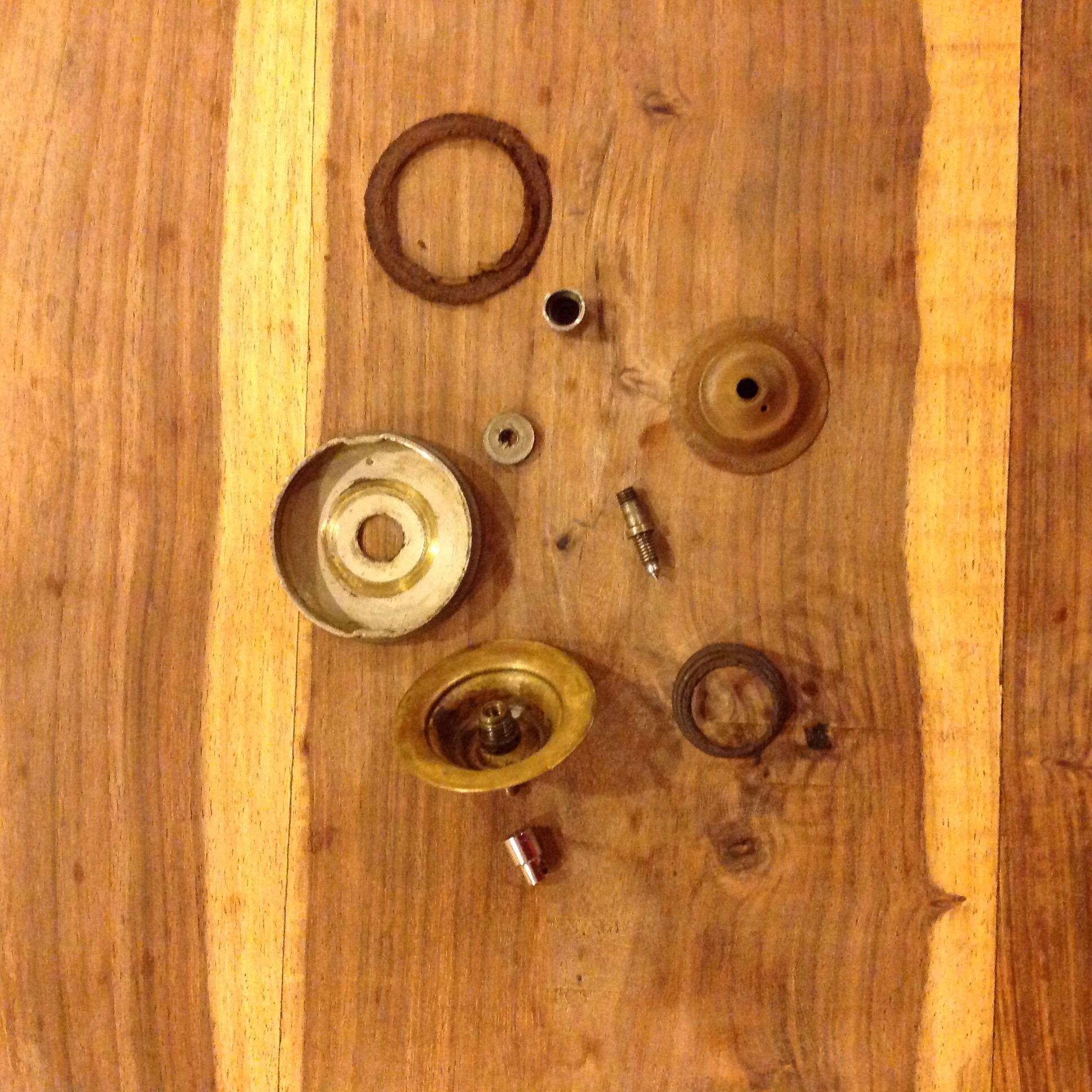

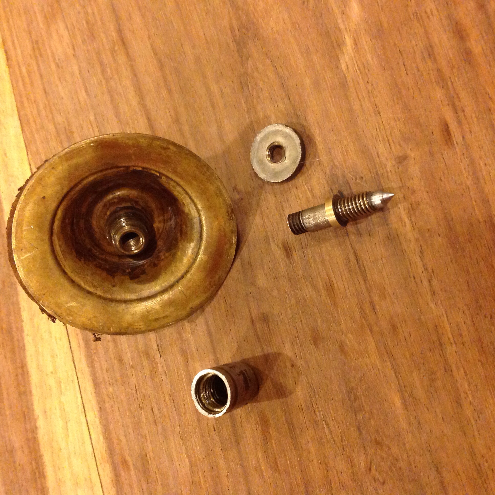

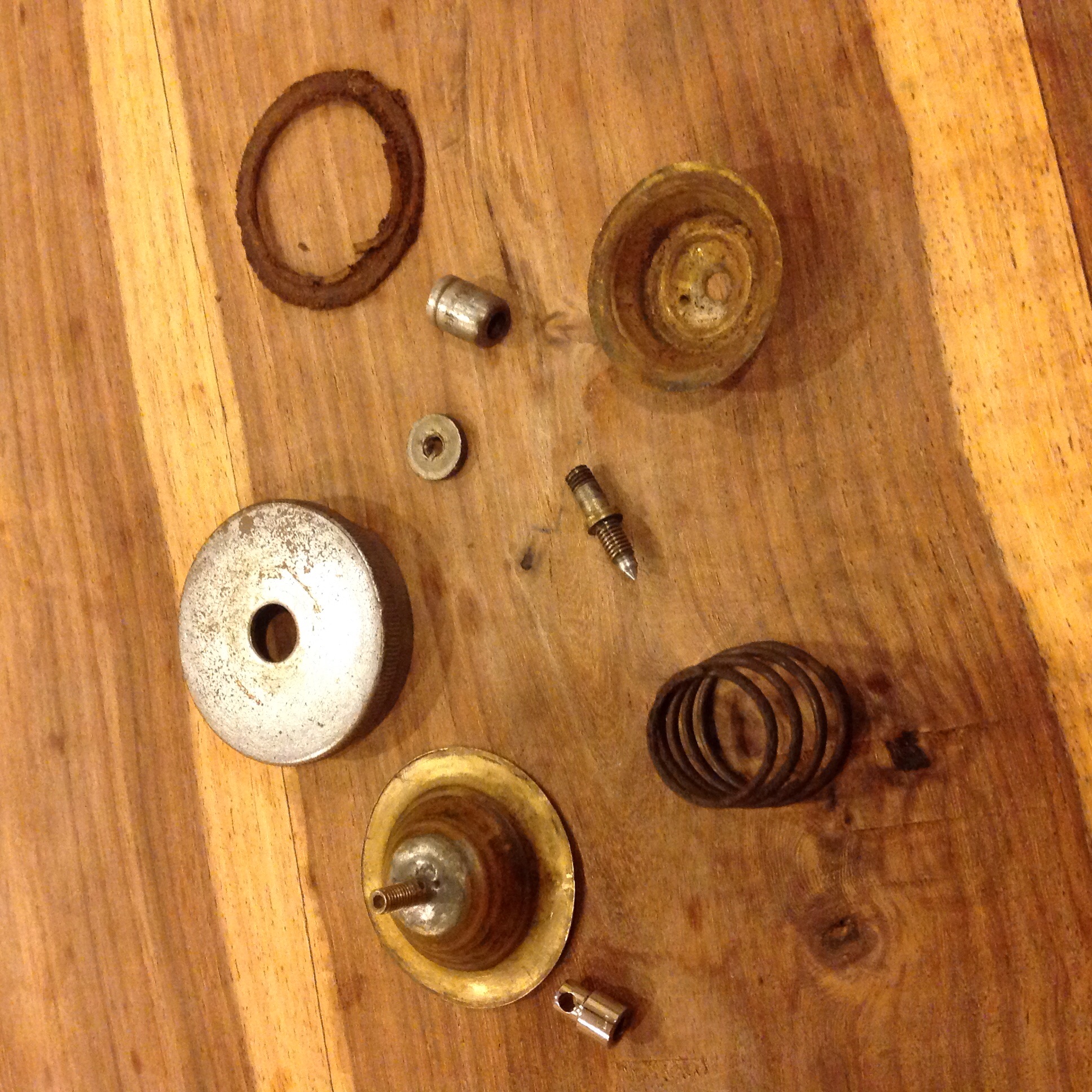

A stripped down cap, machining the air valve is simple enough but it's going to be a little tricky pressing the brass washers, I still believe that these should be an exact copy otherwise what is the point in all this time and effort.
Re: Bayonet Fuel cap
I think your stripped down picture might have answered just about all the questions, thanks Rene.
So if a total of 50 caps is the most cost effective answer, someone will have to go to Candess or whoever manufactures these steel caps & get a price for 40 steel unplated, unassembled caps with 10 extra sets of washers & springs for the register caps, & while they are there, get a look at the final assembly press tool, so a copy can be made for our use.
