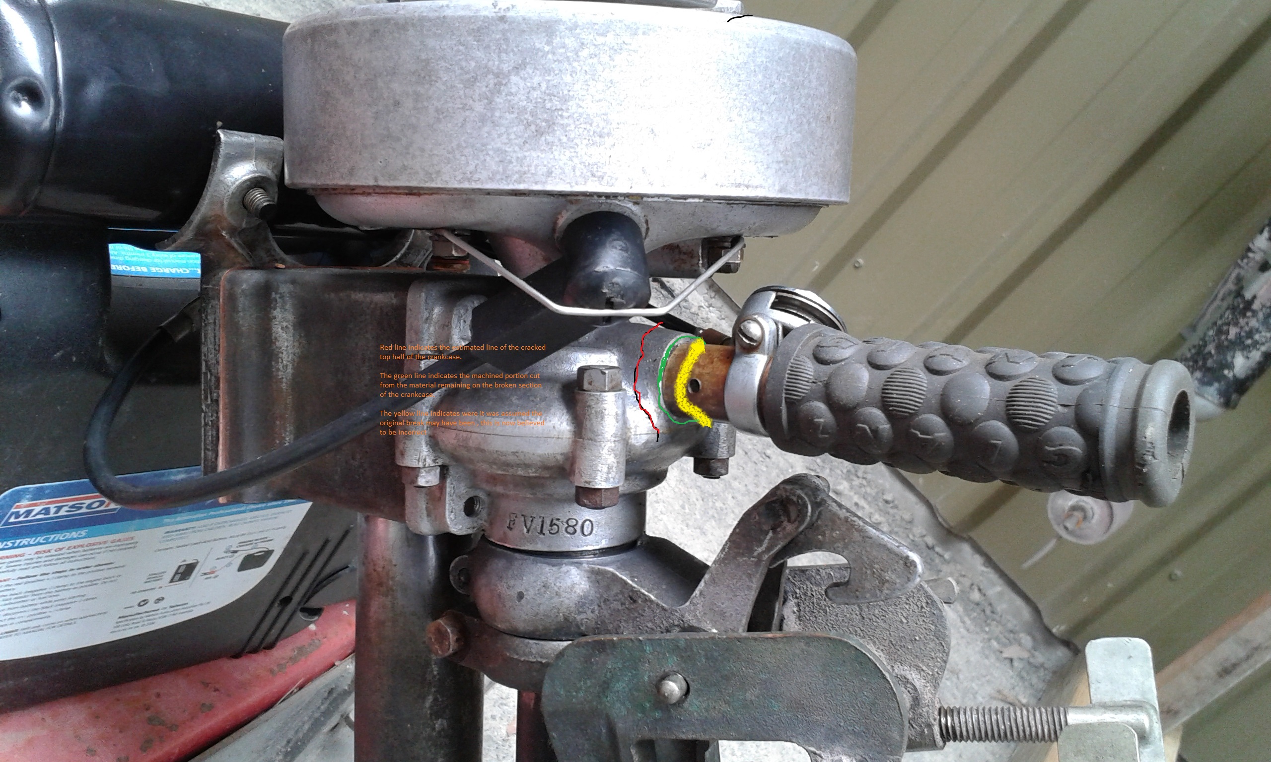

After considering the comments and revisiting the repaired section I now believe I know what occurred.
The motor was dropped on the stub tiller and the impact broke the crankcase through the body in approximately the area indicated by the red line in the attached photo. This would have left a portion of the crankcase attached to the tiller.
I suspect that the agent would have ordered, from BS a new upper case, expecting to receive the stub tiller type as in the photo but instead they received the machined crankcase with the extra fin suitable for the tilting tiller.
As they did not have the lower half of a tilting tiller crankcase they were left with two choices.
Reorder from BS; at the time, with no air freight, this would have entailed a couple of months or fix the problem in house.
I now believe that the damaged crankcase was therefore machined to make the plug, cutting back into the existing material far enough to form the 1/16 flange. This explains why the hole is drilled through the plug simply because it was always there from the original. The green line on the photo shows that there was sufficient material to achieve this and it would have been a simple machining exercise.
They next formed the two aluminium plates to bolt onto the crankcase and to fold around the tiller and grip with screws. On bolting the plates with the clamped tiller in place they had made a creditable repair for the stub tiller steering.
I had originally thought that the crankcase had been broken through the stub, yellow line, but now think this is unlikely.
So in conclusion FV3364 is and will remain a hybrid or bitser, which ever you prefer, as putting it back to original would entail finding and fitting a spare top half stub tiller crankcase. It’s a good repair though and has been in place for most of the motors existence in Australia

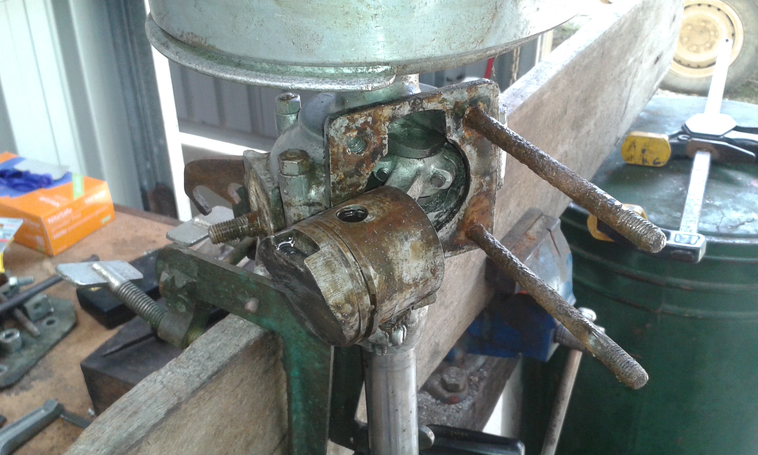

Any one got a photo of a tilting tiller arrangement on the FV? I have never seen one and assumed the tiller was fitted to the lower crankcase like this one
Gannet
Posts: 816
Location: Cirencester
Re: FV 3364
Post by Gannet »
Adrian, as I seem to be having trouble loading photos onto this site I will send you a photo or two in an e mail of FV1867T.
With the FVs and FVPs, the tilting tiller is attached to a small steel bracket which is mounted on the two port crankcase studs.
With the LS/LM the castings are different and indeed the tiller is mounted directly onto the lower crankcase casting.
Perhaps knowing this some of my previous comments make slightly more sense?

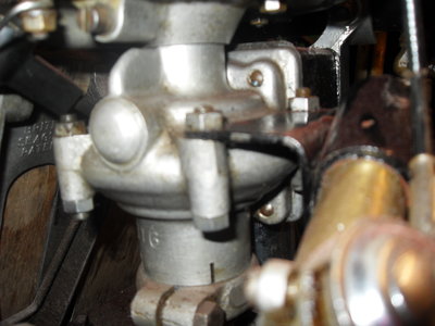

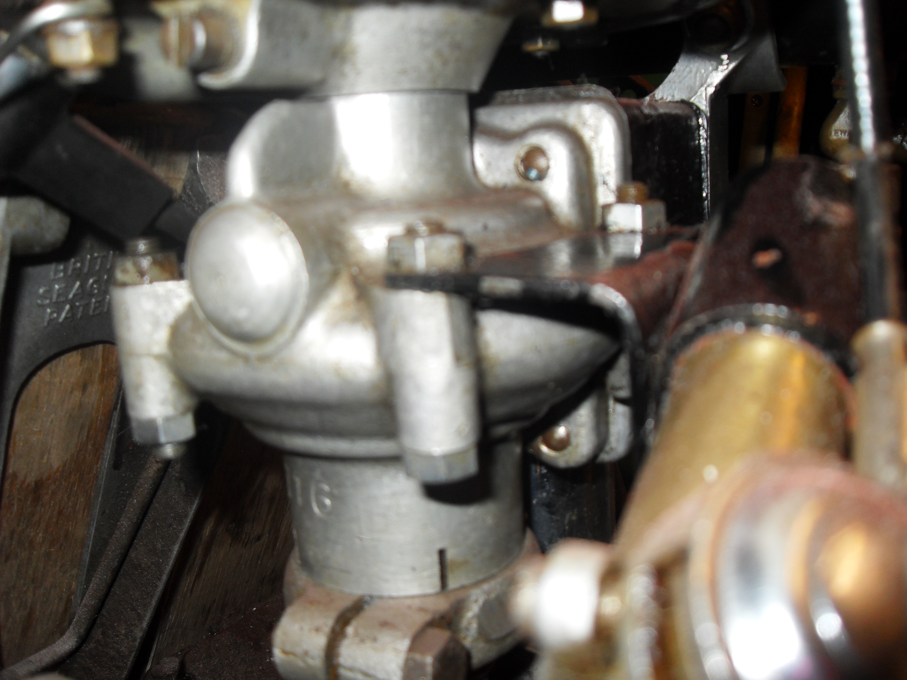

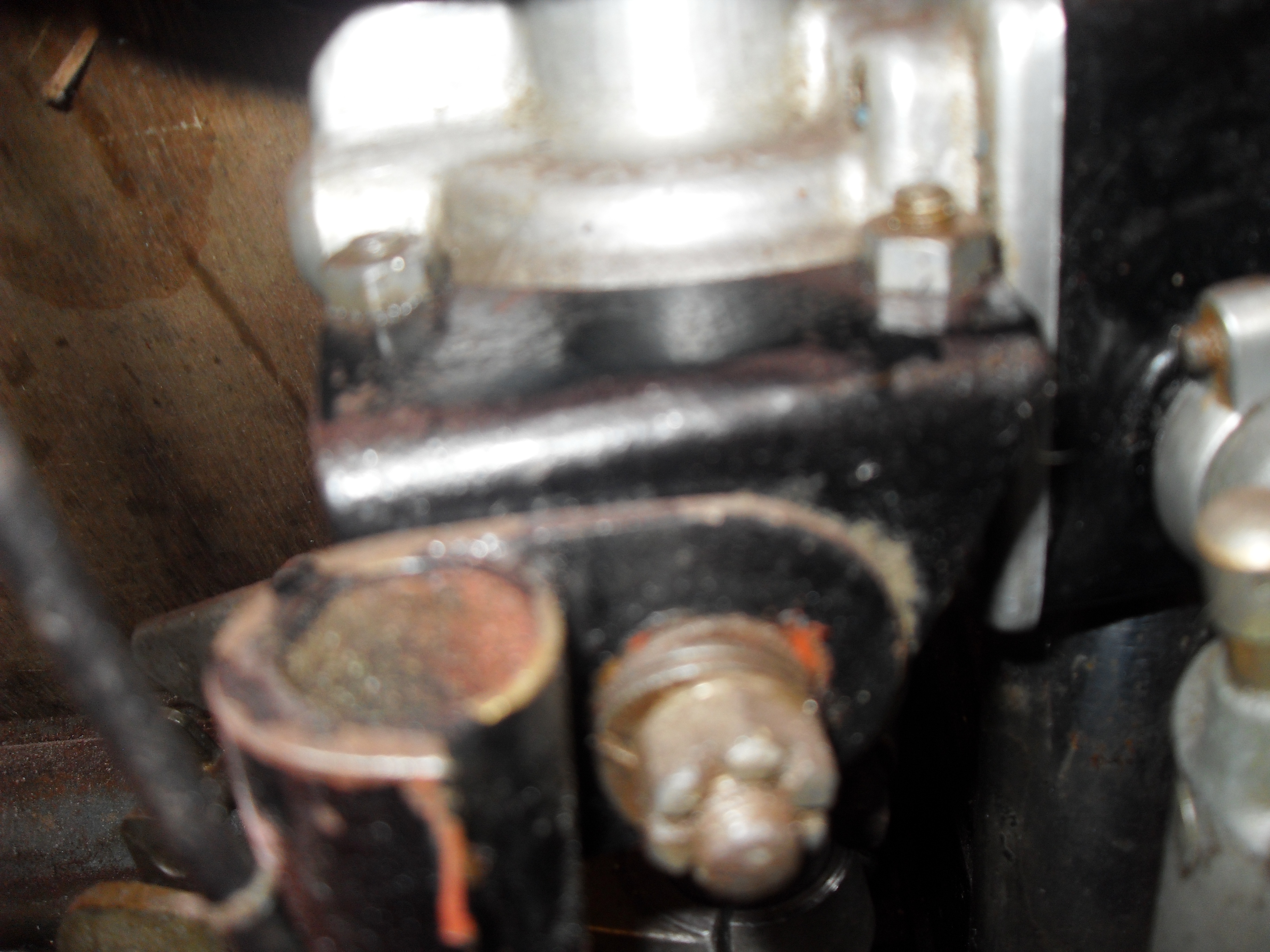

Re: FV 3364
These 2 pictures should help to show you what we mean by the bracket that holds the tiller. Picture quality isn't that great but it's the best i could do for now!
This is my FV11716,a later relative of 3364.
I have 1 spare that will need a replacement stud (if i can find it) it's yours if you need it A-J
This might end up being an easier repair,unless you can find someone expert enough at welding the stub back on again as per original!
quite a simple looking bracket,held in place by the crankcase studs/nuts.
