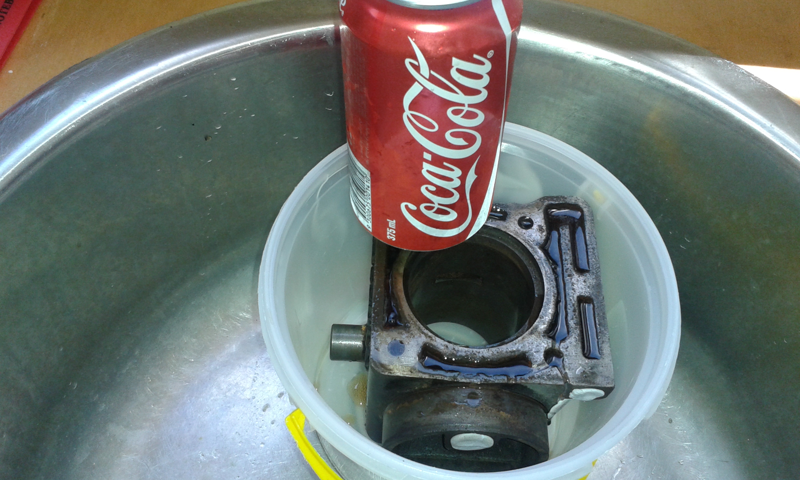

Need a clean.... use a Coke

coca cola is not bad at cleaning some things (but have you seen what it does to your insides! eekgads) that's the phosphoric acid that's in there!
i use my tried and tested method of sulphuric acid (from dead car batteries) leave the cylinder to bubble and fizz for 24 hours, rinse out and have another go with caustic soda.repeat as many times as you think is neccessary.
alternatively, if you have access to certain tools, you could try what H-A does and sandblast them. (i must look into this more as i reckon this could be the way forward with a lot of cylinder corrosion woes)
