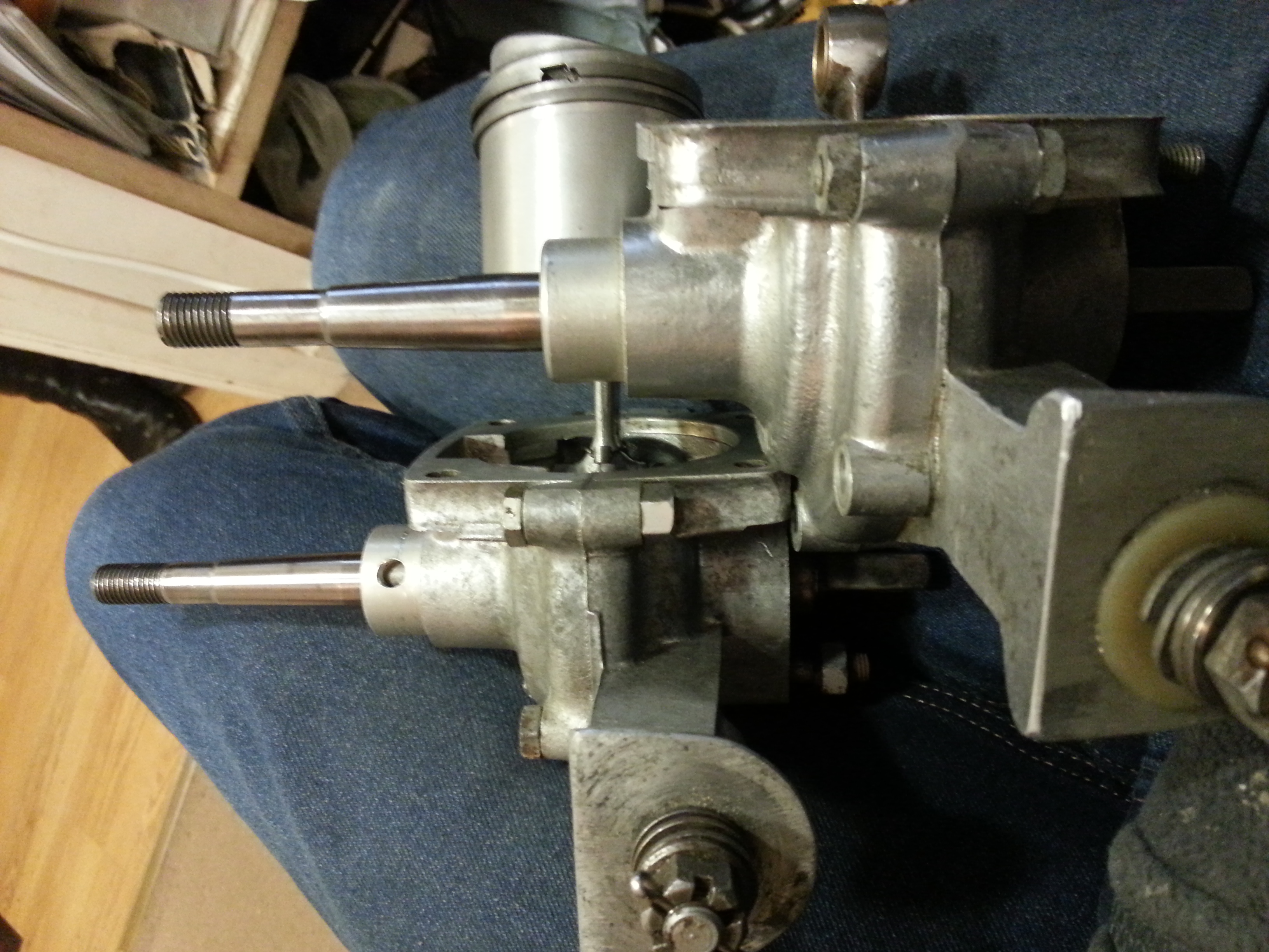

As it stands right now, my old 1960's SJP block is looking like the best option. It is all cleaned up and ready for painting. It has a longer sleeve at the crank end than the one being replaced, but it still looks like it will fit. I'll post a pic once I have it painted.

Sorry for all of the questions about what fits what, some of them seemingly redundant, but I could use some more insight, this time in regards to the ignition.
The plate and flywheel on the left was obtained when I thought I would resurrect the old SJP (the original magneto was shot). The plate with the CDI and smaller flywheel on the right is from the EFPC.
It doesn't seem like the CDI would work with the old plate and flywheel, right? The mounts are in the wrong places and it would be too far from the flywheel to sense the rotation.
Assuming the CDI is not usable with the old flywheel, I guess that means I will need to put the old plate with points on her if I want the old flywheel look. I remember someone making a comment about possibly not having a timing recess - I did not follow what that was about.
Any advise would be appreciated.

Re: Is it possible to morph a SJP and a EFPC?
I've never owned a CDI seagull, but my understanding is you will need to swap the job lot over, and you cannot mix and match. However, the wipac ignition on a seagul is known for being reliable. you say it is shot, what's up with it? you could always get a replacement wipac coil if needs be, not particularly expensive.
The ignition on the left is a Wipac MK2 (bronze flywheel)
That will work fine. if you are using the EFPC crankcase there may not be a hole to locate the magneto base.
These are Silver Century crankcases, the one on the left has the locating hole.
If you are using the SJP crankcase it will have the locating hole, so that will set your timing.
If not looking at the top of the flywheel with the fuel tank furthest away from you, and the transom bracket nearest you.
The ht outlet from the magneto base should be at the 8 o'clock position.
Indeed - all kinds of good info.
To clarify something on oyster's response, the original ignition that came on the SJP is not pictured (and is a different style as well - three spokes, not two). That is the one that is shot. A bad mag - an open when measuring the resistance of the coil. The one pictured on the left was purchased as a replacement a few years back, but then life happened and everything sat until recent times. Wife said I need to clean up the garage - I took that to mean I needed to get the Seagull(s) working so I can pack up what is not used. Hence my recent efforts.
I am glad to hear the one pictured on the left is a pretty reputable option. While I will be using the SJP's block (and the ignition with points), I'll be using the EFPC's crankcase since it looks very, very clean. It does have a timing hole. Yeay!!
So are there other CDI units that do work with the older flywheels or do people convert to the smaller flywheel when going with a CDI replacement?
All of the 5 different Seagull ignitions have their own flywheel types, non of which are interchangeable!
There are two different types, white and black/brown. Each use their own unique flywheel, one has a groove round the outside the other is smooth.
The SJP ignition would be the flat top villiers one, silver flywheel, you can replace the coil in these, cost is about £55.
I would get it all up and running with the Wipac Bronze flywheel ignition, they are simple and loads of bits about.
You can always refurbish the villiers one at a later date with a new coil. Nicer flywheel as you can polish it up.
Keep hold of the CDi set up as they are worth a few quid, you could always sell or swap it for something else.
That engine should soon be running.
