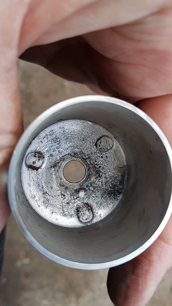

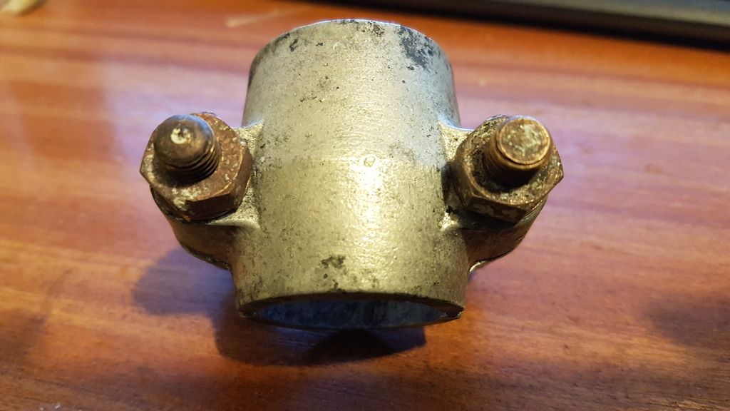

so looking around her cleaning cupboard for oven cleaner I saw the bottle of "Bar Keepers Friend"
it smells like Vim (remember that stuff :shock: ) anyway I wanted to test its cleaning power so I stuck the thrust block in a glass of water added a few tablespoons of powder and let it sit, it has really cleaned everything, the brass bolts are a lot brighter as are the nuts and washers (I took those out after an hour) I'm going to leave the block and bolts overnight, Tomorrow I'm going to try it on the float bowl and maybe give the whole Carb a dunk,I think it will clean up the outside really well and I don't think it will damage the Aluminium like caustic does but I will watch
Re: Little Forty
Be careful with that one Steve watch out for the seal around the float bowl i wouldn't be leaving it in too long check the ingredients of your stuff it sounds like it's caustic based china....

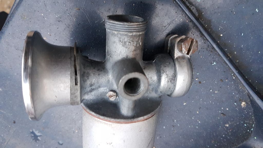

tambikeboy wrote:Be careful with that one Steve watch out for the seal around the float bowl i wouldn't be leaving it in too long check the ingredients of your stuff it sounds like it's caustic based china....
Thanks Tam I had a look and no mention of Caustic soda on the bottle so I took the seal off and dipped it, no sign of any reaction with the aluminum and it cleaned up the Carb body really well
also cleaned all the crud out of the float bowl
