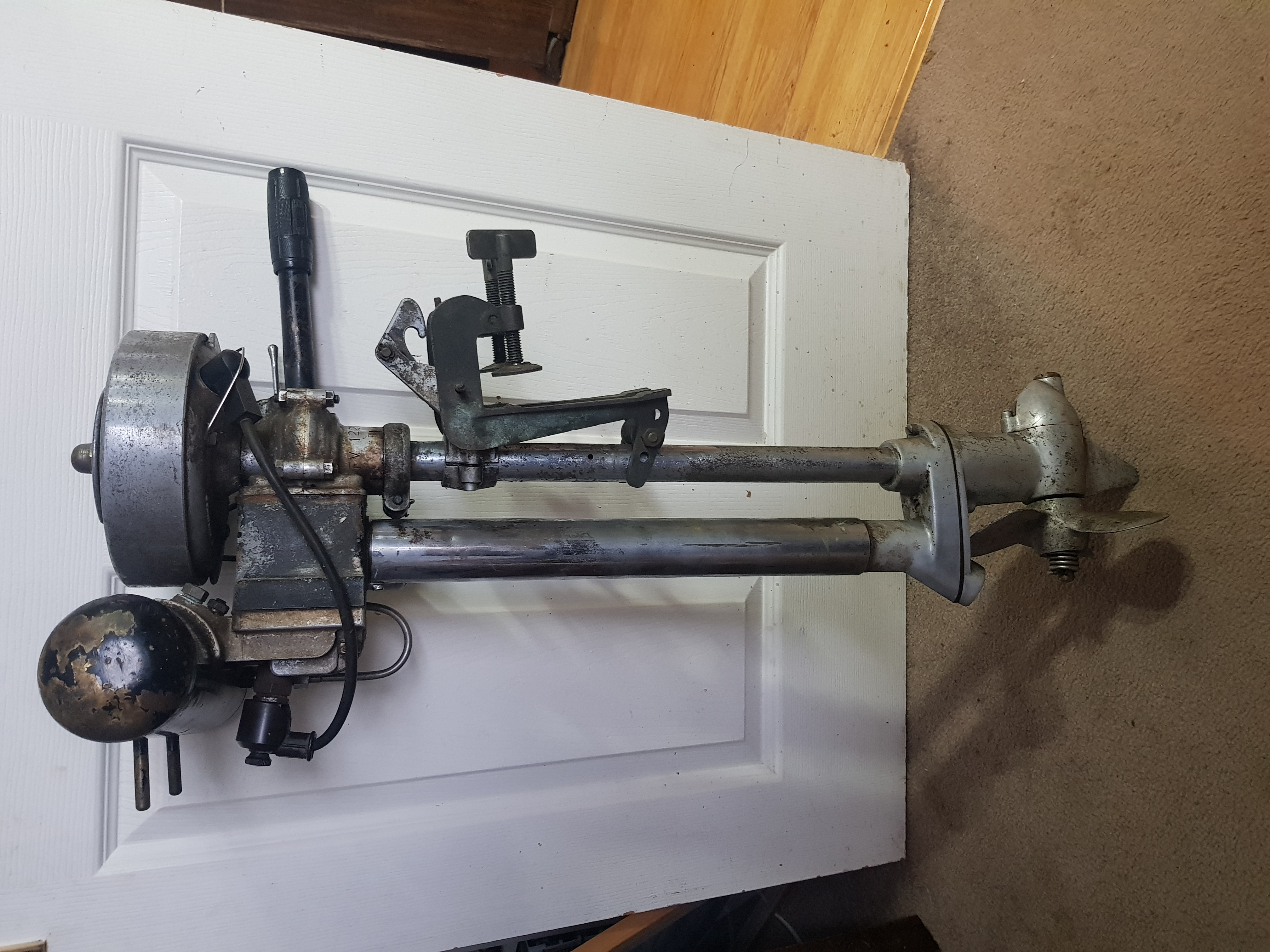

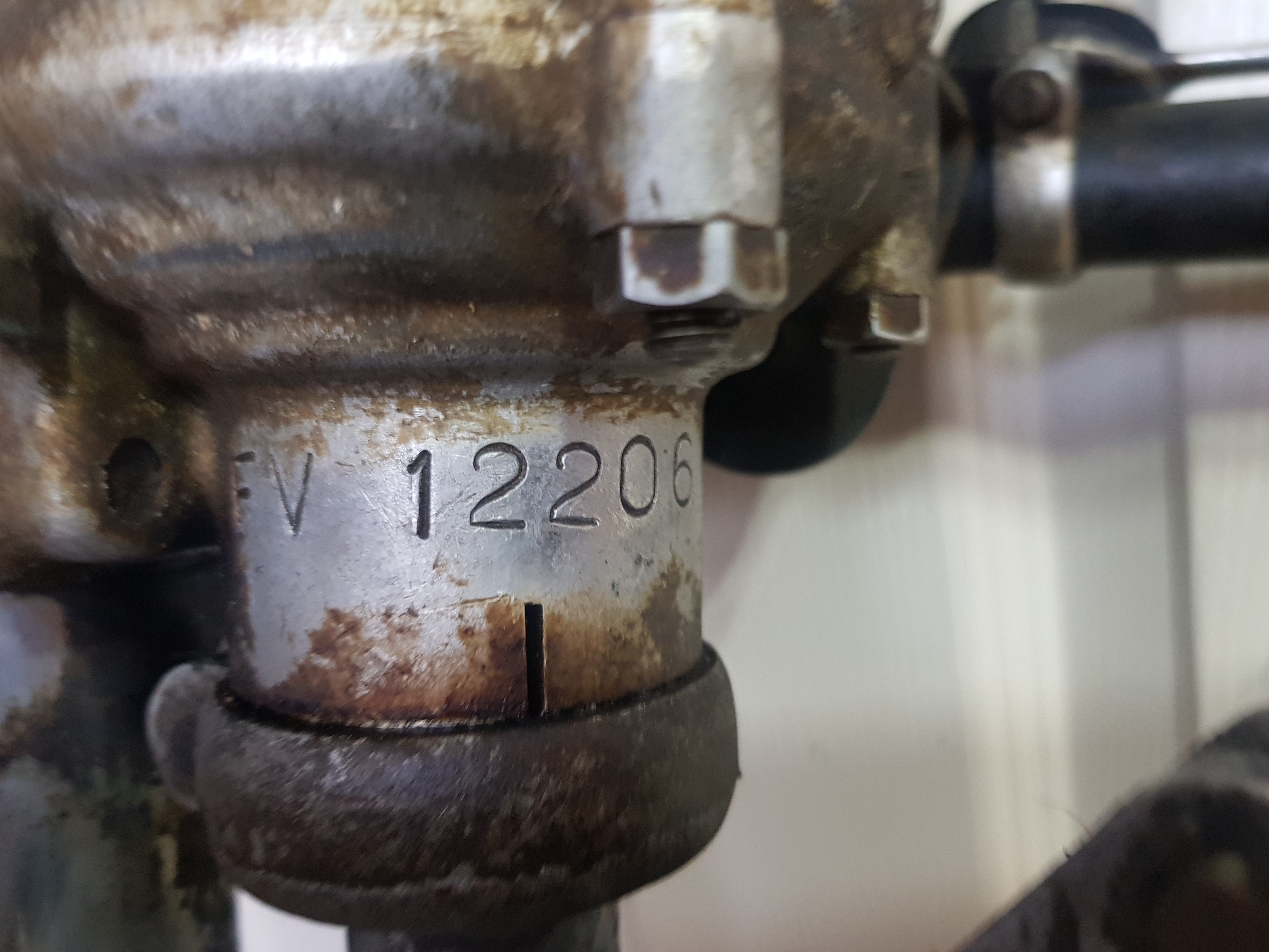

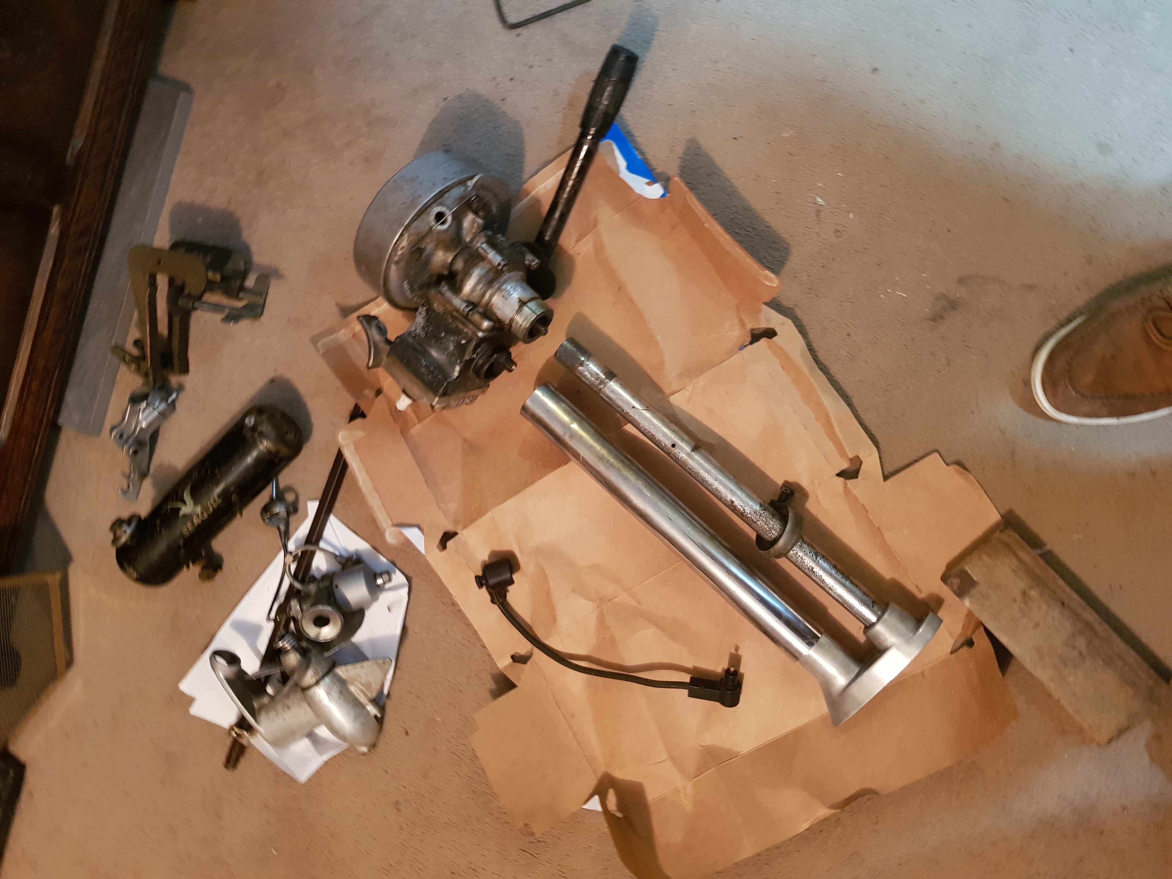

Here you are Jeremy, FV 12206
River motor never been in the salt all came apart easily, turns freely and has a spark.
Has been hot at some point so will have a look at the bore and piston, is this a one piston ring motor?

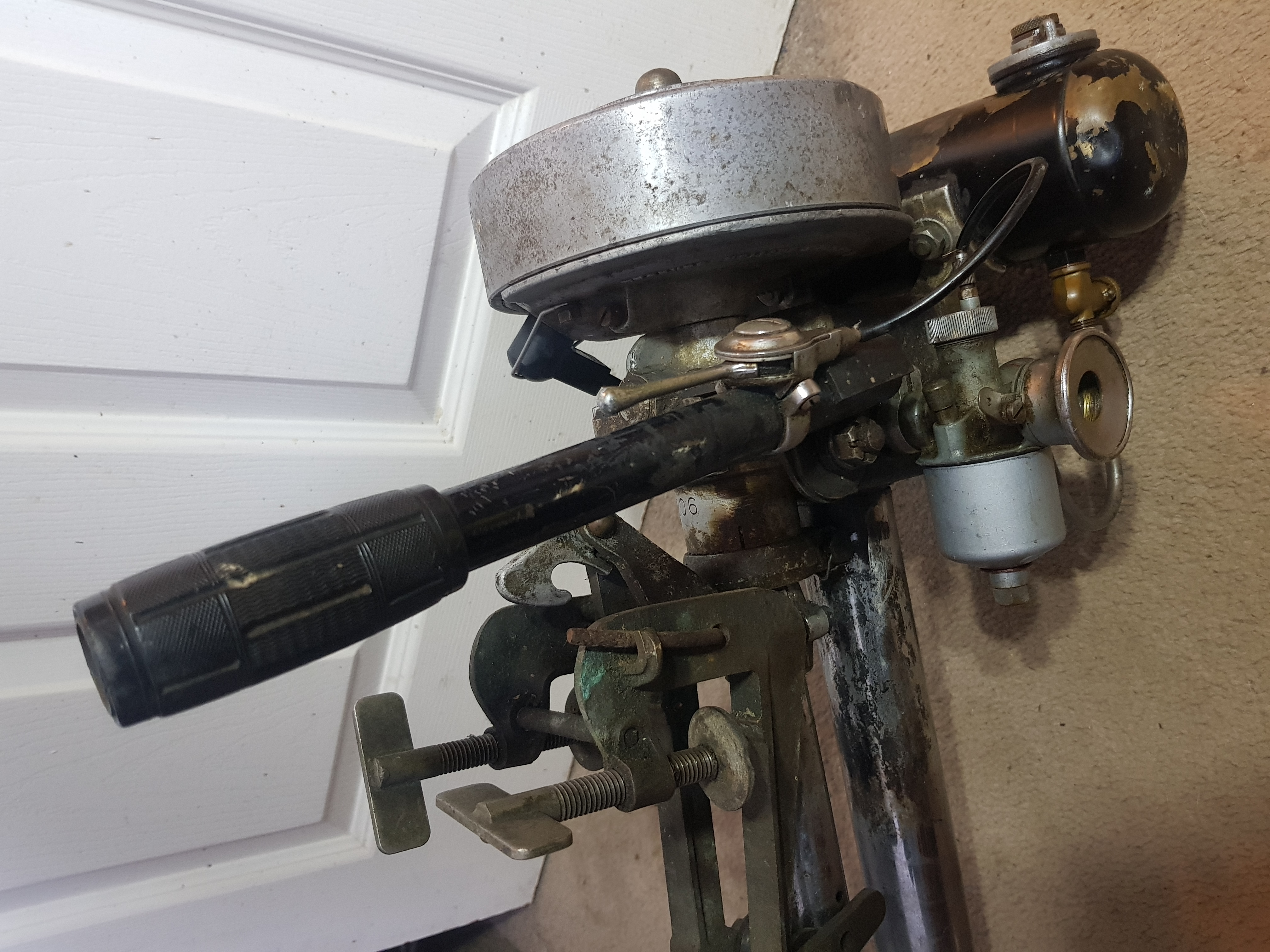

Your newly acquired FV12206 looks good, Allan. Yes, the FVs are great and very useable outboards.
Thanks for the photos.
I especially like the small Champion plug cap. Could it have been an original fitment? I wonder when the Champion was superceded by the Seagull cap. I had previously thought it was a lot earlier than early !953.
Allan, are you sure you don't want an FVP to play with as well?

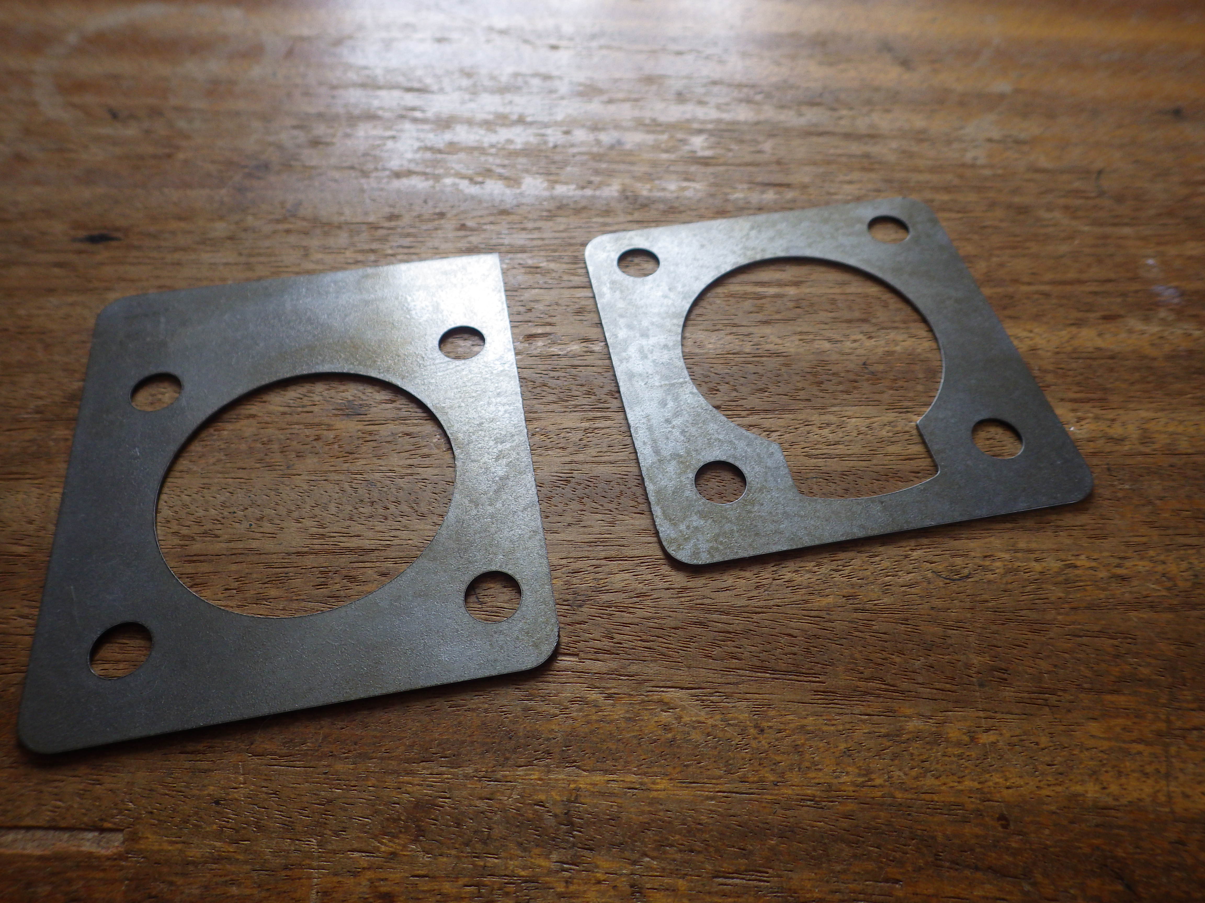

Hi Andrew, thanks yes I know.andrew wrote: Wed Jan 27, 2021 5:25 pm FYI John @ SOS has the FV metal gaskets in stock, I got a set from him only a few weeks ago.
It was just that Adrian previously said he wanted to get rid of some, and John has a limited number available.
Might just make some, could be easier.

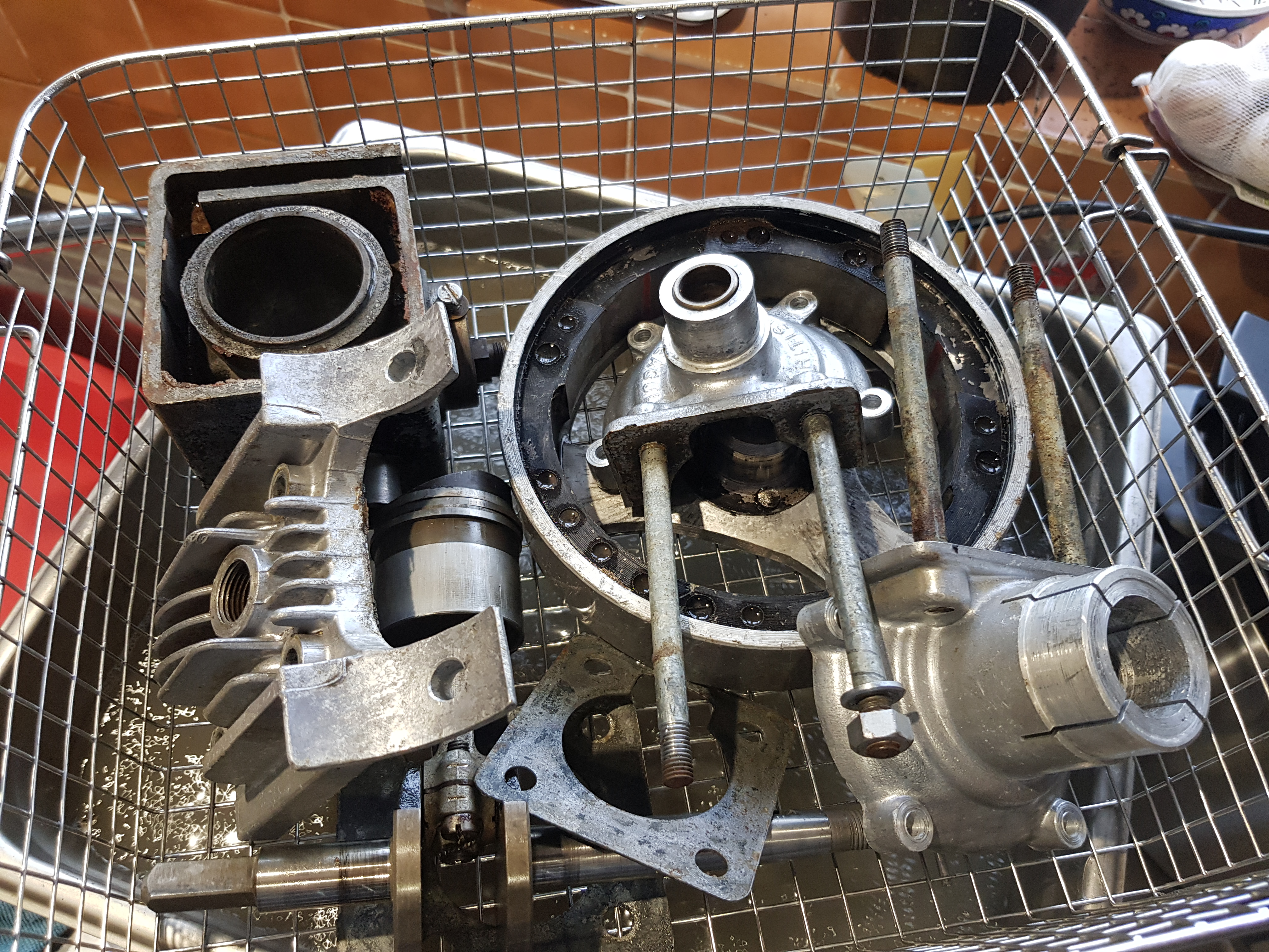

Re: FVs

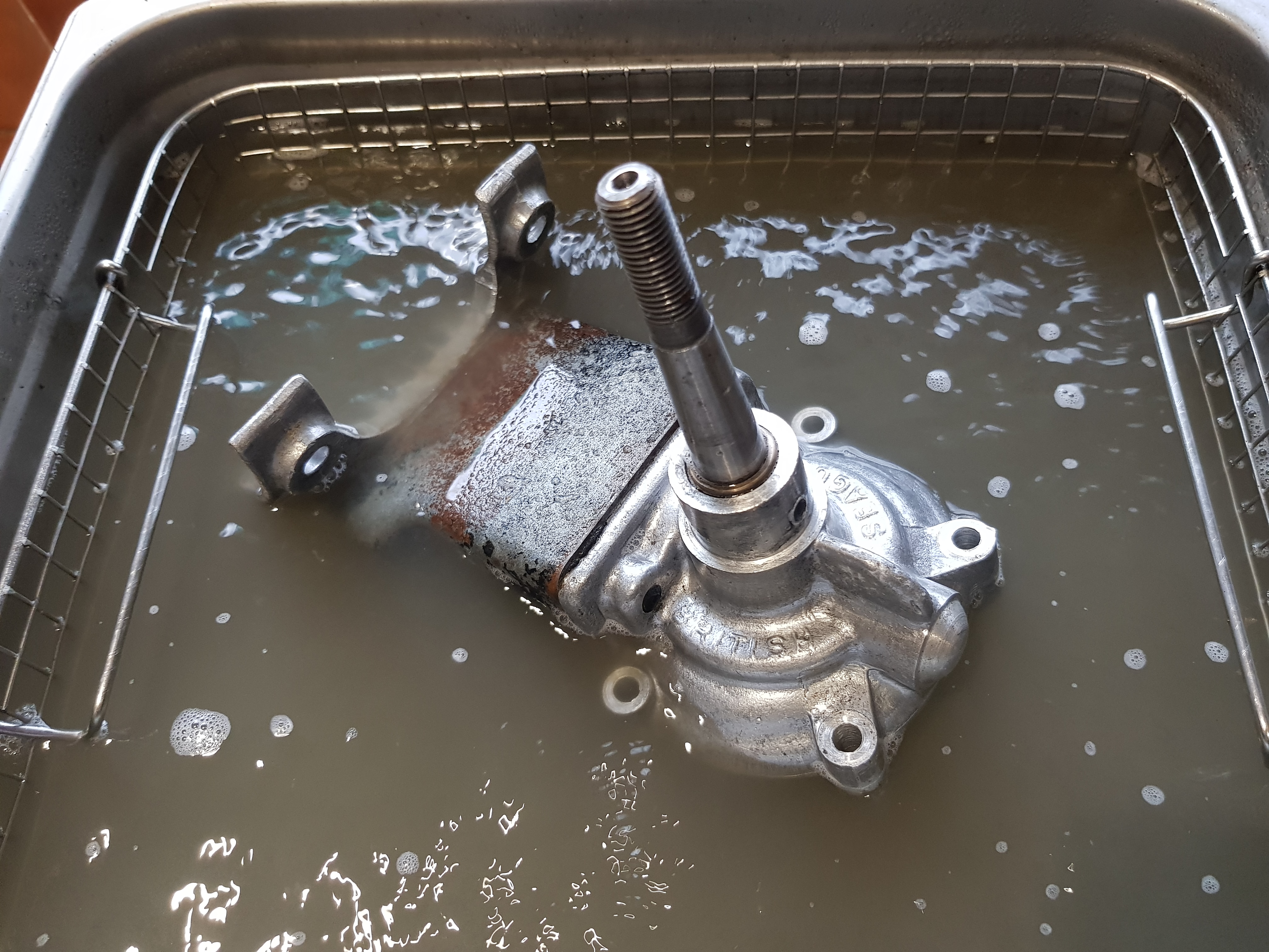

Taking a bath, very clean under all the muck
Comes apart easily when hot
