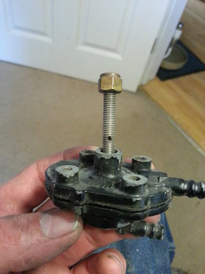

fleetingcontact wrote:HA, I have the pump from the 170 and wondered if I could fit it to the 102 cases, other end to the standard tank - stupid idea or not? I'm not at this point keen on doing the remote tank thing. I doubt I'll ever need it.
Yes I have fitted a pump to a century, you need the vacuum from the crankcase to make it work, Kingfisher has a drilled crankcase bolt with a gallery to the crankcase, that is what I did with my century.

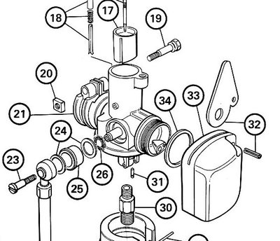

Its called a compensator on the Villiers and I'd made a sooooo foolish assumption thats what they're all called. So part numbers 31 & 33. I haven't looked at it in microscopic detail so there may be other bits missing too. I'll take a pic when my camera battery has charged up but its not that interesting - just a smeggy 416...
HA, thanks for that, any chance of a pic with the thing in situ? Did you send the fuel delivery pipe to the gravity tank?

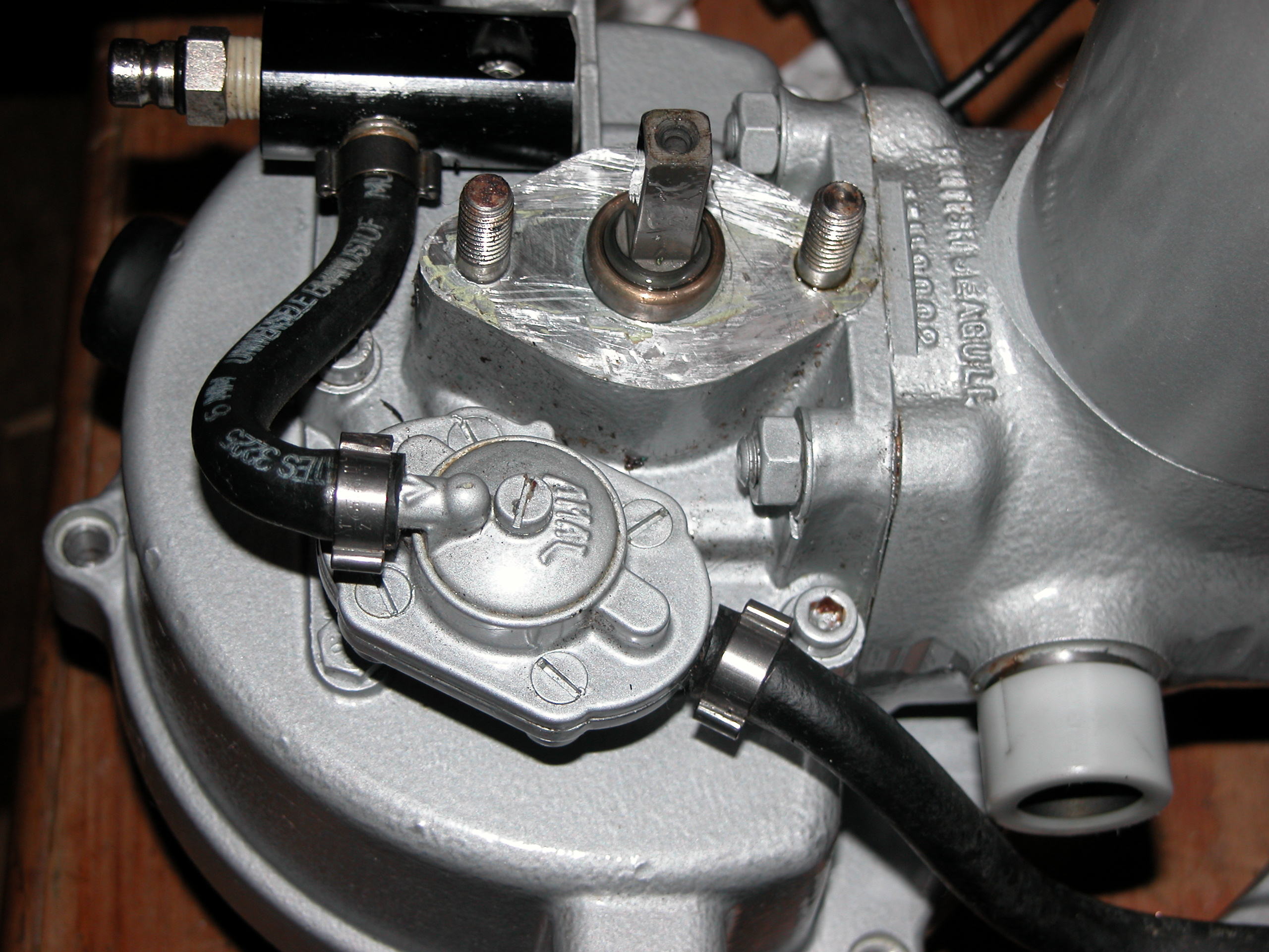

Jeez. Did you connect the fuel pump to the standard tank on the Seagull or did you do this so you can have a remote tank?

The pump feed side of an SU pump, is gravity fed from the tank mounted on the back of the engine, or via an additional connection to a remote tank.
The only reason seagulls have a pump is that the delivery from a cylinder head mounted tank is insufficient for the carb.
If you try and run a 420 without a pump, I have found they run out of fuel as there is not sufficient head to deliver enough fuel.
Remote tanks are generally in a negative head situation, so need a pump.
I am only talking from personal experience that comes from running most of the pumped seagulls including Kingfisher, Seagull 6,170 and successful race engines using 420 carbs .

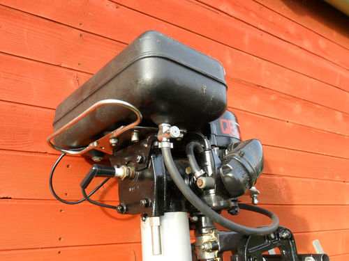

So that looks like a standard QB, don't know for sure since I've never seen one. Is the pumped carb system in pursuit of more bhp, because based on what you just said the QB would be also ok with a 416 and no pump - no?
